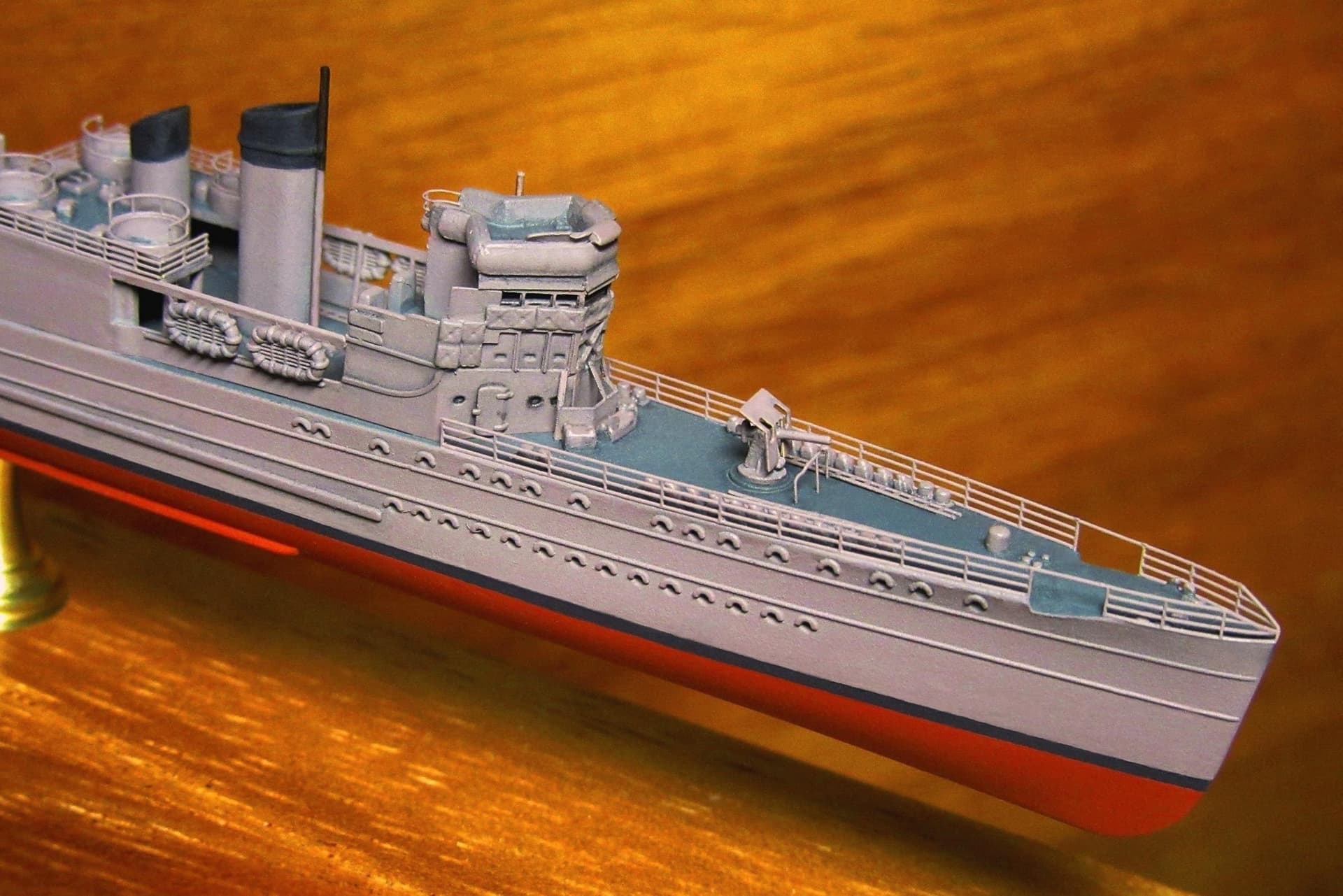

The 12-pounder gun, its barrel limiter, and the debarkation ladders for the commandos have been added to the foredeck. I also added the safety rails.
Most depictions of HMS Campbeltown show the rails forward of the bridge to have been removed, presumably to make it easier for the commandos to scramble on to the dock after the ramming. This is partly true, but a few close-up photos taken by the Germans after the attack show these rails to have been present but folded down. I was happy to discover this, because the rails provided by Flyhawk are so good it would have been a shame not to use them. I figure the model will depict the ship as she appeared in the last stages of fitting out for the attack before these rails were folded out of the way.
Etched propeller guards added.

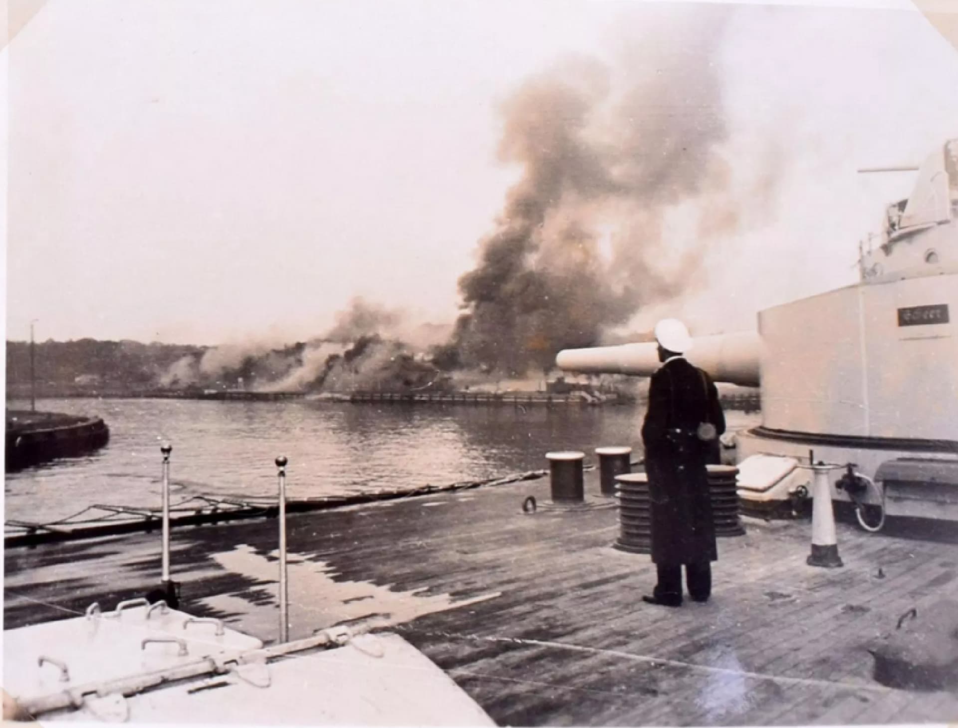

How would I realistically depict the railings folded down? I don’t think simply glueing them flat on the deck would look good.
The rails were folded out rather than toward the ships centerline such as in this view of the German Schleswig-Holstein:
To make them look right you would have to reproduce the sag between the stanchions and keep the spurnwater ridge at the base vertical (i.e., bent at 90 degrees from the now-horizontal stanchions and lines). Even then, I think it might look odd…
I didn’t choose to go this route on the Campbeltown since it would have tended to be too much of a focal point on this small model, maybe even looking to observers as if the modeler had somehow screwed up the railing!
