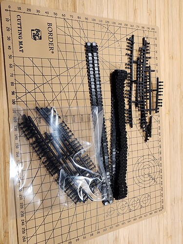

Replacement parts from Meng for my miss molded track parts. Now I can finish the tracks and start working on the hull. After putting in my problem request with Meng it was 3-4 days till they shipped and 3 1/2 weeks to get to Calgary, Canada by post
Its nice to see Meng is supporting you on this. Did they make you jump through hoops?

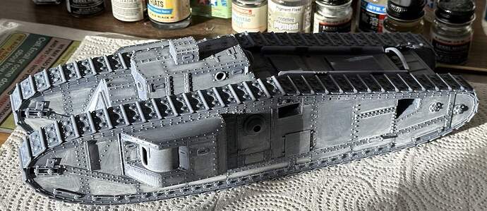

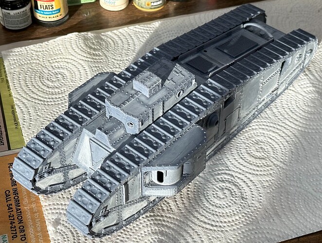

I spent a LOT of time sanding this Vargas Mk VIII tank. The rastering was not huge but it was there and I wanted it off to the extent possible. I used sanding twigs from eBay and could have used something even smaller if I could find it. Here the parts are done and ready for a bath in warm soapy water.

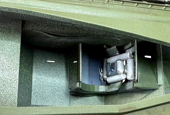

There is one very fiddly bit in this kit. The turret shields are very then and badly warped. The spot where they fit into the sponsons is happily well designed and forces the sheilds into their cylindrical shape. Coaxing them into position is nerve wracking. The first one fit fine but the second split just where the cannon barrel slot is. The damage was repaired with CA gel glue from the inside.
In addition, both shields shed one of the parts that hold the cannon. These cannon will traverse but will not be able to elevate.

Paul, Meng was great to deal with. They wanted my address, the code on the inside lid of the box and some pictures. I had confirmation that they would ship in a couple of hours. The International looks awesome, and huge!
Paul, great looking tank. Really something out of the ordinary ![]()

Next the tank was flatted and it was time to join the main parts together. Once this was done there is no going back so the guns needed to be solidly mounted to the turret shields. If they came loose there would be no getting at the bits inside the model. The mounts were weak to start and one of the two in each shield had already broken off. The shields were installed in the sponsons and once in position the guns were attached by CA glue. Then bits of sprue were glued in place to make the mount good and secure. They will now traverse but not elevate.

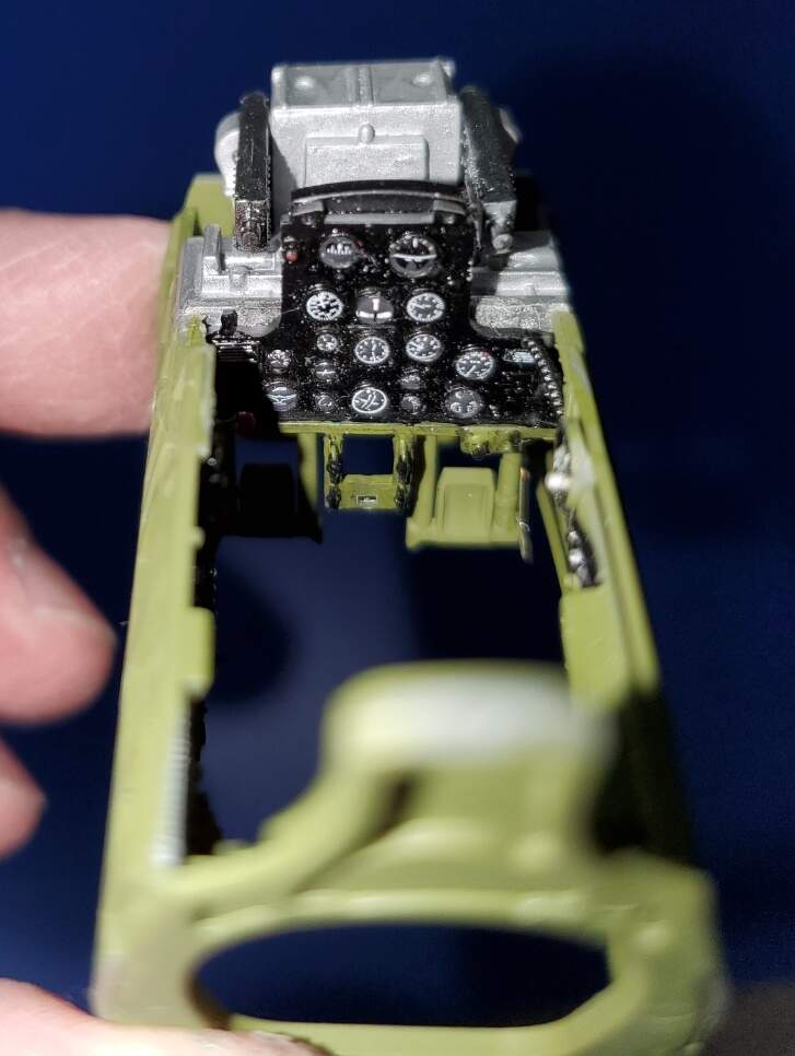

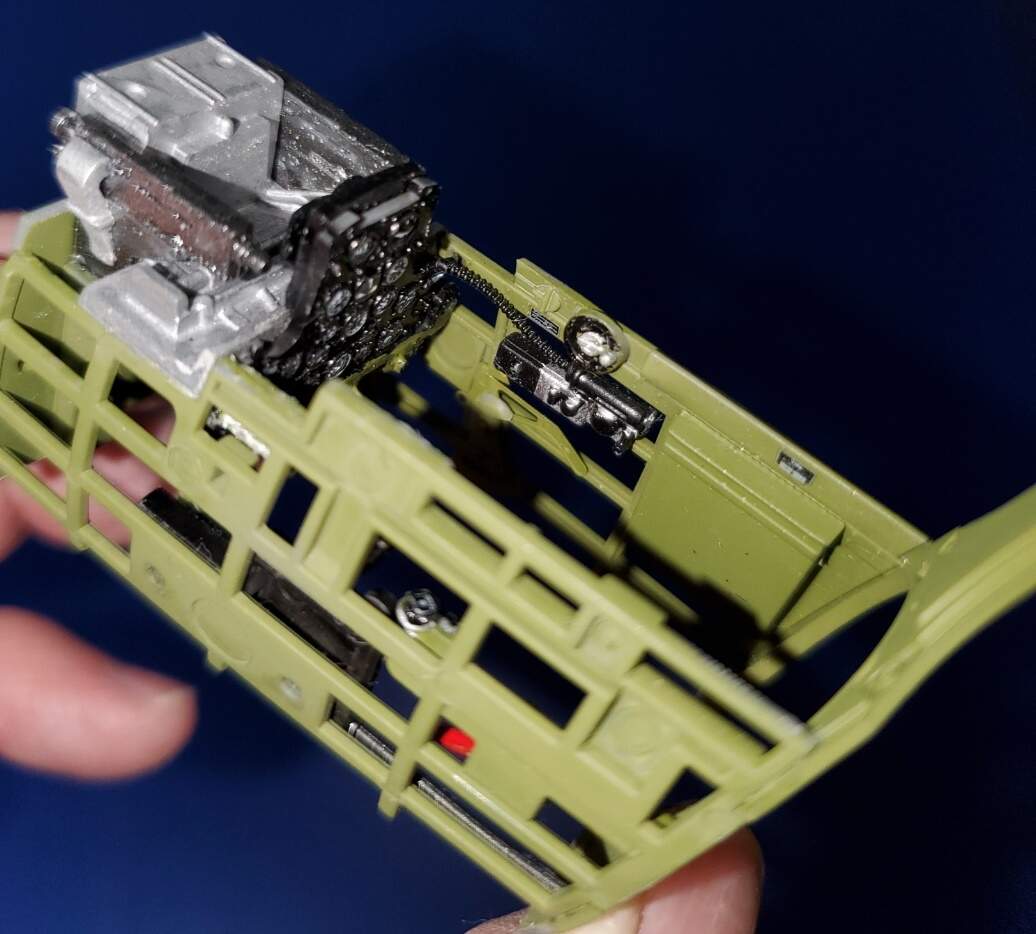

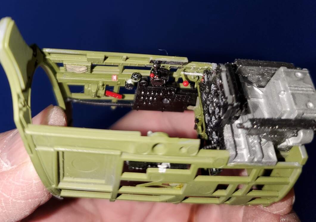

I’ve made some not-so-fast progress on the Great Wall 1/32 Flying Tiger. As usual, I got myself going and forgot to take pictures, but here are the cockpit sides and bulkheads put together:
As usual with Great Wall, the instrument dials are all separate decals, but that’s at least a little easier in 1/32 than 1/48. And they do look great when applied and with a drop of gloss.
The instruction sheet is a bit vague in places and I glued the instrument panel to the gun shelf in the wrong place. Luckily, I figured it out before the glue dried to the point I wouldn’t have been able to pull them apart, so disaster averted. Other than that, I’m loving this one so far!
