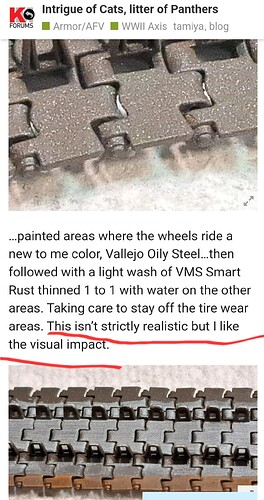

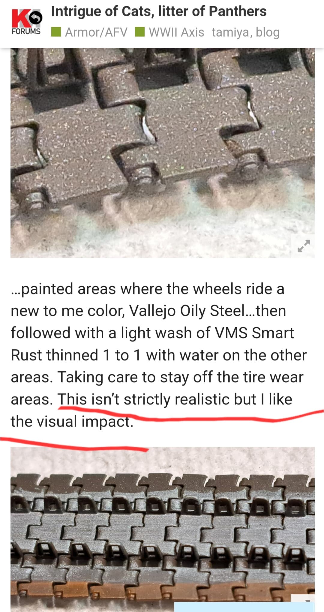

My approach testing QuickTracks, Tamiya Dark Iron as track color, overspraying Tamiya paint with much hotter Floquil Railroad paint, using VMS Smart Rust as a wash & AK Graphite pigment. I take pictures via cellphone at each stage then wrote it up to post in my Intrigue of Panther’s thread. It’s quick, easy and makes an additional blog post for the model build. Total time ten minutes or so to document five tests rolled together.
Played with new products to finish a set of QuickTracks early Panther D tracks.
Base of Tamiya Dark Iron, followed by mist of Floquil Railroad Antique Bronze.
Painted exposed metal where wheels ride followed by a wash of VMS Smart Rust for visual impact.
More VMS rust wash.
Rubbed down with Graphite powder.
Results…
Taking several pictures during the process makes for far less typing to document as one can see the various outcomes at a glance.

@Biggles50 Leo,
Where did I say those tracks were realistic?
I said it was testing.
Maybe consider asking or discussing before making assumptions about what others know or don’t know.
The not being realistic is even addressed in my actual blog post.
So no, I don’t need to rethink my track finishing because visual impact is more important to me than a strictly realistic appearance for the tracks. Yes, I’ve known about the manganese for decades.
Of course, modeler’s should finish models in a manner that suits their tastes and priorities.

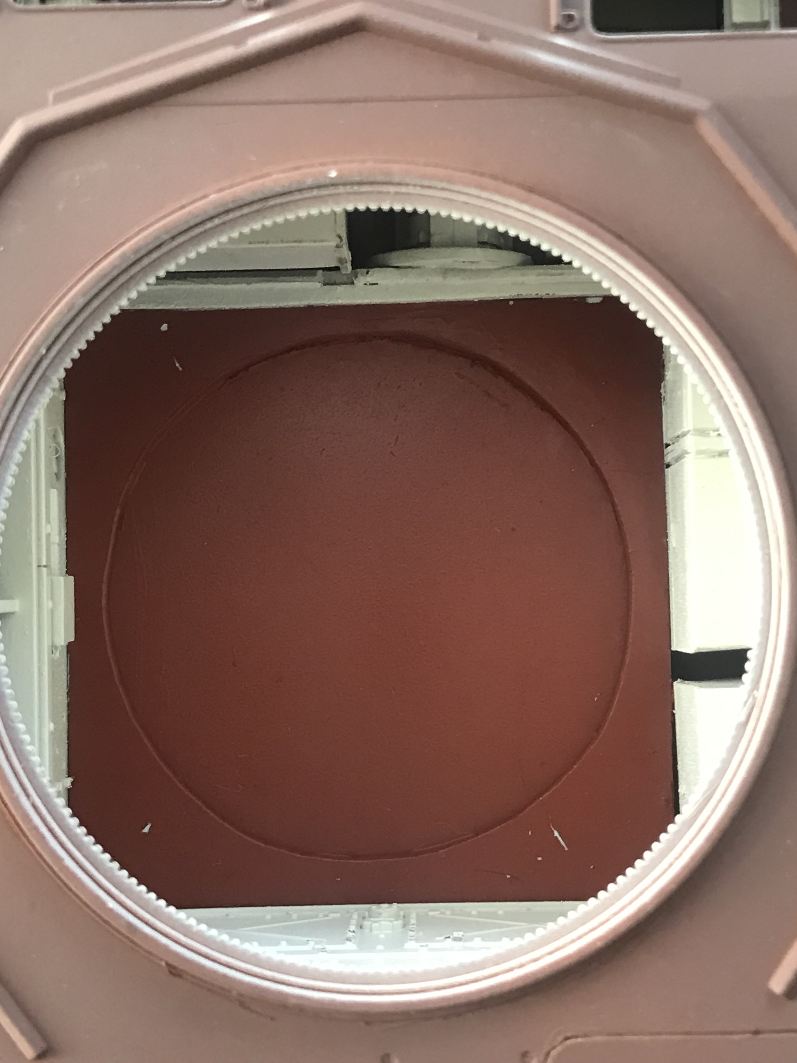

The floor is glossier than what it should be. It is a learning experience, because I didn’t follow proper painting procedures. I now know how to use AMMO paints properly, which I should have checked prior to paint.
