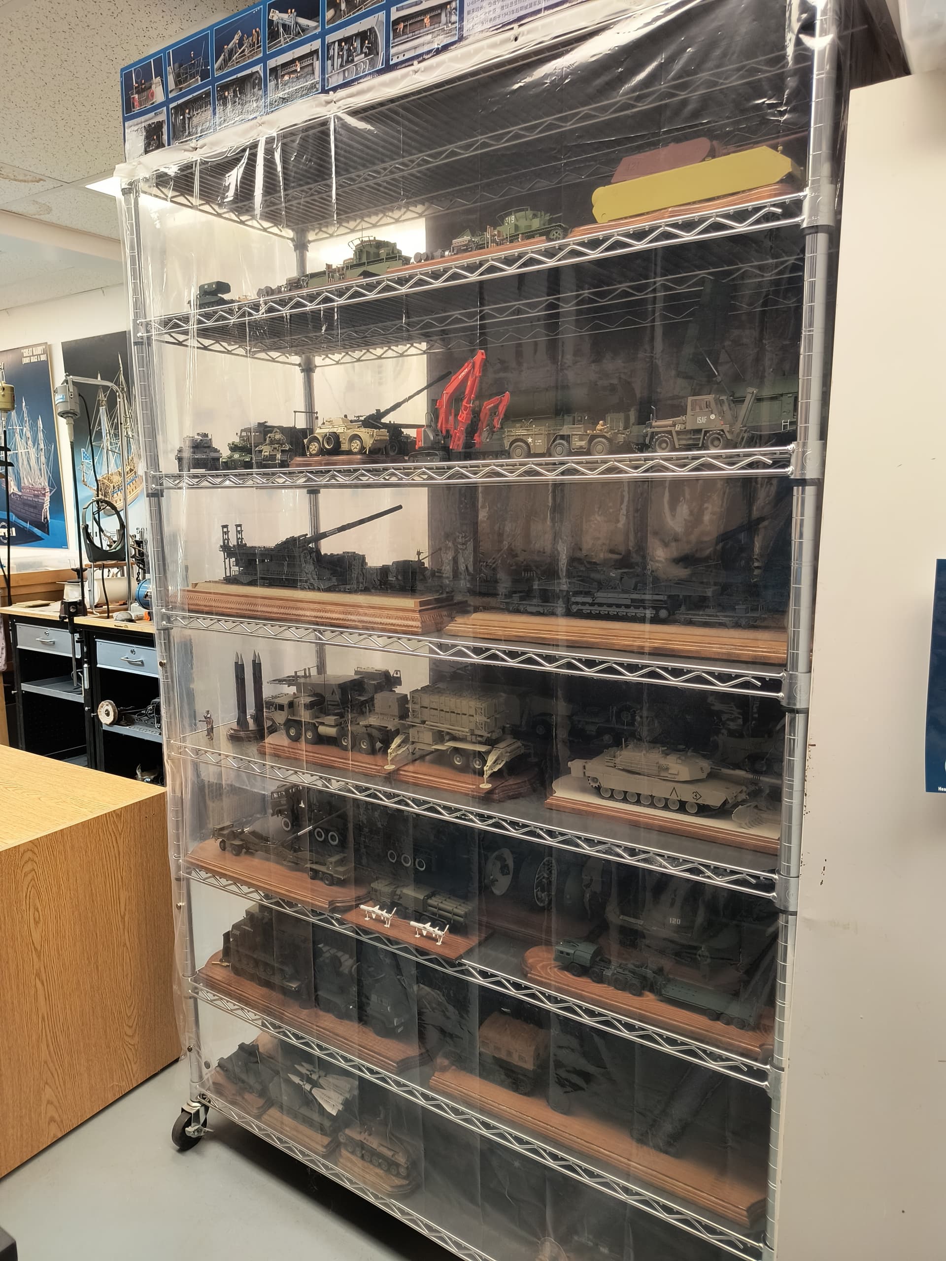

If you have the room, I’d recommend these racks from Sams. They are $100 each, have 6 shelves, liners, and wheels. Get an extra one and and use two shelves from it to make 8. Cheaper than buying the shelves separately and leaves some for future (or larger spacing between shelves). Get 2 clear shower curtain liners from Walmart for $3.50 each, a couple packs of round magnets and a handful of Ty-Wraps from HD. Use the magnets to hold the overlaping corners closed. I have 6 of these in my shop and they are all full. Time for another one I guess.
That’s a great idea,although my wife wouldn’t want them in the living space but in the basrment would work for me.

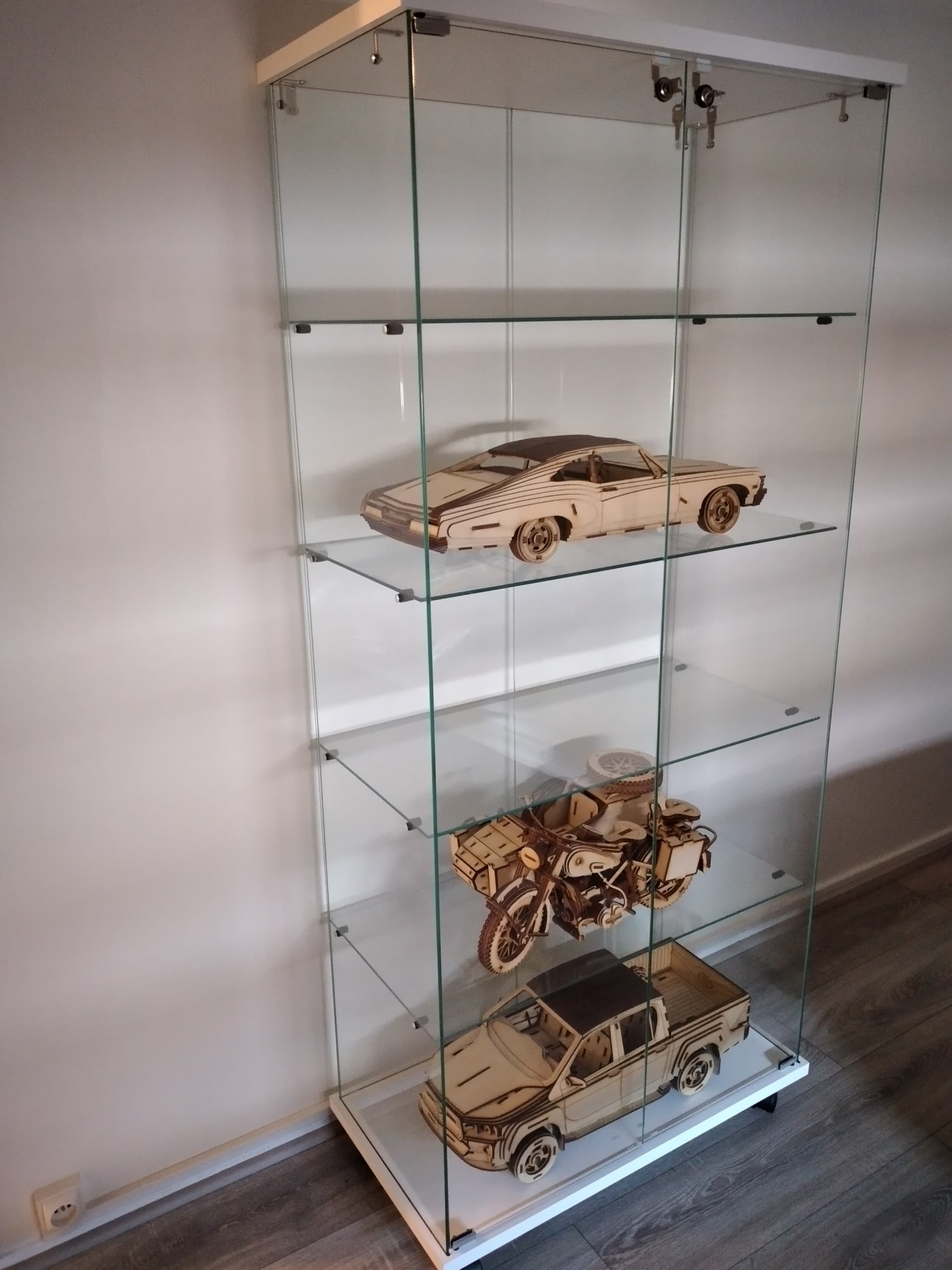

Display cases:
A bit expensive but your models are safe.
I use Ikea shelf Billy
but after years ultra fine dust is penetrated.
I think to put a fan to give a little over pressure inside (in a far future,)
I like the fan idea. I had a glass case that was supposedly sealed. However, over the period of several months fine dust still found it way inside and in the models.
