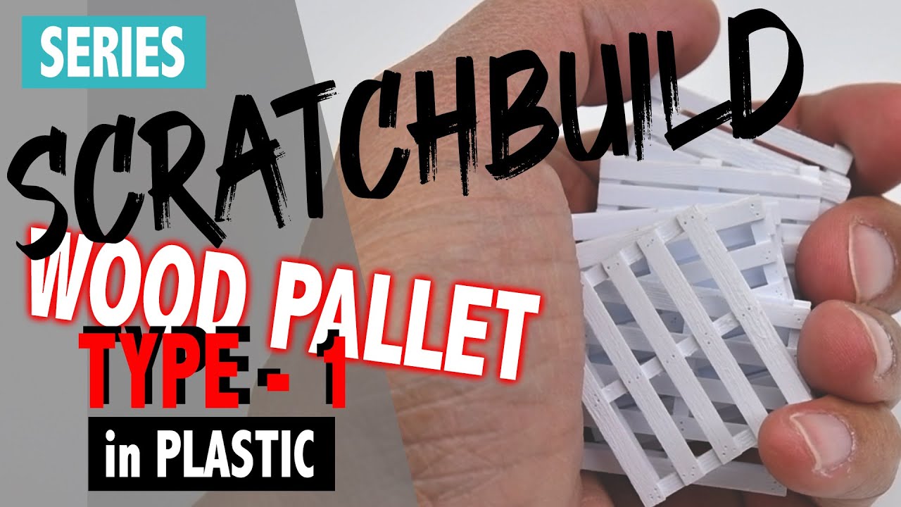

Just want to share with you a tutorial I created about the construction of the wood pallets in 1/35 scale (this is the version using polystyrene strips). If you are trying to build wood pallets in scale using a repeatable process this tutorial might help you. I developed a template and step-by-step process to make the process easy to follow and that producers the same result every time. I hope it can be useful.
Good video, I think for the plastic version, scoring the plastic while still in the strips before cutting would help with realism when viewing the pallet from different angles.
I agree with you, scoring the plastic first is another viaible option.
My next video will be about the same template but instead of using the plastic strip I will be using balsa wood, that will give options depending on which material people will prefer to use.
I ended up following the Consumer Brand Association (CBA) (formerly known as the GMA). They suggest standard pallet dimensions to be 48" x 40" which equates to 3.5 x 3 cm in 1/35 scale. See the link below I used for reference in my research. Because there are so many types and styles I had to choose one to make my process more straightforward.
Stay tuned because over the next few weeks I will also release another video, with what I am calling the wood pallet type 2, a littled easier to build with a nice looking result.
Thanks Jorge. Good stuff, looking forward to seeing more.

As much as I like to scratch build (I have a HUGE selection of Evergreen styrene in all sorts of widths, thicknesses and diameters), I actually prefer to use bass wood strips to make pallets.
I like these pallets you’ve made with that cut on the bottom side planks.
The next video that I will release next Monday is all about using the template I created but instead of using polystyrene strips, I am using balsa wood as well.
