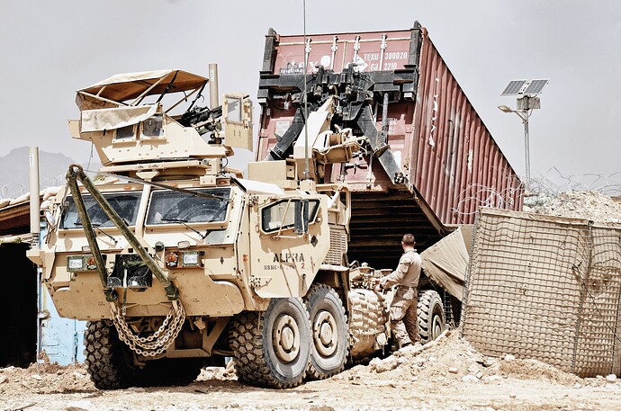

My intention with this project is to make a model resembling the vehicles in the two pictures below. The main differences between the ILK LVSR MKR18 kit and the vehicles below are the armoured cab and the MCTAGS (Marine Corps Transparent Armoured Gun Shield) armoured “turret”. The MCTAGS is a standard item in the USMC inventory, and can be seen on vehicles like the Hummer, the MTVR 6x6 truck and the LVSR.

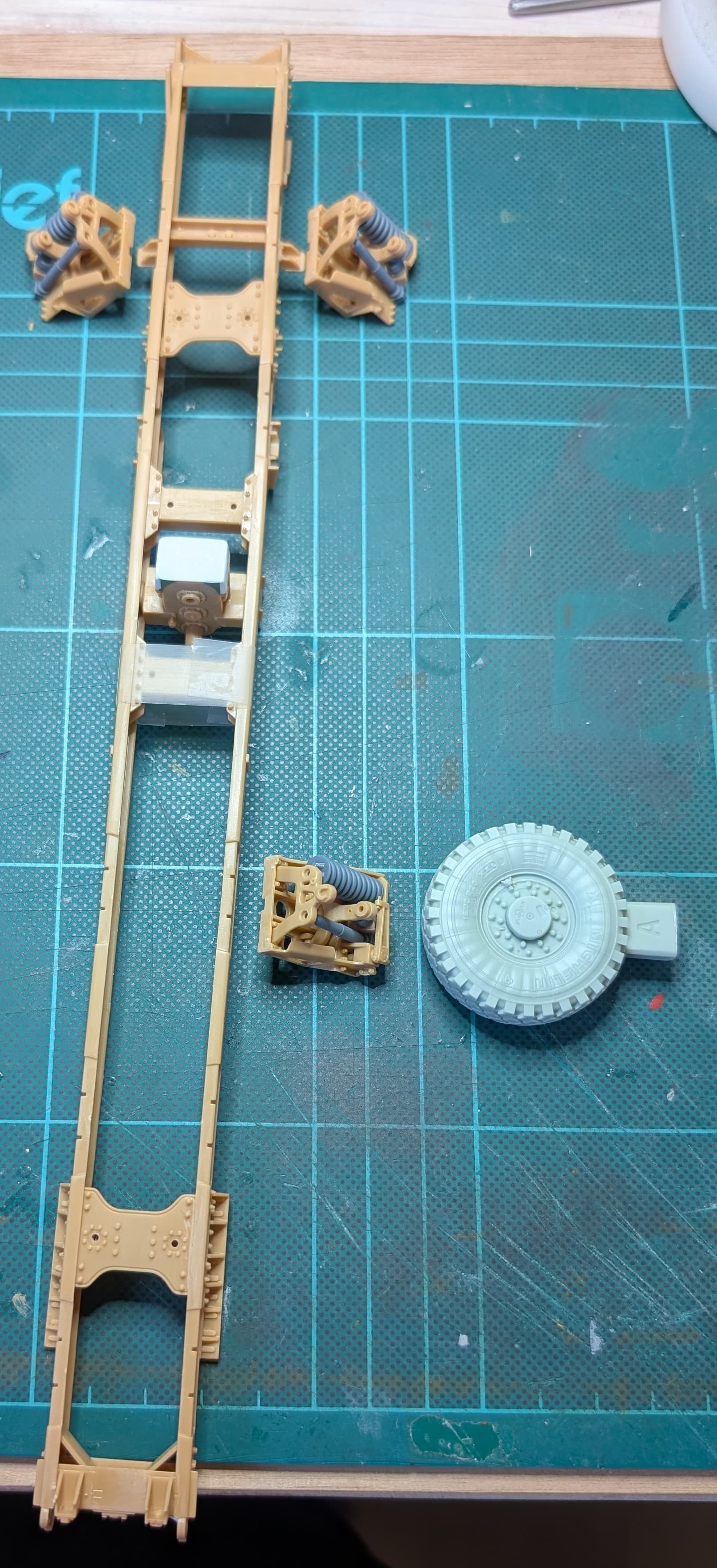

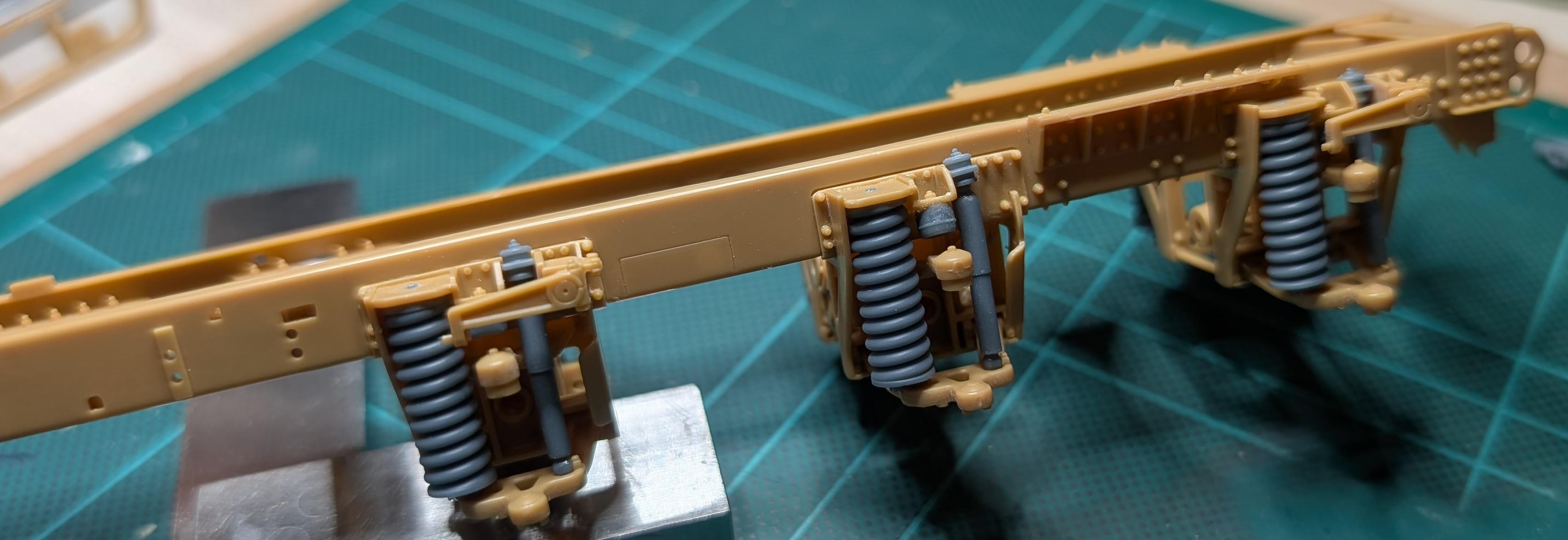

The first subassembly I have built is the C-section chassis frame (Step 13 in the instructions). By implication, it is the foundation for the other subassemblies of the kit, and thus it is a paramount importance, everything is squared away in the frame, as any imperfection will cause other parts to be out of alignment.

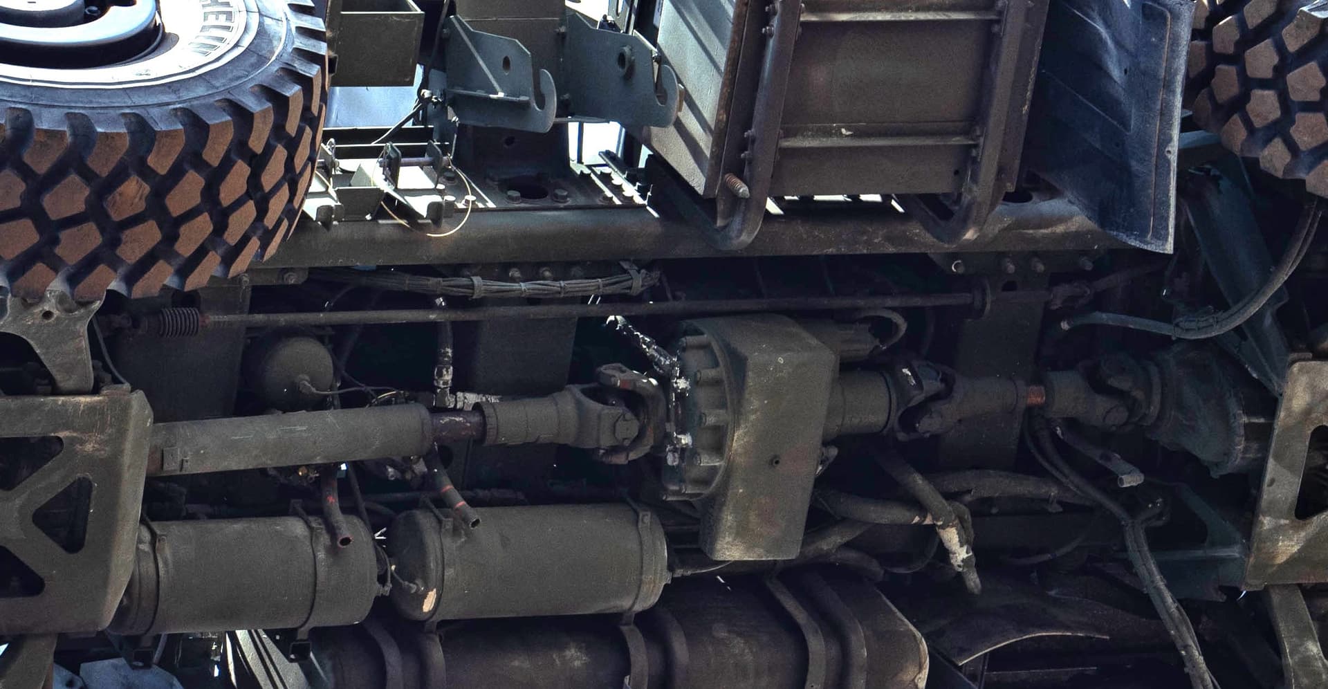

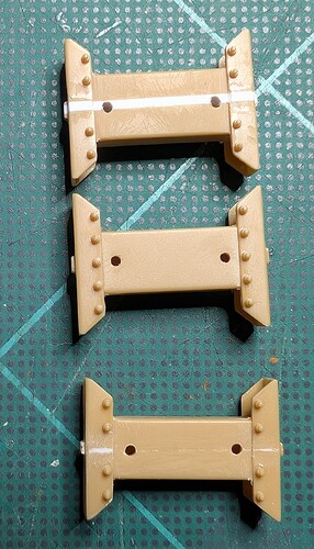

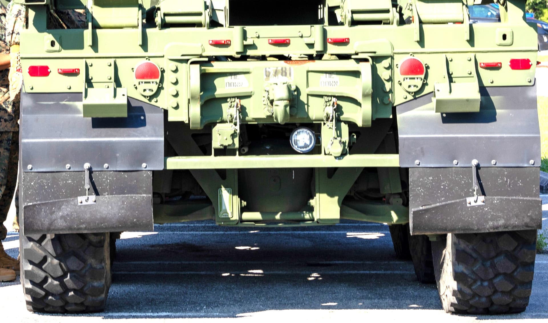

Comparing the kit parts with pictures of the underside of the real LVSR reveals, unfortunately ILK did not do their homework properly. There are significant differences between the chassis frame of the real LVSR MKR18 and what you get in the kit. The chassis frame errors are in two places. The C-section beams of the chassis frame are connected to each other with among others three H-shaped square tube beams, which on the real LVSR are situated between the second and the third axle. In the kit the third of the three H-shaped beams is situated between third and the fourth axle, which is wrong, at least on the MKR18 variant.
Furthermore, in the kit these three H-shaped beams have the same width, but in real life, all three beams have a different width, see pictures below.

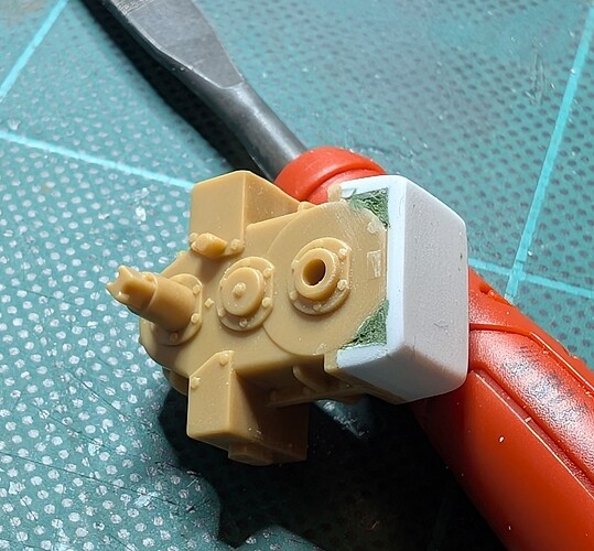

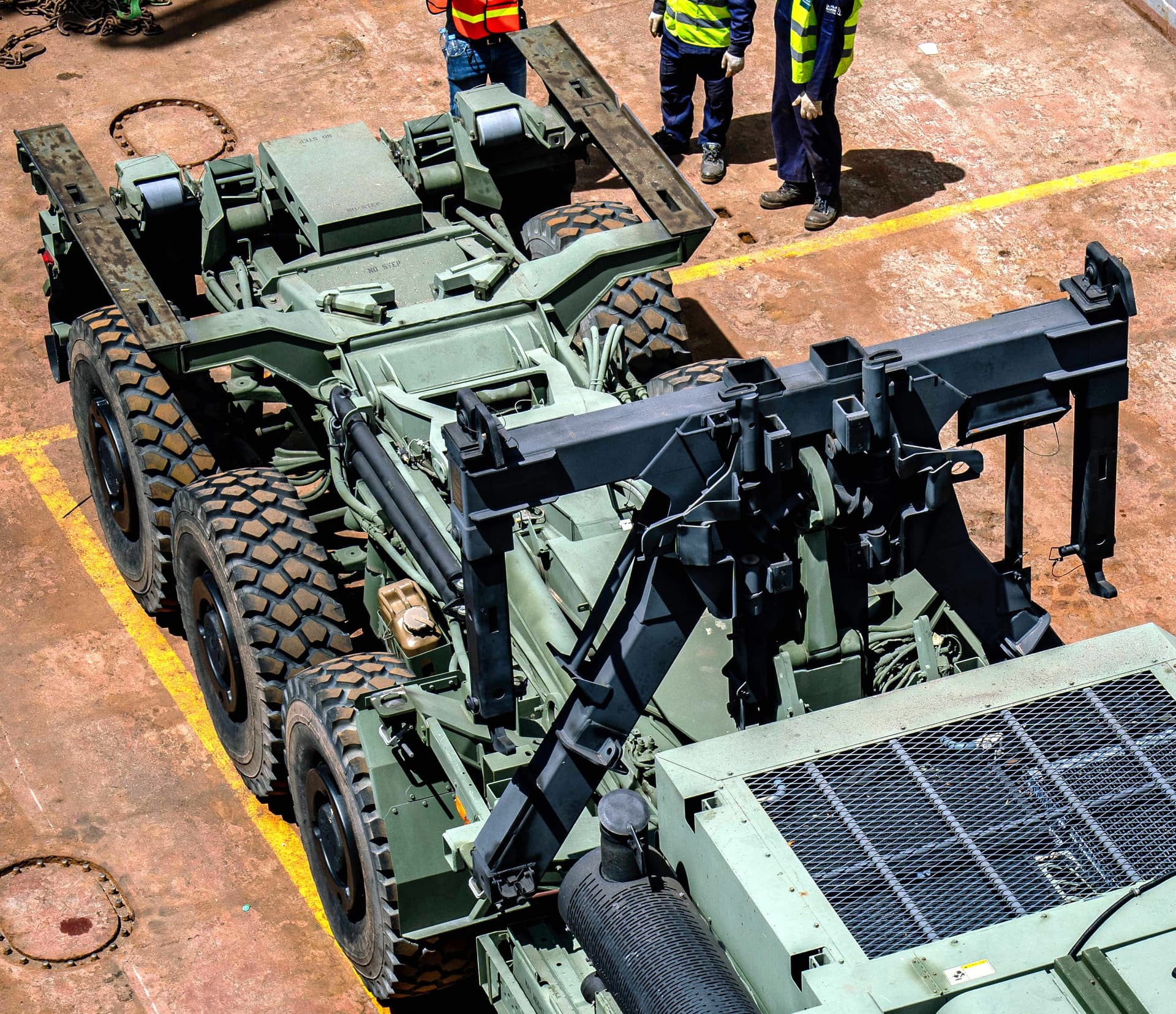

Also, the transmission part is wrong. It should have a flat bottom unlike what the kit gives us. I made a quick modification of the part. It is not a 100 % accurate, but better than the kit part.
In this picture, you can see the completed chassis frame with two of the TAK-4 suspension units. I have managed to keep the chassis frame straight from the front to the last of the three H-shaped beams. From there, the chassis frame is beginning to bend a bit. I hope, I can straighten the rest of the chassis frame, when I add the Load Handling mechanism.
Summing up having built what you see in the pictures:
Generally speaking, the ILK kit is a nice, well detailed and fairly accurate representation of the Oshkosh LVSR (Logistics Vehicle System Replacement) MKR18 Cargo truck. Minor errors exist in the kit, some of which will only be seen, if you place the completed model on a mirror. The casting of the plastic parts in OK, but not as well done, as what for instance AFV Club or MENG provide. If you know the AFV Club Stryker or M60 kits, you know, what I mean.
If you wonder, why I bother about the appearance of the parts in the chassis frame and in suspension units, which will not be easy to see, when the model is completed, then my intension is to place the completed model on a mirror, so these fine details indeed will be visible.

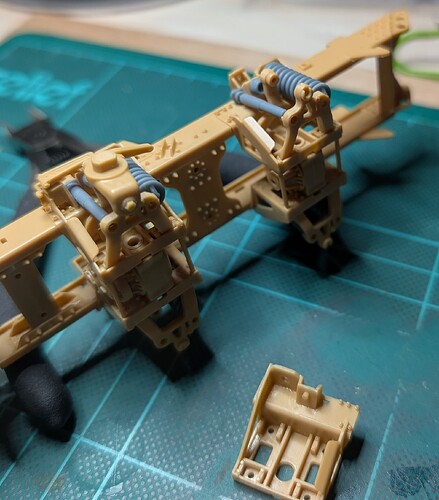

The TAK-4® family of independent suspensions are complex mechanisms. There are 15 - 17 pieces per unit on the LVSR and ten units in total.
The cylinder spring and damper from EMP3D are very nice, and they will save you cleanup time, especially on the cylinder spring.
Back again with the past weeks progress. All ten TAK-4 suspension units are now completed and mounted on the chassis frame. Unfortunately ILK again disappoints with inaccurate and faulty parts. Generally the rear three suspension units are wrong. Only some of the parts resemble the real deal, as the photos show. My guess is, ILK looked at the forward suspension units and assumed, all ten unit are similar, which they are not.
However, as these suspension units are covered by the wheels and the 20’ ISO container, I have chosen not to correct them. Rather, I will spend time time on the more visible parts of the LVSR, for instance the MCTAGS turret and the framework for the DUKE antennas, which I will have to scratchbuild.
Current needs, if you have them, please share :slight_smile:

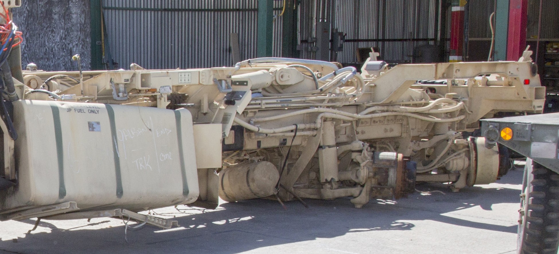

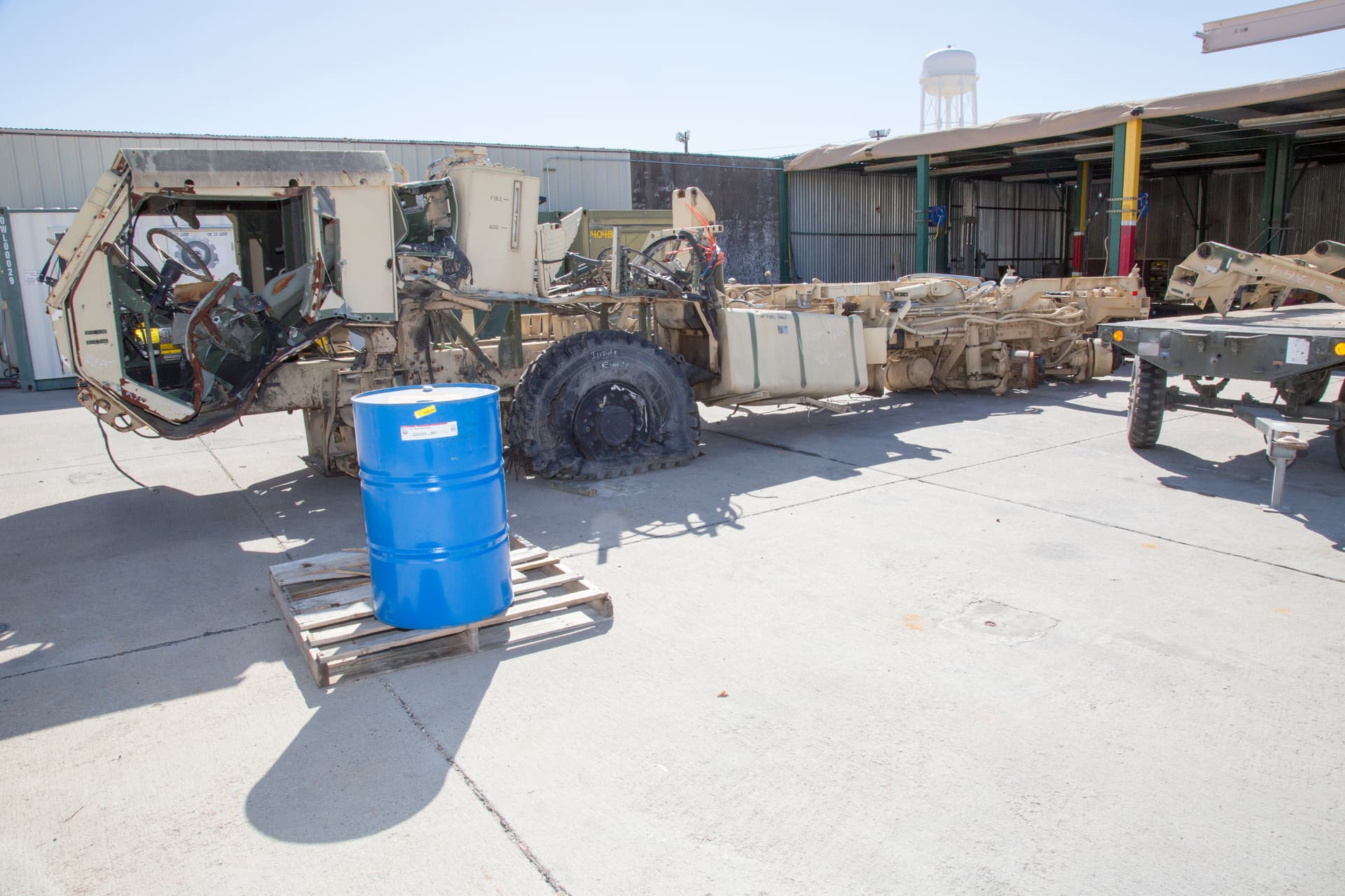

A detail view of the last suspension units. In the picture above of the damaged vehicle, you can see the last two suspension units (the center unit is missing). In the ILK kit all suspension units have a spring facing the front of the vehicle. In real life, the spring is inside a tube, and on the last suspension unit, the spring is placed behind the part to which the wheel is attached, not in front as on the eight other suspension units.
Clearly I Love Kit did not do their homework in this matter.

Having looked at the few pictures I have of the suspension units, I think, it it reasonable to assume the last two suspension units have indeed been switched around. The other suspension units have part F13 in front and part E13 to the rear of each suspension unit. However, from the photo of the green LVSR below, it is clear, part F13 is indeed facing rearwards.
Regarding the actual cylinders, the best picture is the one of the damaged vehicle. The view from above also gives some details.

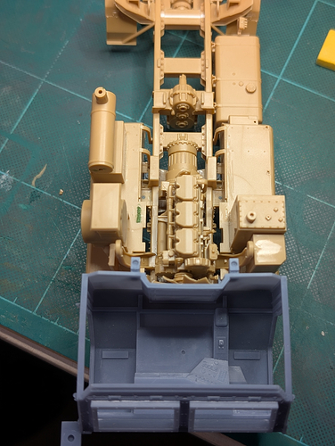

But progres has been made. The sponsons next to the engine are nearly finished, and here it should be noticed that parts T14 and T15 should be exchanged, so T14 is used with S20 and the other way around. If you use T14/T15 as per the instruction, the detail in the part will turn inwards towards the engine, rather than being visible from the outside. Also a lot of ugly ejector markings will be visible. So make sure to use them in the right place.

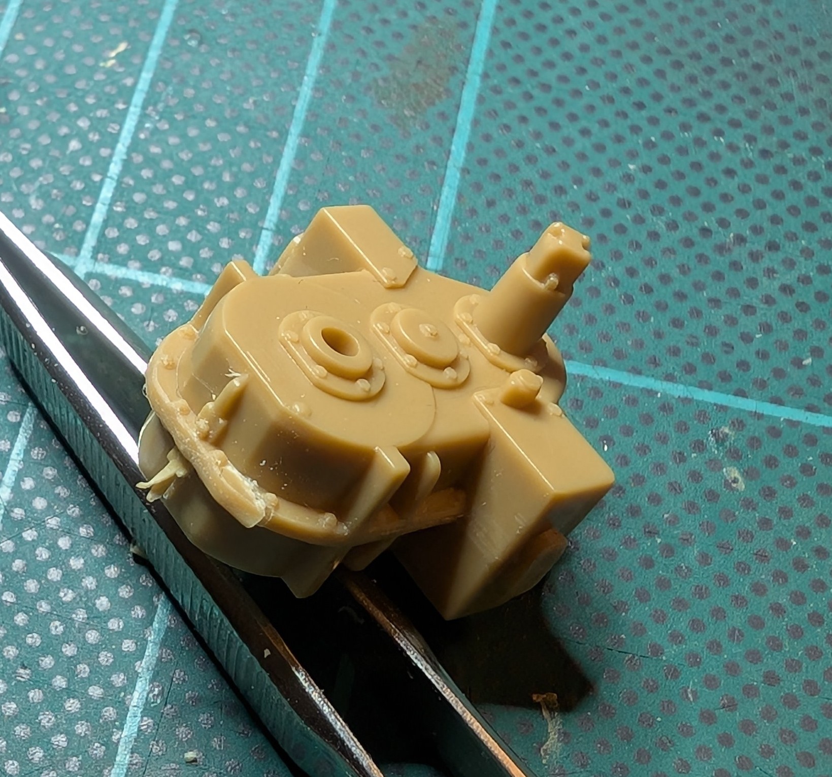

The engine is a small model in itself and despite being not entirely accurate, very little of the engine can be seen, when the engine hood is in place, so it does not bother me. If it bothers you, a corrected engine is available here: Small Designer LVSR engine Unfortunately the transfer case in this kit is not as it should be, see picture of the LVSR from below.
The drivers cabin in the picture is also from Small Designer/3D Wild.
Small Designer LVSR armoured cabin
