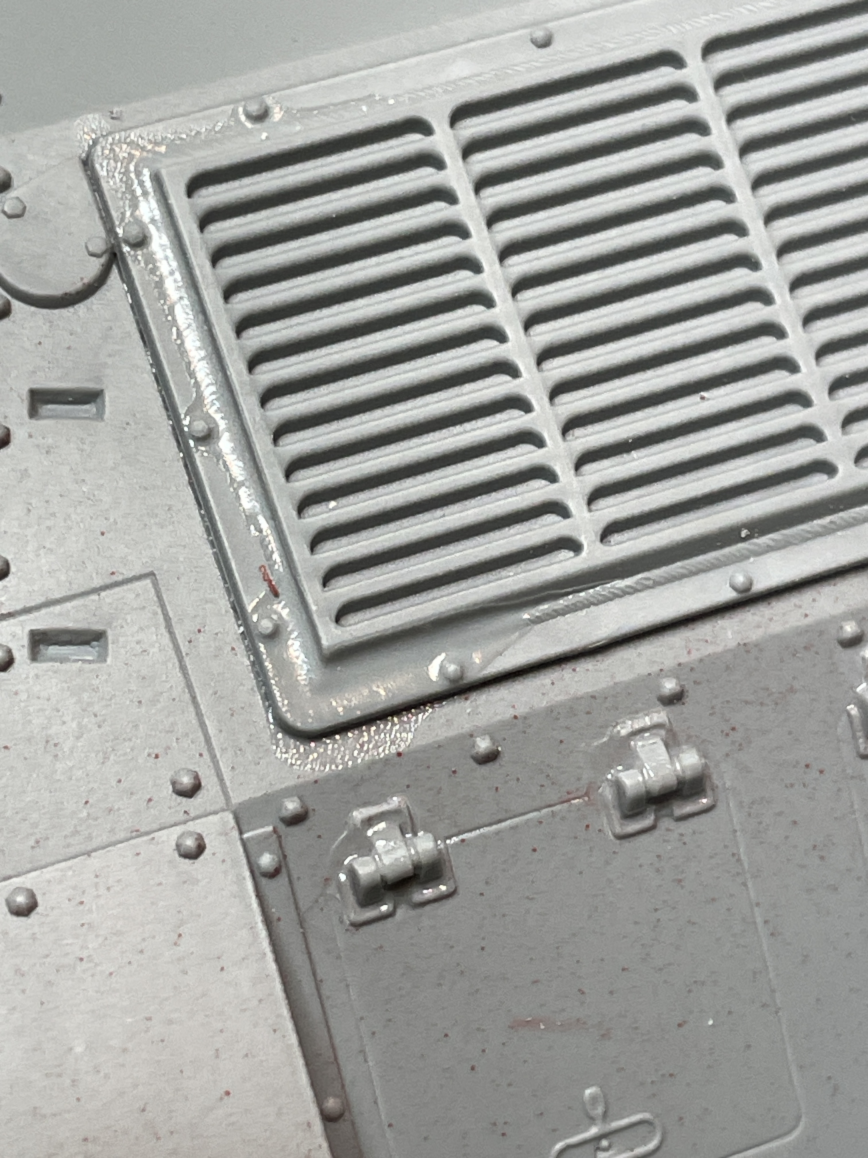

Another item of note is that the plastic is quite soft, and although the details are good and crisp the will melt away if you use too much glue. I found this out on the rear engine grill when I spilled a little too much extra thin on it.
