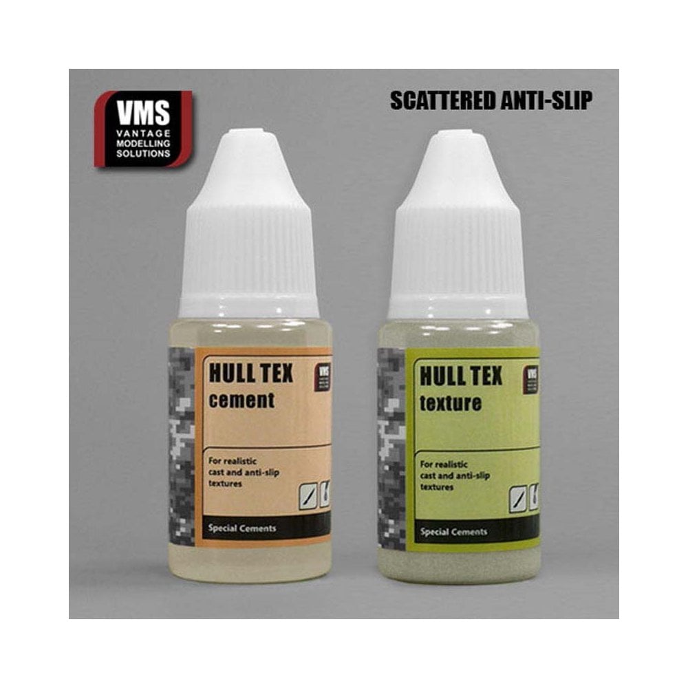

This is the stuff I use.

I would recommend anti-slip from MIg Jimenez, I have it and I tried it and it is excellent, it comes in several colors, Black, Sand and Brown
