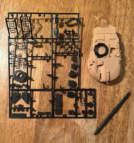

Let me check my stash, I might have an old Tamiya Chieftain turret since I built my Chieftain from an Accurate Armor conversion set several years ago. It isn’t a Stillbrew version obviously.
Some ERA is a possibility, but I may want this thing to be pre-1982. The turret I got from Robert has Stillbrew armor so I will want to integrate whatever additional armor I do with that, unless I end up using a different turret…
