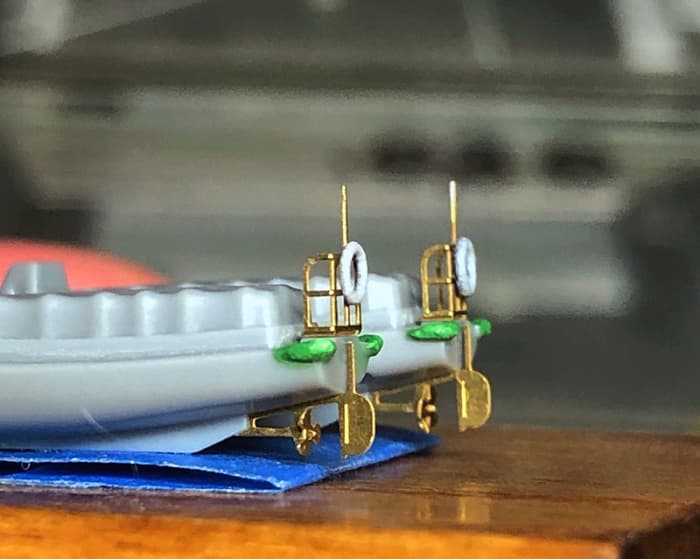

Tamiya’s 7.5 meter motor launches are nicely done with accurate shapes and good detail – but they can still be improved!
Here I’ve plumped up the kit bumpers with putty and added the etched brass details from the Infini set.
The brass fittings are quite small, but these kit-specific parts fit perfectly!
The Infini set comes with life rings as well, but the etched parts are a bit two-dimensional. Test fitted here are a couple of different resin rings: a slender one from North Star Models and a more substantial rendition by Blue Fatty Models. Each looks good, but the Blue Fatty ring on the right is (to my eye at least) slightly more convincing, so I’ll probably go with those.

Thanks John. Those small PE bits are a snap with my (home modified) high-tech Dollar Store glasses!

The Blue Fatty life ring looks certainly more like what you’d expect a (todays) life ring to look like, but I have no idea about the proportions those from the IJN at the time.
With the attention to detail you even put into those motor launches, one could remark that with that zero pitch on your propellers you aren’t going anywhere
but again I’d never say that

Well, ok, maybe you caught me breaking my no scratchbuilding rule…
but those teeny little side scuttles hardly qualify, do they…? ![]()
As for the boat props, I did put a little pitch in … but you are right - I should have put more!
