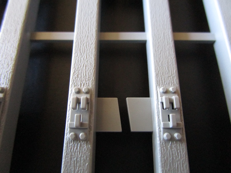

Here are my results measured between the Trumpeter and the Miniart kits pictured.
41mm between, inside rail to inside rail.
The angles of the close up photos tell slightly something else but they both measure 40mm - 81mm, inside to inside.
Miniart
Trumpeter

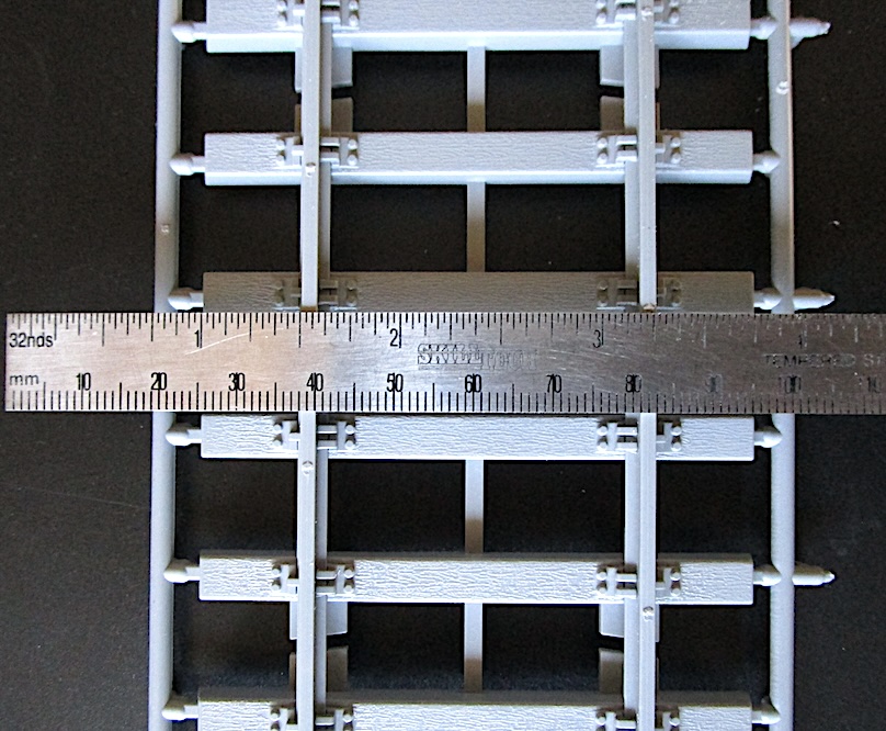

Picked up the Railway Dead End AK35010
The inside of the rails also measure to 41mm
40mm - 81mm :railway_track:
