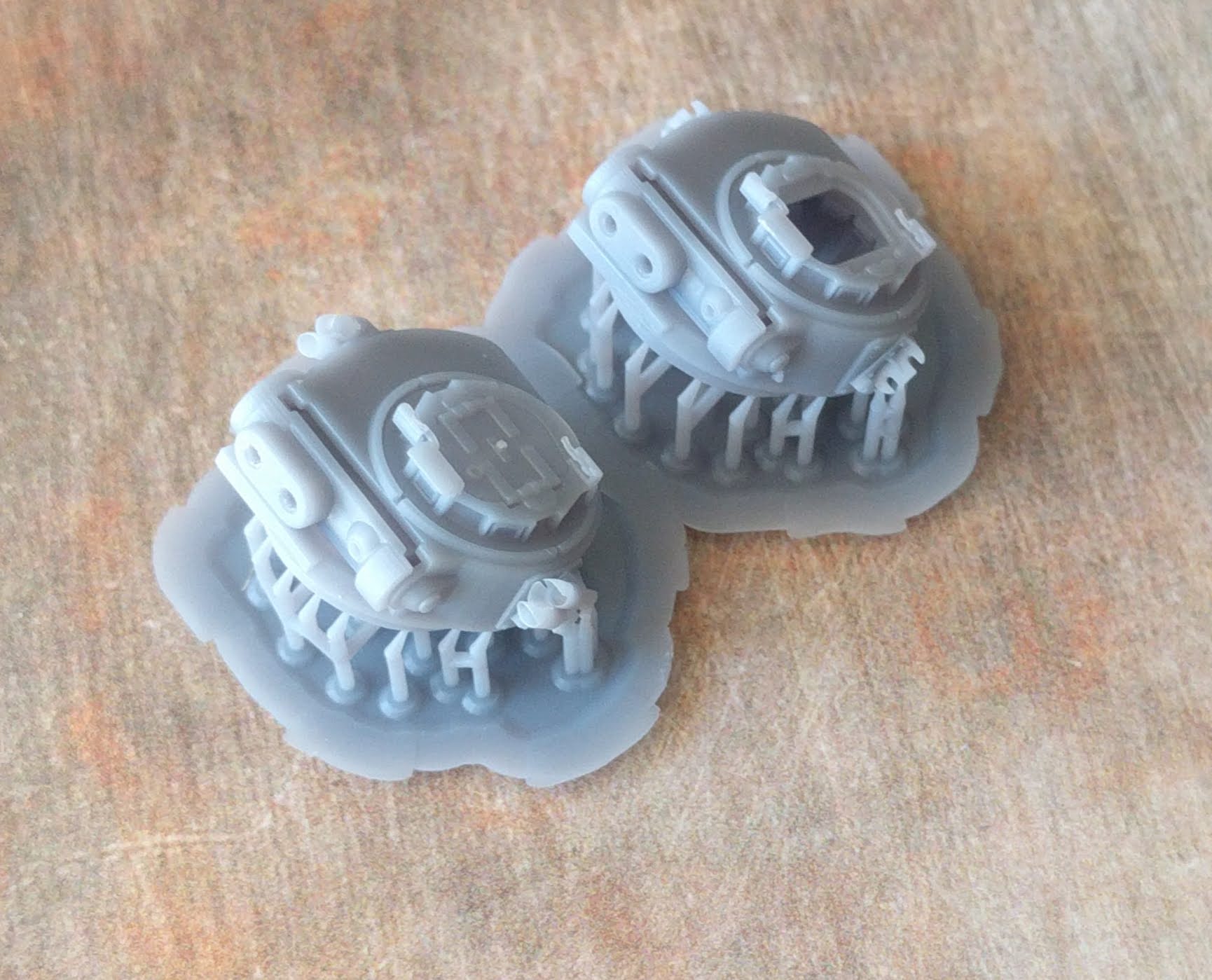

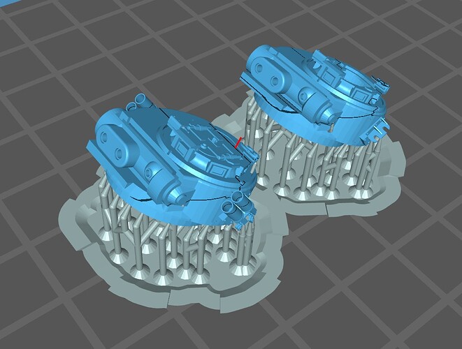

In the meantime, 1/72 turret test.
one with smoke launchers in place, one without, to see which prints best.
lol. yeah, gonna have to thicken up those launchers for '72.

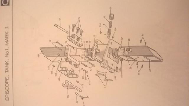

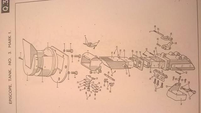

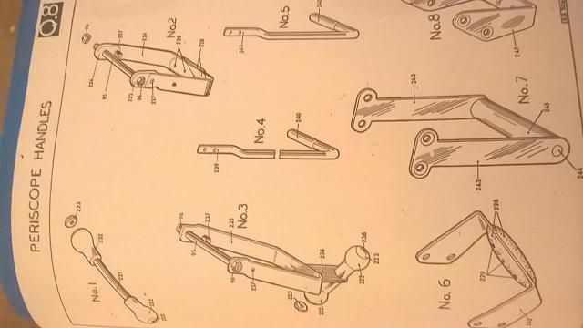

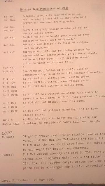

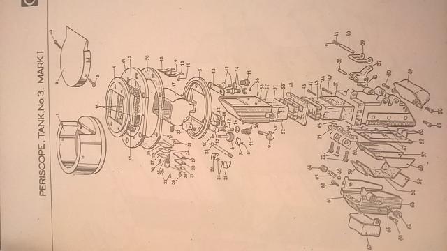

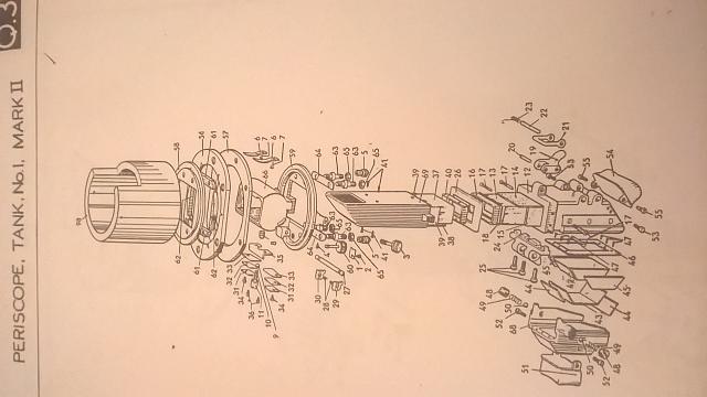

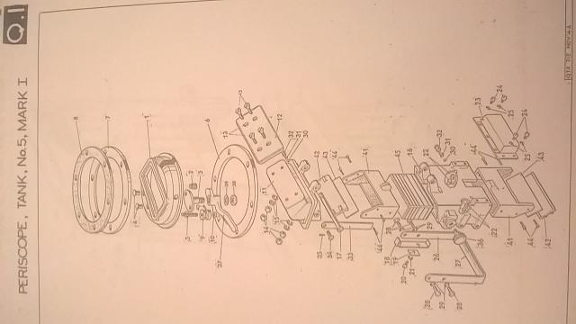

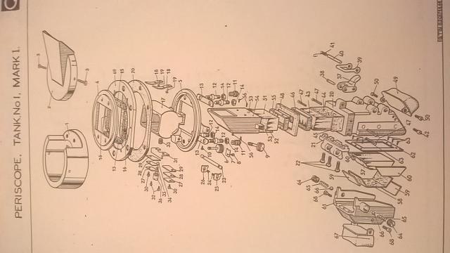

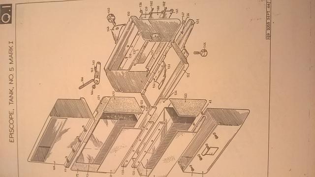

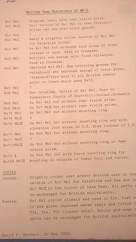

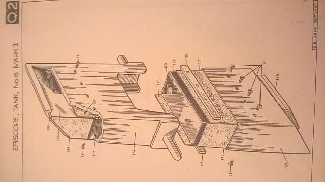

Question for British armour buffs: I’ve been unable to find decent pictures of periscopes that would be typical to the mid/late war period. Just about everything I find contradicts every other. Should they have a wee rectangular hat or not? Also I’m assuming that by this stage most vehicle tools were stowed in the bins? If not, what tools would you normally see?
Hi Mousemuffins
Can’t give you much in the way of an overview, but I happened across these a few years back which might be useful?
Mal
Drawing - Episcope No 1 Mk  1
Drawing - Episcope No 3 MK 1
Drawing - Episcope No 5 Mk 1
Drawing - Episcope No 6 Mk 1
Drawing - Periscope Handles 1-8
And some more
Drawing - Periscope No 1 Mk I
Drawing - Periscope No 1 Mk II
Drawing - Periscope No 3 Mk 1
Drawing - Periscope No 4 Mk 1
Drawing - Periscope No 5 Mk 1
There are a few more, but look pretty similar to me. Yell if you want them.
Mal
oh. those are perfect. Look like there WAS some variation in the hood. I think I’ll go with the middle one.

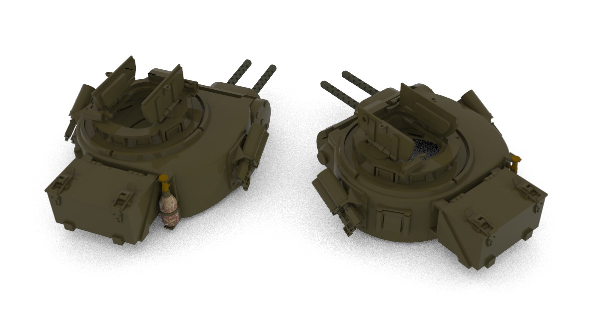

Last couple of turret details.
Pistol port and Fire extinguisher.

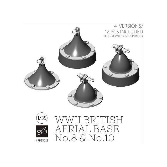

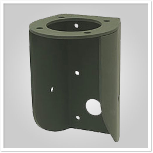

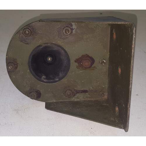

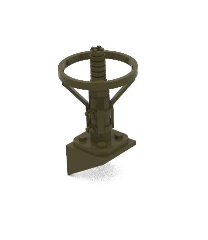

Antenna mounts

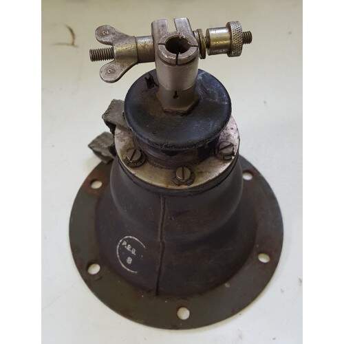

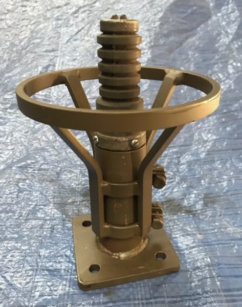

yeah, but what kind of antenna? I know practically zero about british ww2 radios. Need something typical for mid-late war.
This sort of thing? That’s a number 19 I think…
Also, do I need more than one? are receivers a different antenna than for a transmitter?
Edit: no.19 was a transceiver. solves that issue…

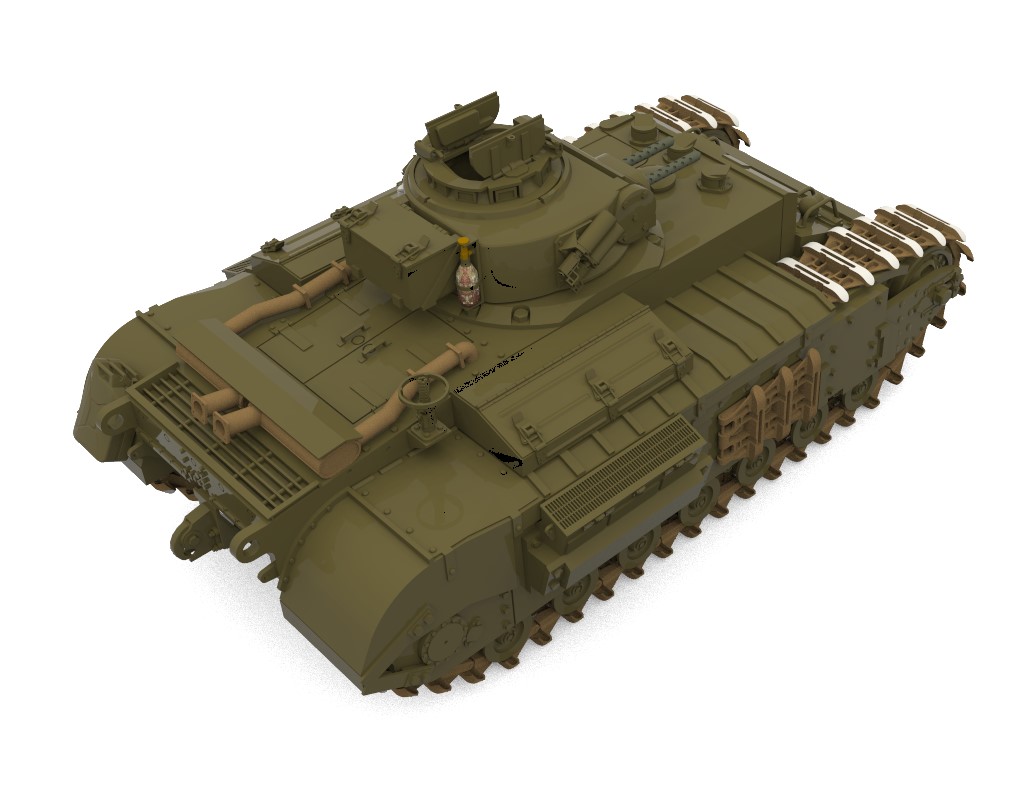

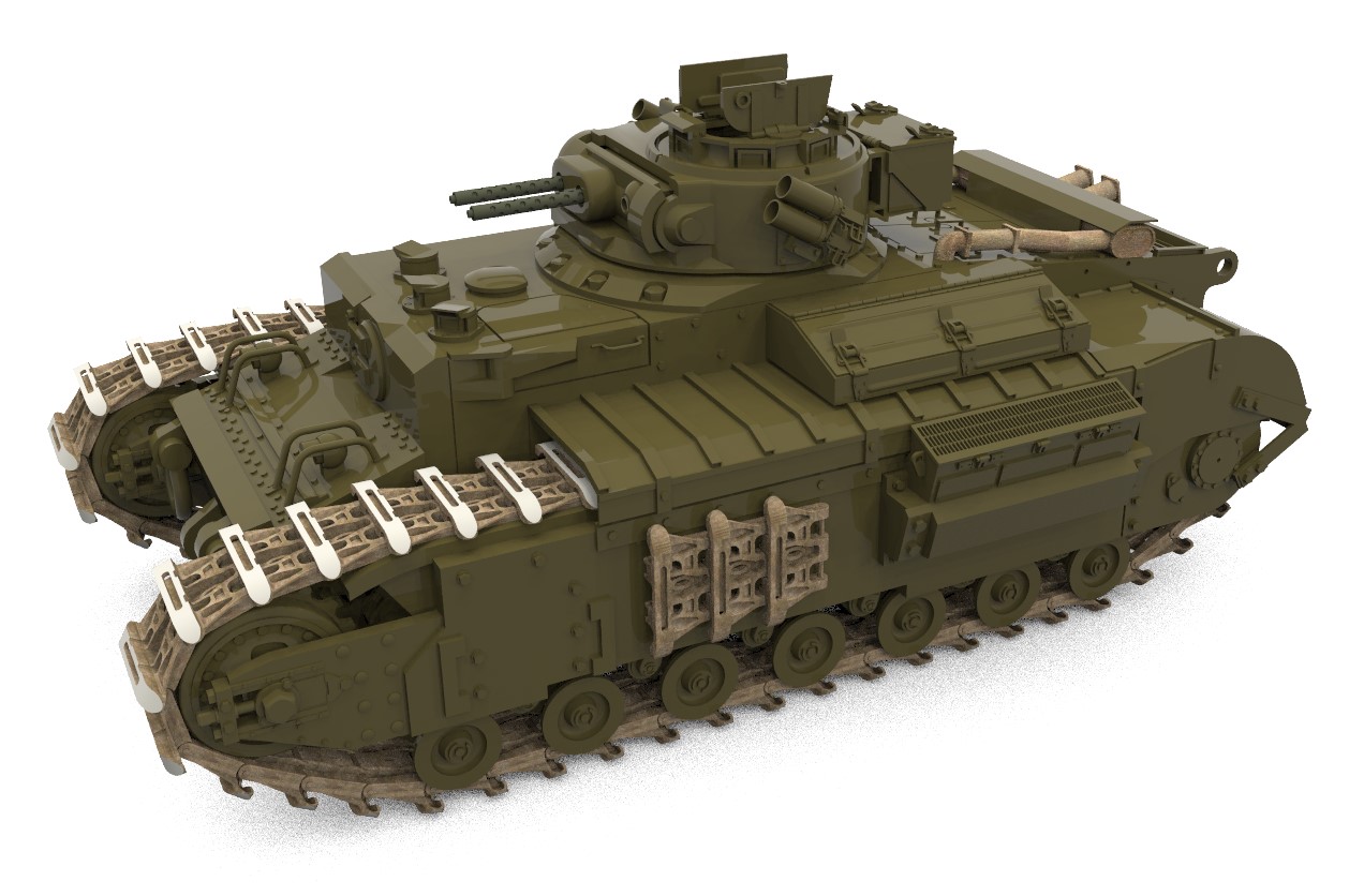

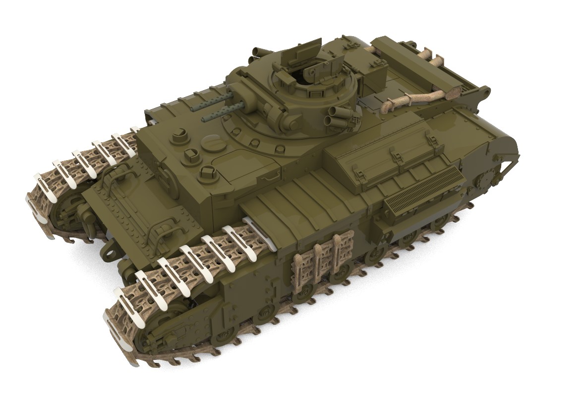

ta dah!
Screenshot 2022-02-08 185207
The exhaust would be glowing cherry red. Would there be a cover to prevent them from being seen at night?
Jerry cans?
Nice antenna.
Didn’t the No.19 set use two antennas? One to send, and one to receive. So one like what you added to the right rear, and a cone-shaped one like Topsmith showed - put it on the left rear.
