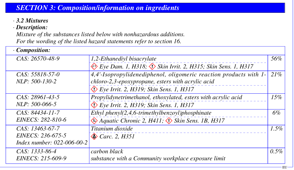

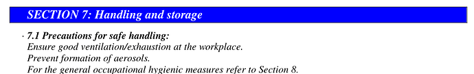

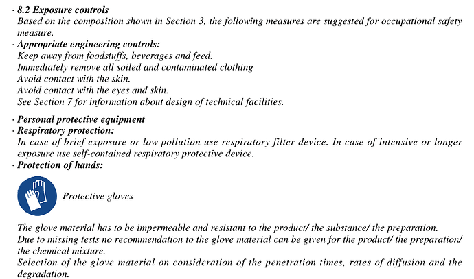

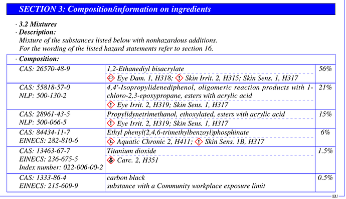

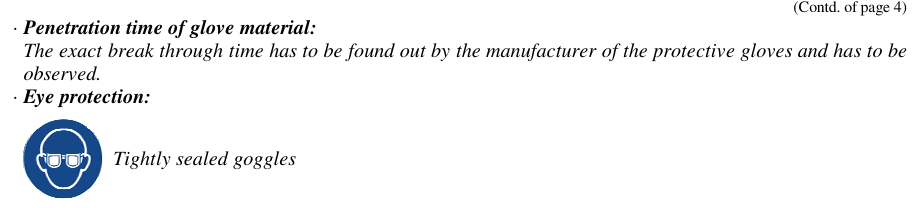

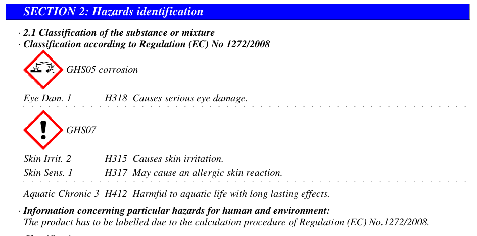

Take a look at Elegoo’s water-washable UV resin’s safety data sheet (SDS): https://download.elegoo.com/04%20LCD%20Printer/12%20Photopolymer%20Resin/Water%20Washable%20Resin/ELEGOO%20Water%20Washable%20Photopolymer%20Resin%20MSDS%20Report-2022.PDF
  • Eye damage, skin irritation, and allergic reaction causing
  • Interestingly, not enough respiratory toxicant
  • Includes titanium dioxide, which is a class 2 carcinogen
    Storage recommendations:
  • Use respiratory protection and rubber gloves when using:
  • SDS even recommends using goggles or some sort of eye protection, which I don’t even use when 3D printing… Hmmm..
Elegoo’s SDS quality is not very good - I work in the chemical industry, so I read this stuff quite often.
