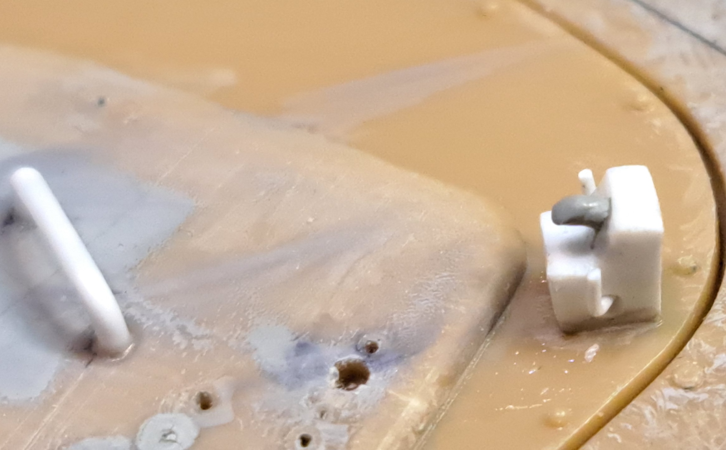

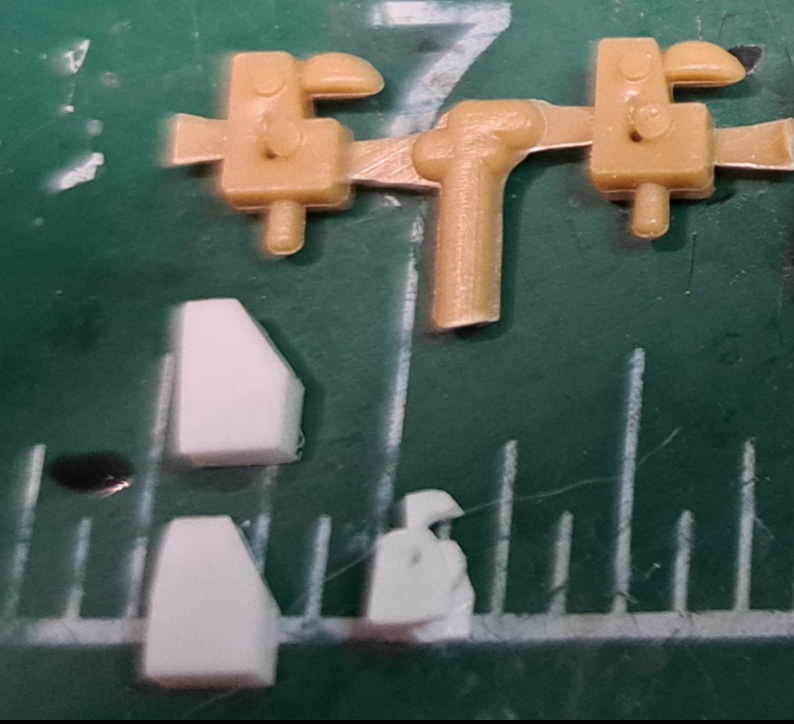

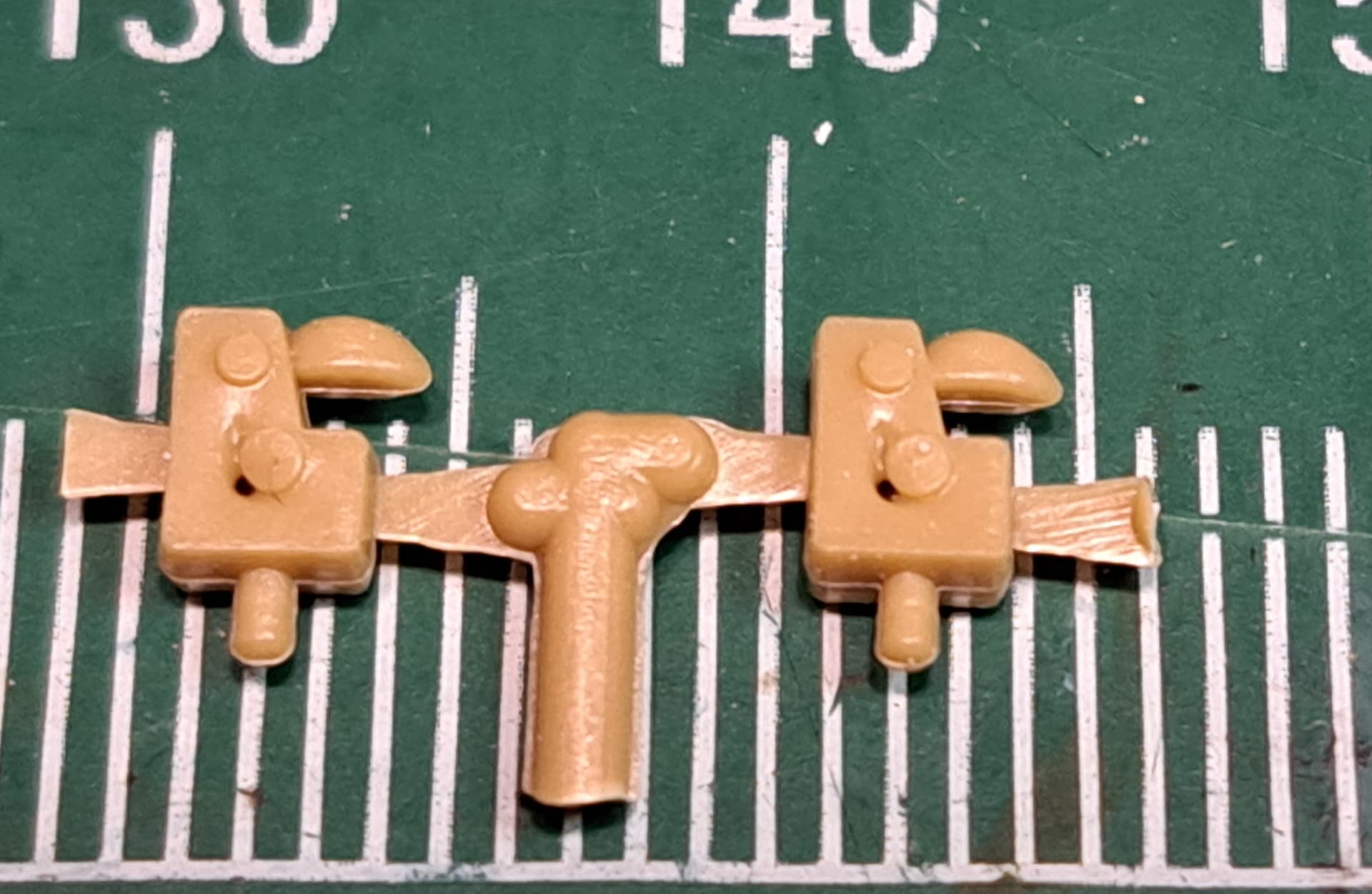

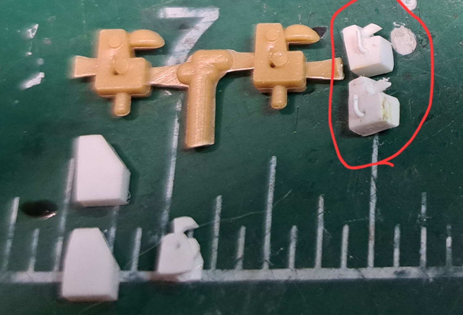

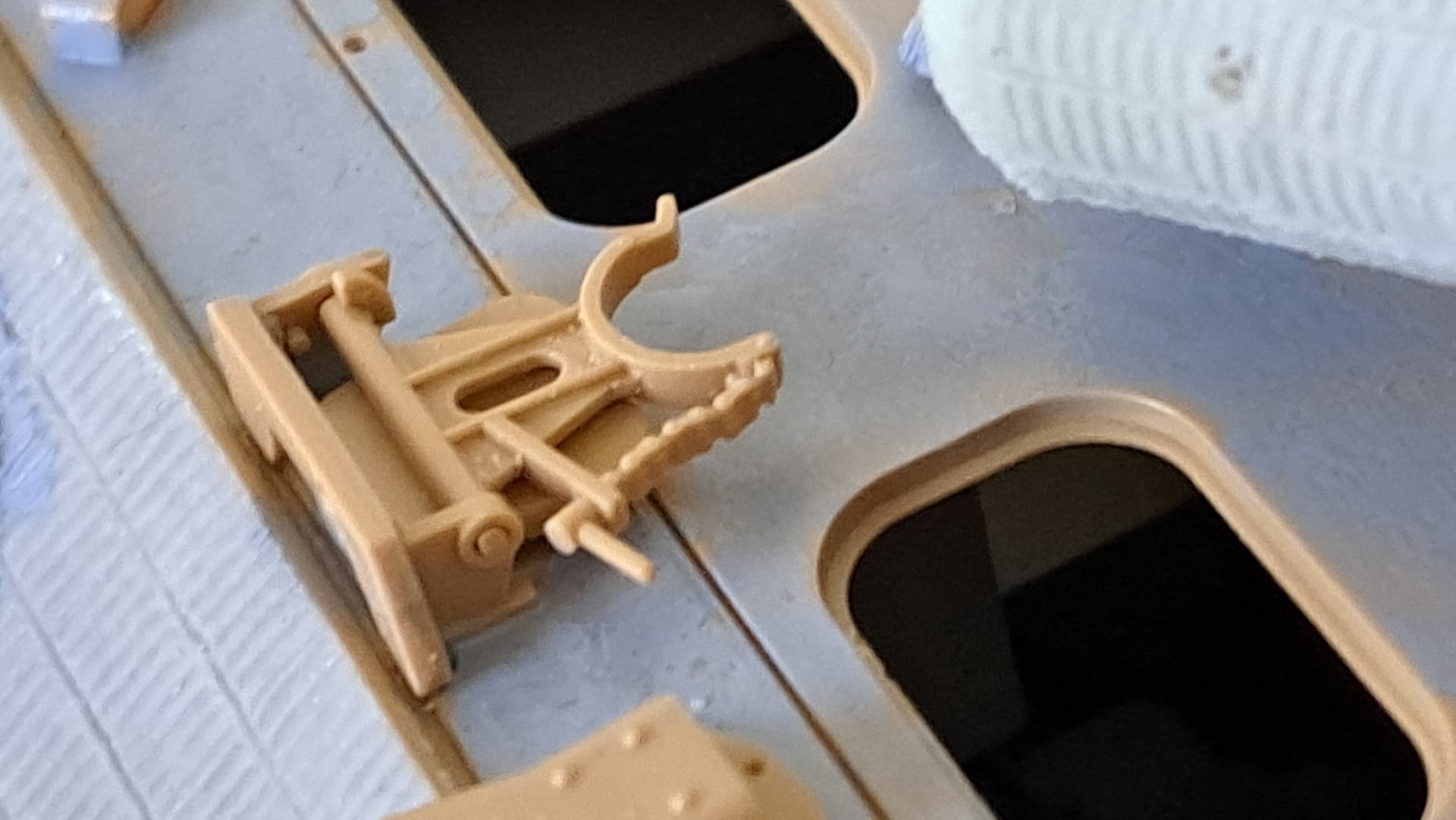

The Hatch Latches
Italeri provides a pair of HL’s.

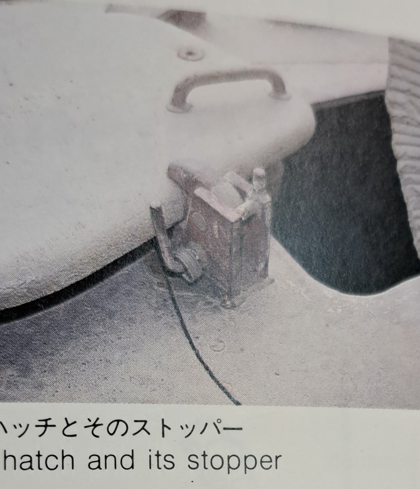

Panzers in Saumur #2 has a nice picture (discussion only) of a Panther A’s HL.
Made multiple attempts at scratch building, some of which are provided below for entertainment purposes.
Eventually, realizing this would take until Christmas
or result in buying a resin kit to copy parts from Meng’s Panther D/A if I didn’t move on.

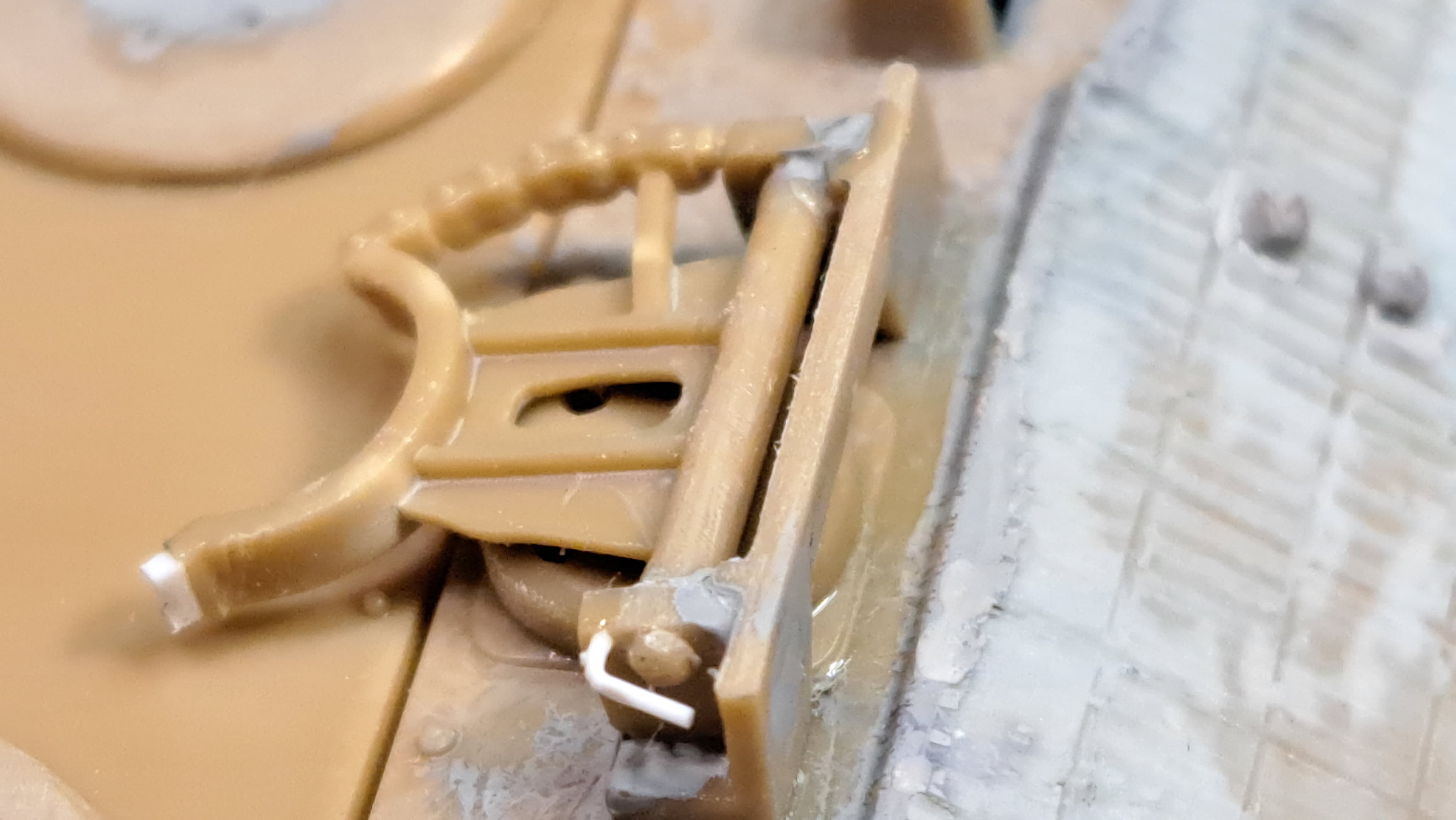

The red parts installed.

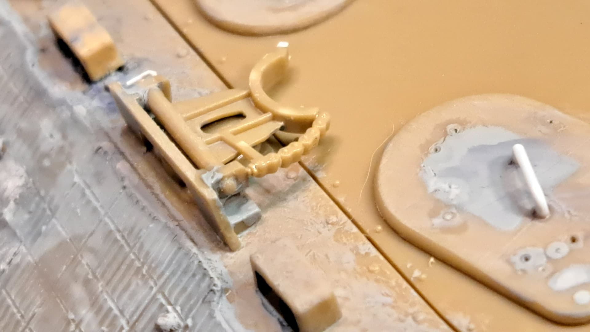

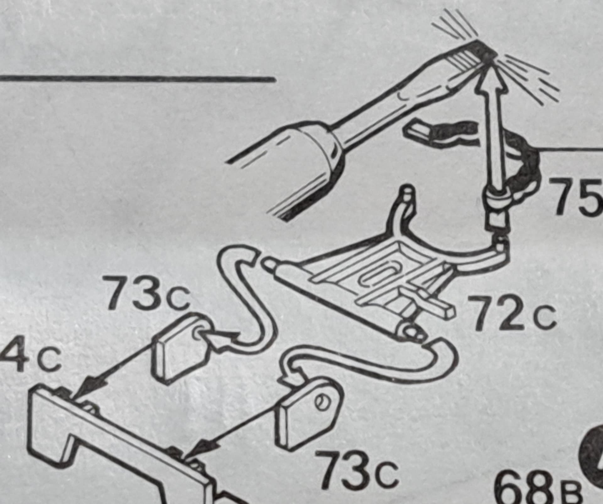

The kit gun travel lock instructions.

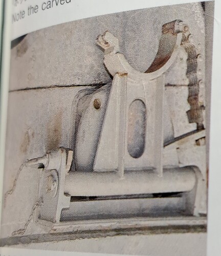

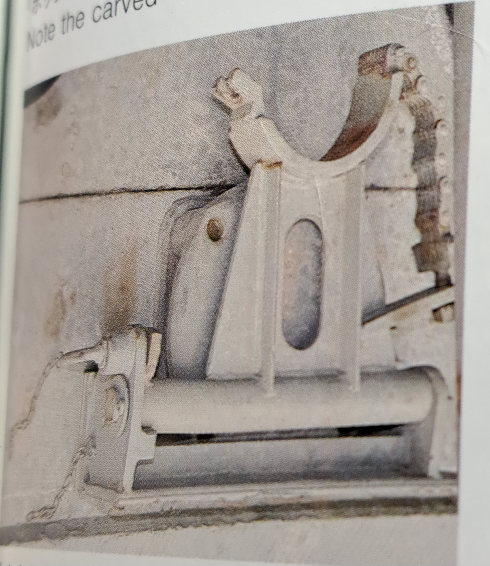

Decided to tweak the GTL based on this picture from Panzers in Saumur #2 (for discussion only).
•straightened chain
•cutting it as shown
•removed a link
•added hex nut to end of chain
•chopped ends off of 72c
•made slot for left side of 72c
•added fiddle bit to left side of 74c
•70b drilled per Samur picture but it’s under the travel lock
While the quality is poor with half a dozen plus sink marks the detail on the GTL is pretty good
. I liked the Italeri chain better than the On The Mark PE chain for the GTL.

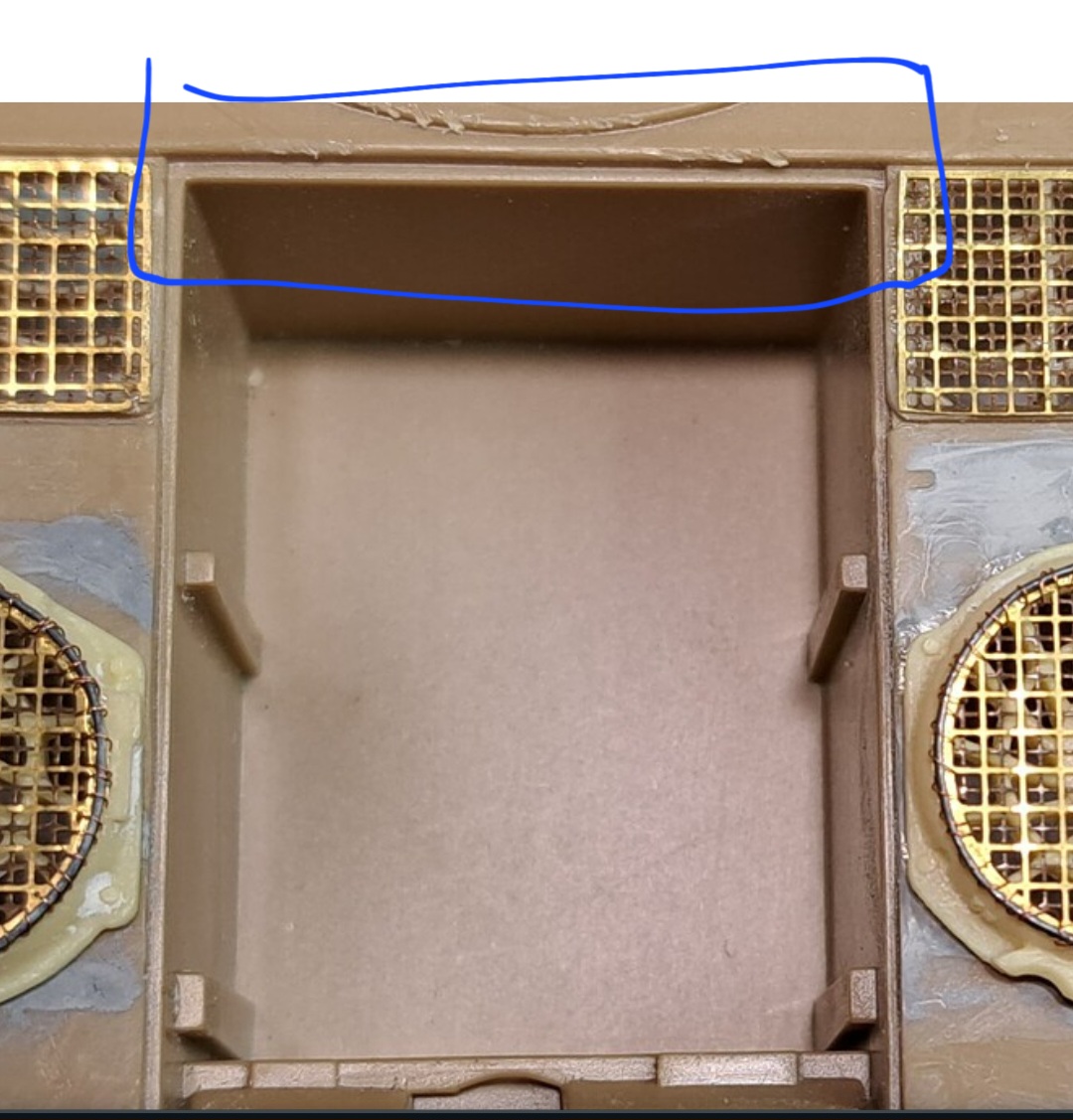

Part 50c is missing!
None of the spare Panther hulls are the correct dimensions. Struck out on Ebay for replacement 50c.

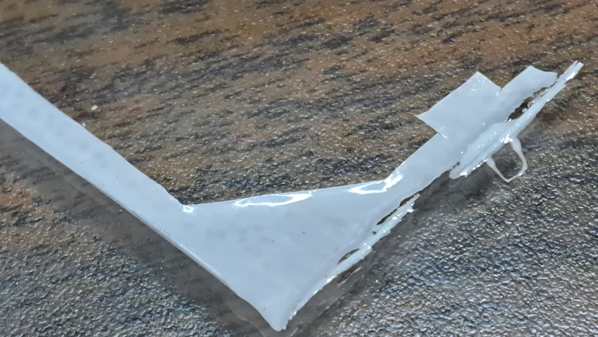

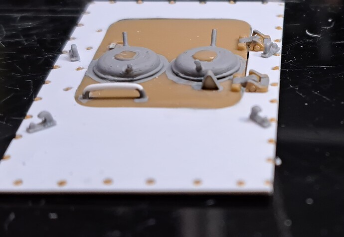

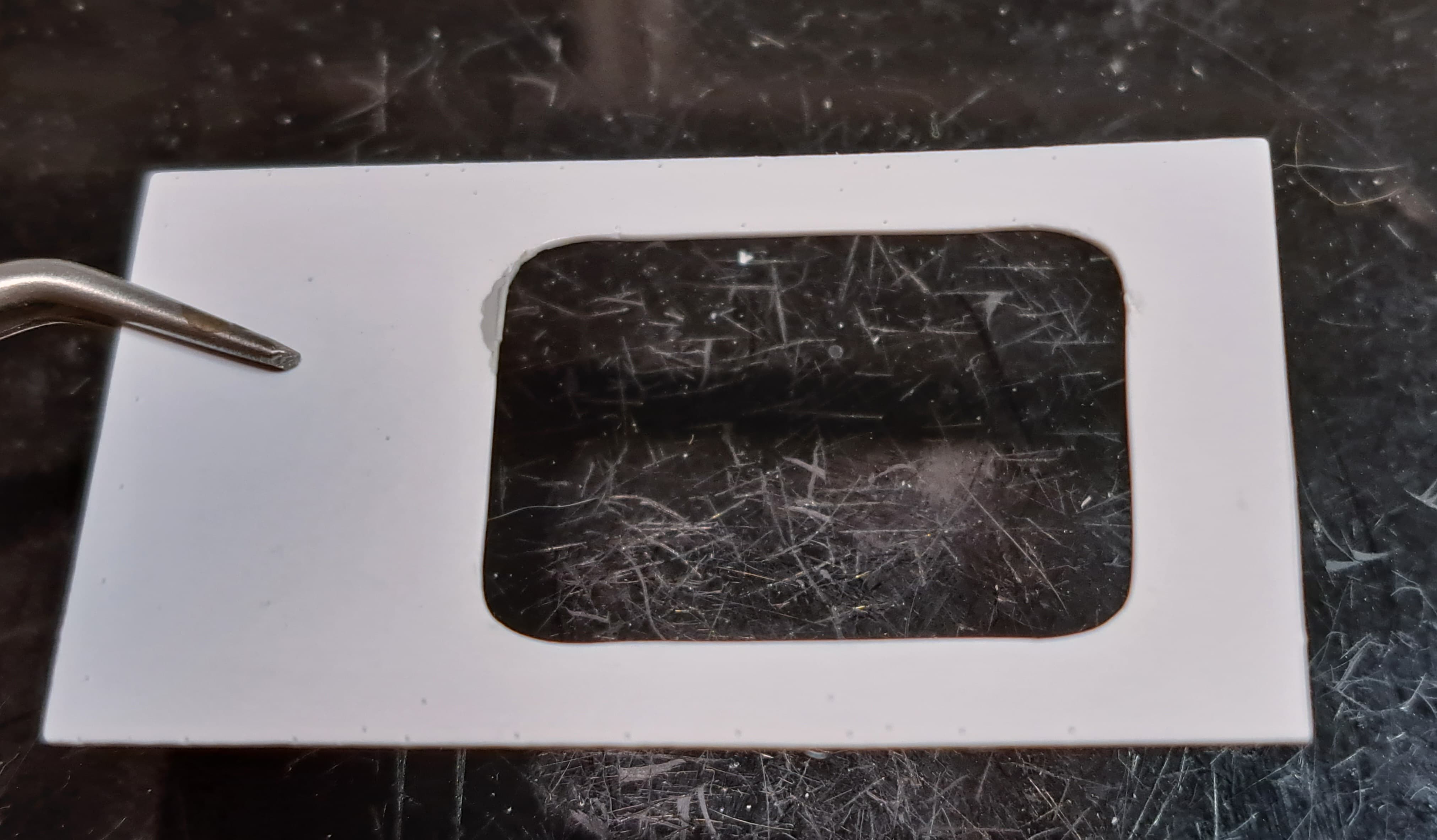

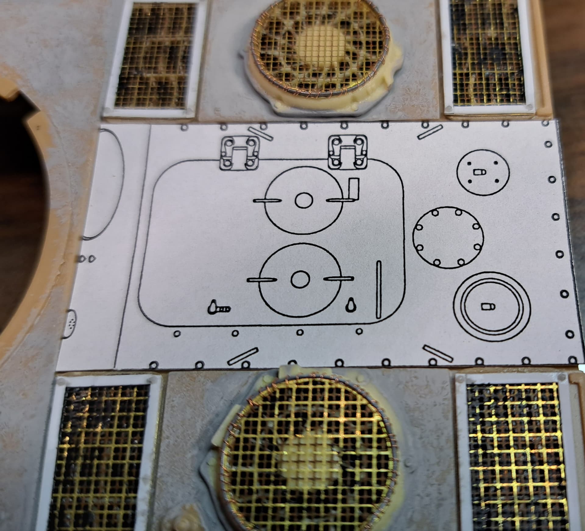

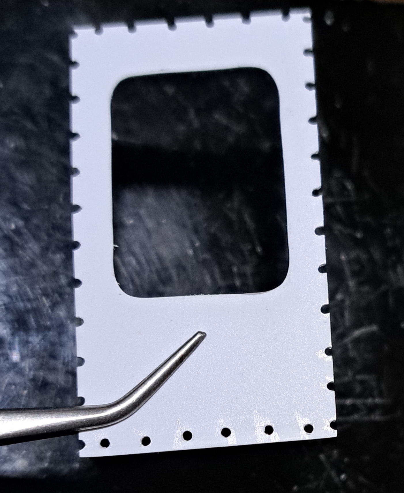

The plan is to use a drawing of an early Panther D’s rear engine deck in Panzer Tracks Panther as a pattern for the new “erstaz” 50c part. However, with the dimensional errors Italeri built into the model’s rear it’s not necessarily cut and paste for the template.
The full scale 1/35 template was both too long and too wide to fit on the Italeri Panther. However, I’d made several copies scale at 100%, 99%, 98%, 97% & 96% with the intention of using the one that fit the Italeri hull best as the pattern for the new part. The 98% pattern fit nearly perfect.
Taped pattern to a sheet of .010 white sheet styrene, marked all detail locations with a sharp pointed divider, then cut it out.
Needs a lot more clean up etc but attempt #1 is under way.

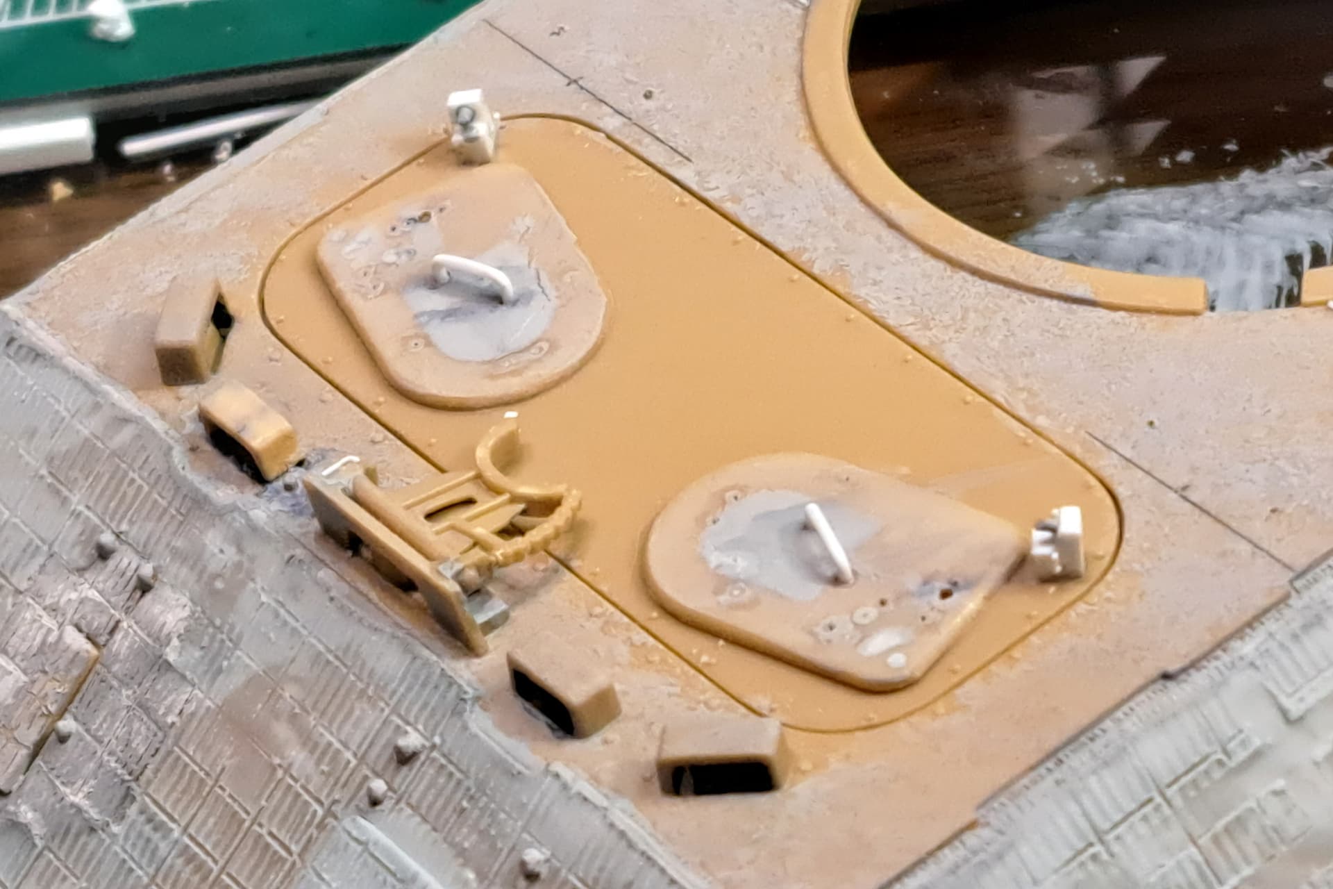

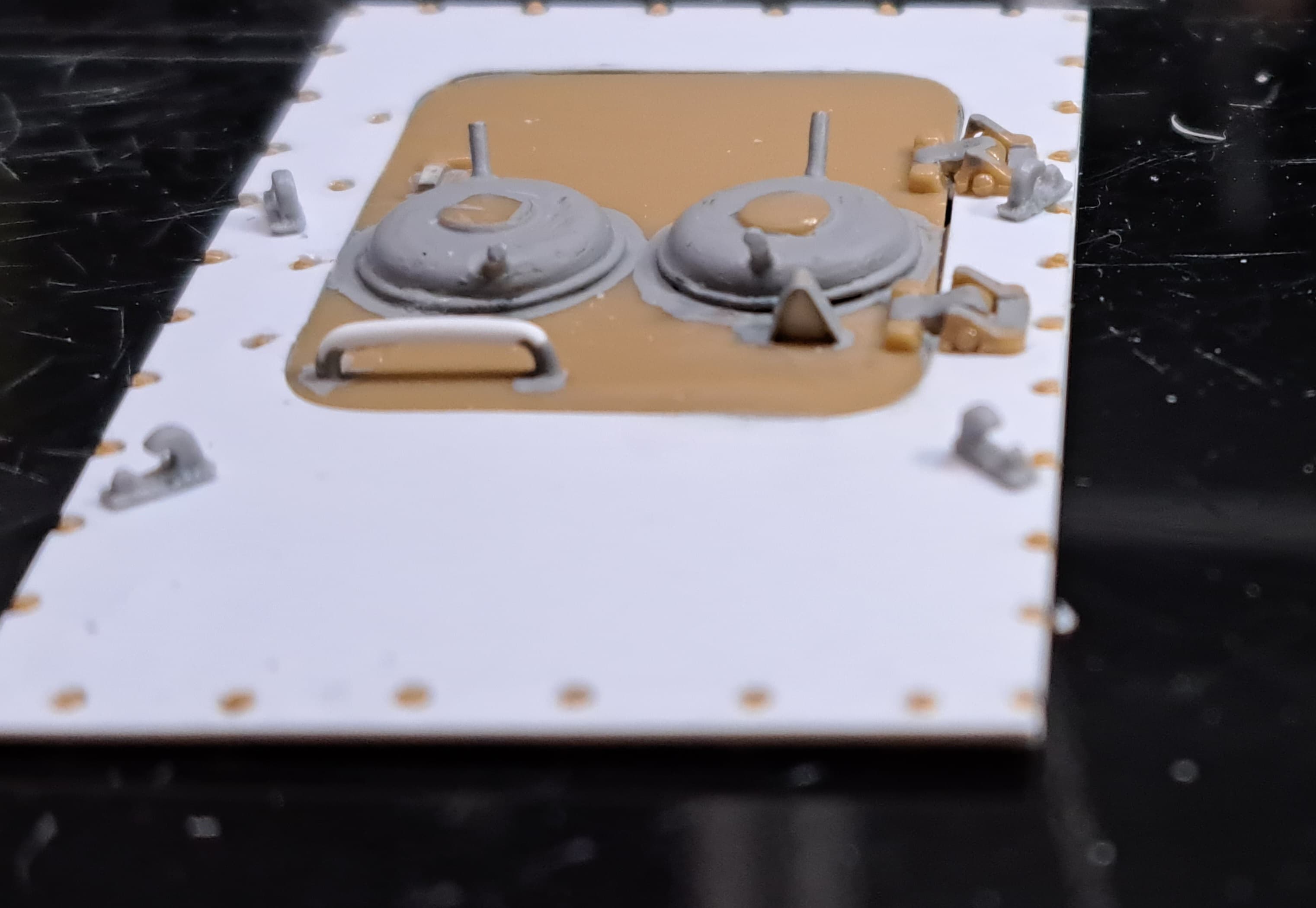

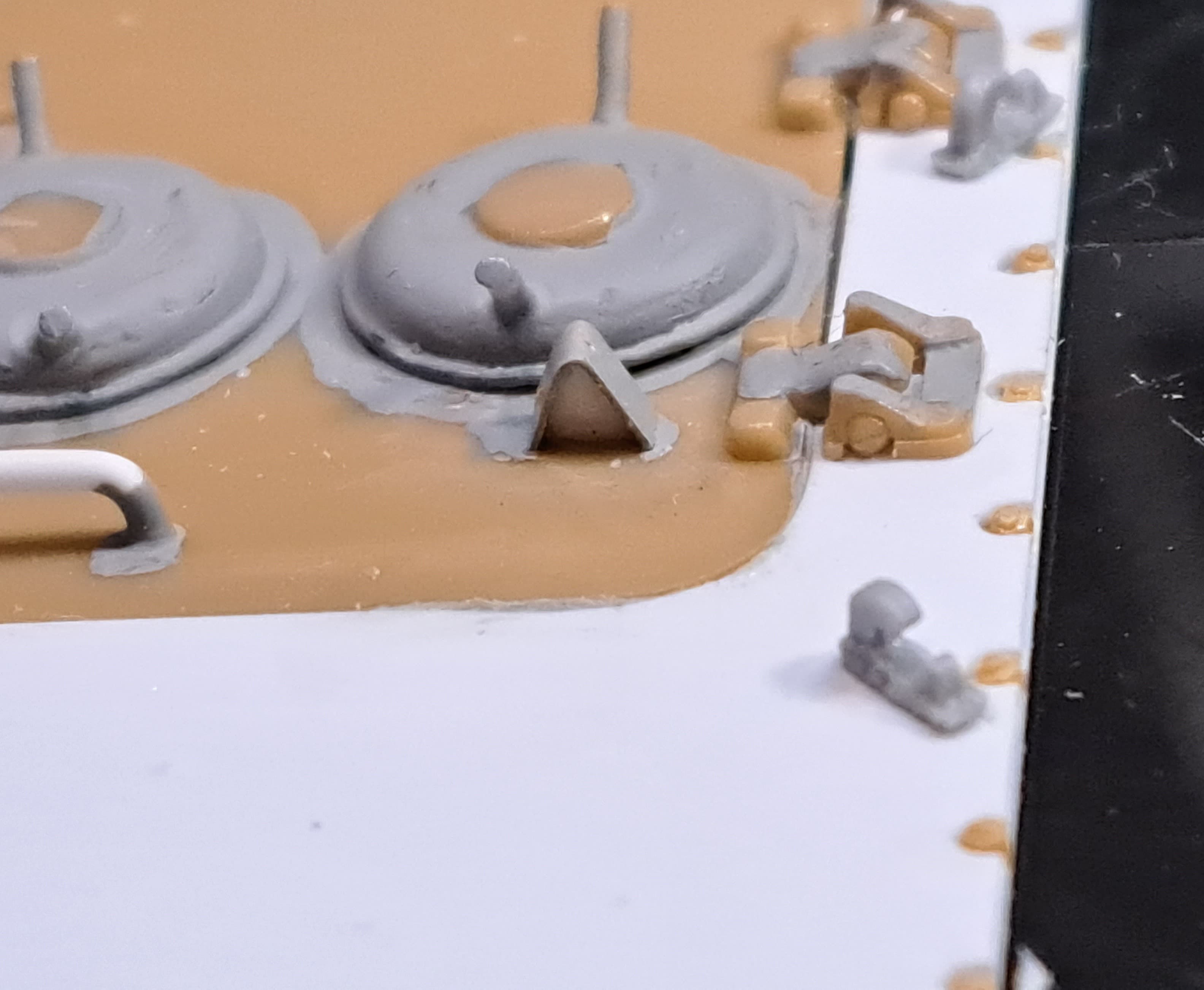

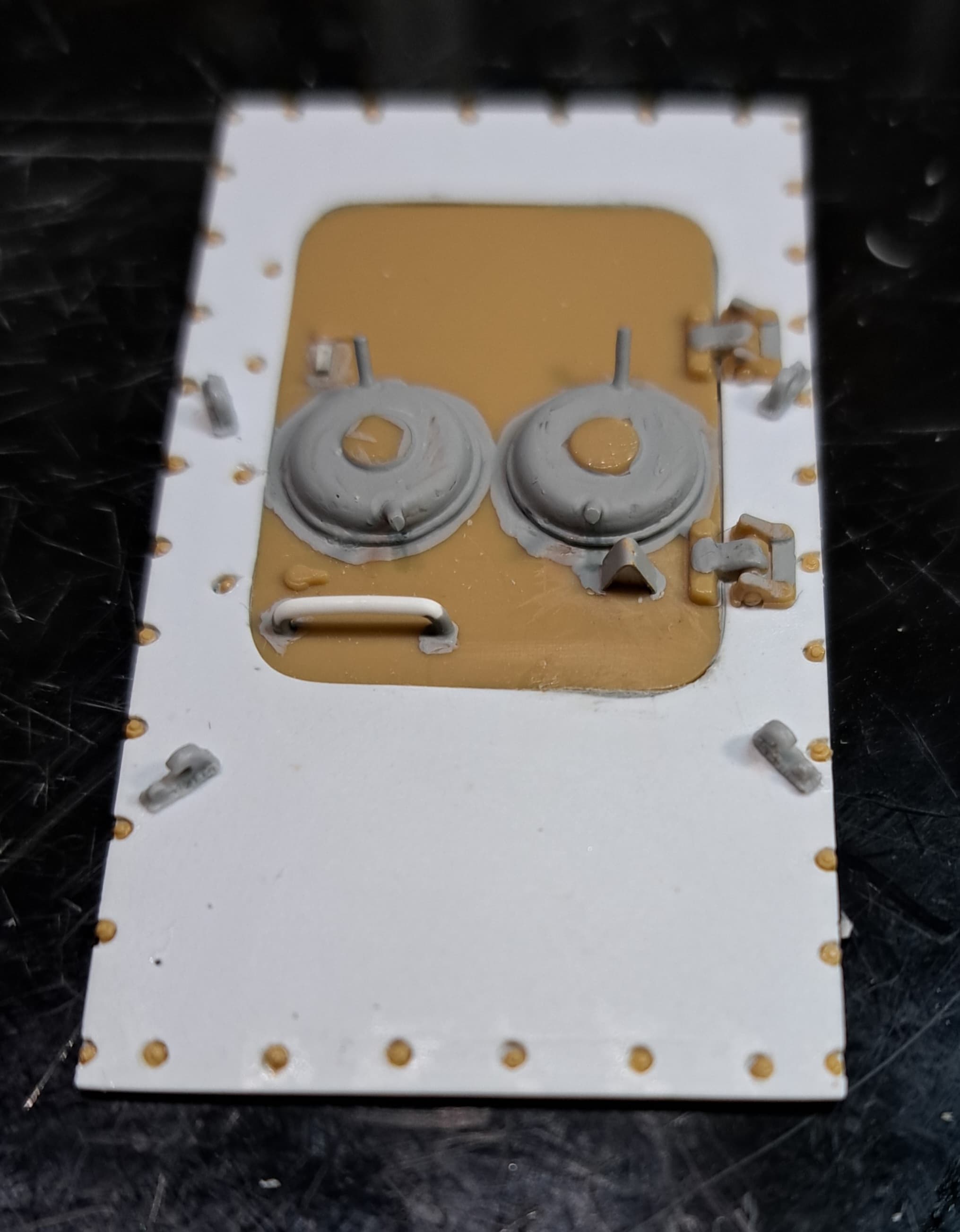

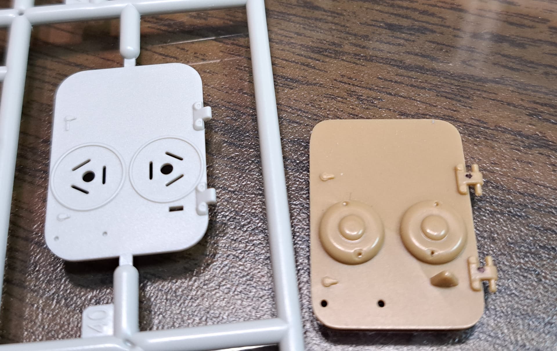

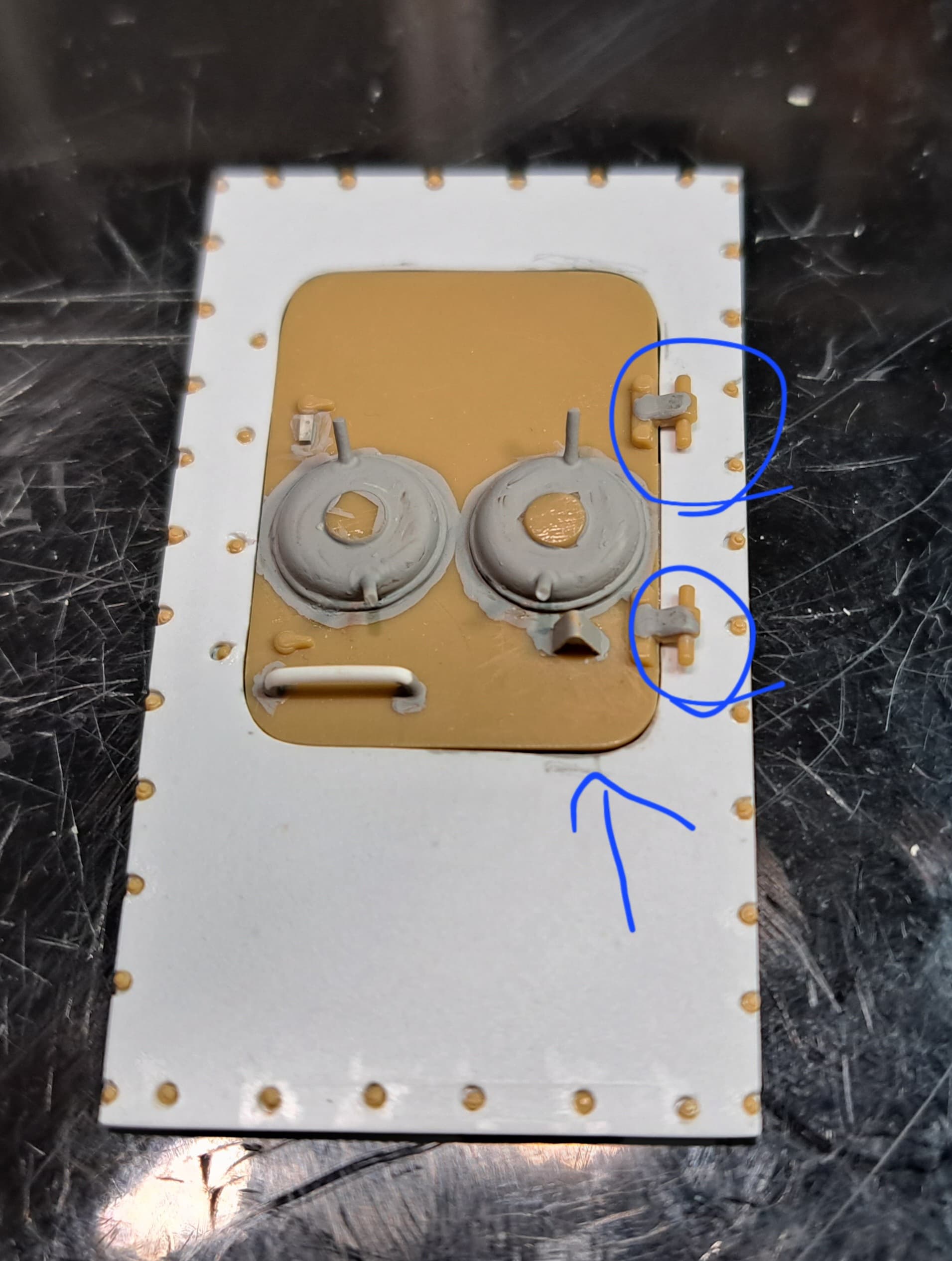

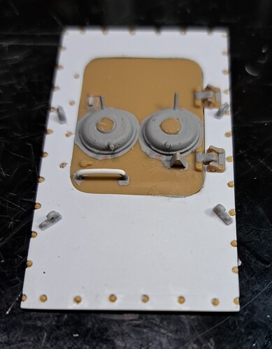

The hatch test fitted.

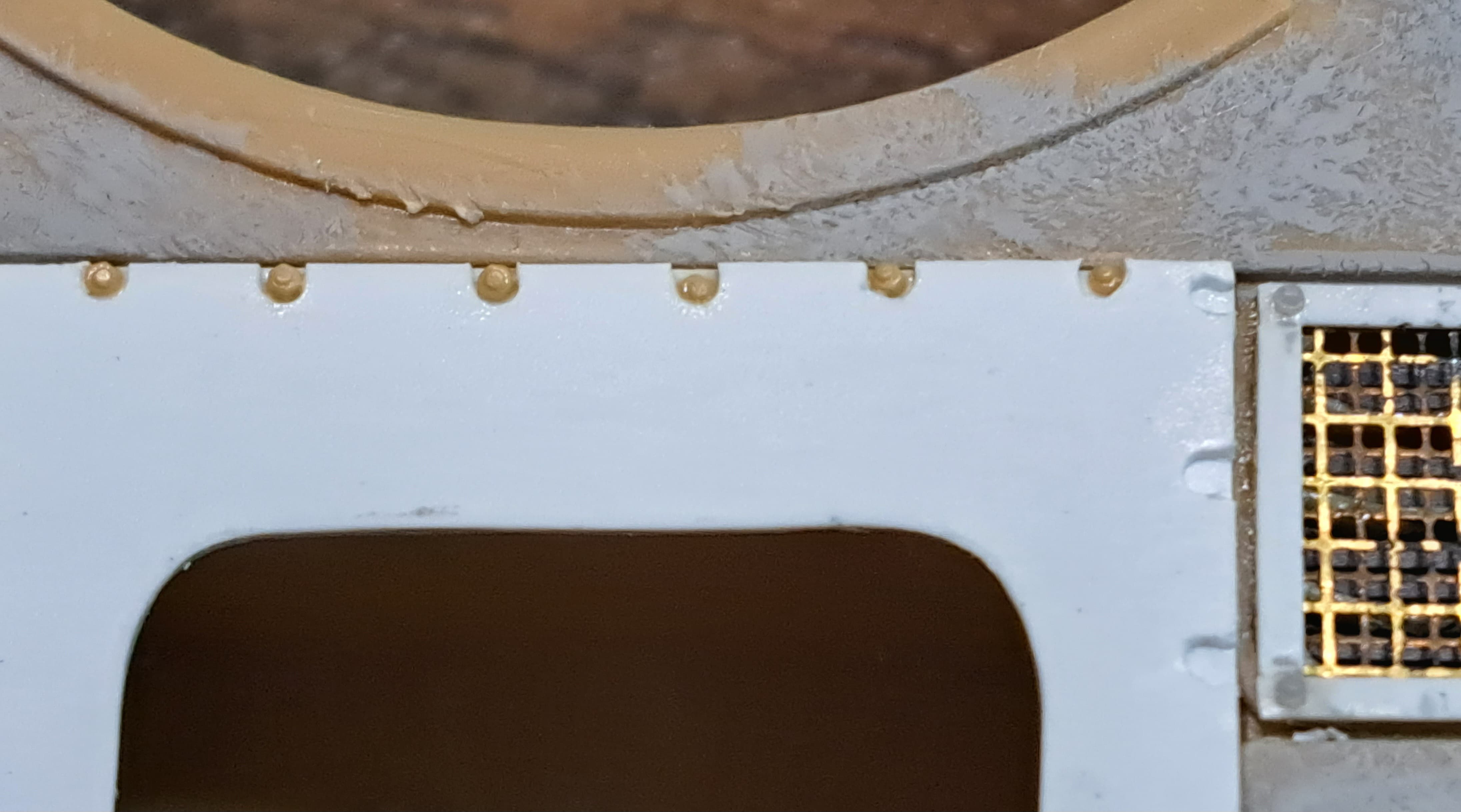

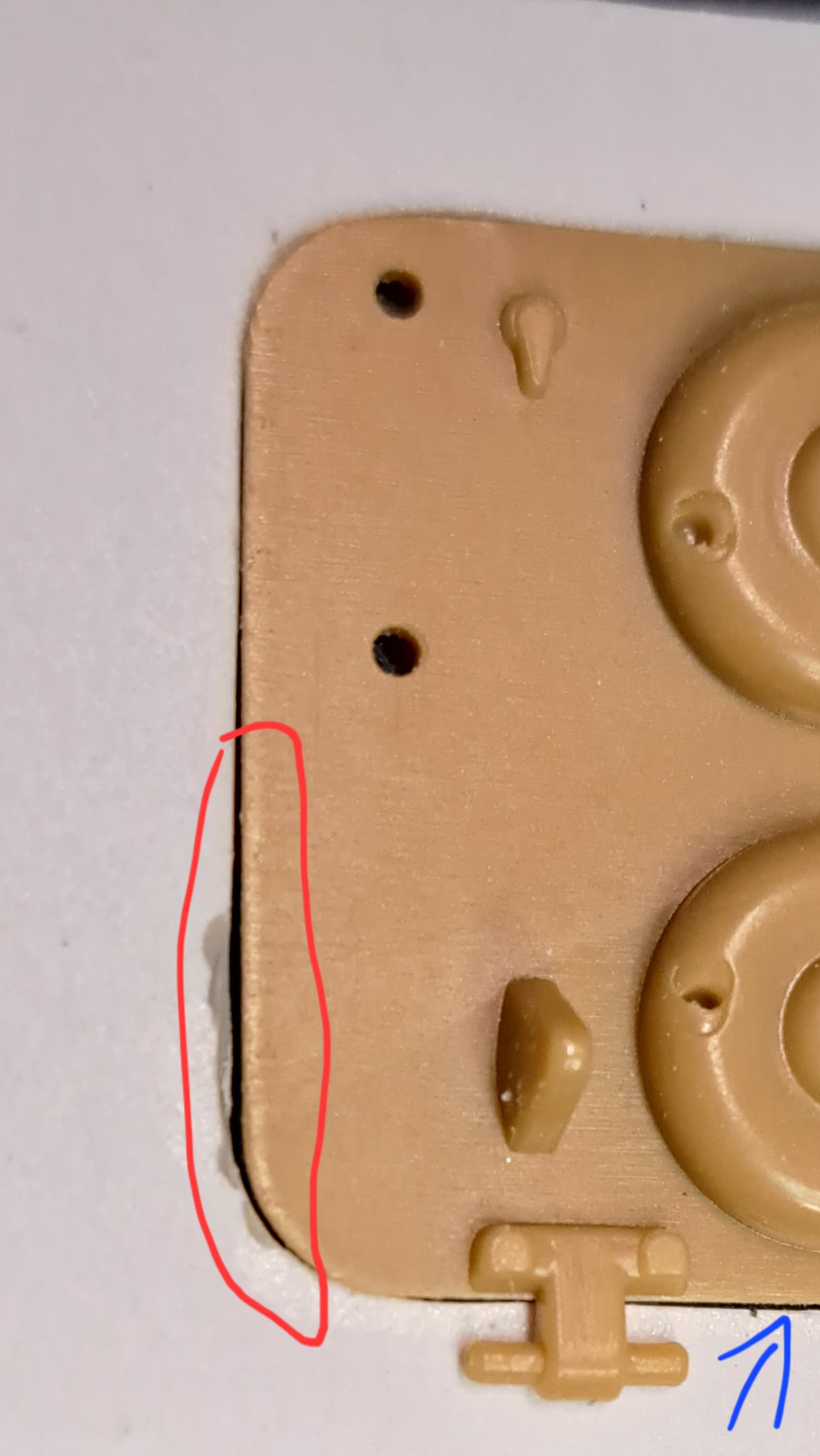

The red marked gaps have to be tightened. Combination of .010 styrene rod and thinned Molak Stucco Putty on the edge for the first round. The blue hopefully OK with just a coat of two of TMSP.
A light coat of Molak Stucco Putty around the edge.
Adding material back with thin coats Molak Stucco Putty isn’t very quick or interesting.

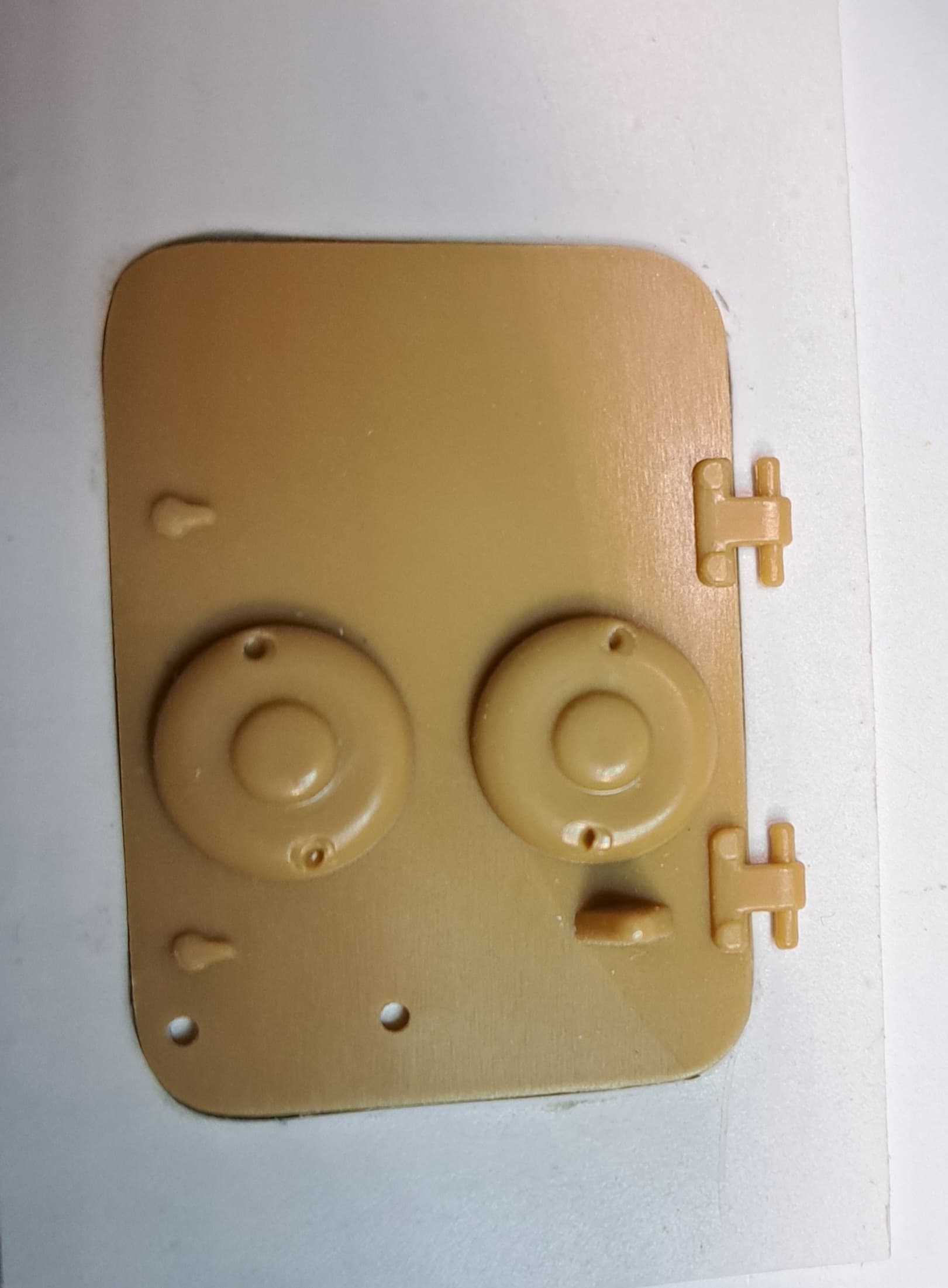

Replacing the engine deck on this kit isn’t such a bad idea. The original part had working hinges, so you could open it up to see the engine. The hinge pieces were both overscale (IIRC) AND poorly detailed. I had an Italeri kit on my Shelf of Doom, that I thought about robbing another kit for the necessary parts.
Damon.
Garrand, I think you’re right that replacing 50c is a good idea. I just wish a spare from another kit was suitable.

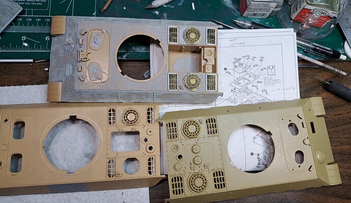

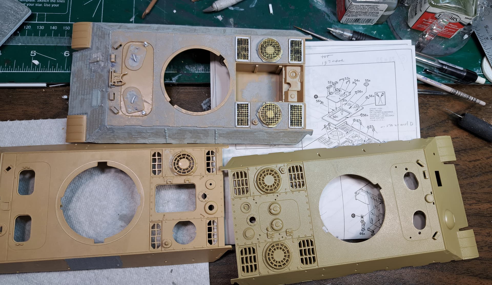

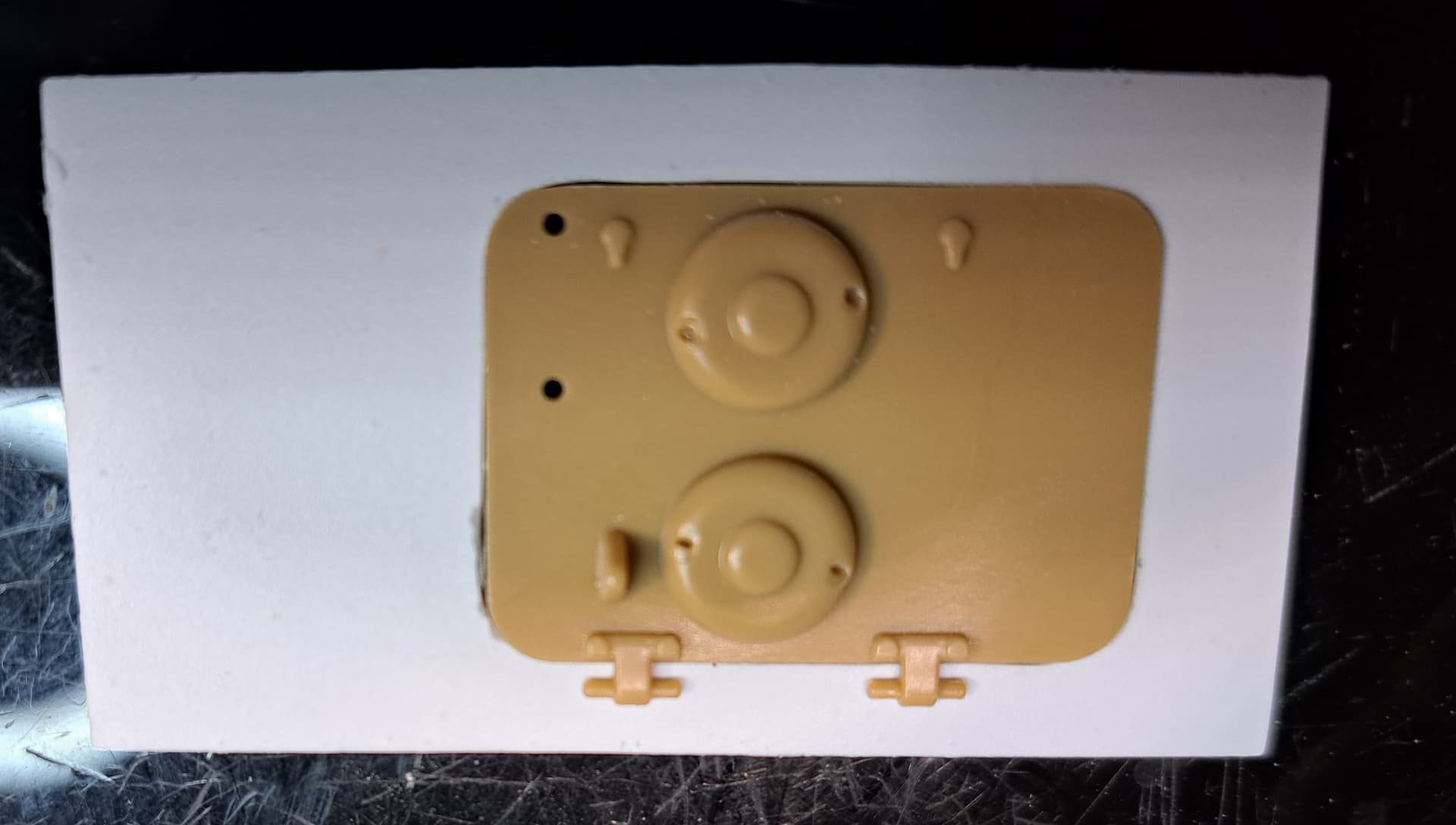

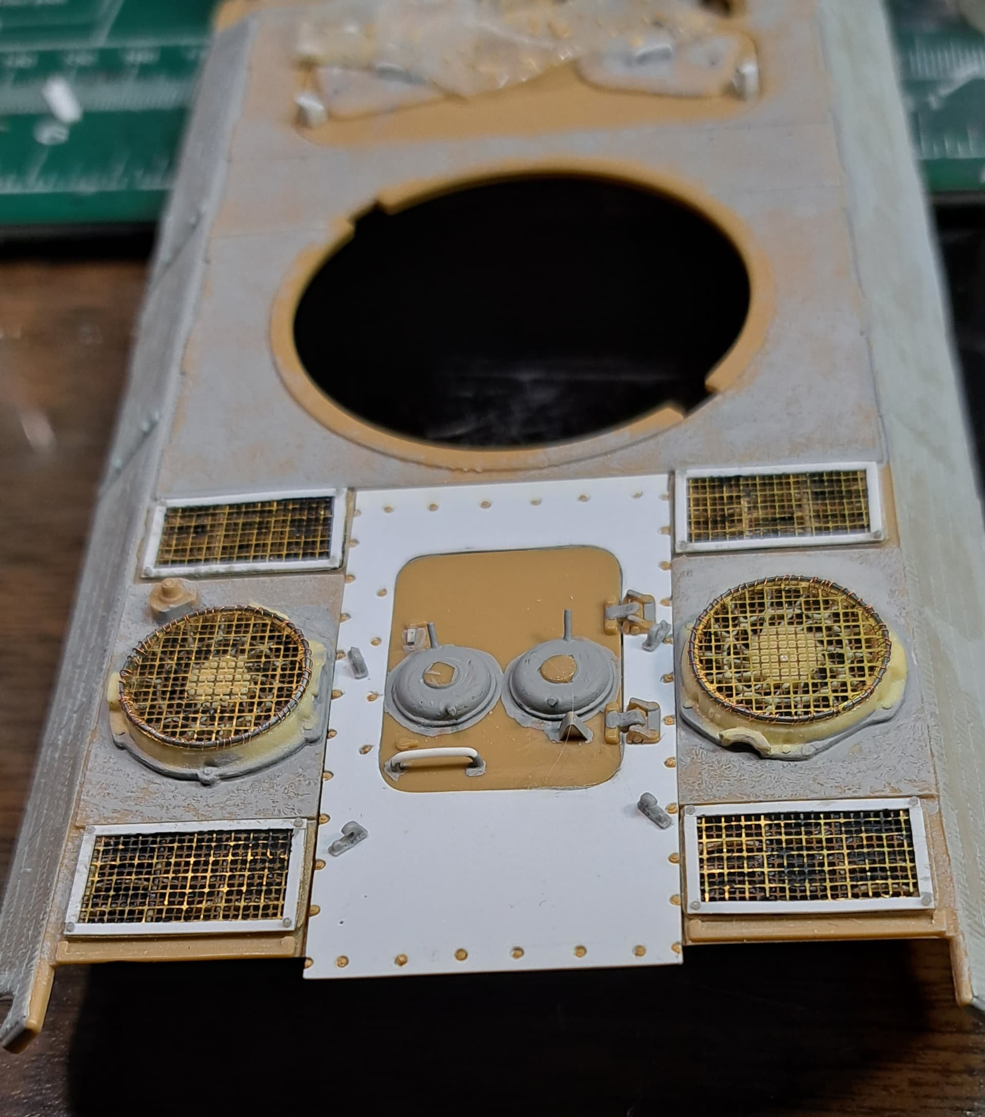

Decided to pull the Meng Early Panther A as it basically has a very similar hull. Thought it would be good to see this in 3D and not just look at plans.
Indeed as Garrand mentioned the Italeri hinges need at least a few tweaks. Meng parts are light gray. Looks like a pair of solder rings around the filler caps will be in order to add a bit more detail to the Italeri hatch too.
I think the hatch fit is suitable enough.

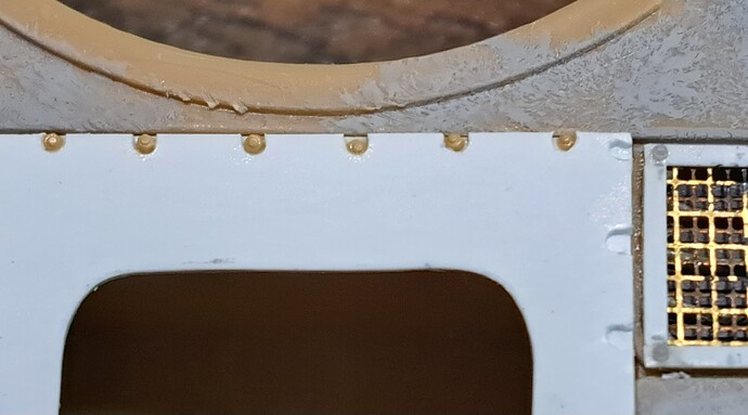

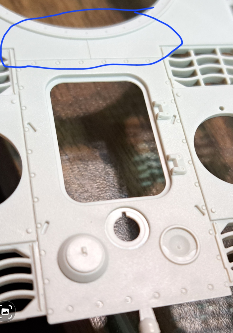

Here’s Meng’s awesome looking Panther engine deck. It’s inspiring! It also highlights what Italeri screwed up so badly on this model at the top just under the center weld in blue
Italeri.
Drilled bolt holes and cut the slots.

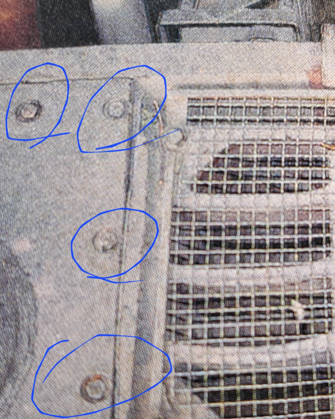

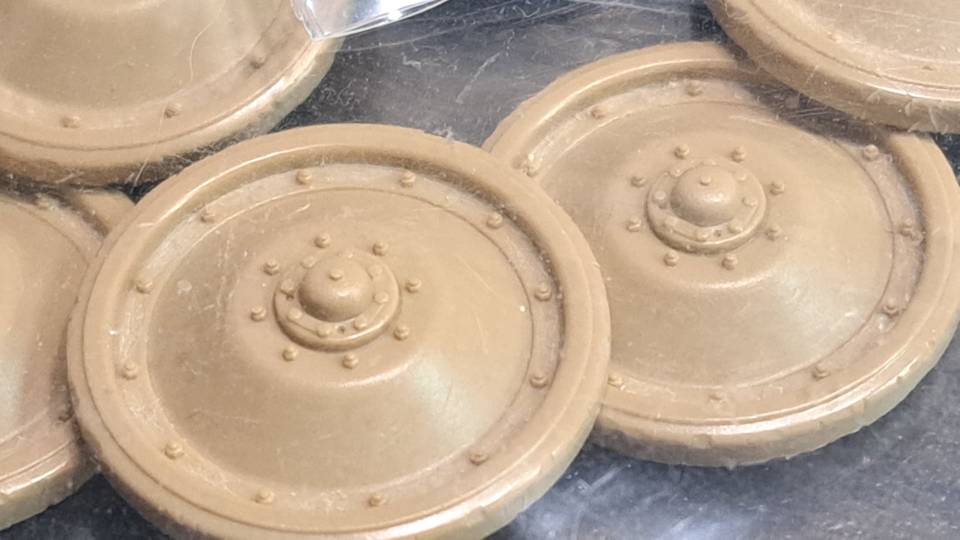

Everyone, understandably molds those blue circled bolts as round but they are hex bolts in my opinion. (Panzers in Saumur #2, discussion only)
Back in 1997, I cut the Italeri Panther kit wheels down to 16 bolts
because I wanted a Panther D out of the kit.
Being some what OCD, I saved the shaved hex bolts for 26 years - just in case, they were needed for something.
Muhahahaaa!
Found a use for the hex bolts…

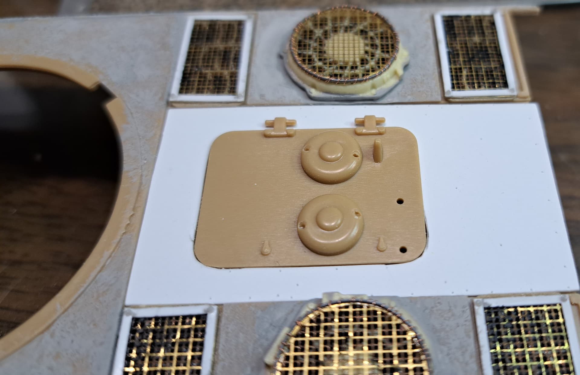

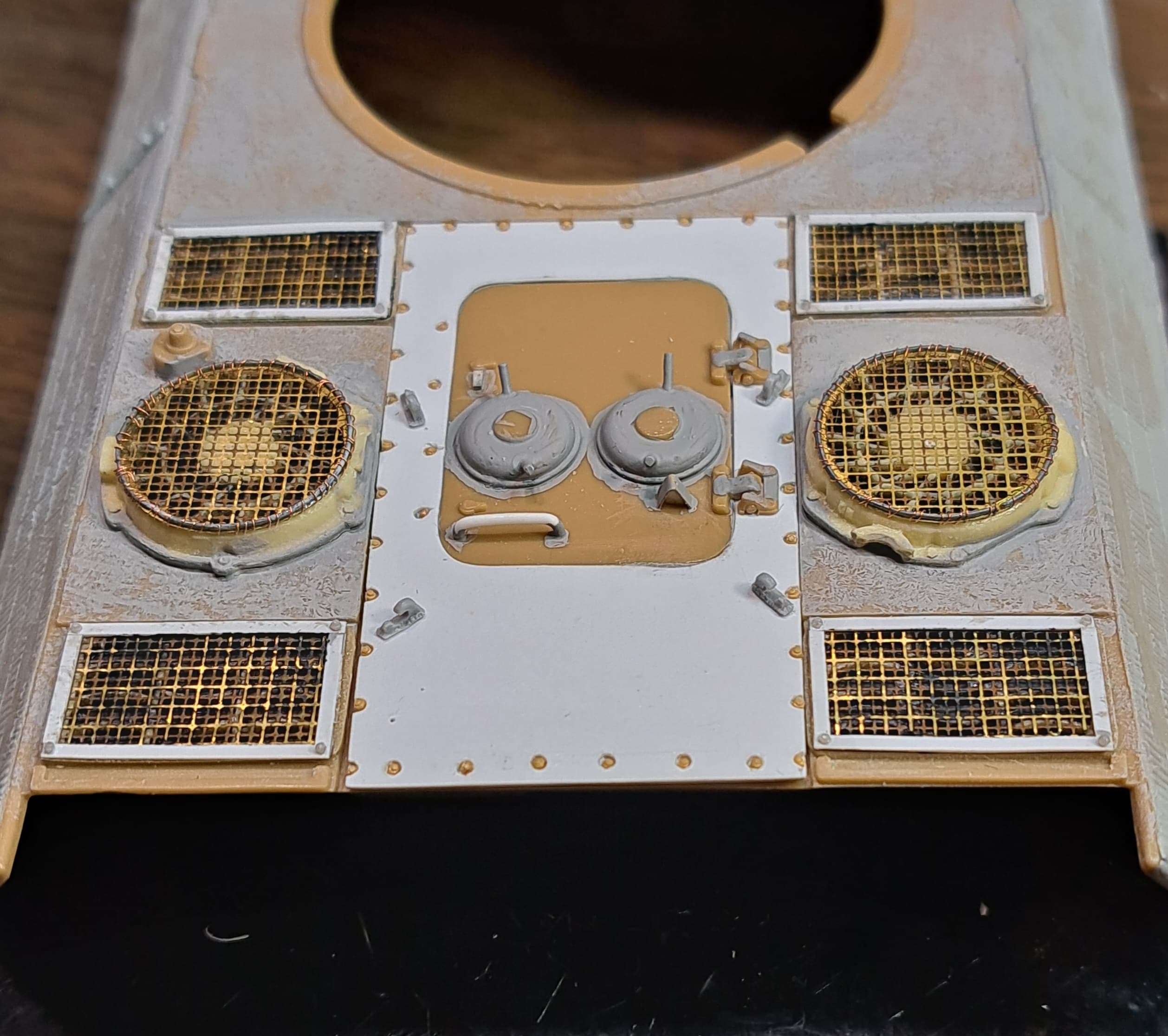

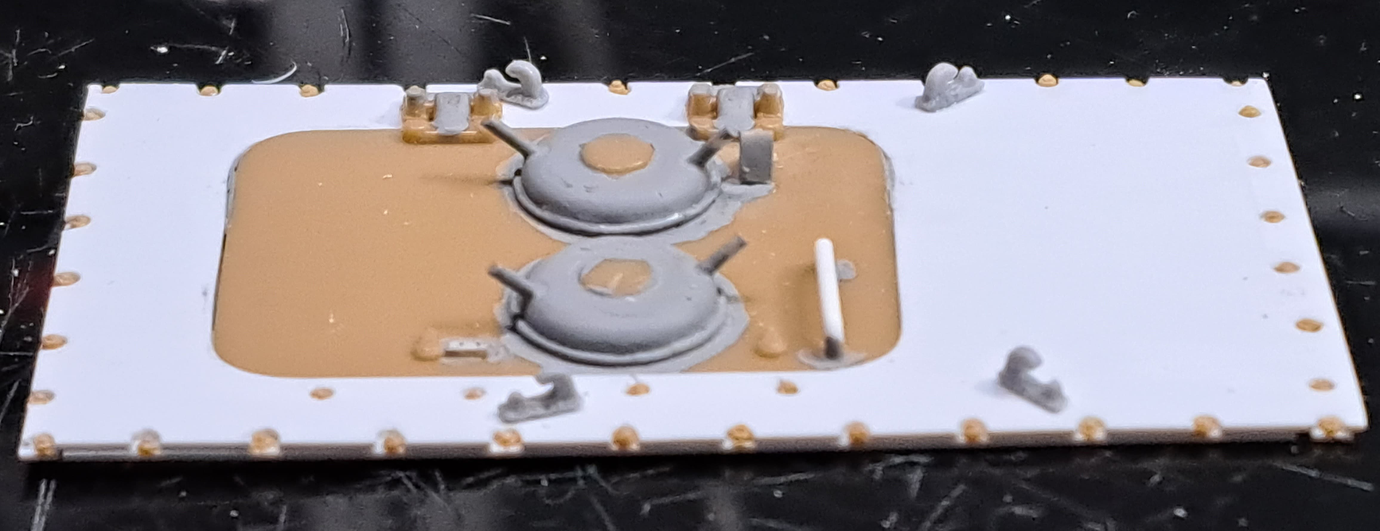

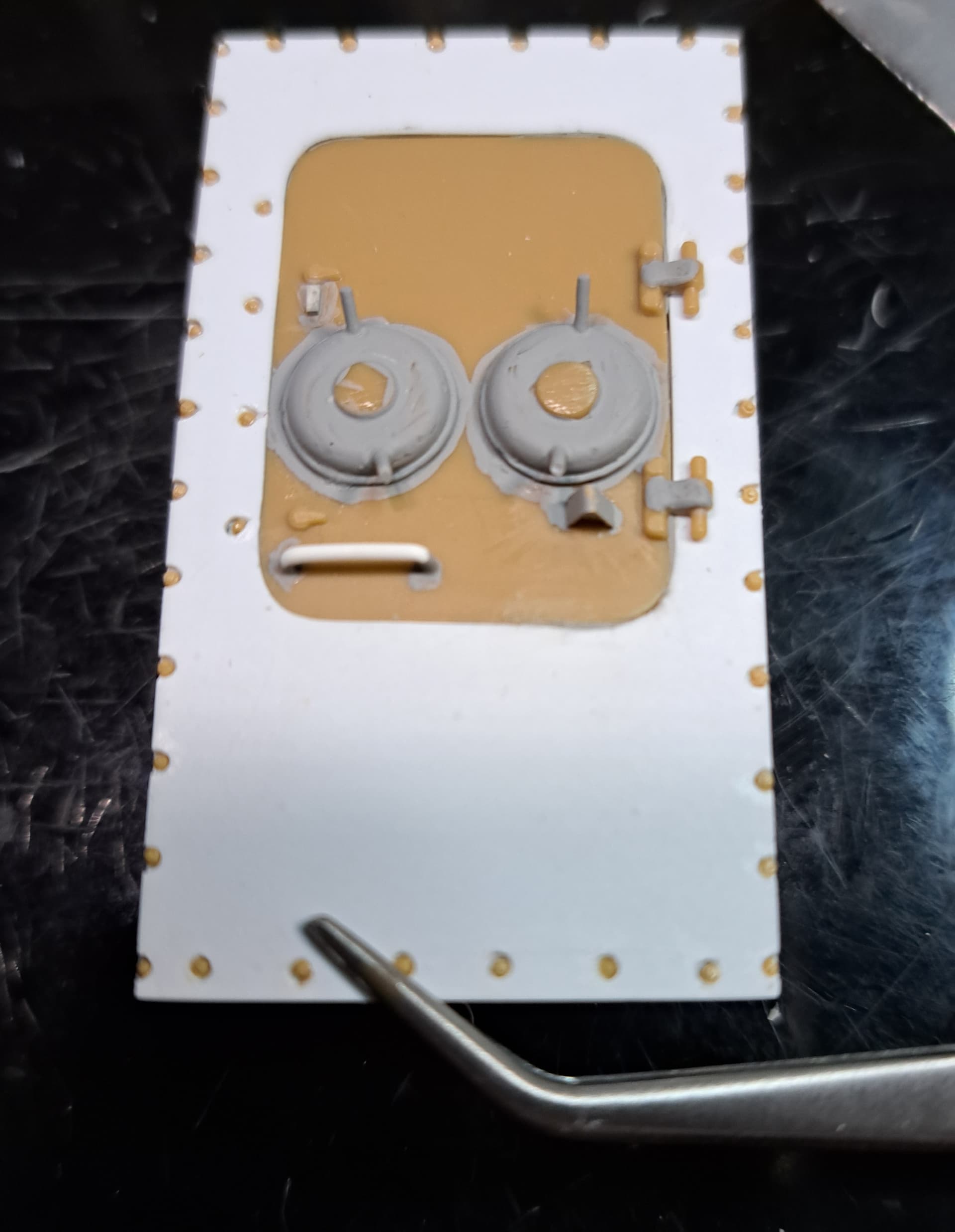

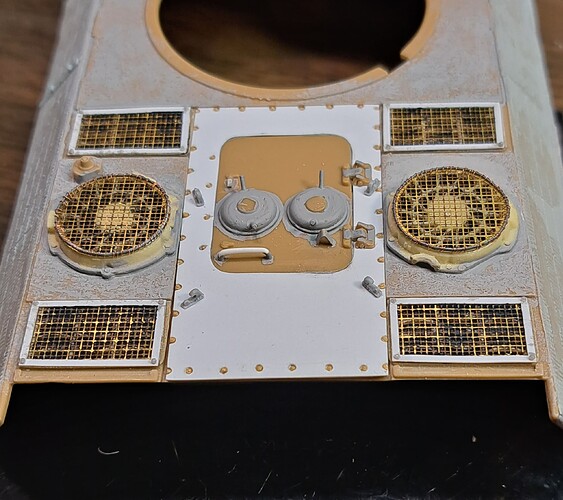

Erstaz 50c cobbled together.
May need a few more tweak etc.

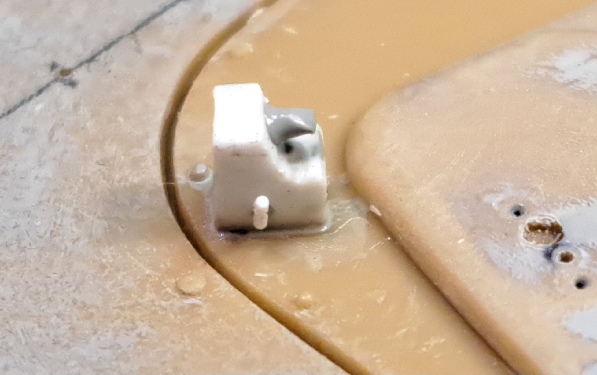

The gap in the lower right hand corner was mostly because the hinge angled down and didn’t allow the part to rest flush.
Bent the hinge plus a shim yeilds the following fit.

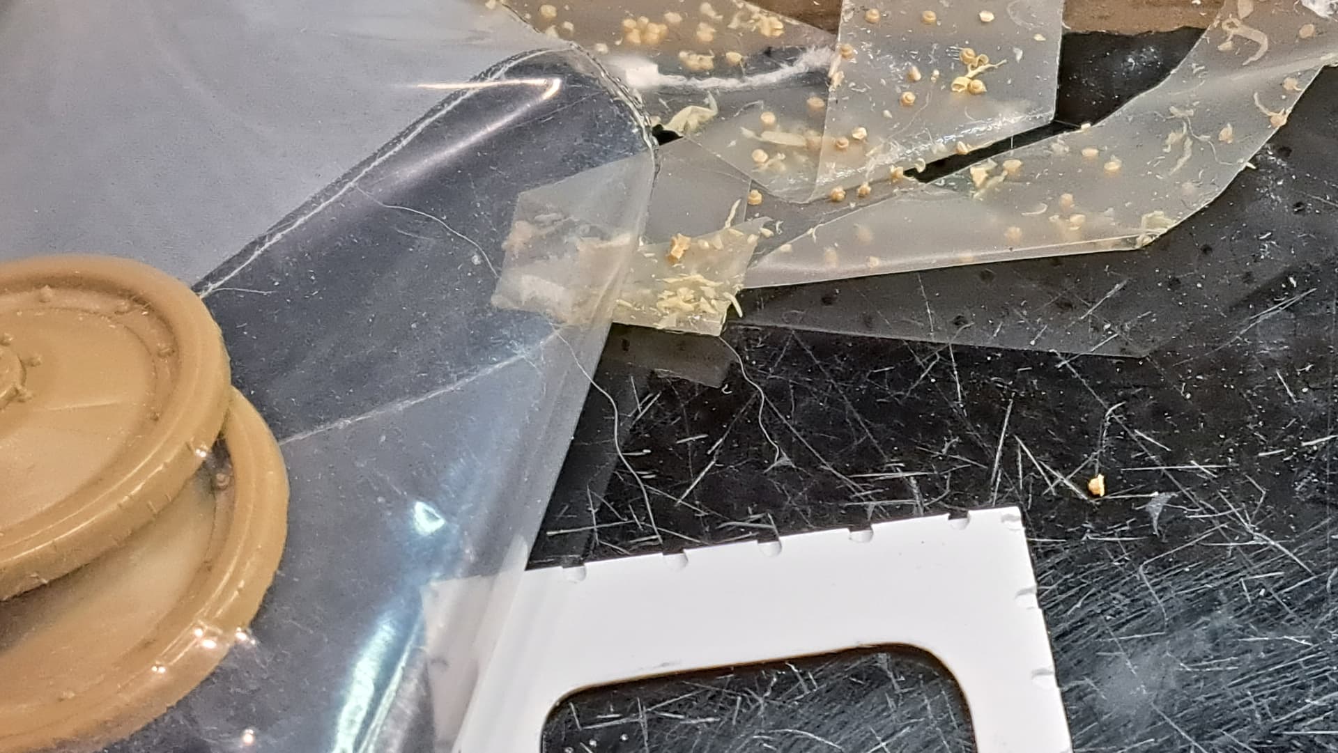

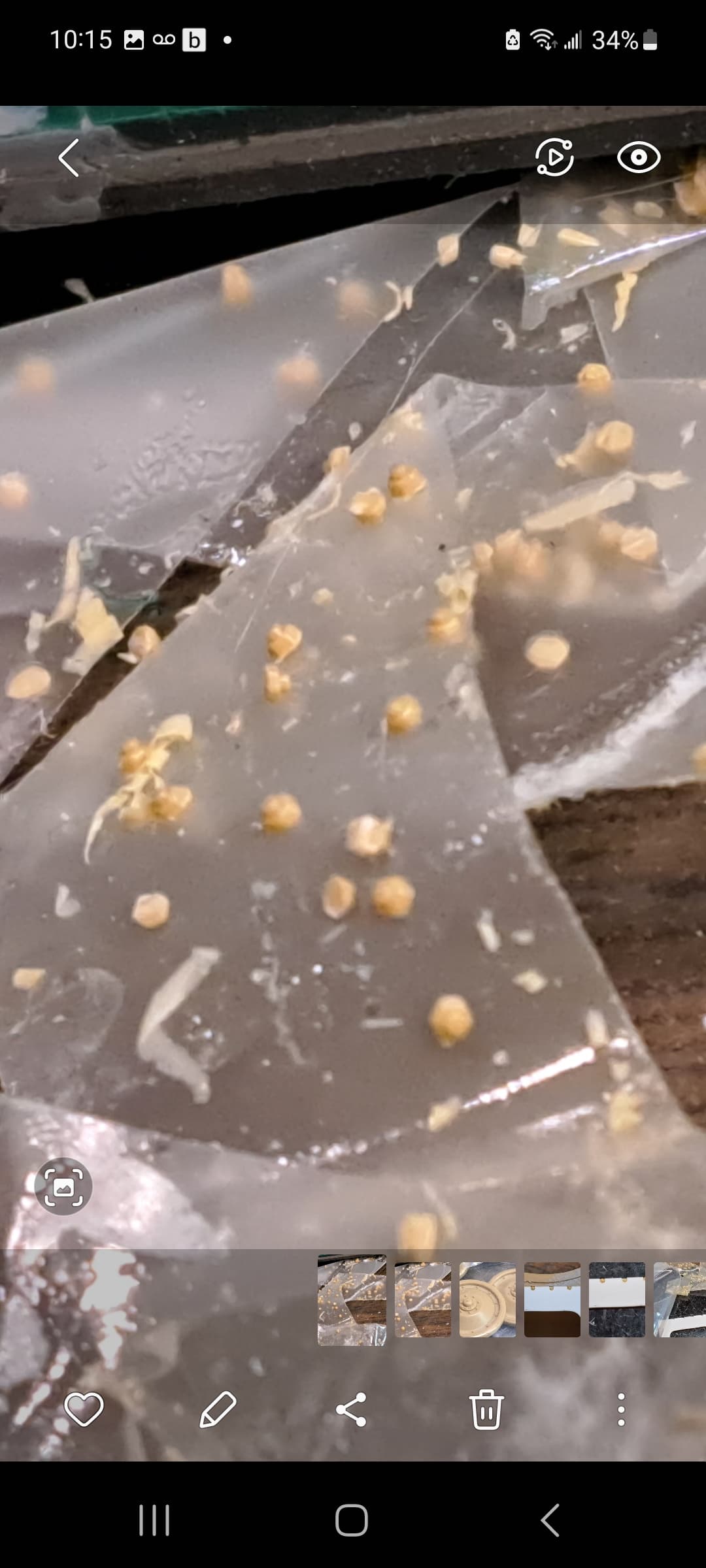

This thinner than paper resin flash from the Cavalier Zimmerit sheet proved very helpful making the shims. Super glue to attach and razor blade to make flush.

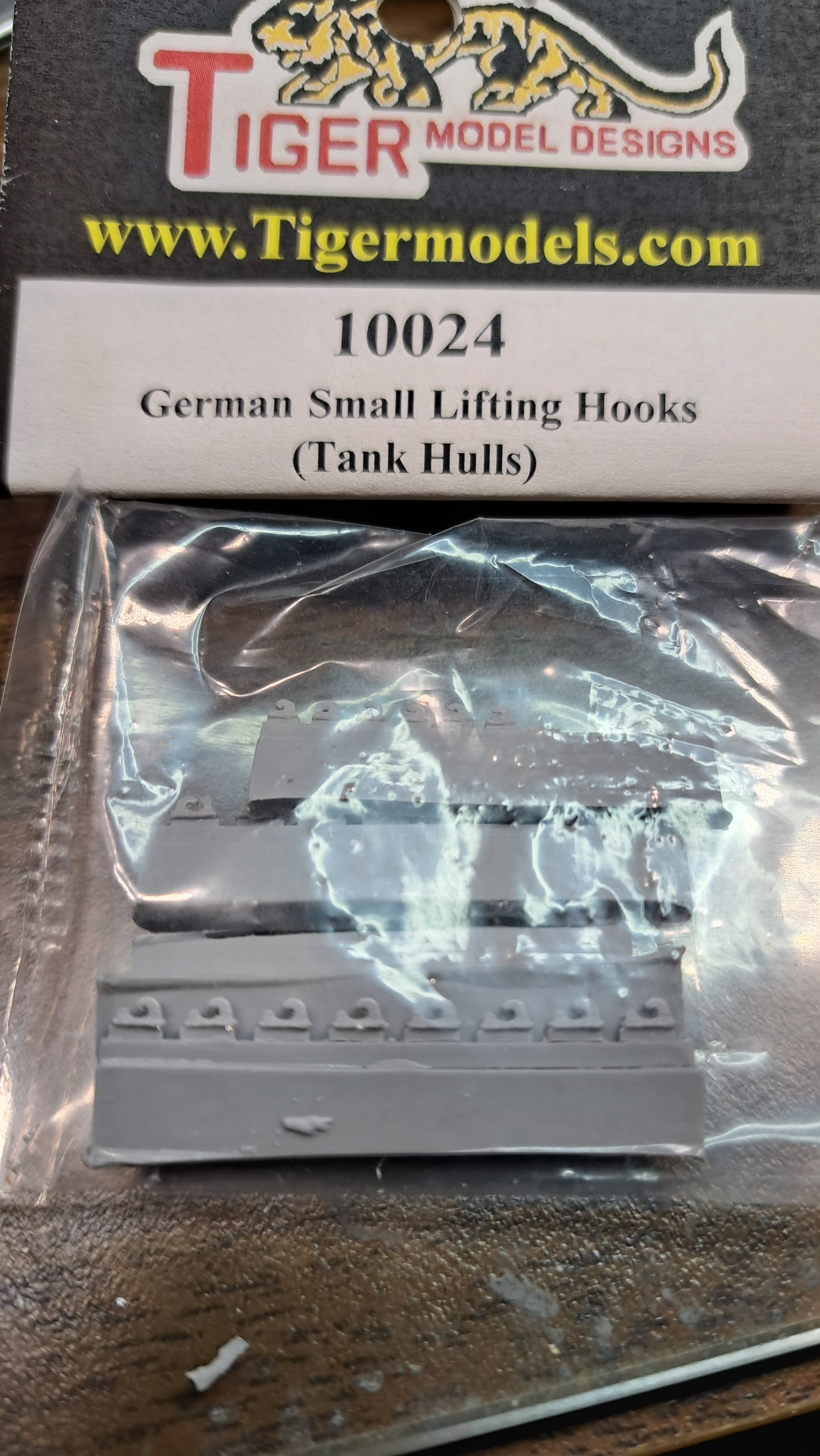

Pitched the Italeri engine deck C hooks in the trash with with these.
The hinges were tweaked by built up slightly with Molak Stucco to change contour. The two filler caps had a solder rings added to their bases which I speculate is for bullet splash. The early Panther D filler cap seemed flatter than the rounded molded it top of kit kit hatch. Filed to a flatter shape, cast texture added plus ears with styrene rod. The small triangle shaped stop was cut away and replaced with scrap PE & styrene so it would have the corrwct hollow indent on both sides. Another little fiddle bit was added and handle replaced with styrene rod.
Kali demanded a test fit before we move to the three remaining large details for 50c.
Kali’s mock up
Kali suggested we test and see if we can “cheat” in a dimensional band-aid for the hull length with a ~5mm strip of styrene.
Will have to test and see if the rear plate can be "tweaked into fitting…
