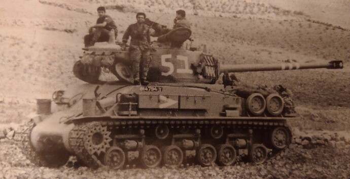

The funny thing about the original vehicle is, you can not tell, if it is based on the M4 or the M4A3 hull.
Did they cut off the engine deck hatch supports from M4A3s when they were being rebuilt to M51s?
If it was a M4 would it not have a 60 degree glacis instead of 47? The photo looks like as 47 degree glacis.
That’s a good question, I’m not sure, that feature can be seen in the picture?
The vehicle in the picture for sure is based on a late, wet hull with large hatches and the 47 degree slope. But only the angle of the upper rear hull will tell, if it is a M4 or M4A3. Or M4A2 for that matter.
By the looks of it: no, it can’t. Which can mean two things: either the hull was from an M4A3 and they cut off the supports, or the hull was not an from M4A3 to start with :slight_smile: For the modeller, this is really only relevant if there would be scars, but it’s the kind of detail you’d only want to add if you really want to show that it was an M4A3 to those who pay close attention, IMHO. And the jerrycan is in the way for seeing the angle of the rear plate, so that doesn’t help either.

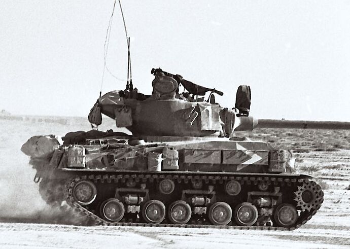

The same vehicle as above, seen from the other side. Still no indication of whether this vehicle is based on the M4 or the M4A3 hull.
I just realised something: Did the IDF receive any M4 (105 mm) tanks at all? Because if not, then this one’s hull would have come from an M4A3 — the only large-hatch M4 tanks with welded hull front that were made, were 105 mm howitzer tanks.
I think, but I’m not sure, that 12301-א is an M4 (105 mm), not an M4A3. I can’t see the support on the sponson, but it does look like there’s a lump that could be the air scoop at the back. It’s impossible to say what type 12498-א was, but the tank in front of it has an M4 engine deck, so if 12498-א belonged to the same unit, I would kind of expect it to be an M4 too.
Both are M4. The IDF purchased about 30 something M4 105 from Italy in 1948.
My memory seems to be getting worse than I realised :frowning: I lost track of why I asked about them in the first place — I thought earlier tonight I was wondering if they had gotten any M4A3 (105) tanks but no, I had asked about M4 (105)s because if they had not, we could rule out the M51 being based on an M4 hull … sigh Your photos prove we can’t, unfortunately.
I have given up on trying to figure what type were Israeli M51. It is hopeless with so many types of hulls, engines, turrets etc finding their way to Israel.

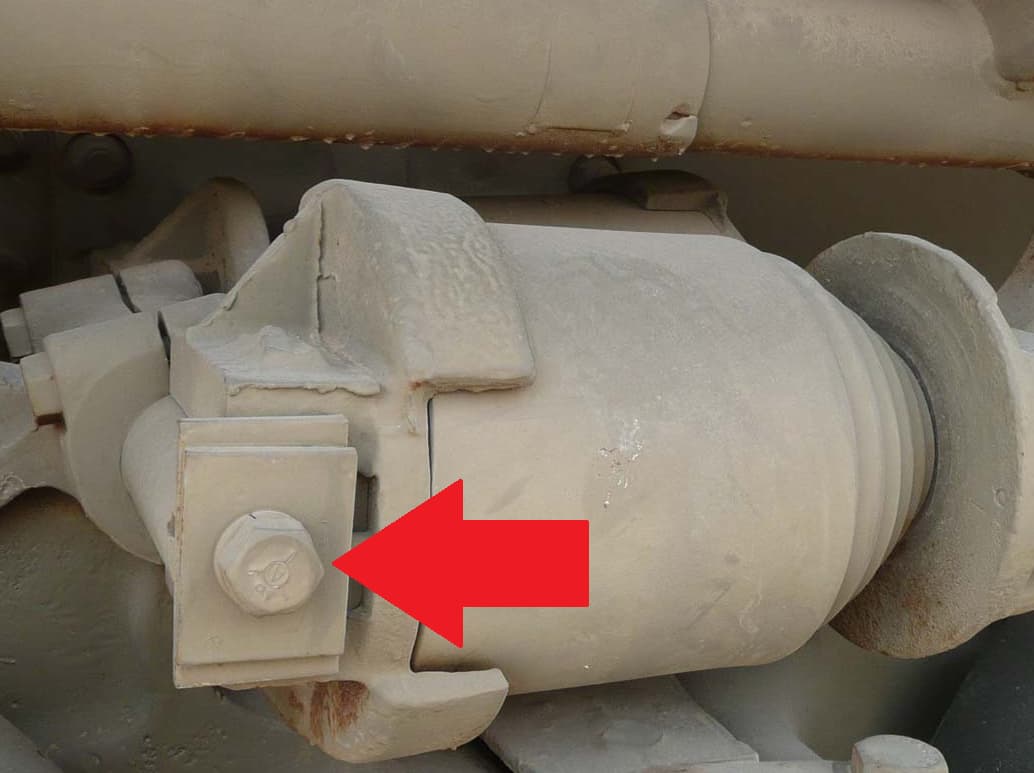

Anyway, back to the beautiful build. A detail I notice recently on Israeli HVSS suspensions is this minor modification:
A double plate bolted to the side of the spring plate. Compared to the original:
The question is relevant here, though, because of this thread apparently being about an attempt to recreate the vehicle in the pictures, 814794-א. Getting that as right as possible would mean trying to work out the hull type.
Exactly. I want to replicate 814794-Y, among other reasons, because I can get decals for it from SabingaMartin.
Since I began this kit some years ago, resources were fever than today, so I began with the Asuka M4A3 kit.
I do have a few photographs showing a M-51 based on the M4 hull. In this photo, if you look at the angle of the upper rear hull, and compare the near vertical angle of the upper rear hull with the vertical jerry can on the right rear fender, then I think this photo is evidence af a M-51 based on a M4 hull. In the other picture, the angle of the upper rear hull is far from the vertical of the jerry can, and thus, this picture depicts a M-51 on the M4A3 hull.
