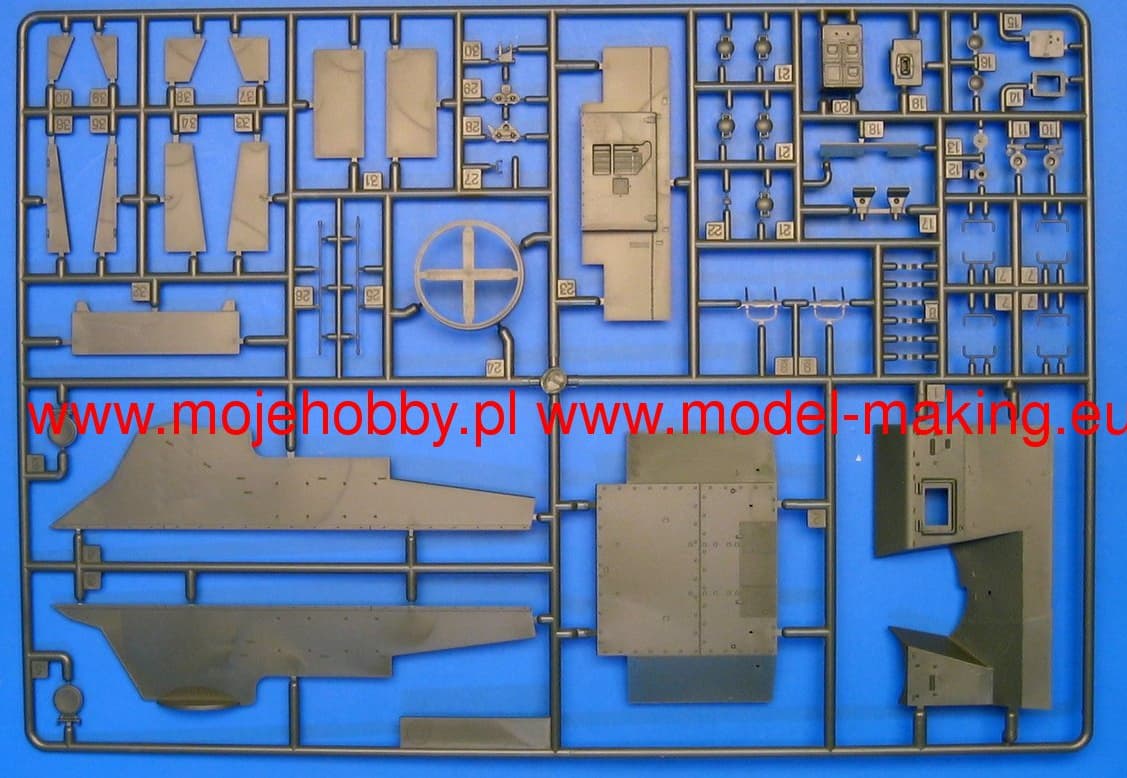

I thought most Airfix 1:35 armour was Academy repops?
Academy 13210
Hey Rob, whatever you do about tracks be sure to post pics as you get into it! Always good to see a new build.
yeah you could be right mate, i know their 1/35 hetzer is, i was just wondering if anyone could shed any light on the subject for me.
Scalemates say:
I concur.
Sprue images at Super Hobby if you want to compare and be totally convinced.
Academy:
Airfix:
The Italeri and Dragon sprues are totally different from Academy/Airfix
and from each other
Yes, it says Academy but I wouldn’t be surprised if the fit works well with the Tamiya kit like a number of their other kits and the Tamiya kit is a repop of the Italeri kit.
Academy sprue:
Airfix sprue:
The images of the Academy and Airfix sprues are taken from opposite sides,
the Airfix sprue is from the reverse side (no part numbers)
Dragon sprue
Italeri/Tamiya sprue
