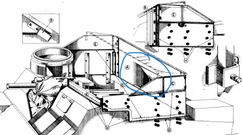

I know this is coming a bit late but the wading fittings for the M7 HMC included a slanted cut out to protect the engine deck air intake. To keep that waterproof.
not too late but can’t work out what part you mean… is that the grill right behind the fighting compartment?
m7_ext
Yes. that rectangular grill, just aft of the fighting compartment is air intake for the engine. That would have been made waterproof. For the M7, it was easy enough to simply enclose that in the wading extensions. I’ve circled the angular cutout in blue
ah yes now I see… yes too late :wink:

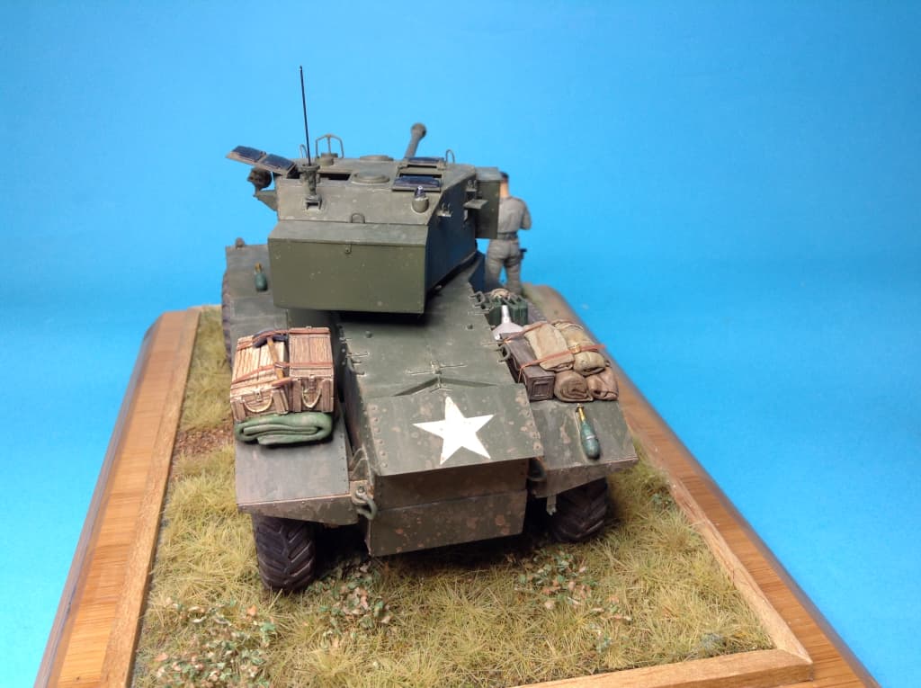

matt varnish on, stowage on, tracks and rubber painted… not envisaging a heavily weathered vehicle this time)
That is looking very good :+1:
finished, finito, done… really enjoyed this build, learning all about stowage, some extra detail and scratch building…
