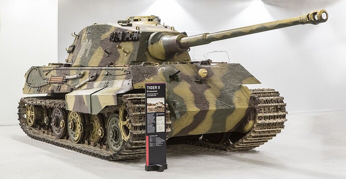

SableLiger’s photo posted is of Bovington’s Tiger II in original, factory paint. Another view;
Actually, this one is the unrestored 104, SableLiger’s is the post-restoration, I’m assuming? ![]()

Did Bovvie repaint 104, or just give it a good clean & polish? And is the “old” paint genuine or an earlier museum repaint?
Who knows? I think they probably repainted it using the original pattern.
