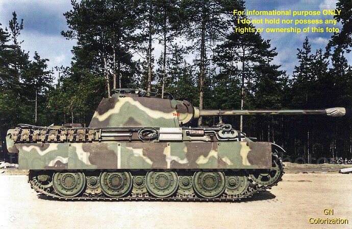

So this is a close resemblance of how the Panther actual appearance:

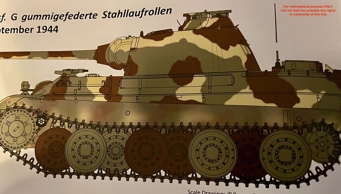

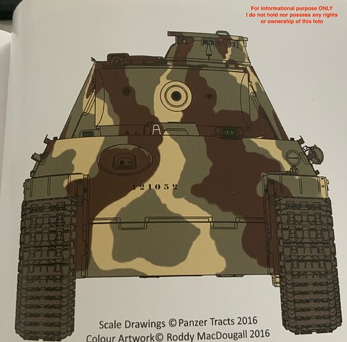

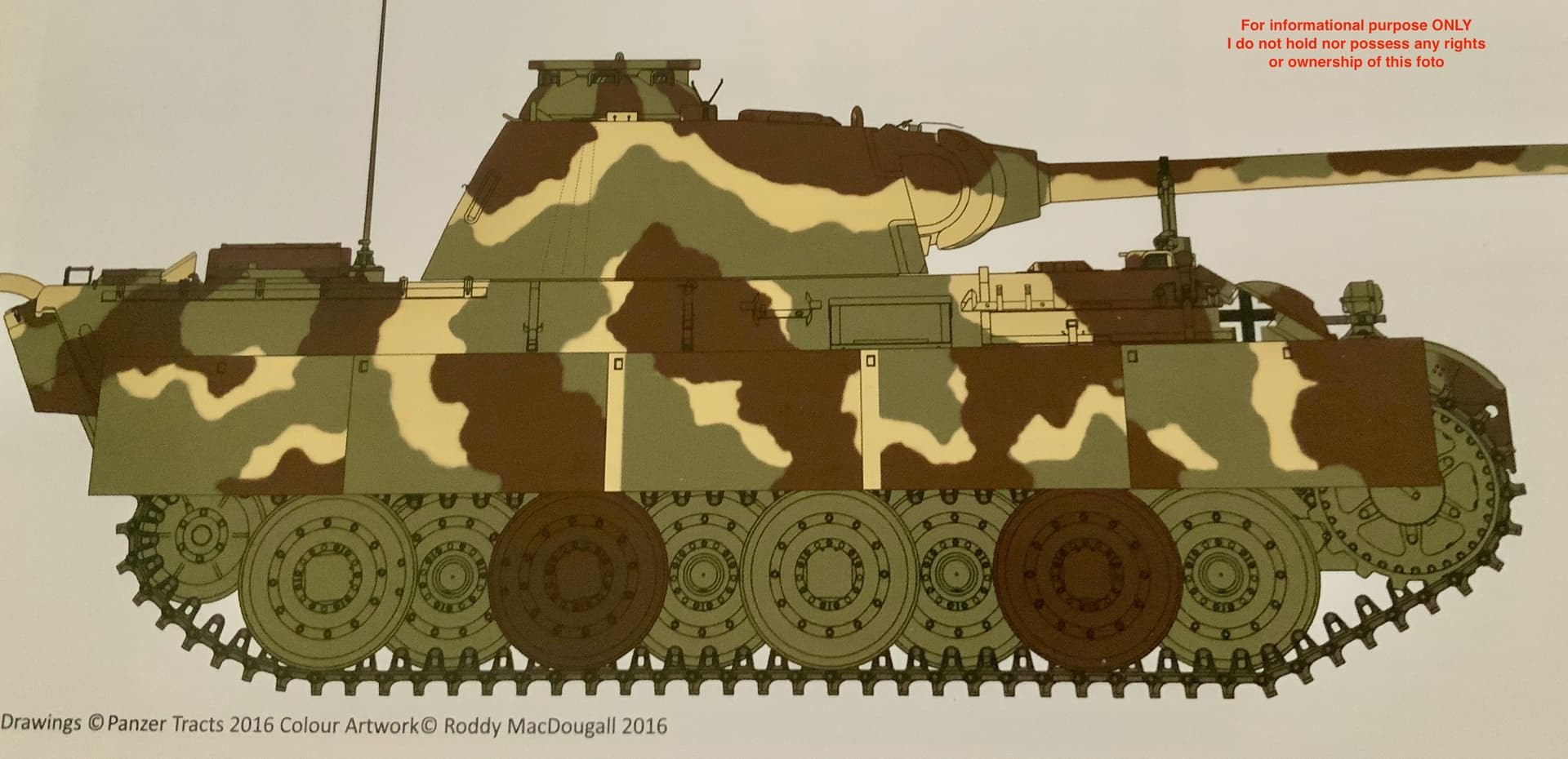

Here are the superb color artwork by Roddy MacDougall serving as camo scheme reference:

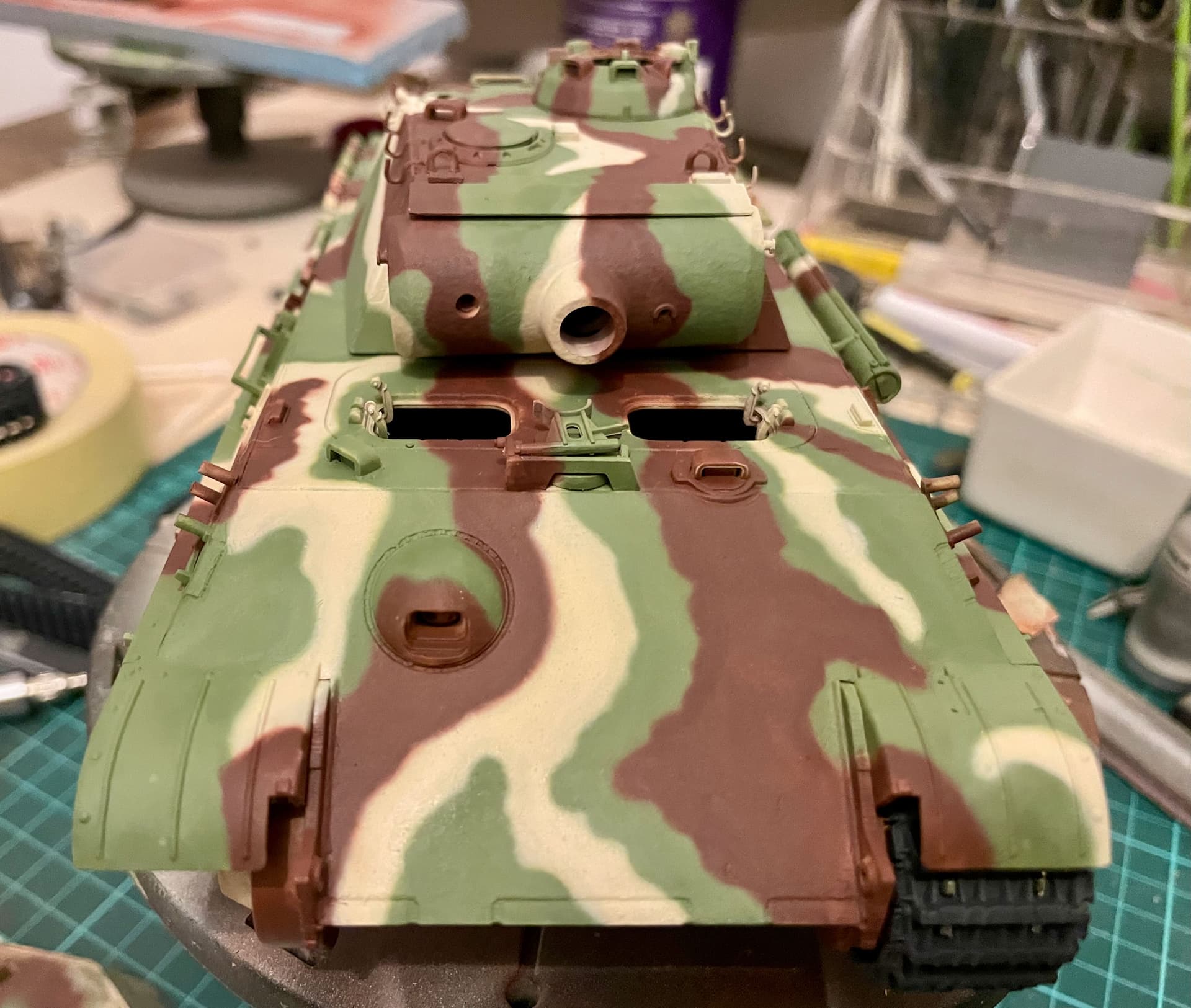

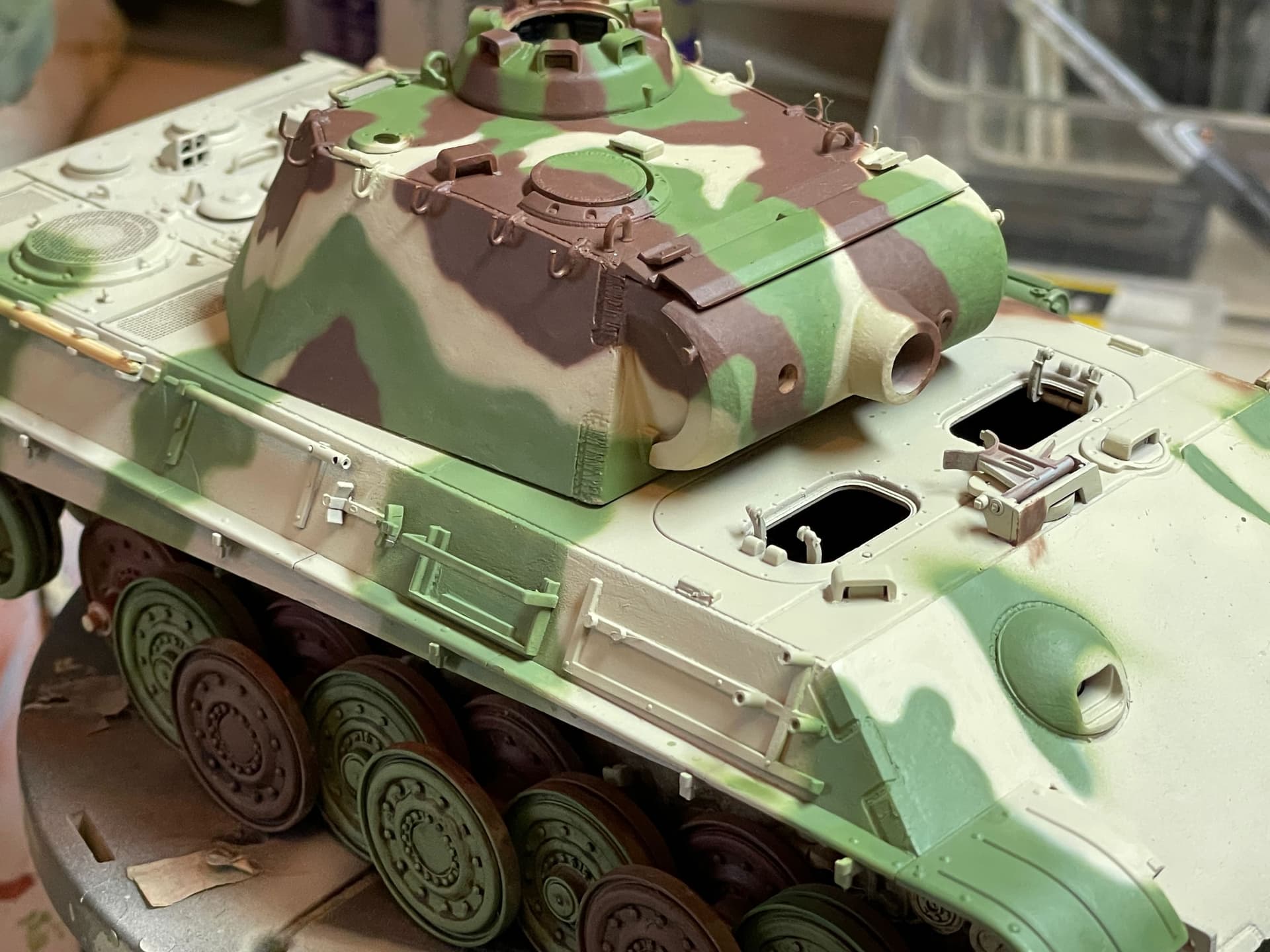

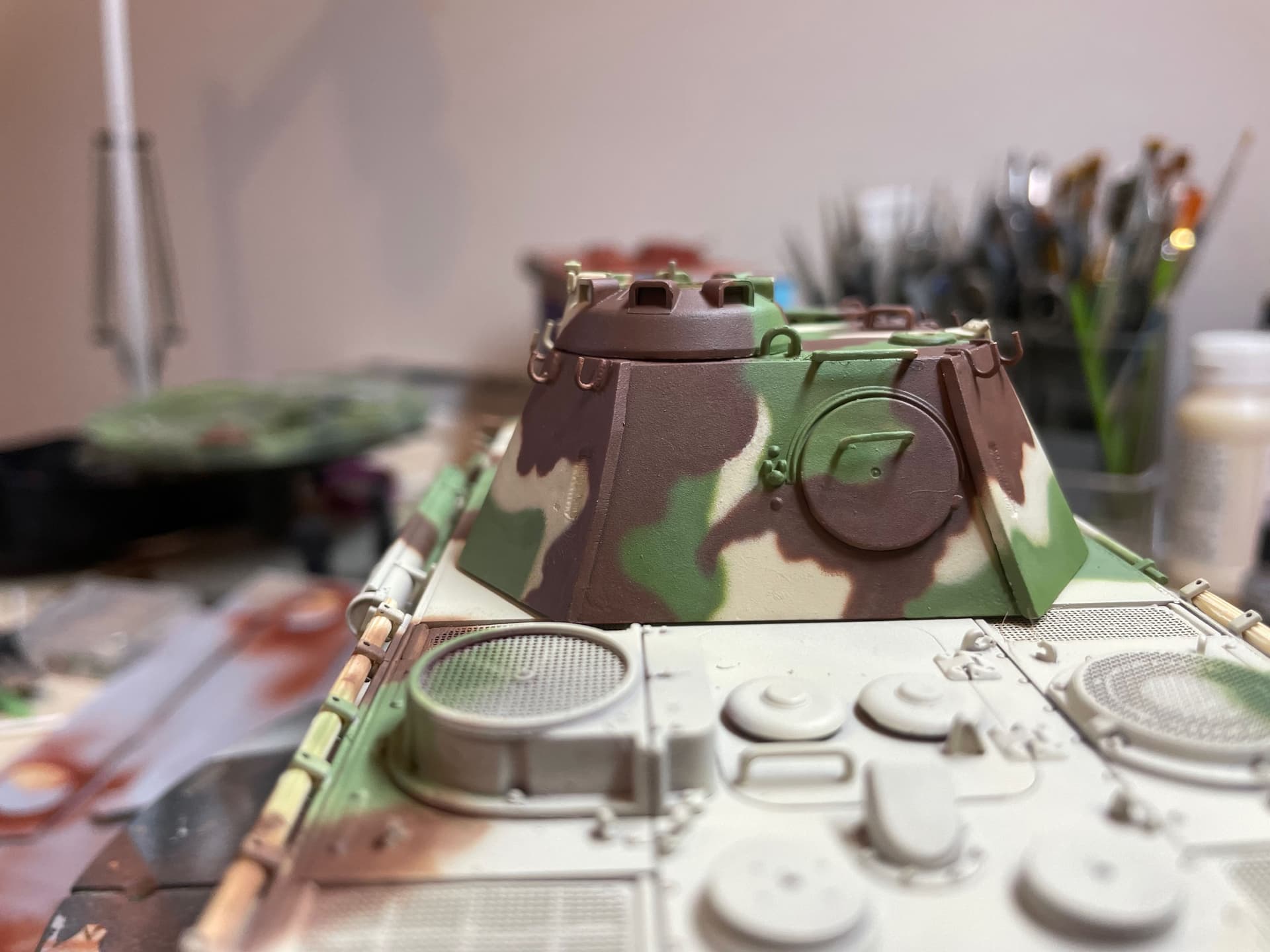

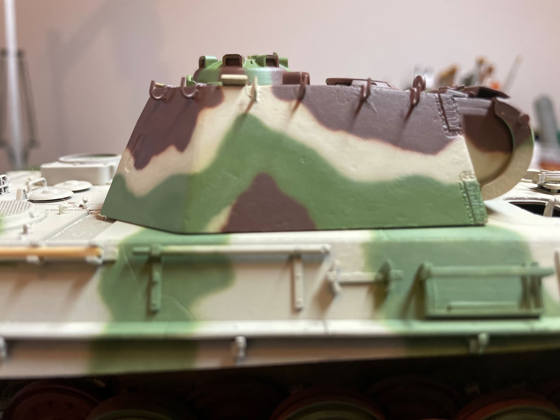

Since I was very eager to do the turret camo, I tackled this first. I mix all my colors for a project new, sometimes I alter leftovers like Brown and Green in this case. Compared to my other Panthers the color applied look quite a like but in reality one does notice a slight difference in their overall appearance.
Most of the turret came will be hidden under the turret numbers an spare tracks which where obviously used as the original foto indicates.
The two sides and the front should come quite close to the original … the rear and the turret roof are mostly “functional”.
Since I use very small amounts of paint, the rest is then used on the hull.

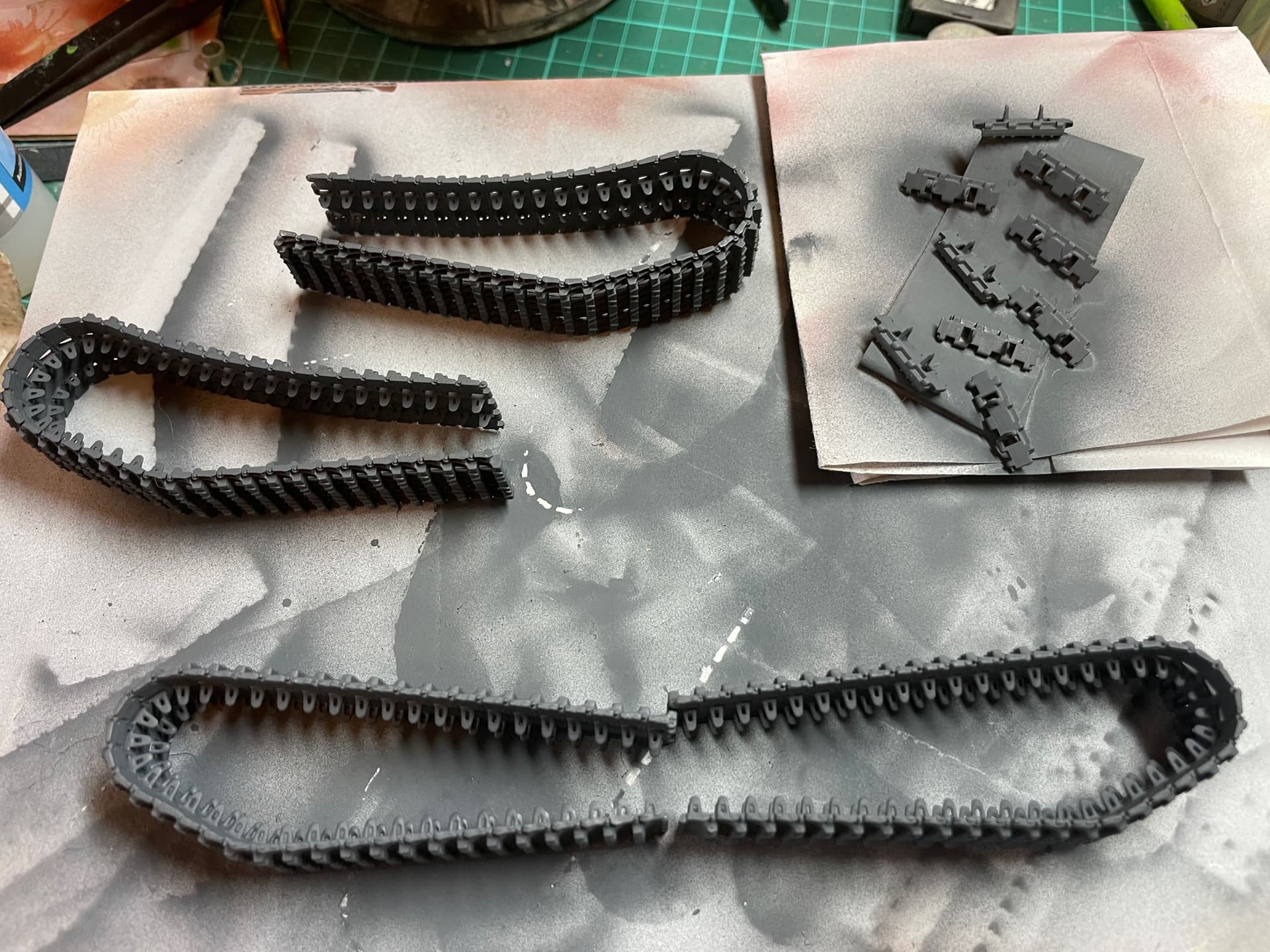

I purchased the same 3D printed tracks I used for Panther #114.
Ready for weathering …

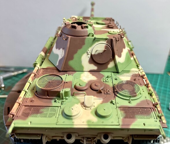

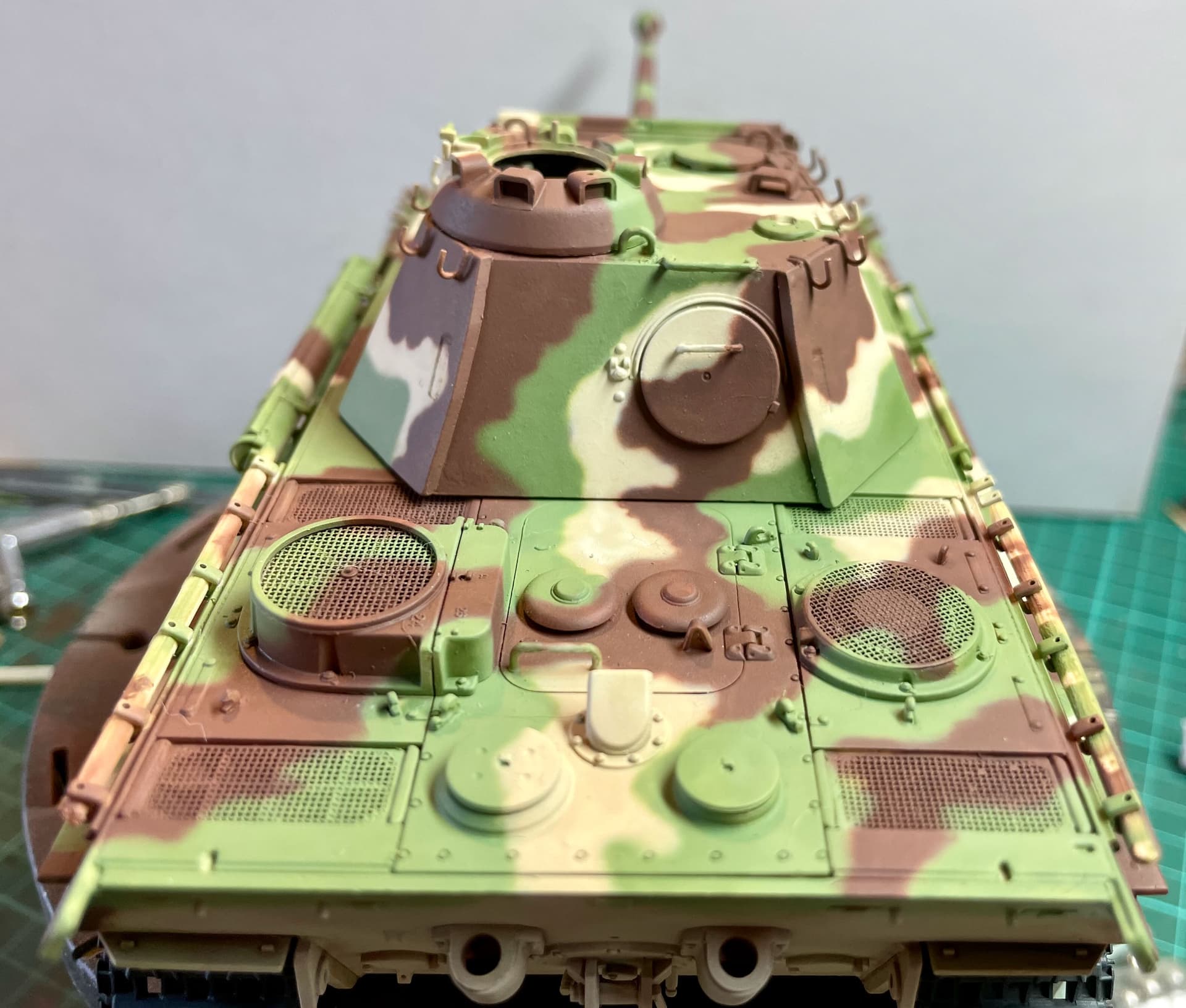

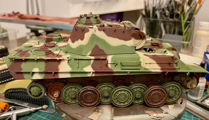

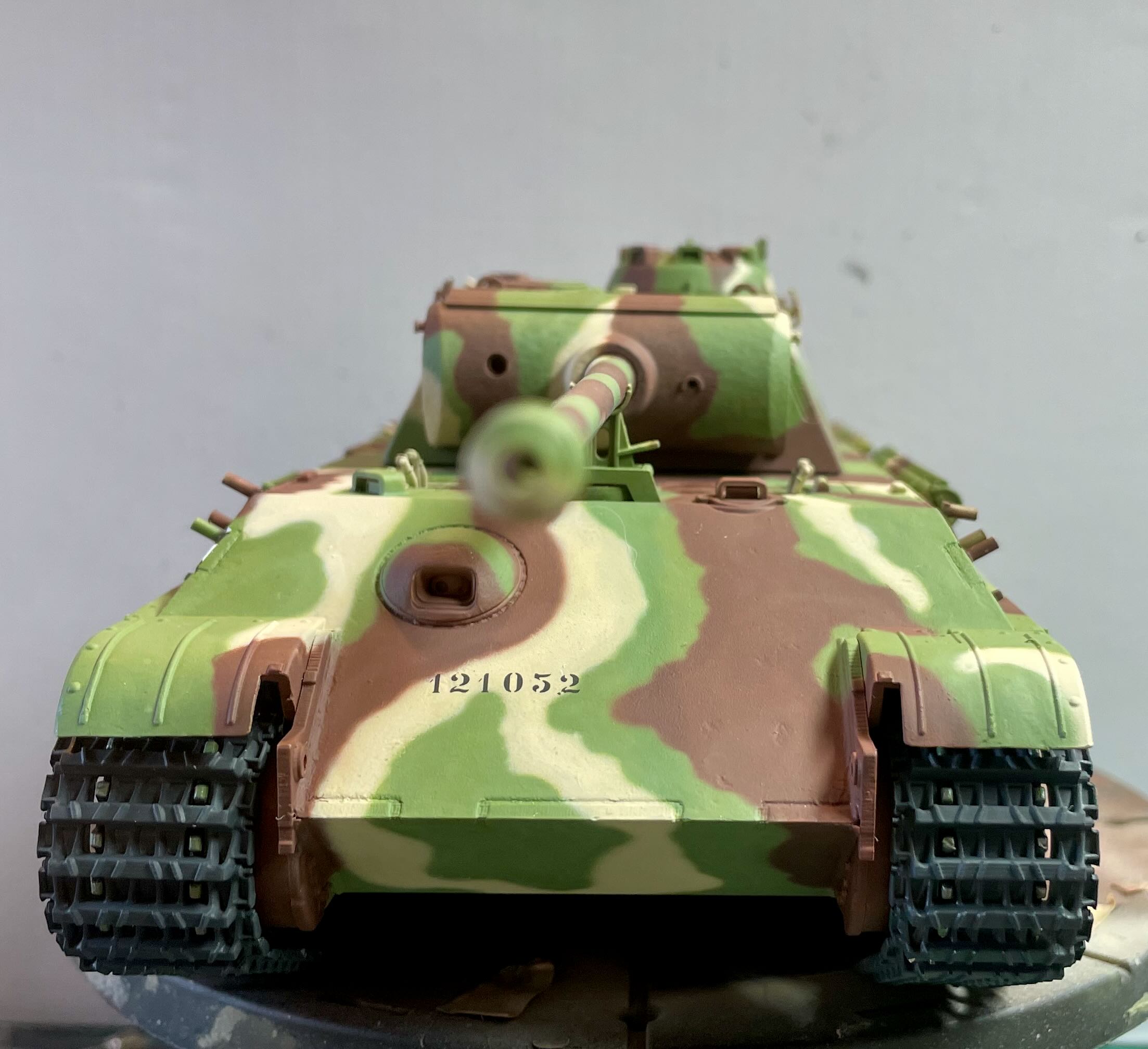

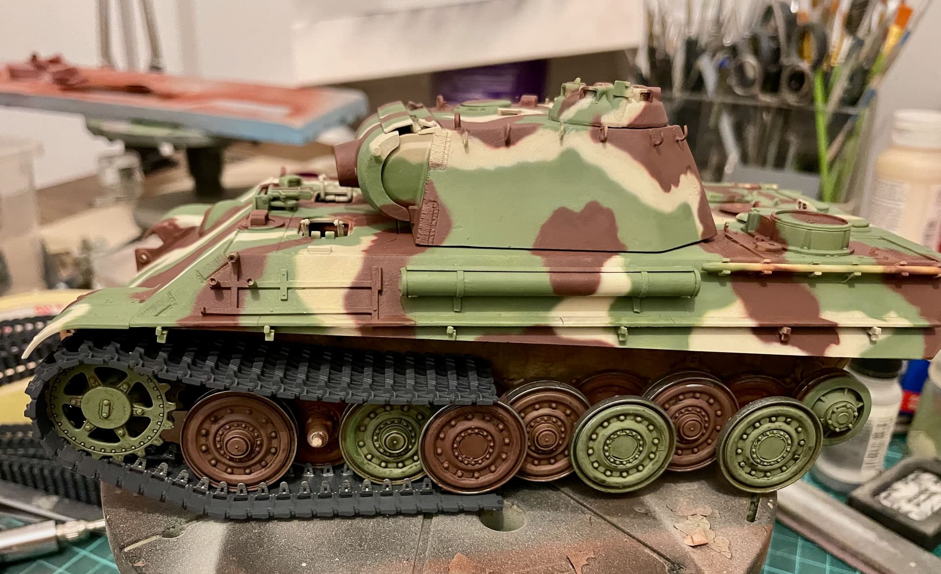

So I finished the basic camo with a few imperfections to be dealt with.
The front and sides are close to the colour drawings but I diverted a little on the front and the turret sides after studying the original fotos a little closer. The top of the hull & turret are mostly “fictional”. There are hardly any good top-shots of German WW2 tanks around to get more specific / accurate … oh well.
Test fitted the 3D printed tracks which will undergo some weathering with the side-skirts being the next step covering up most of the running gear anyway.

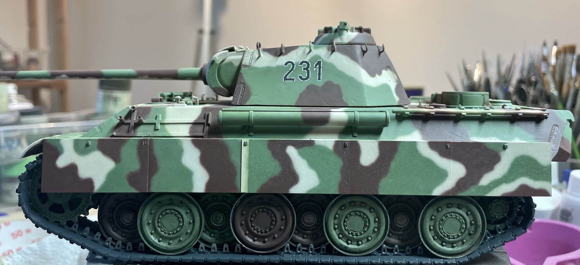

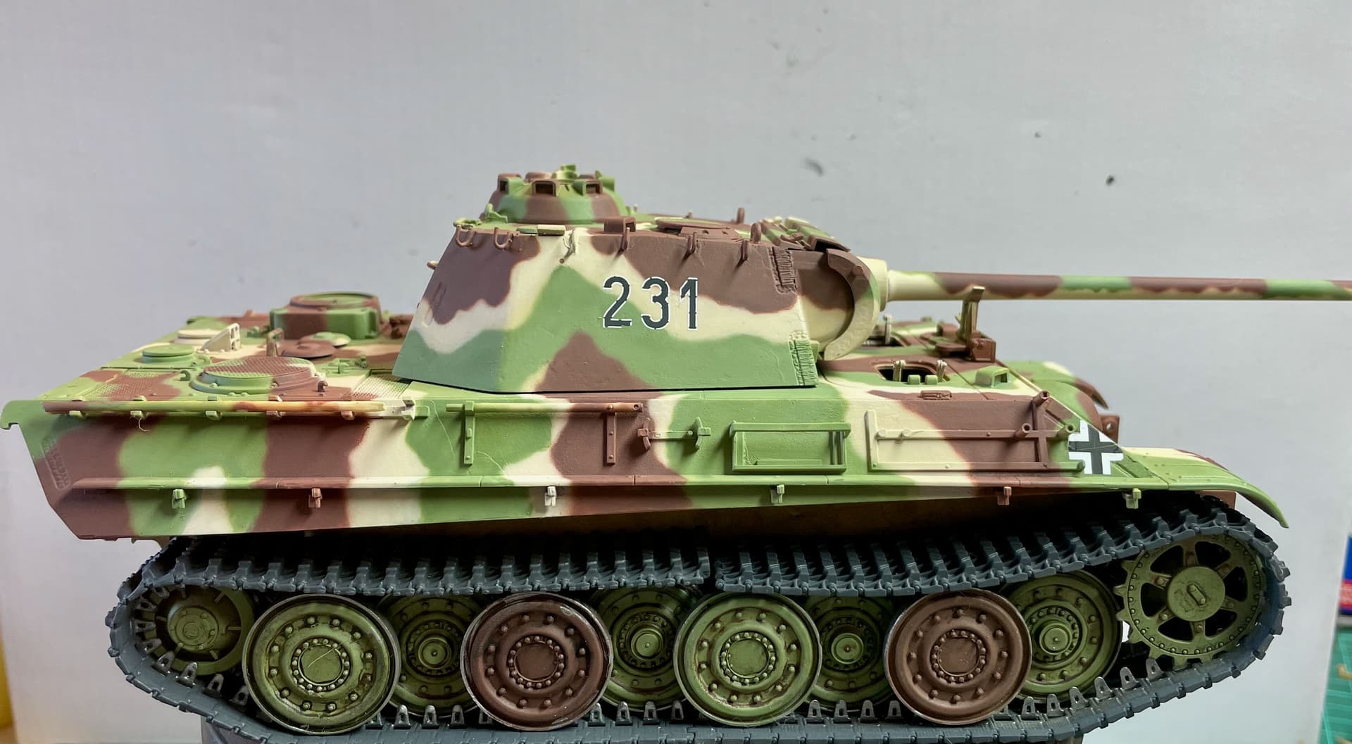

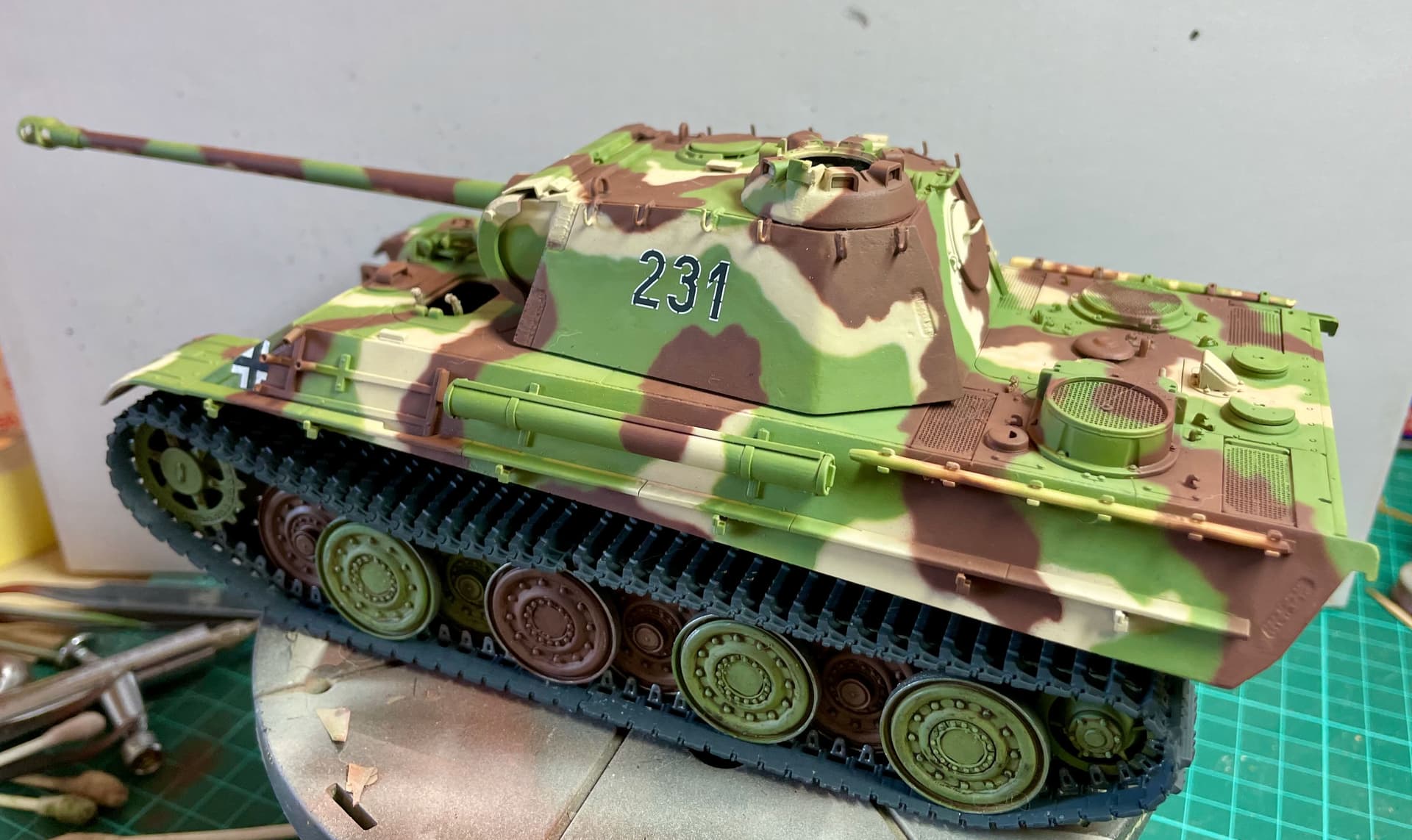

So I have worked a little to finalise the “basic” appearance of the 231.

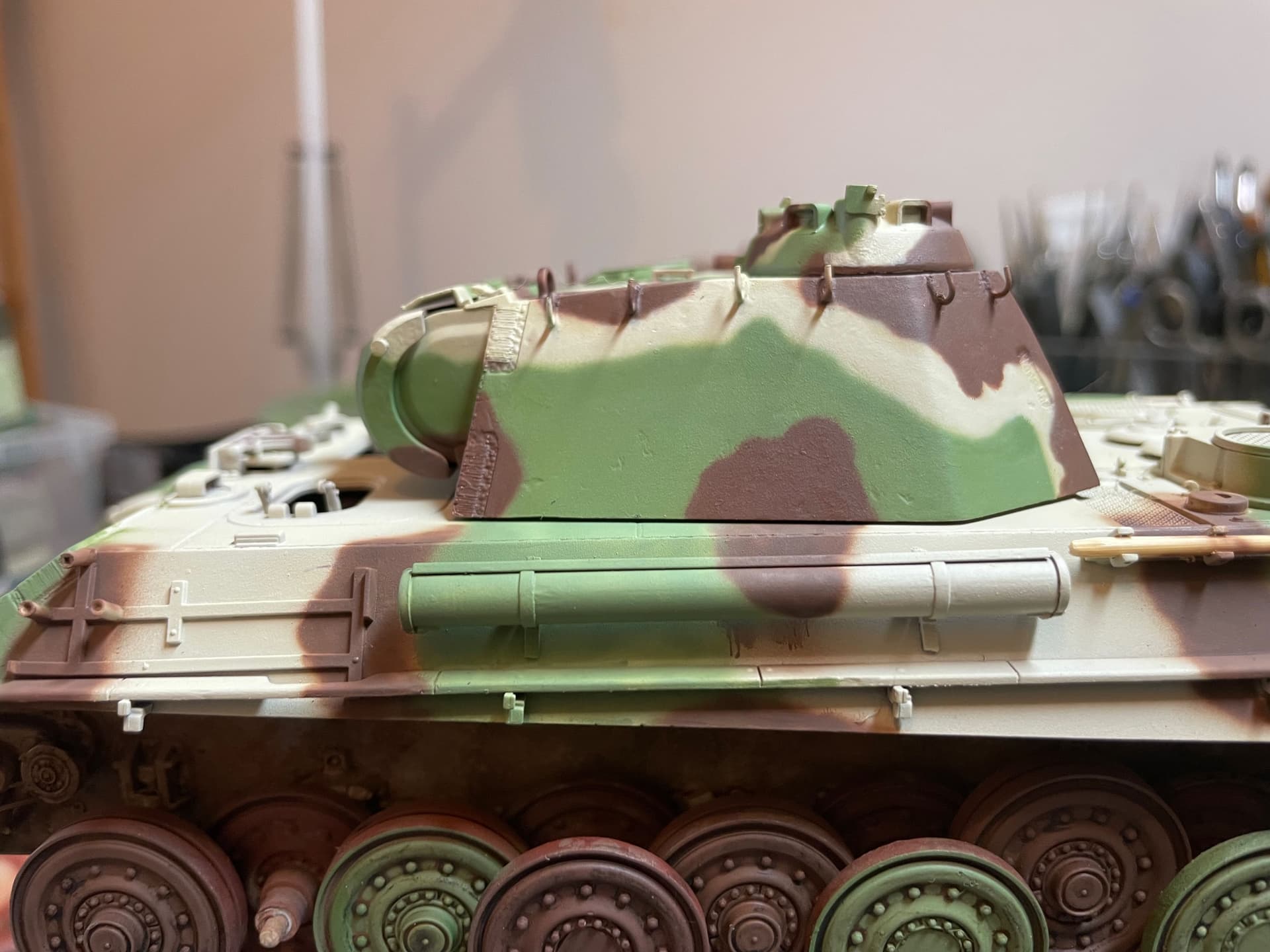

Adjusted the camo on the turret rear area a little … inspired by the combat fotos introduced.
Got the decals from ECHELON (Set AXT351034) on so far … I will attempt a little more research on the Balkenkreuz on which of the rear bins …
Already prepared the side - skirts, so they are next …
Christopher
So I’ve sprayed the side-skirts …
Left side is imaginary … “borrowed” most of that layout from the TAKOM camo recommendations.
The right side is challenging the original …
Still some “touch ups” to be done.
Christopher
That is some finish; “spectacular” springs to mind.
You definitely nailed the side skirts.
Stunning camouflage finish. Very precise. Outstanding paint work.
