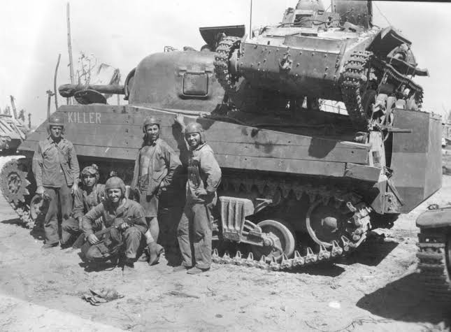

“Killer” M4A2 on Roi-Namur - the famous photo in 1/35
Hi all,

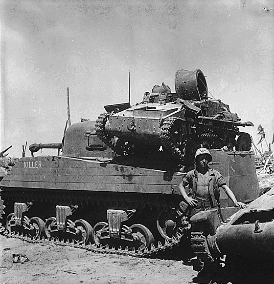

Like many, I’ve always found this photo of Killer and crew with Type 94 tankette on the back to be really interesting.

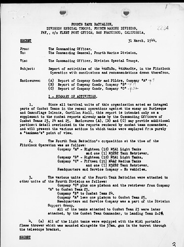

Next, focusing on the 4th Tank Battalion, I found this period document in the National Archive after some heavy sleuthing - MARINES 4th DIV - 4th Tank Bn Rep of Marshall Islands Ops.
This document is amazing and covers the Company C Shermans of which Killer was a member. The relevant pages are below with the link for further details and reading about the Stuarts in A and B Companies.
Short background
Company C

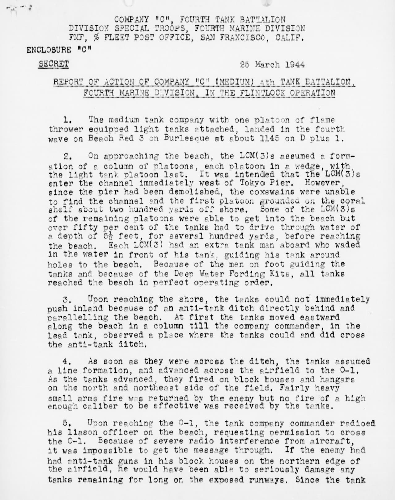

The Conclusions and Recommendations which follow the above includes fascinating info about Deep Wading Equipment and the wooden planks attached to the Sherman hulls.
https://catalog.archives.gov/id/78410090
For me, that document is an amazing action report…

That’s a great idea for a diorama and thanks for the background info.
I guess the obvious question that springs to mind is how on earth they managed to get the tankette onto the rear of the Sherman!
Thanks.

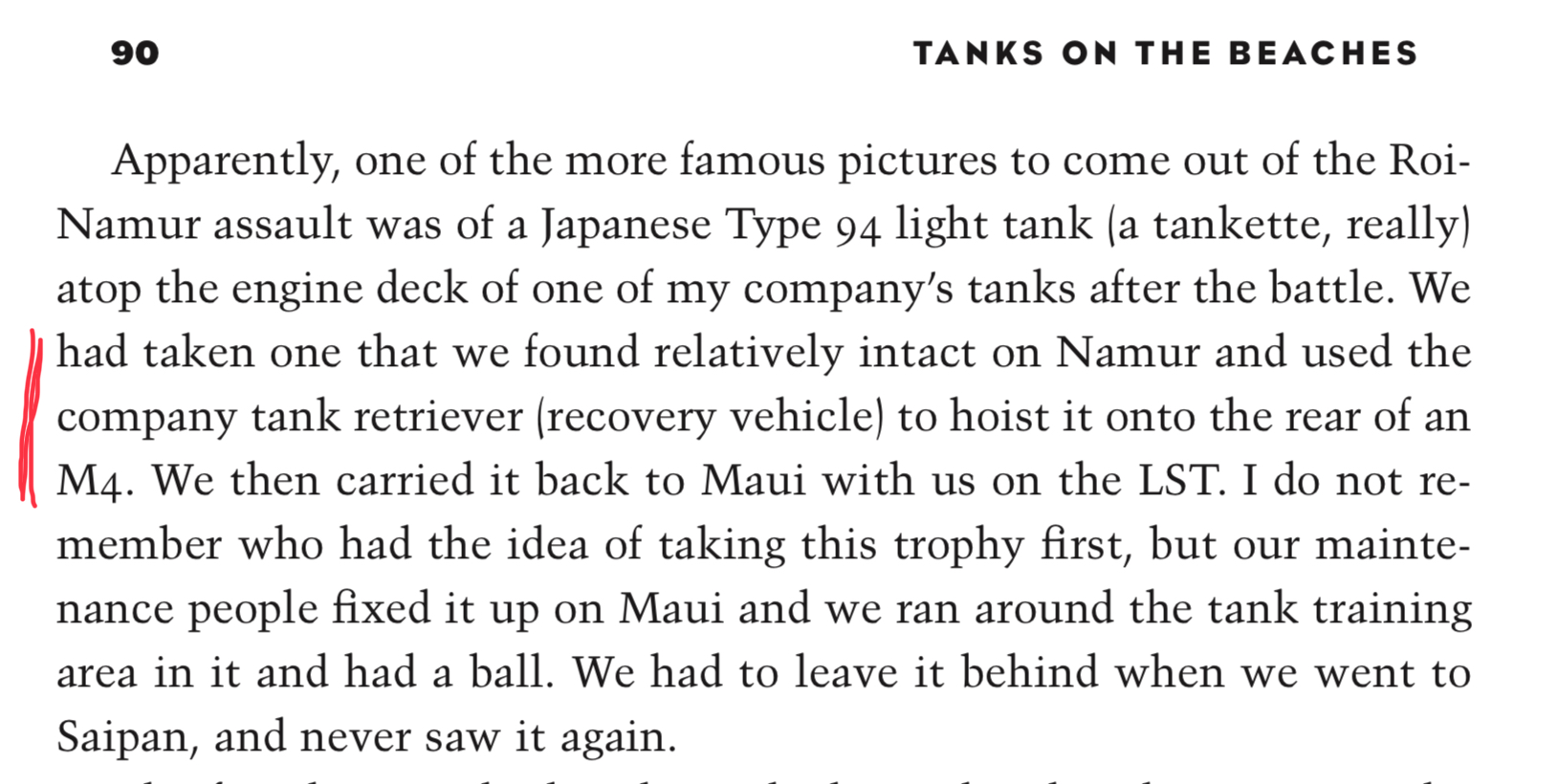

Company C had an M32B2 Tank Retreiver with them and it put it on the back of Killer. The source I found for this information is the Company C commander’s book Tanks on the Beaches aka this extract-
It may have been the M32B2 Lulubelle that was later in Saipan that did it.

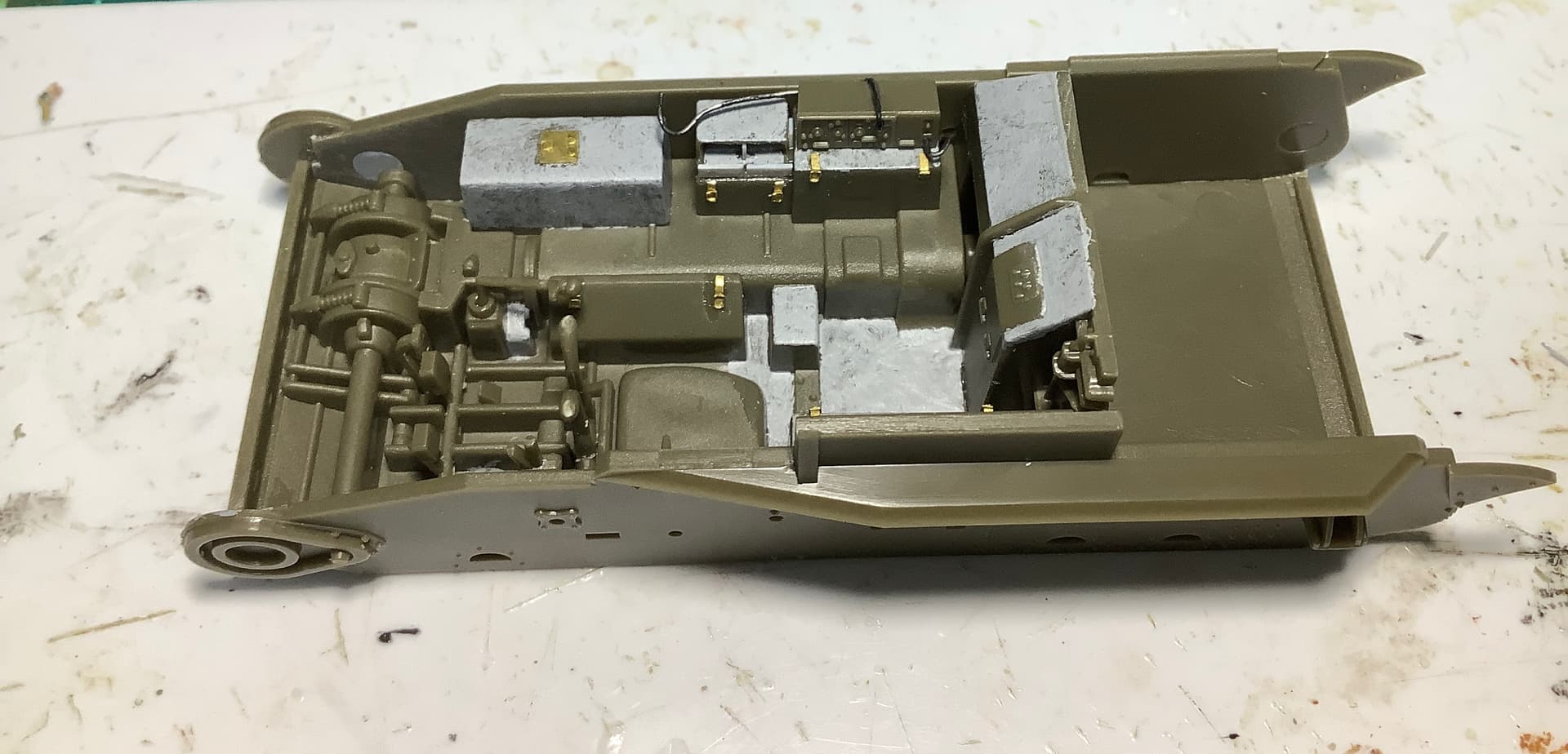

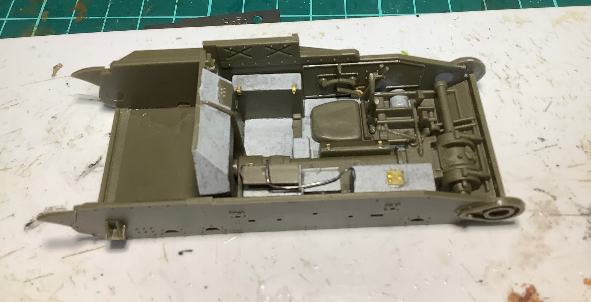

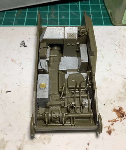

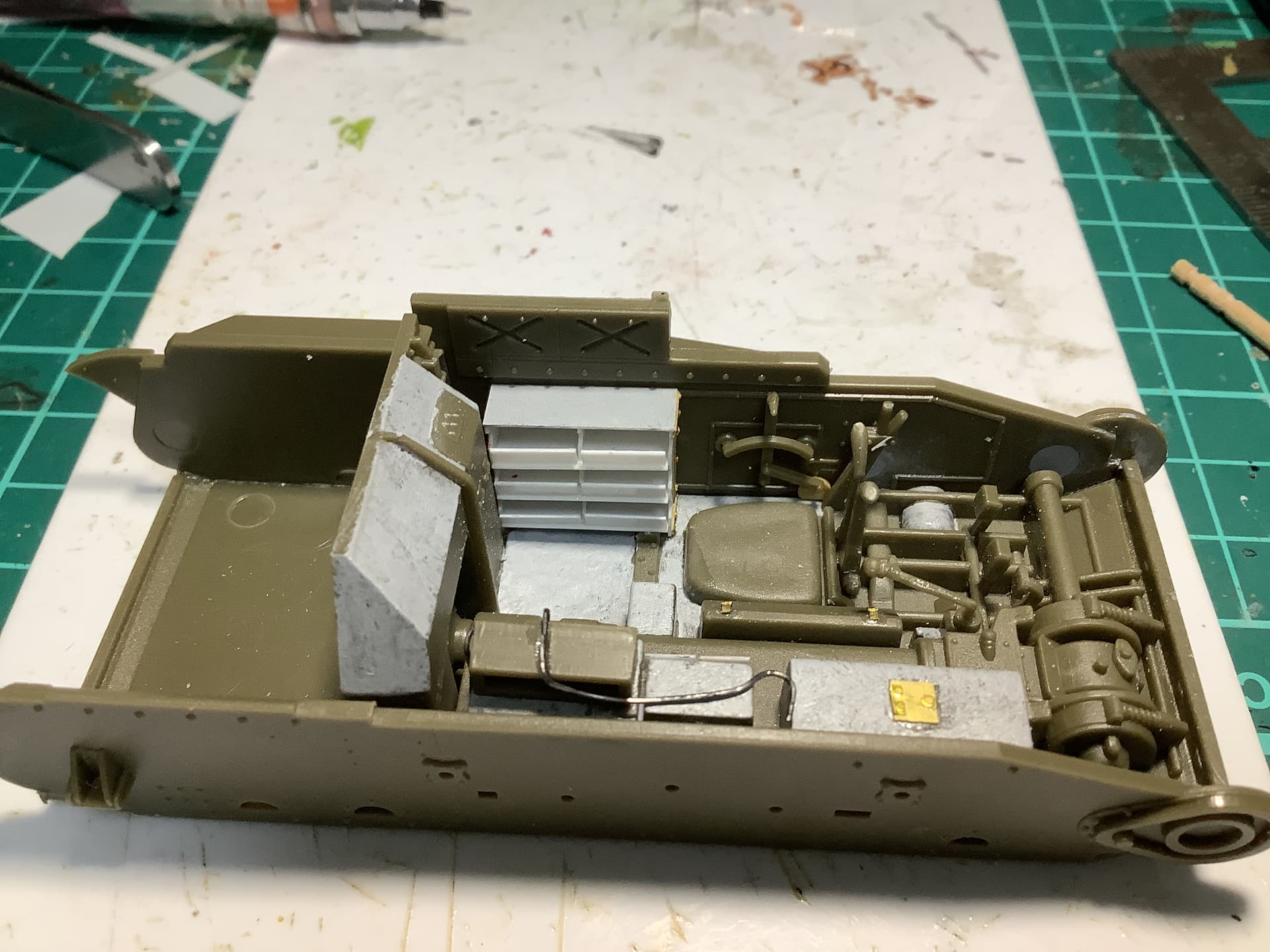

Actually, I’ve been again visiting your excellent diorama The Road to Singapore for inspiration re how you did the interior for the Japanese tank as the Fine Molds Type 94 is just a shell. I’ll get round to that build and the other tanks in the coming months/years…
I will have to check that out more.

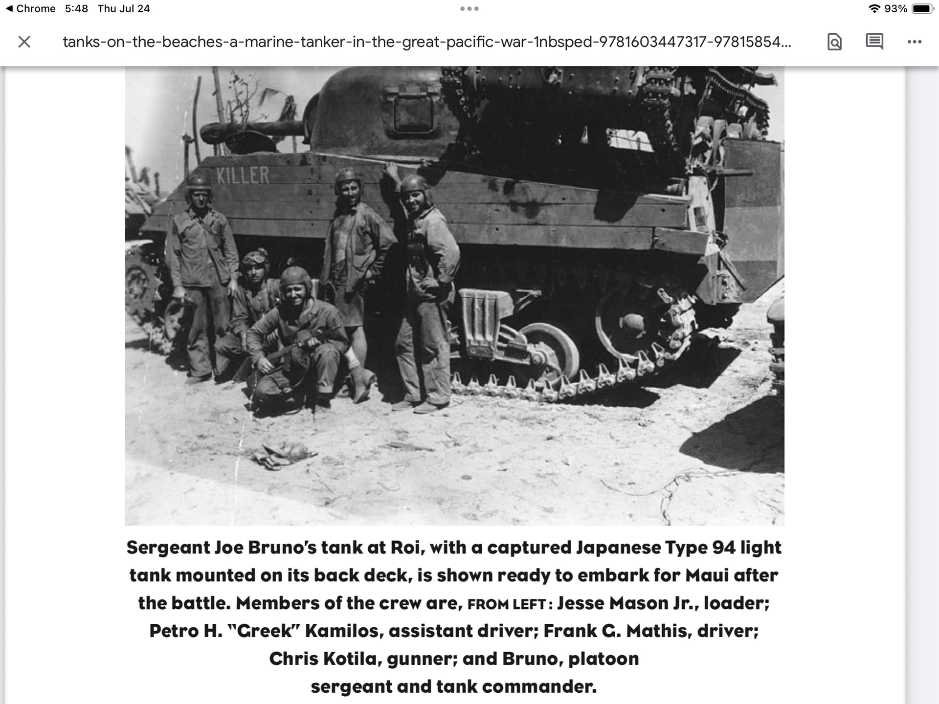

The book Tanks on the Beaches co-written by. C Company CO Robert Neiman that I quoted above has some very relevant pictures, 1 of which I had never seen before.
The best thing, though, is that all of the Killer crew are identified. Here they are:
Killer and crew, 3rd Platoon, Company C, 4th Tank Battalion.
If anybody has any information on any of these men or access to their service records in the US, it would be great to learn more about them.

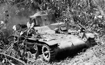

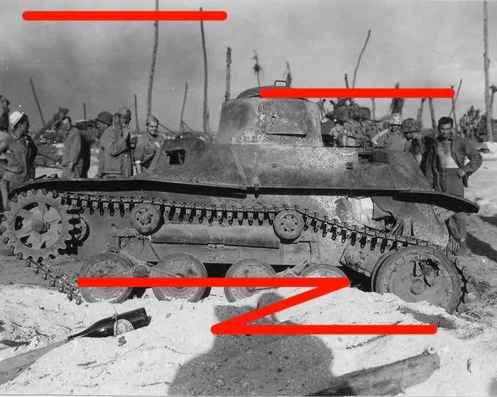

And here are the two Japanese tanks - a Type 94 TK and Type 97 Te Ke - prior to the Type 94 being loaded onto Killer’s rear hull.
Another well-known view.
Neiman refers to the locations Roi and Namur islands in referring to the event so it is not clear exactly where it occurred. I’ll stick with Roi-Namur….
And lastly, the tankette on Maui.

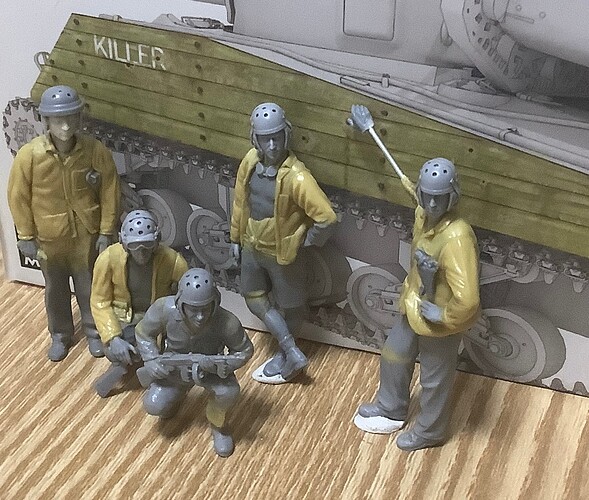

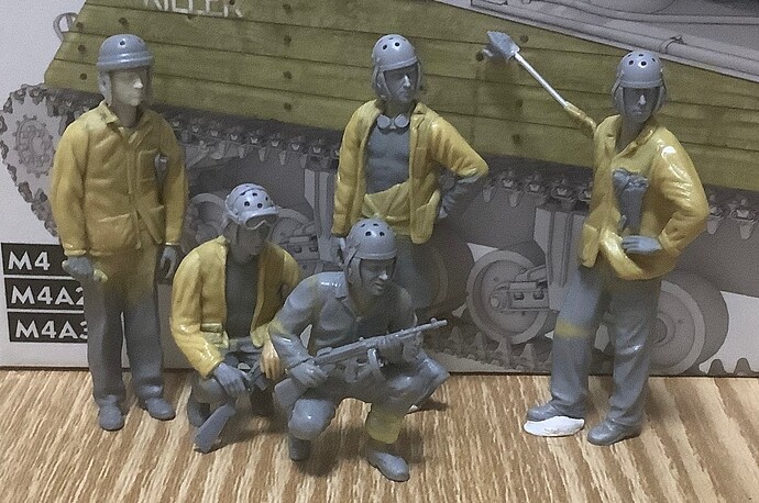

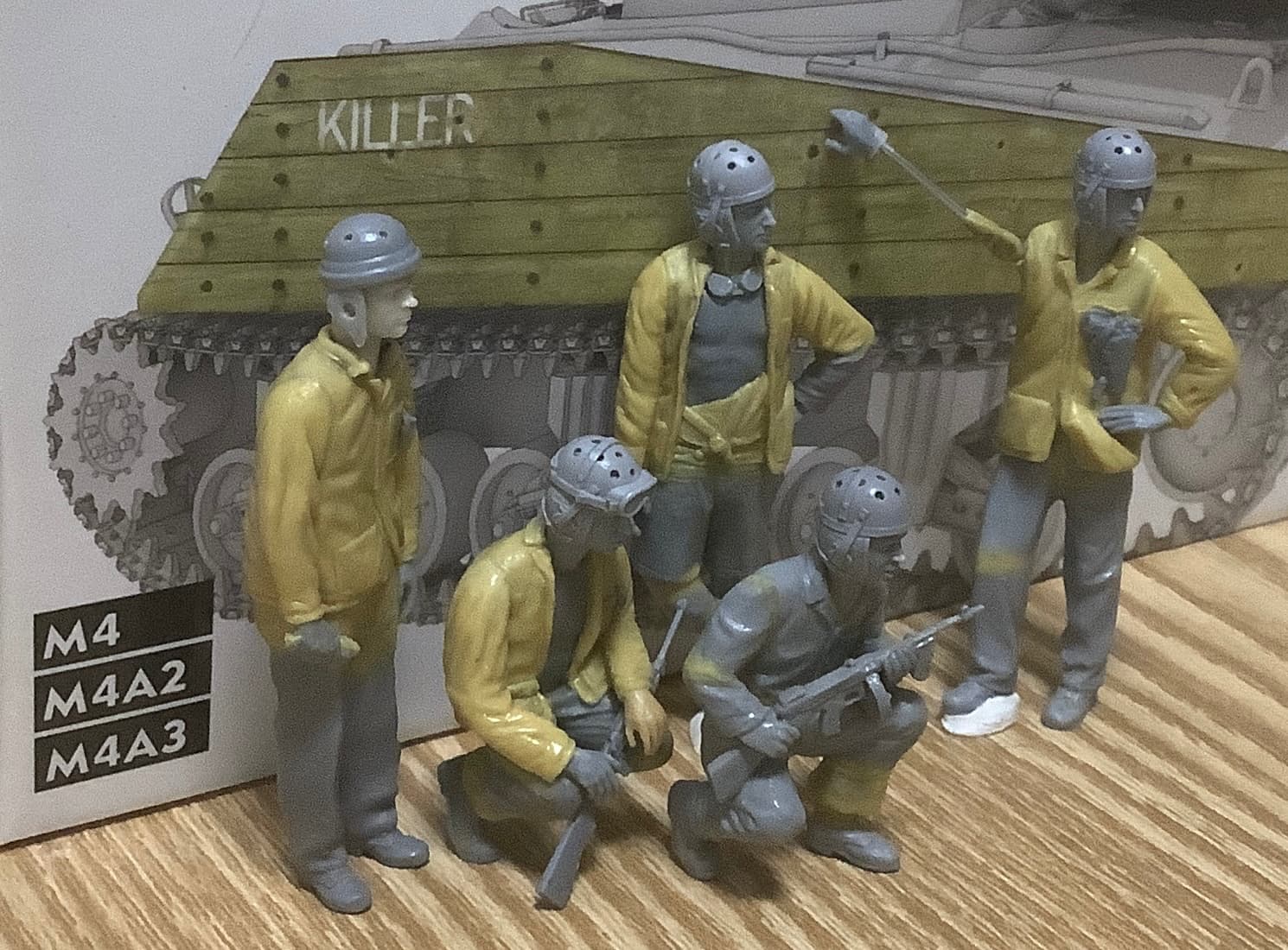

Pretty much finished the figures. I tried Tamiya Quick Type putty this time and found it so much easier to work with, mainly because the texture is stiffer than other putties I tried.
I’m pretty happy I could get a reasonable likeness to the original picture or my diorama based on the original photo was a dead duck.
Just some dog tags, laces and straps to do.

They look great. :+1:

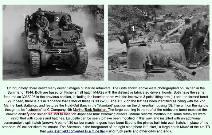

Here is Lulubelle, M32B2, after loading the tankette on to the rear of Killer.
Thanks. Yeah, they came out better than I expected, to be honest.
Excellent work on those figures Jeremy
Thanks very much.
It’s looking good.

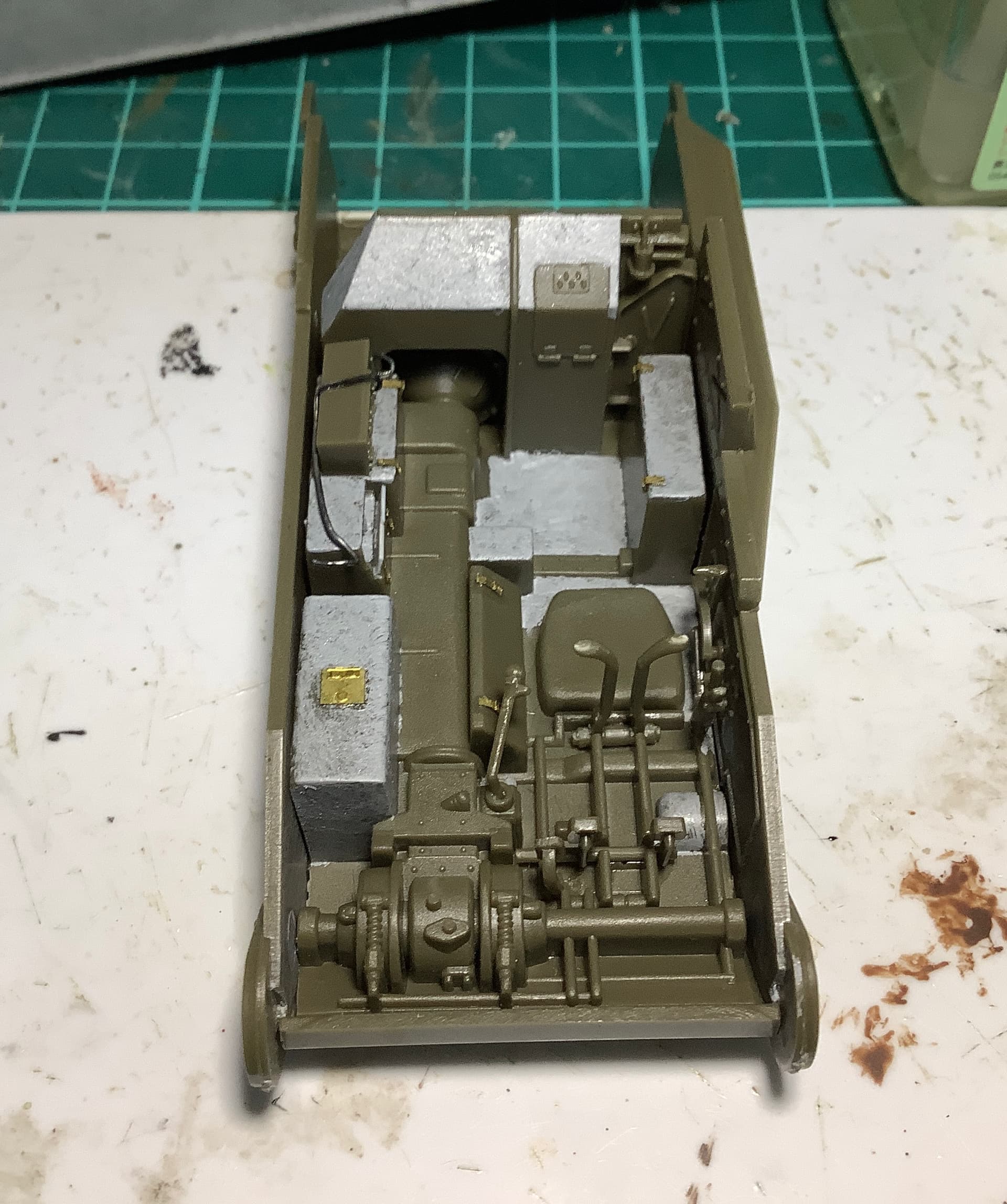

Got the main components to build Lulubelle, the M32B2 for Company C. Lulubelle is an M4A2-based tank with narrow hatches (only the Dragon kit is appropriate for this hatch type and not the Academy version) and T56 tracks, oddly enough. It is possible to buy the necessary sprues separately to do a conversion from Asuka, who have an M32B1 kit. We’ll see how well that goes!
Just found this great photo of the same destroyed T97 as shown in the other images posted above. Could be Killer in the background right.
