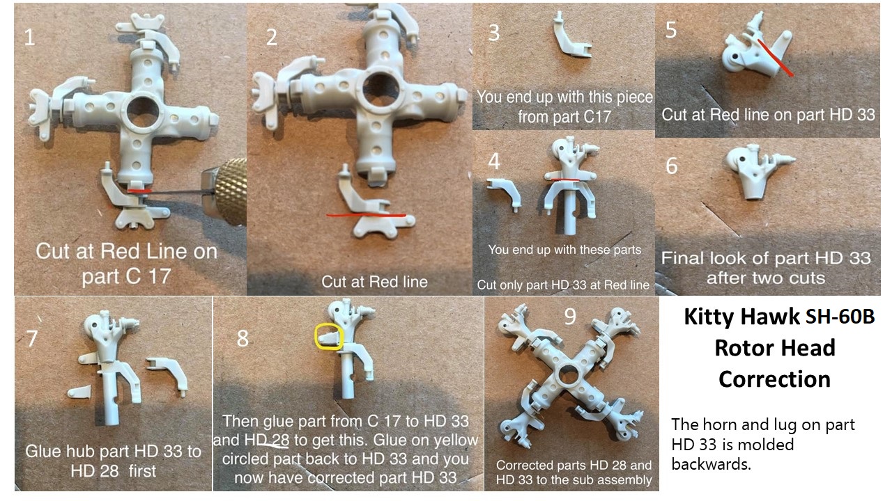

All Zimi has to do to make me a fan is to fix the Kitty Hawk rotor head and print coherent instructions.
What is wrong w/the rotor head? I have had no issues w/the rotor head. Do you mean the reversed parts on the SH-60B rotor head? If so, it was fixed in all subsequent SH-60F and later boxings. I don’t know if the Zimi SH-60B has the new parts or not.
Two of mine have the bad rotor heads, so that is indeed what I’m on about.
I have that printed out for when I get to that assembly stage, but I still shouldn’t have to make that correction.
