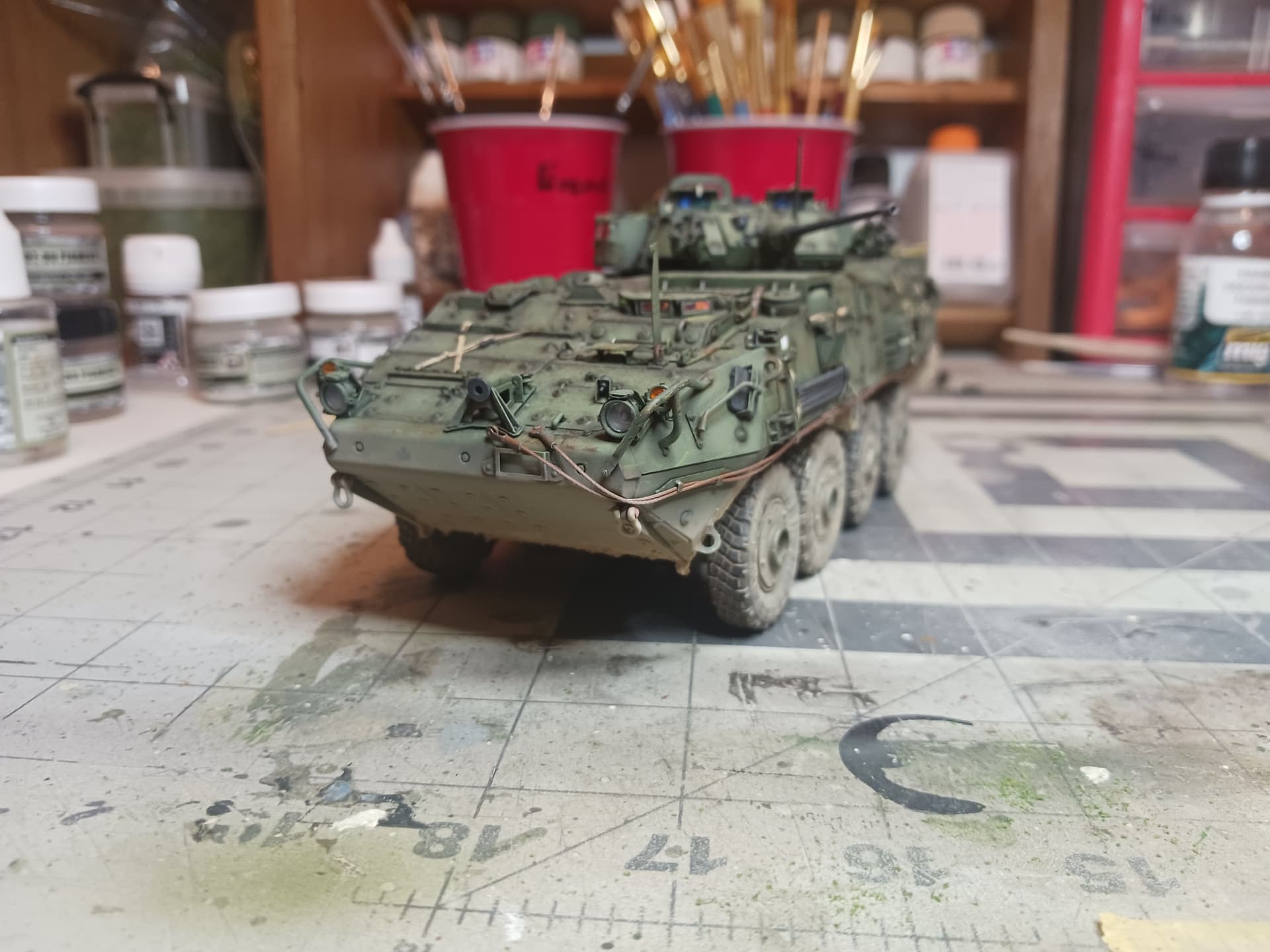

This is where I started to try and do the dust on it and that sucked really bad. The very matte surface absorbed the enamel dust I was using and would not blend out. SOOOOO, I ended up covering it up with my airbrush in big disappointment. It just felt too strong.
As you can see the dust is just too strong and I ended up using oils instead.
I also plan to go back and revise all this. The photos above represent a test to see if oils would work even and I was willing to go through with it. Like I said I am going to gack and finish it up. The turret in the pics is finished and here are the pics of that.
Any Critique especially on the turret is welcome and appreciated!

Could you share the method you used for the dust? I have a Canadian Leopard C2 in Afghanistan I need to weather and this is the exact look I am after

I airbrushed the dust first with Tamyia Buff and maybe a splash of something else, I don’t remember. I then use oil paints, again buff, and flat earth. On the turret that is all, I used for dirt and dust. On the hull, I also used AK dry ground terrain paste for its base texture.
