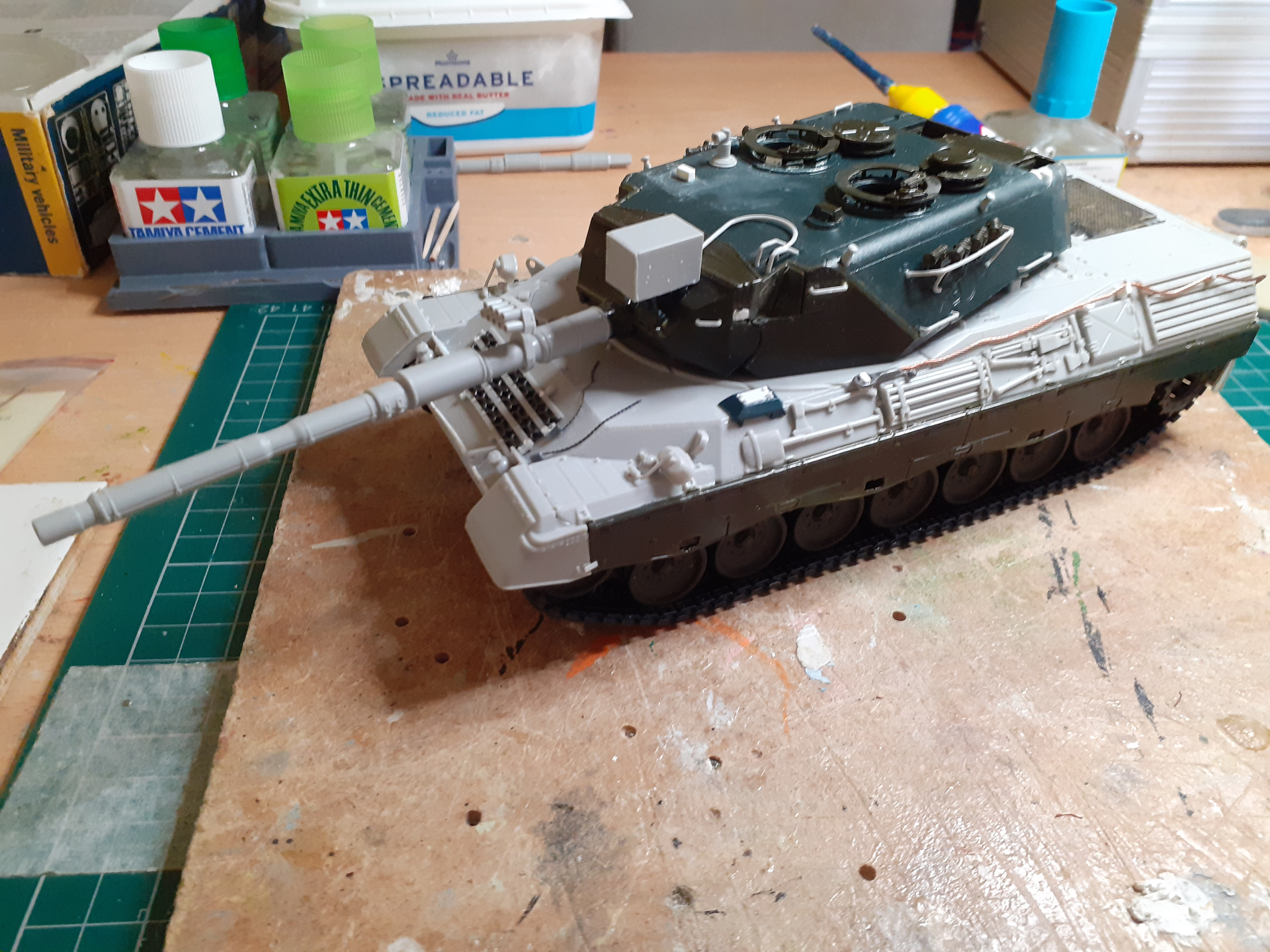

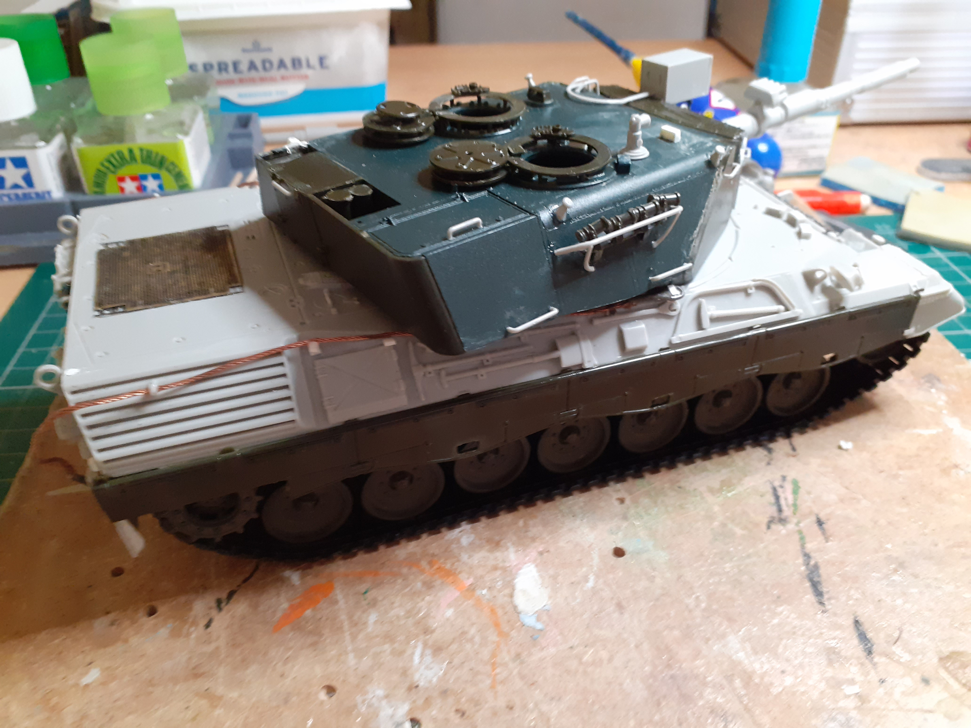

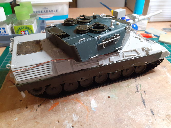

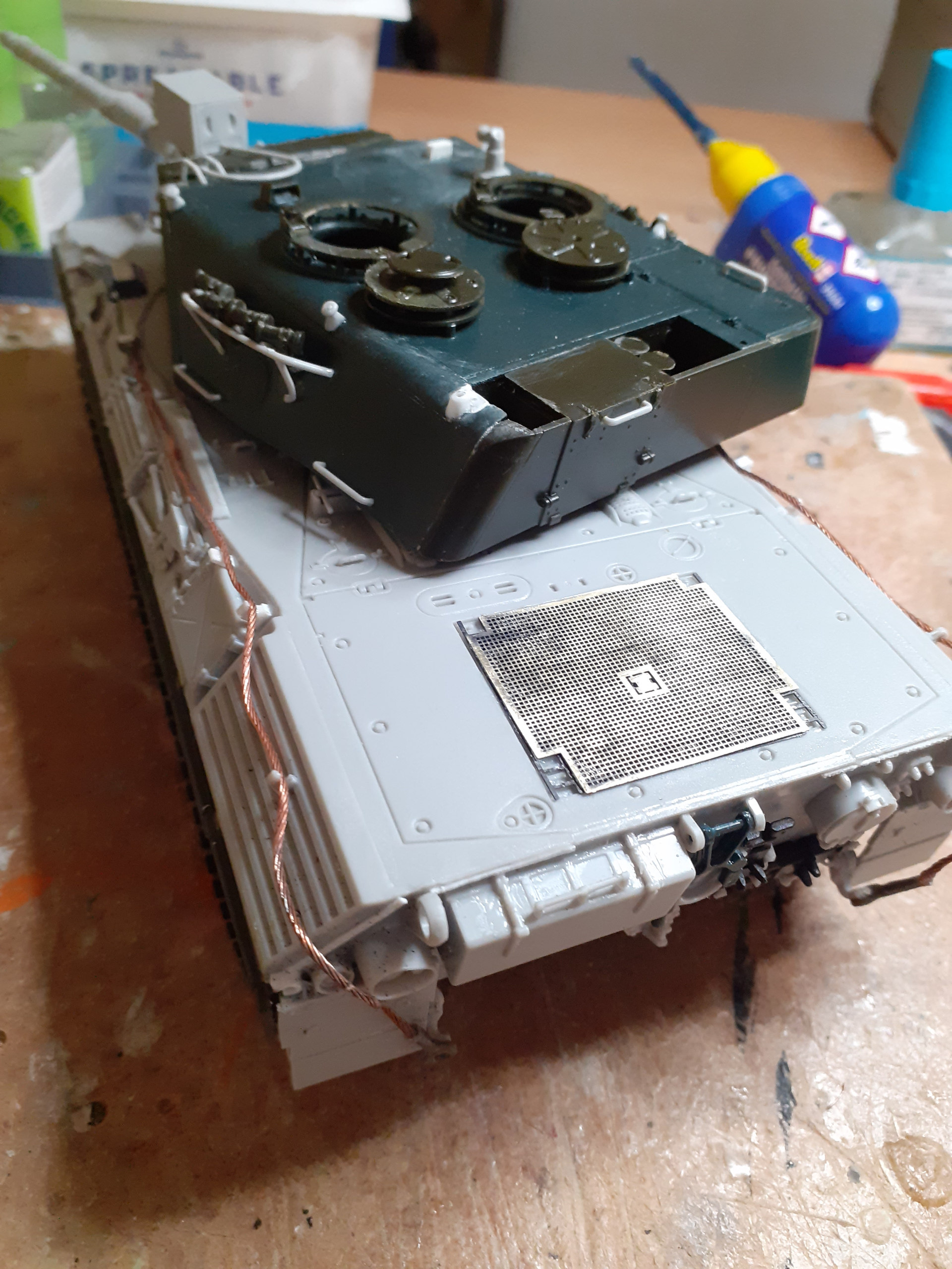

Hi friends.This one ive been working on past fortnight.This time a Leopard 1A3 Bundeswehr.Took the light grey hull from the Leopard 1A5 from Italeri plus a mishmash of parts from my Leopard spares box.This one went ok as i had beefed up the idlers and Sprockets with brass rod drilled through the mounts.I scratchbuilt the tow cable mounts and added the gunners sight and shorter periscope mount.Few more bits to do like adding sprue to canvas mount as Italeris leaves a gap when mounted on turret.Happier with this one so far.Painted the chassis and wheels by hand with Tamiya XF51.

Thanks Jakko.Still got a bit too do.Got the close in weapon blanking plate to add on turret top and ive been told my TRP sight is too tall,Will check my references as i used a shorter one from a 1A2 kit.
Cheers mate.
The TRP is too tall, yes, now you mention it. It needs to be just tall enough to look over the gunner’s periscope. The part you have looks to be from a 1A5, which had a taller housing for the gunner’s sight.

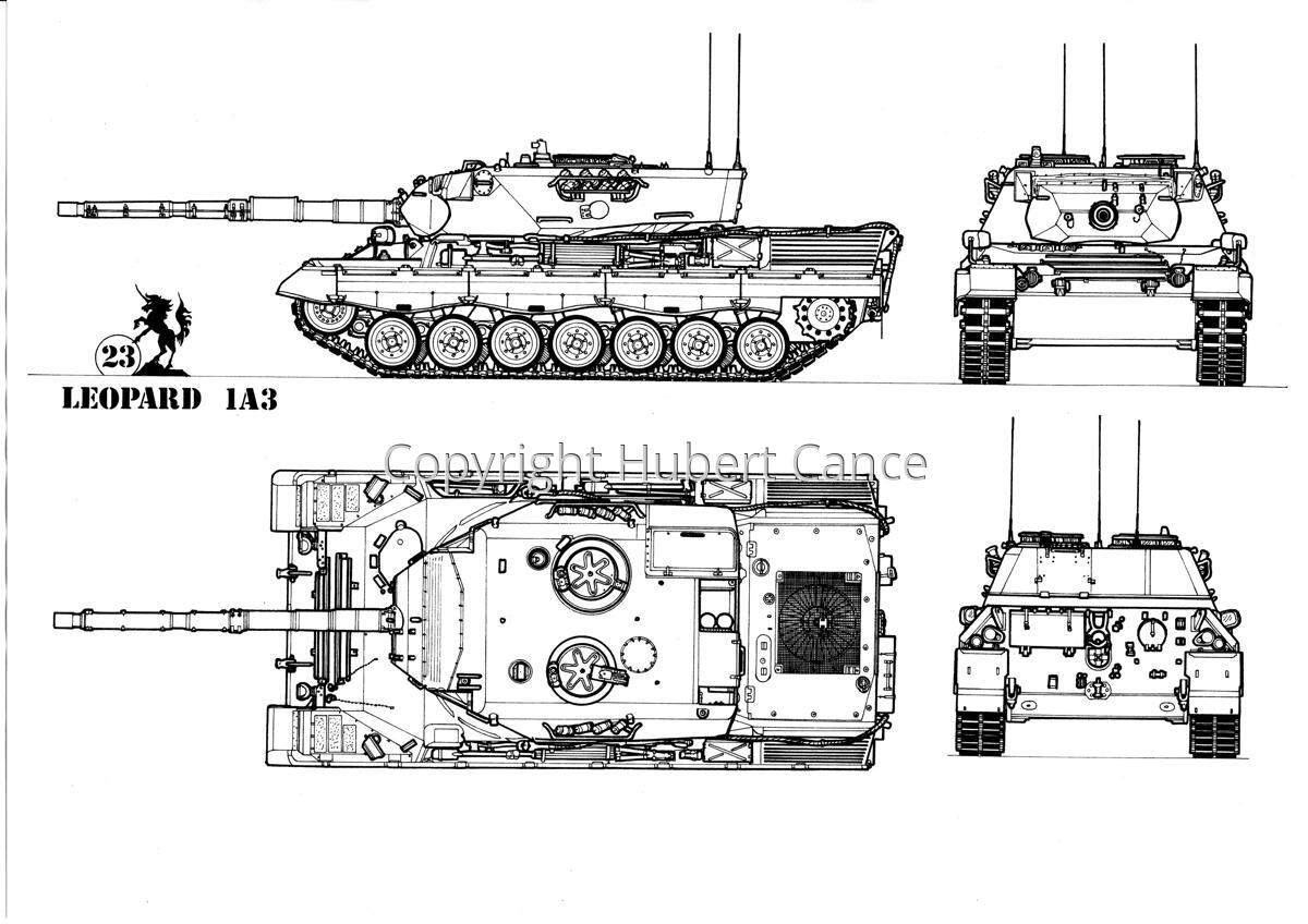

Also, something I just noticed (and was probably aware of twenty years ago :slight_smile:): there should be a round plate in the turret roof behind the gunner’s hatch opening, for a close-defence weapon that was never fitted. You would see it poking out from under the open hatch on your model — see this drawing that I found here:
In 1:35, the plate is about 9 mm in diameter with a 1.5 mm edge around it, according to the drawings in The Leopard 1 Trilogy.

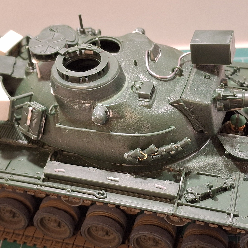

Nice work Richard; I’ve been hors de combat for a bit but you might wish to consider some chains on the smoke dischargers. They’ll (inevitably) be overscale a touch but will add something I feel:
Fiddly work but worth it I feel.
PS: Yours - unless just lodged in position - may need a bit or repositioning - from where I’m standing that is)
Hi Brian.Nice of you to drop by.I did consider adding the launcher chains from the Eduard 1A2 etch set.I seem to struggle getting the launchers in a good position.I will leave them as id end up breaking too much.I think the rails over them wasnt such a great fit.Might end up redoing them as ive got fair few spares.Sometimes the Italeri ones are moulded a bit short
Well, good luck with whatever you decide; I hasten to add it wasn’t meant to be a piece of micro-managing.
