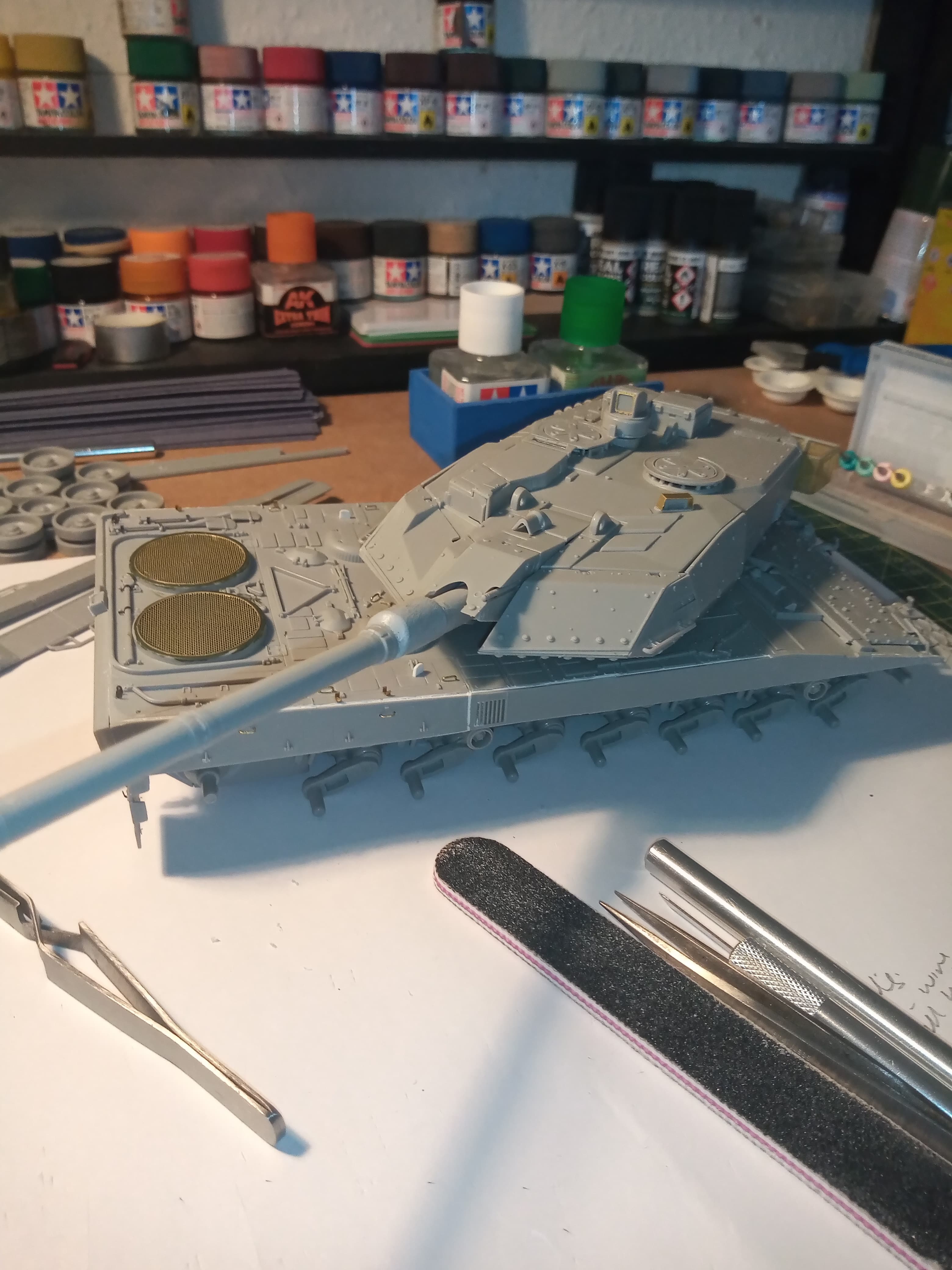

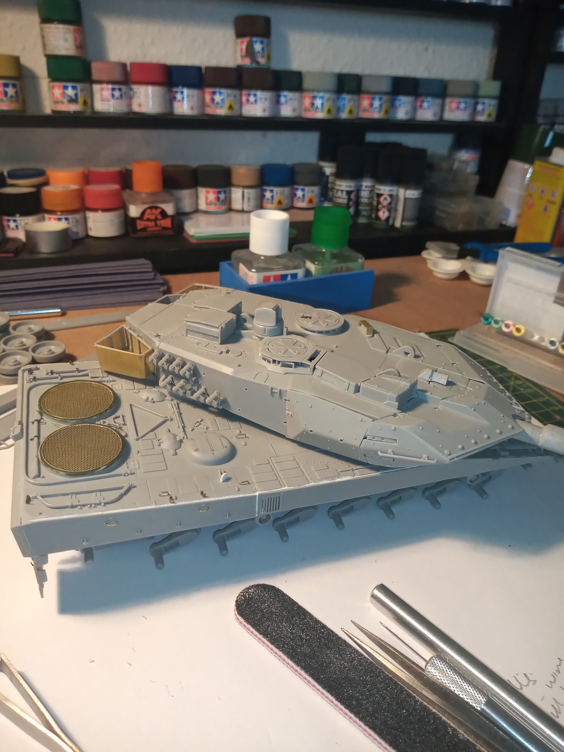

Aside from all the issues, it’s building up ok…
And I need to order that decal sheet as well.
I’m not sure if you’ve encountered this yet. When I built mine the turret impacted the air intakes, especially once the slat was added. It’s known that the top piece of the hull bows down slightly. I had to put a brace inside just behind the turret ring to the floor. this kept the hull top level and the turret with slat no longer hits the air intakes (or anything).
Good to know Ian, many thanks :+1:

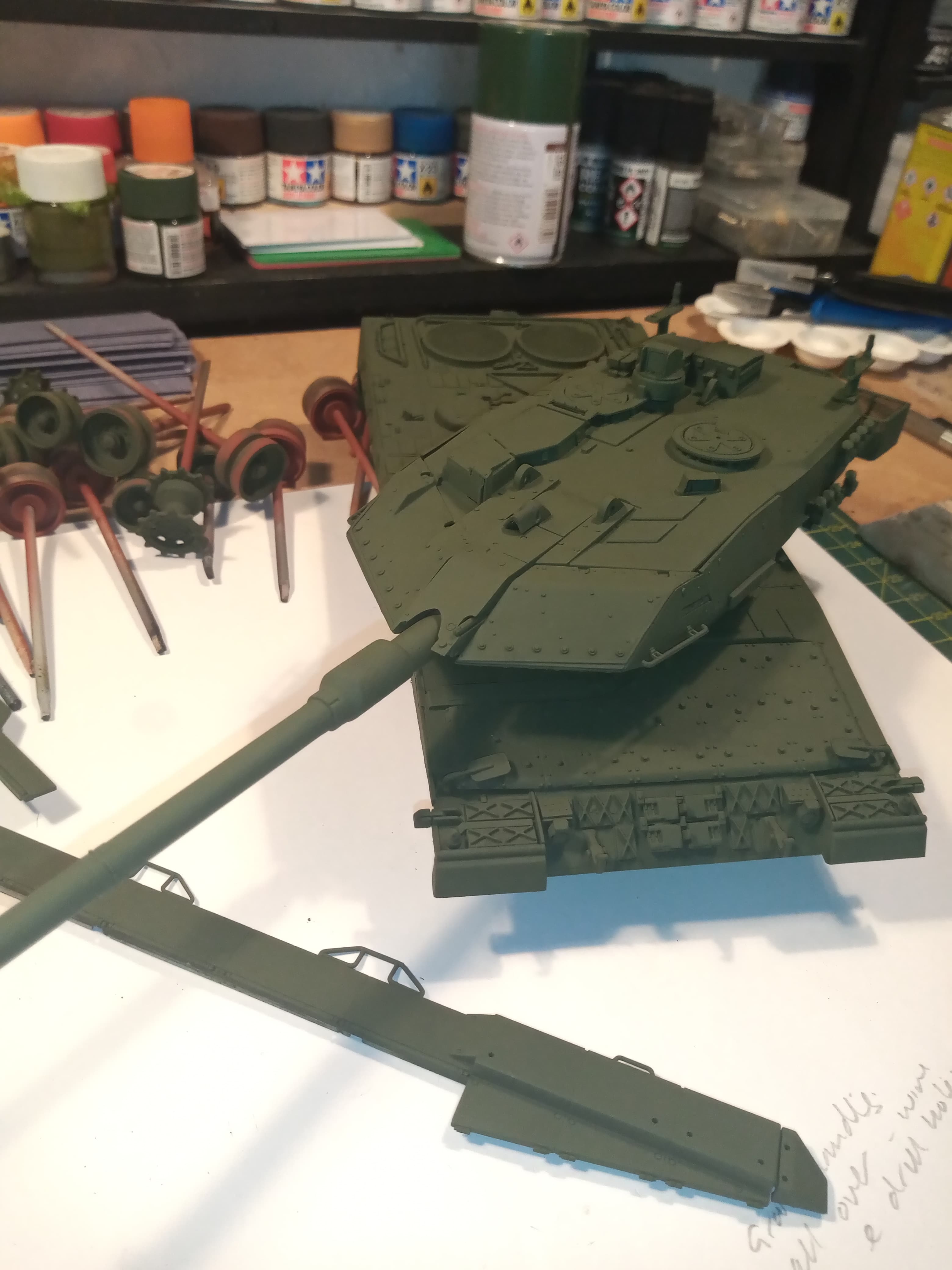

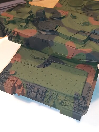

Phase 1 of painting done … Green is on…
Ended up having to use Tamiya XF 67 as I’d unknowingly run out of AK NATO green…

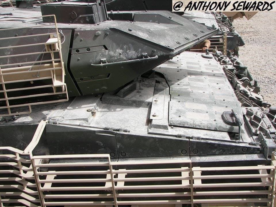

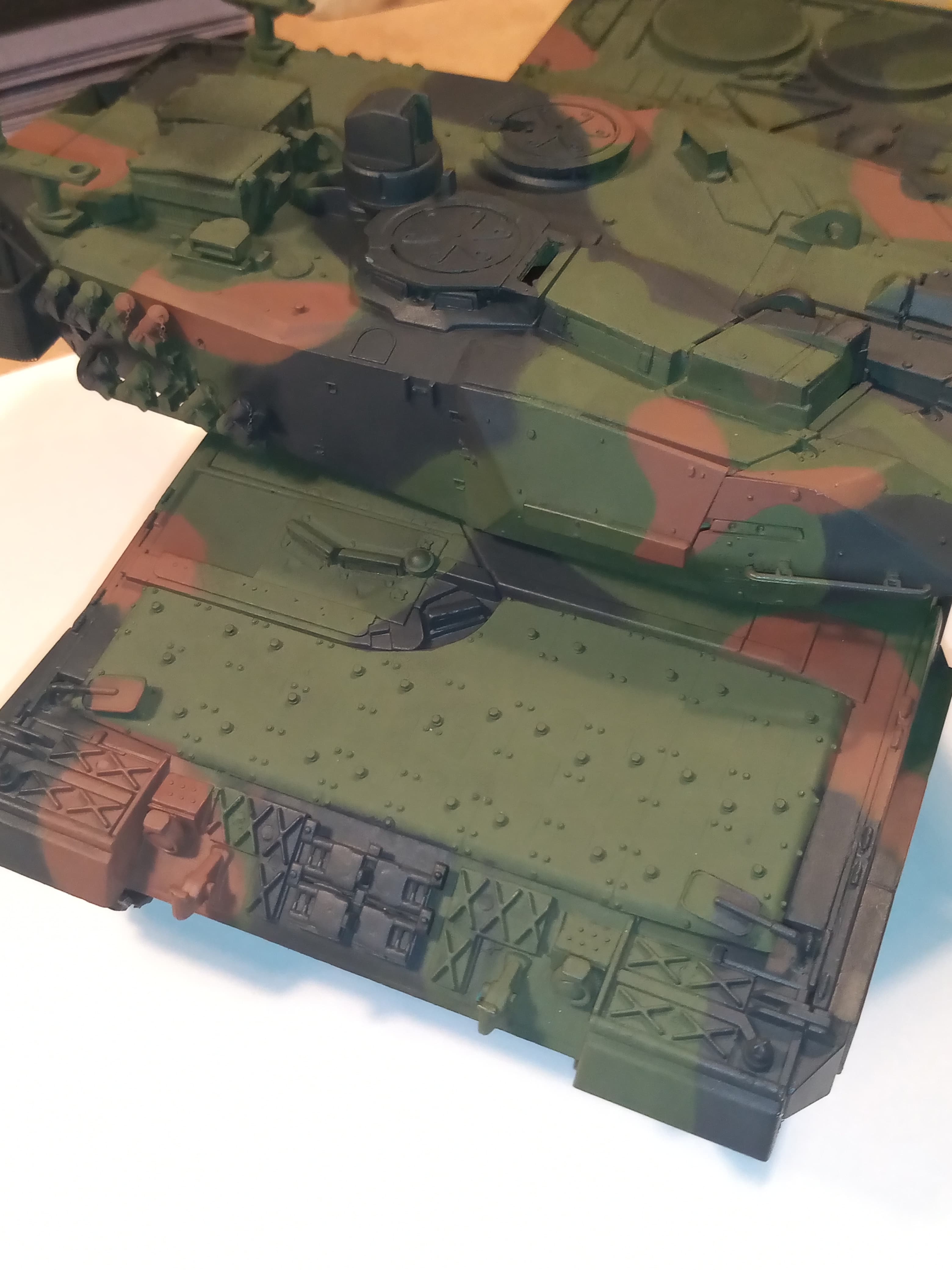

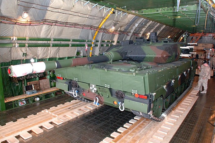

When adding the NATO cam, leave the extra armoured upper hull plate in green. It was never painted , even though the instructions tell you to paint it.Photo when they arrived in Country( Kandahar , Afghanistan) in late August 2007
Here is another reference photo for you, showing the green add on armour on the upper hull in plain green,
Great info Anthony, many thanks mate. If you have any other info on the wagons you used, feel free to point it out :+1:

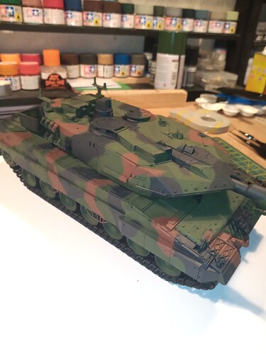

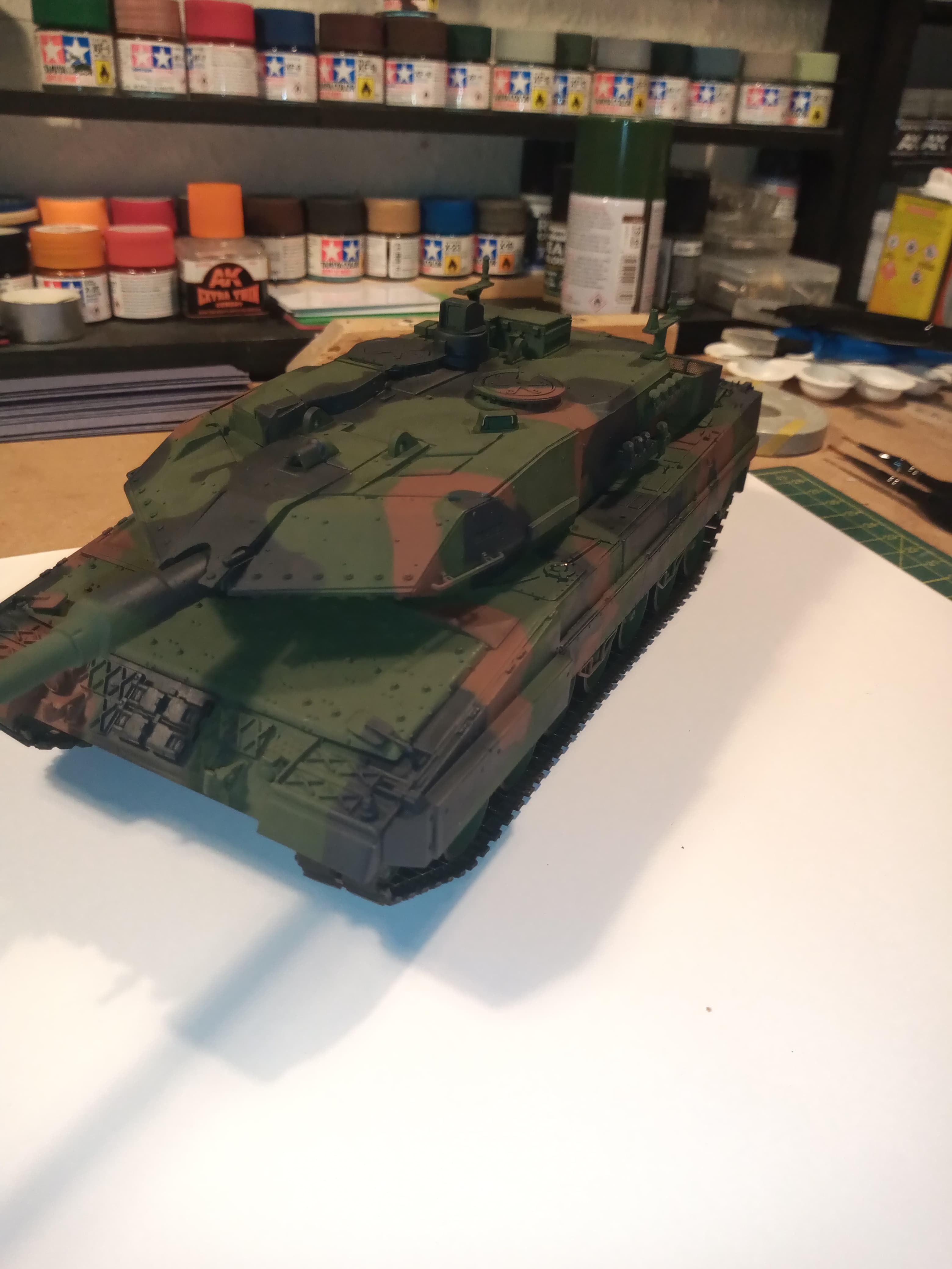

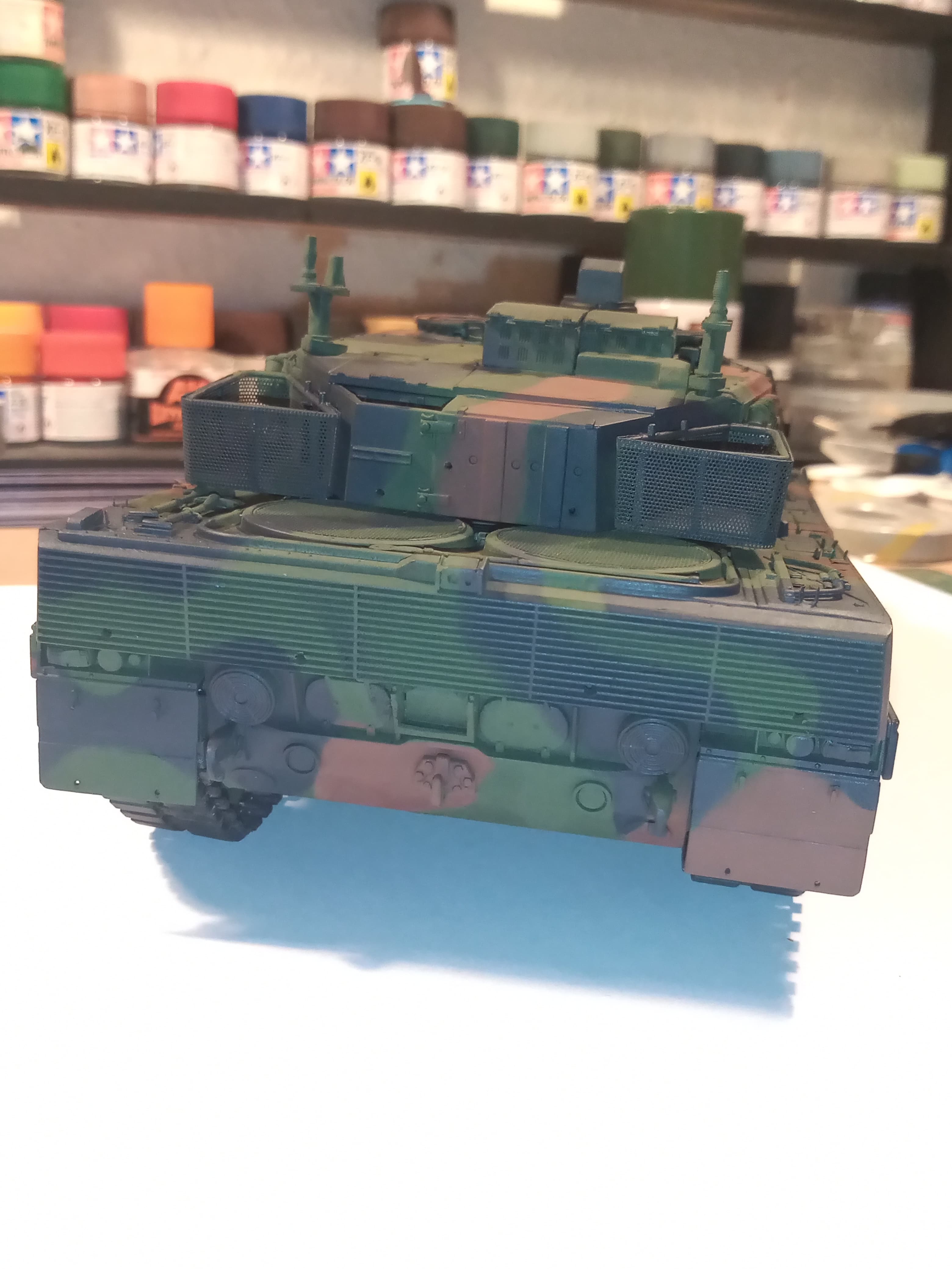

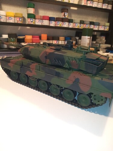

3 tone is on and now begins a ton of detail painting but along side that, I will make a start on the flat armour…
And a shout out for Anthony @AD_Sewards regarding the front top armour and staying green.
Looking good👍
If you’re going for an “original” off the plane version the sides and back were also straight green.
