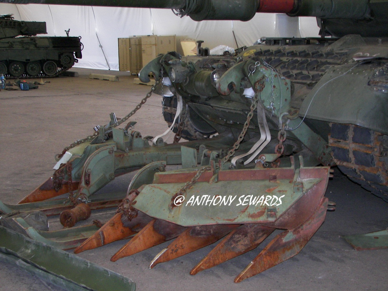

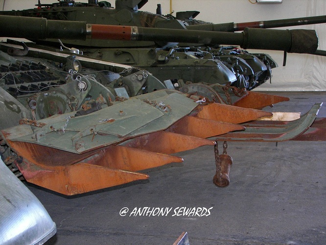

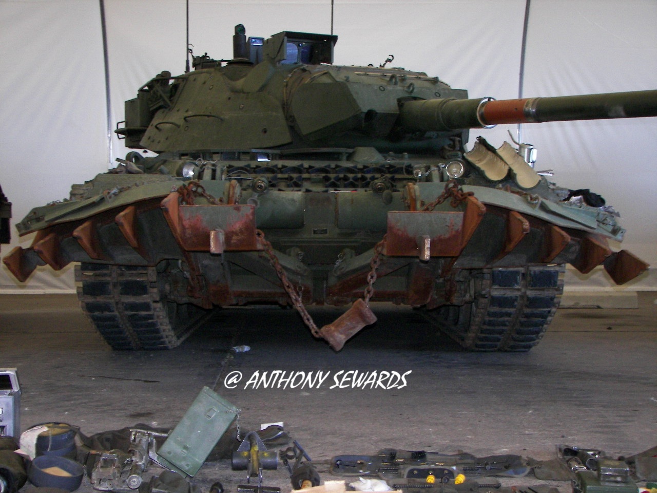

Here are a few teaser photos of one of our C2’s fitted with the mine plough….. Photos from August 2006….

That rake looks pretty cool. I didn’t realize that the HB kit is so solid.

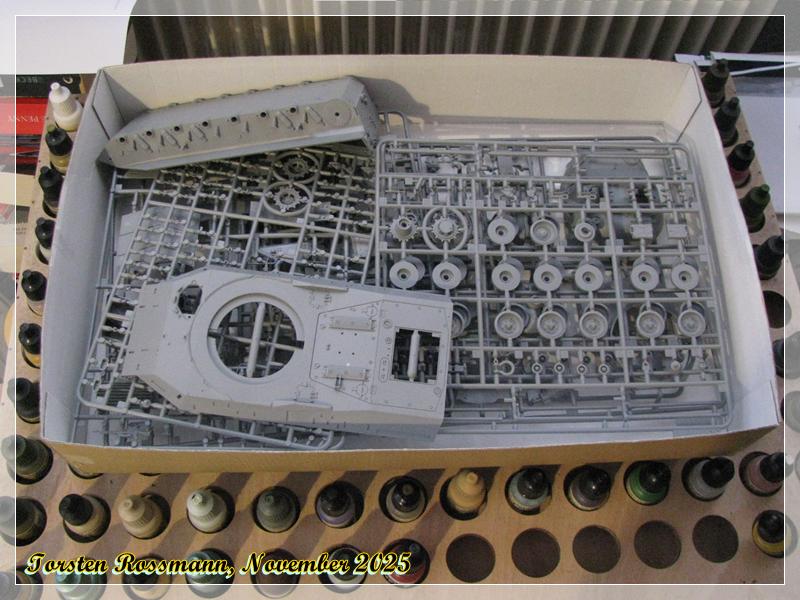

Okay, after some delay I’m ready for take off … :rocket:
aaaand action …

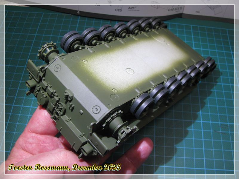

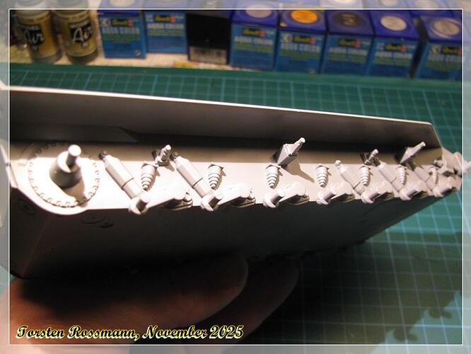

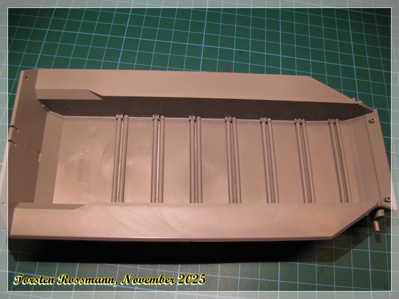

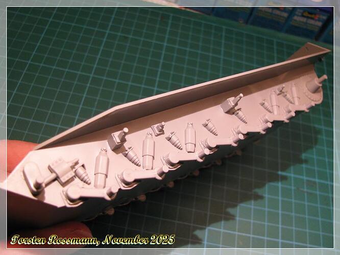

First parts on the lower hull are done. The parts have some annoying seams … :roll_eyes:

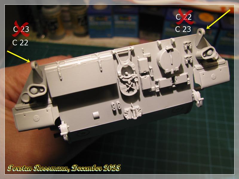

Takom mixed up the eyes at the rear in the intructions. Parts C22 and C23 are vice versa. It looked strange on test fitting, so I had a look in my Tankograd Leopard 1 book

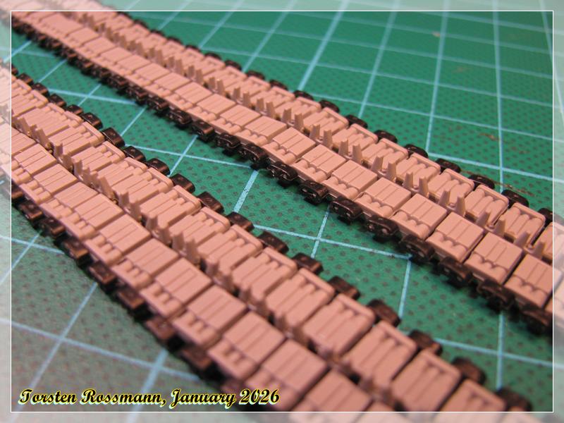

Jay, @JayJHCruz how many links have you used per side on your Leopard? 90, 89 or less? :thinking: Sprue T has 180 links and 180 teeth …

My apologies, totally forgot to come back to this thread. But I come to 81 links per side. So that gives you some spares.
Leopard 1 is supposed to have 84 per side though, as far as I’m aware, but it looks good on the model and the top run is invisible anyway.
Thanks Jay! So I will start testing from 80 links onwards. Takom doesn’t mention it in the instruction.

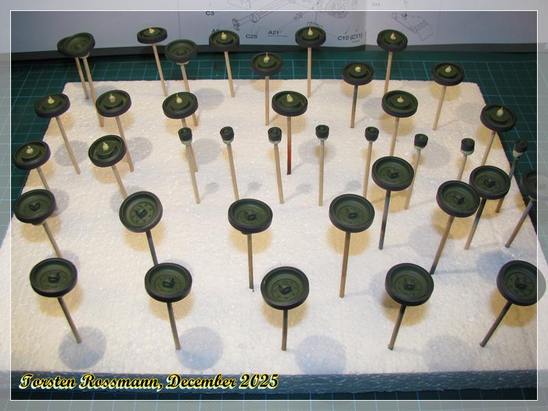

Today I painted the lower hull and the wheels Bronze Green. Will show you pics asap.

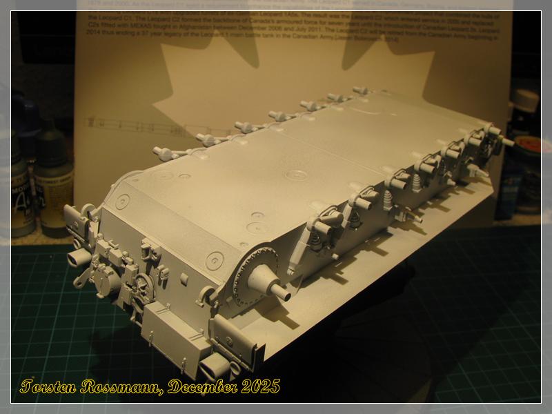

Sorry for the long delay of my postings here, guys, but everything is going slow these days. Life always gets in the way of model building and I also have my Saab J 21 on the bench which is a creepy kit. But I will win … :wink:
Anyway, first primer over all …

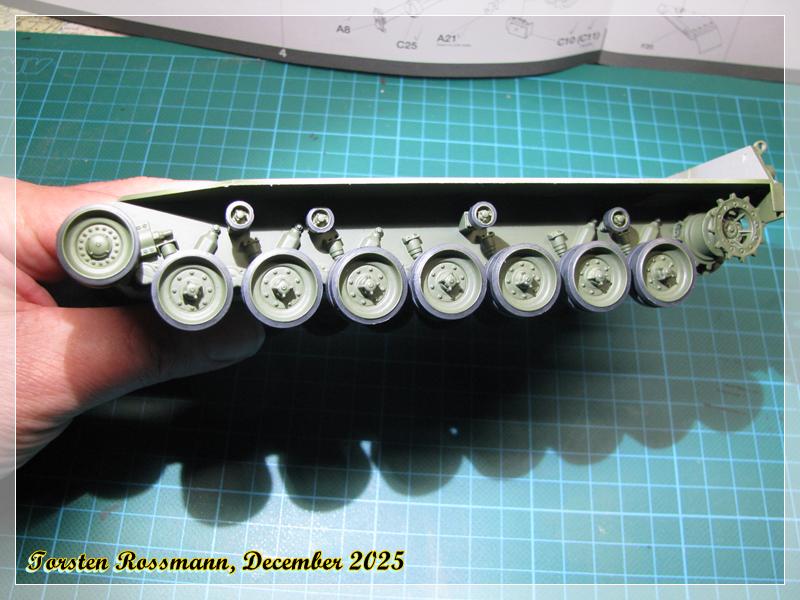

Then I sprayed Vallejo 71250 Bronze Green. The rubbers on the wheels are brush painted which took quite some time. For rubber and tires I always use Revell Anthracite 36109
and finally assembled. This part is done … :slightly_smiling_face:

Guys, I hope you don’t think this thread has died. I know, it’s slow progress, but even slow progress is progress :grin: I took care of the tracks. Putting the links together was an evenings work, but to cut the parts off the sprue and clean them is very time consumpting. After some testing I found out, that 83 links per side fit well around. So here are both tracks ready for painting which I will start tomorrow …
