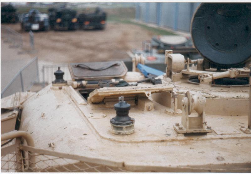

Hi All
the Centurion decks are UNIQUE to the AVRE 165 mm reason is that the rear section where the normal air vents would be is now a extend and houses a 100gal fuel tank . the pictures show the fuel tank and the extension which is enclosed not like Amusing WRONG kit of a AVRE.
the AVRE are all converted to Mk 5 standard and some have Mk 3 in till build and mk 5 turrets .
Mark 8 engine and gearbox deck are the same Has MK 7
Mk10 engine deck again unique was the the final build batch these decks can been seen on iserali tanks as well .
Centurion AVRE
be careful if using Amusing hobby vehicle .Kit front track adjust wheel was only used on one vehicle in Gulf war. all AVRE used wider sold type wheel .
every AVRE has different modifications , example in Gulf war . one of them had .30 mounted for wireless operator on turret roof. one had a chain strop welded hanging from turret armour like chain mail,
another had a Tent frame one engine deck so it could be erected quickly. and so on .if you building a AVRE in Germany from late 80s you need to add hush puppies tracks . there was no steel Track and they were issued for Gulf war

ok where to start.
They have based their model on 11BA46 at Duxford so will compare the model with that vehicle.
Hull
C22 /23 track adjuster wrong wheel shape as they have done the wheel in there STRV 104 kit
Rear fuel tank top wrong shape, bolts wrong size and no weld seam .
Rear tank fuel cap wrong shape as under it is also a fuel gauge
bottom of the fuel tank not sealed
no drain bung in bottom of tank
tow hook bracket should be in a V shape and not straight back and main plate should be wider .
convey light needs adding and cover
No cable run to infantry telephone
Rear towing eyes wrong shape and position depending which vehicle
Rear tail lights wrong place and wrong shape
Handles require replacing on bins, decks and turret bins
Front side lights wrong shape
Left drivers episcope and cover would be removed and a night sight fitted when up armoured
Co drivers sight cut off and blanked off on some
Hole next to drivers hatch for mine plough socket not all 165 AVRE had the socket fitted .
Dozer blade bottom pair of loose arms has one pin not two.
Only left hand exhaust has a little exhaust sticking out the side not both.
11 BA46 has a tent frame on rear decks
Turret
No Windscreen bin on rear of basket
Rear turret roller wrong place
No tie back securing point for holding fascines
Wrong aerial bases
Won’t go into the add on armour
If you want a AVRE to look like a AVRE build the kit . If you want a perfect one WAIT for AFV Clubs one . Or do lots of work to amusing hobby version
I worked on it for over two years with the Owner who passed away and I have been told its in progress.
Here is a few pictures . Ok the green tank is the reference vehicle that all AVRE are based on.
Sand vehicle is Duxford 11BA46 and interior as well and I am driving it with class 60 mounted on the front .
hope this helps
Ossie
