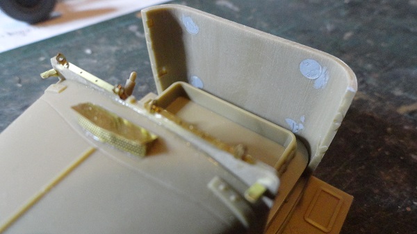

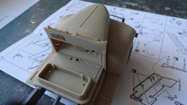

the cab with some PE mounts for the small windscreens
the dash sanded smooth for PE instruments
That would be an interesting, if specialist museum, the Jerrycan was a major contribution to operations in the desert, where supply is key.
The small parts, so far, the hemispherical windscreens, made from two frames sandwiching a marked out piece of clear glazing provided by ed. The dash instrument facia and dial film

the cab back filled and sanded and ready for primer.
in primer
