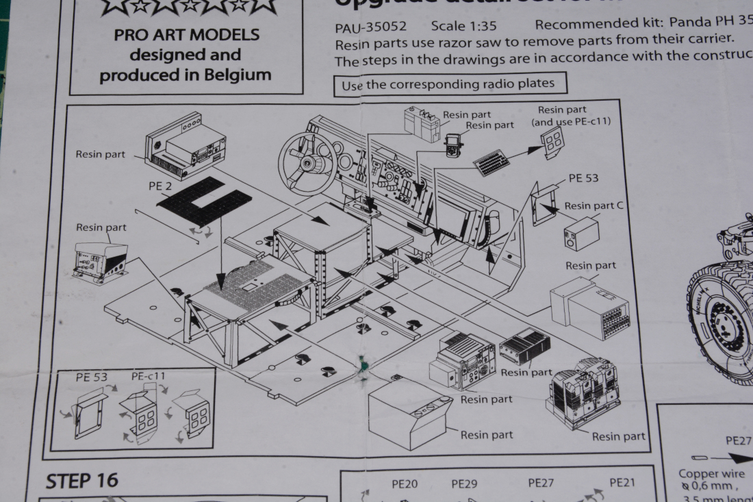

I was wondering where the Pro Art PE part #2 tread plate went. They showed it to go on top of the gunner’s platform but it is too wide. Their instructions show to bend it to fit but I still thought it was wrong.
Here you can see the Pro Art instructions showing to place the tread plate on the gunner’s platform
It goes on the right rear on the floor. Pro Art only includes the one piece of tread plate though.
RFM includes the tread plates/rubber mats in their kits as seen in their instruction sheet. They are raised up a bit though.
Do you know what these Pro Art pieces are for? Pro Art does not show them on their instructions at all. Could these be the floor mats?
My guess is that those plates are the bases for the radio bits. I think they have shock absorbers in the raised circles.
Great catch! Yes, they seem to be the bases for the radios. Pro Art does not show them in their instructions. I already CA glued the radios so will have to try to remove them carefully and fit those bases in.

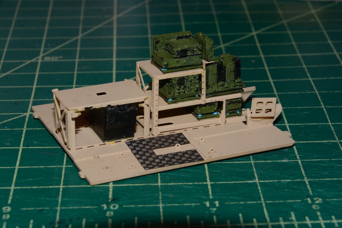

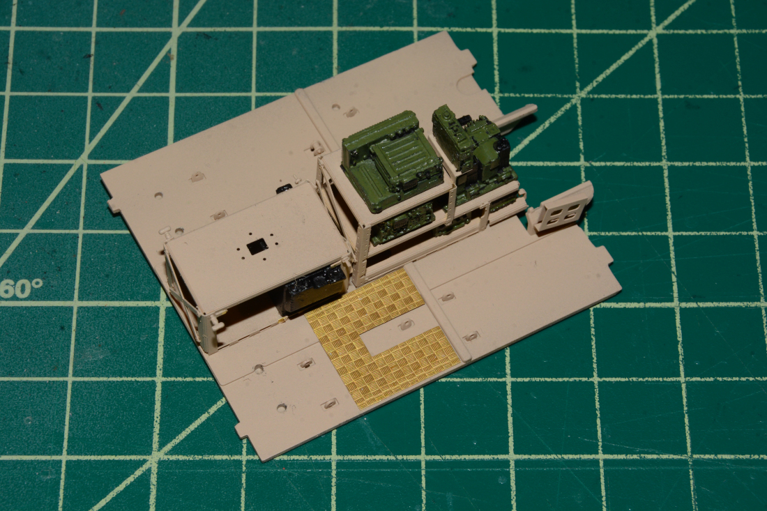

Painted the Pro Art tread plate but it is only dry fitted for now. Waiting for the Eduard set so I can add the rest before gluing it in. Also added the Pro Art radio base plates. I used AK RC markers to paint the tread plate and radios. Thanks to Rob (18bravo) for the reference photos. Also thanks to loncray for pointing out the radio bases.

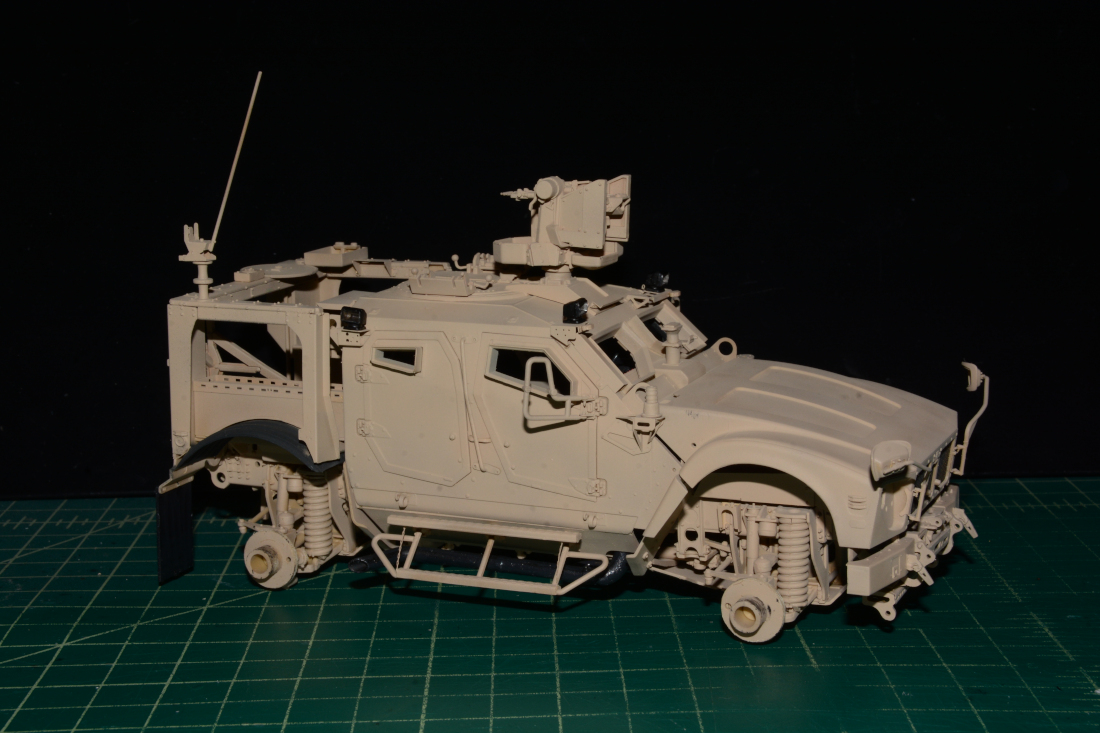

For the first Panda M-ATV, yesterday I added the CROWS, rear mud guards and 4 lights on the roof corners. Still a few things to add like the mirrors, wheels/tires, all the clear parts, .50cal and antennas. I also need to touch up the CROWS as that is when the thunderstorm rolled in while I was airbrushing it and lost power. No painting today as we had a thunderstorm earlier this morning and still under threat of more thunderstorms today.

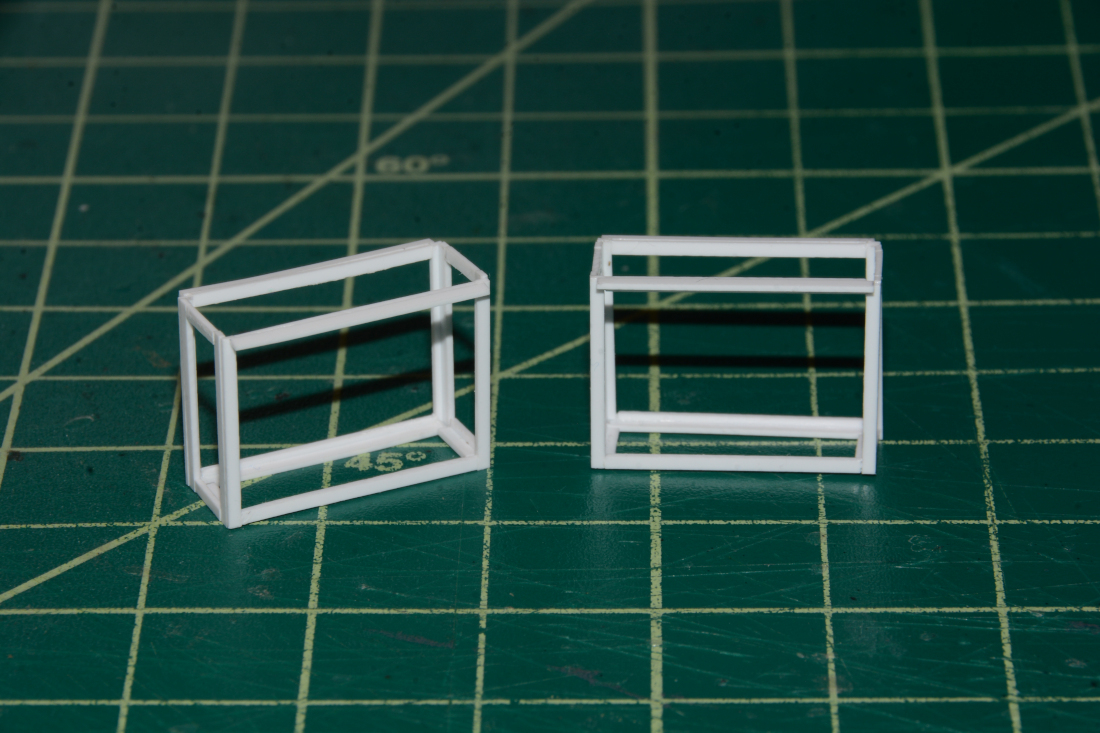

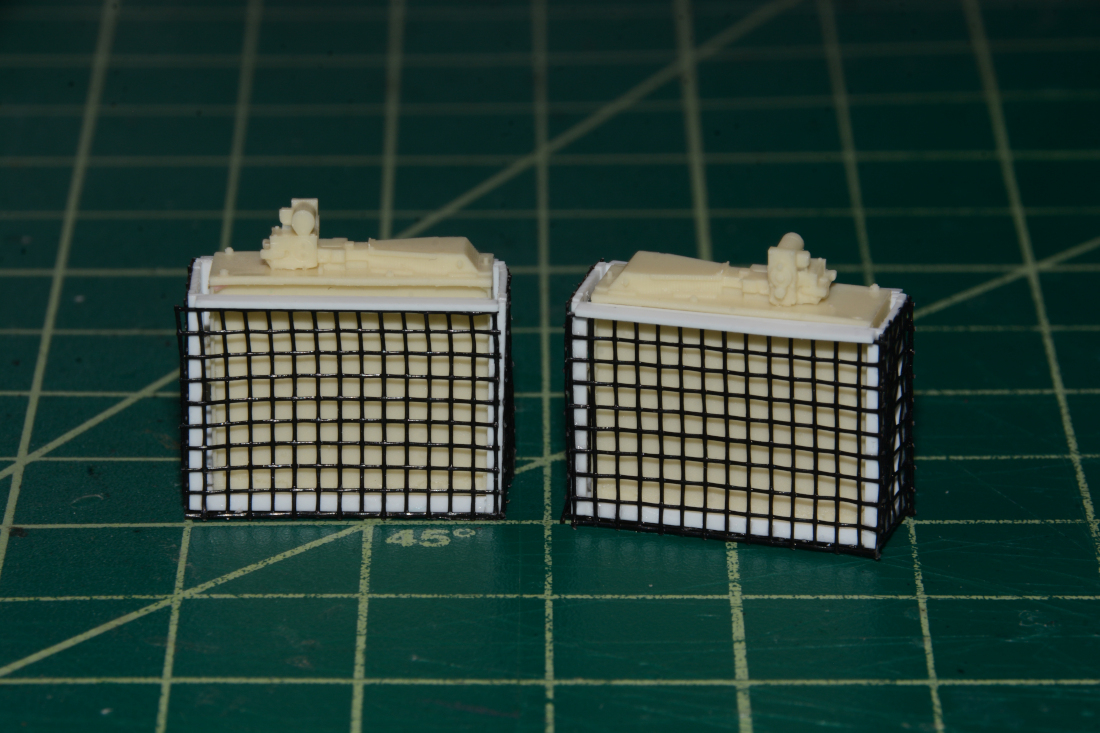

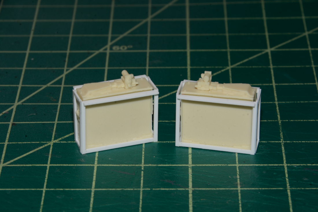

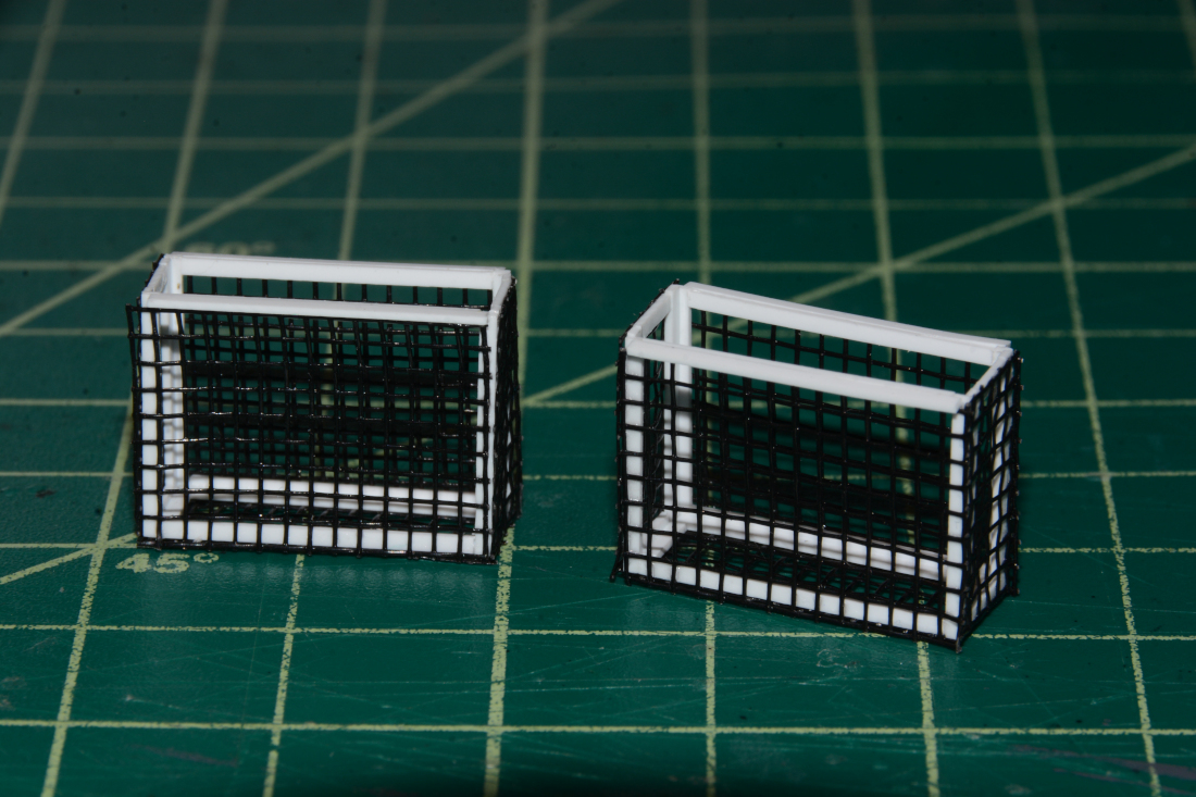

After viewing the reference photo of the camo M-ATV with minigun, it seems that the external storage basket on the side of the turret has a 3,000 round ammo can in it. I had previously scratch built those turret baskets but to fit a 20mm ammo can. I just scratch built a couple new turret baskets to fit the Legend 3,000 round ammo cans. I scratch built two guessing there is one on the other side of the turret as well. I still need to add the mesh.
Got the mesh on the turret baskets.

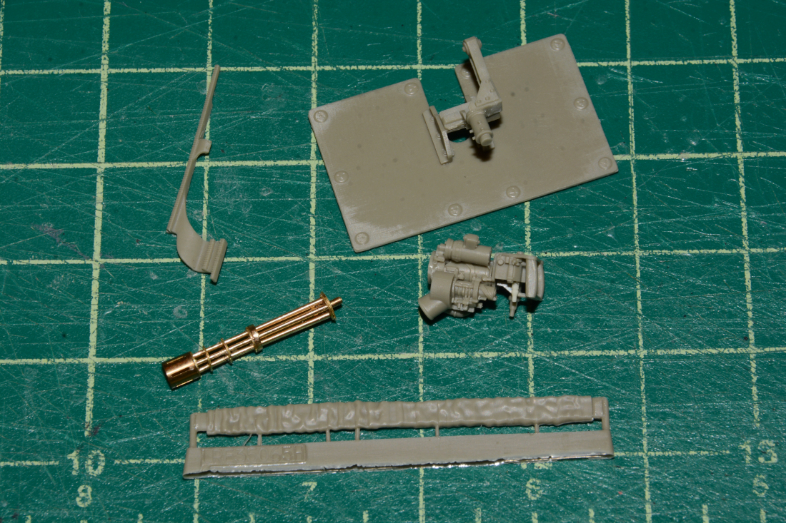

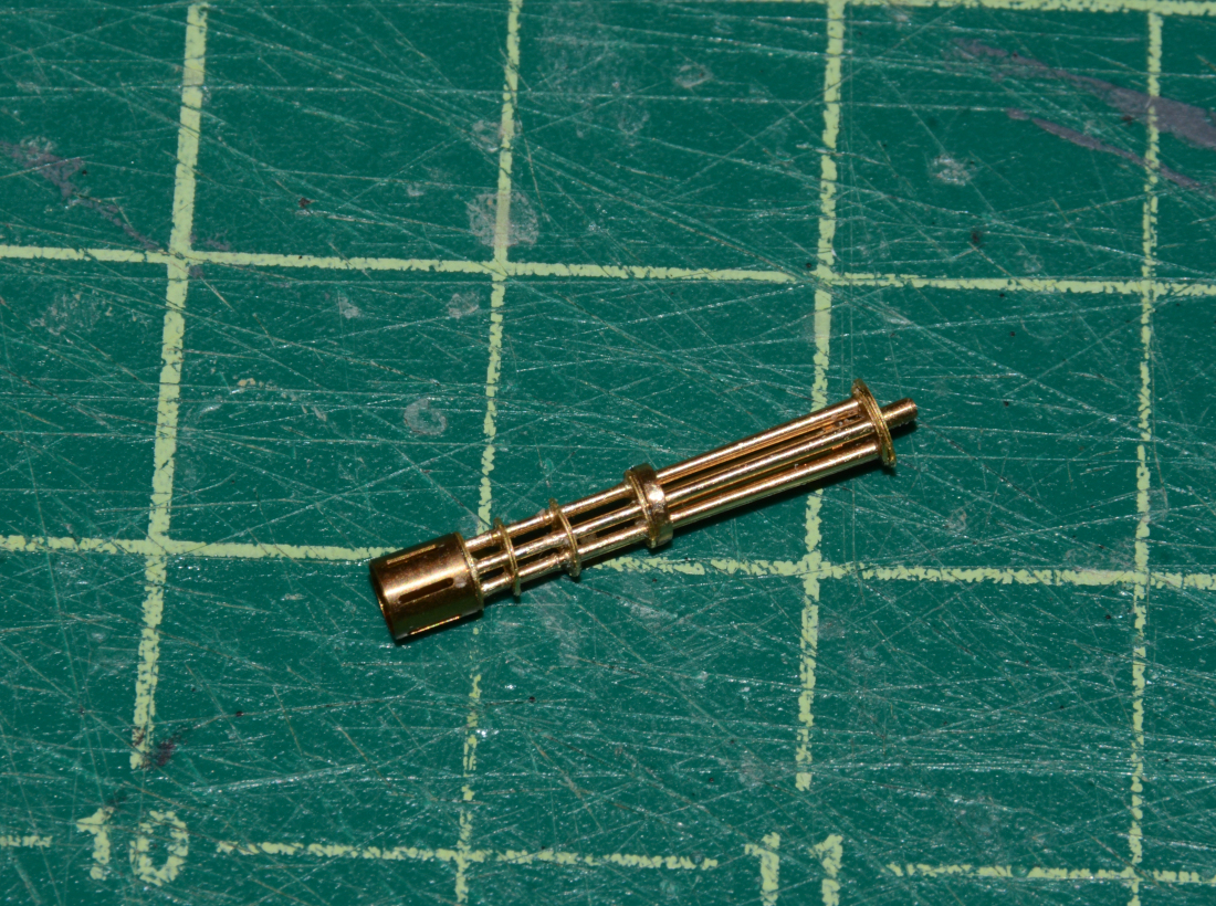

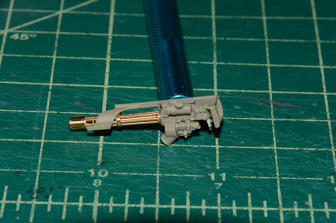

Worked on the Live Resin M134 today. The metal barrels are from RB Model. It took me over 3 hours just to assemble the metal barrels. I was ready to toss them as they are extremely fiddly to assemble. I will attach the barrels to the rotary assembly some other time. I am tired from working on those barrels. I also have to fix the two barrel clamps below the muzzle.
Got the metal barrels attached to the rotary assembly this morning. The two barrel clamps still need a little adjustment but not going to worry about it as they are extremely fiddly.

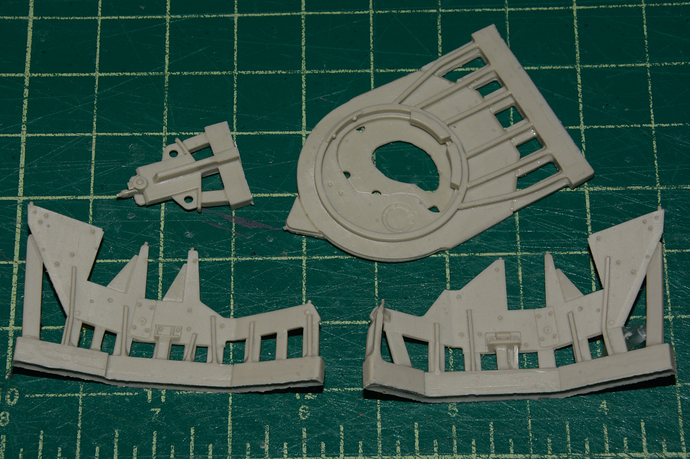

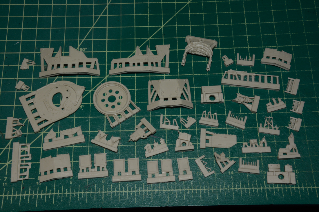

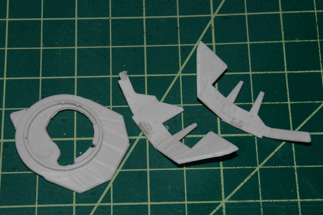

Started on the Legend MCTAGS turret for the ILK JLTV. Lots of resin included with clear parts for the shield and sides of the turret.
Some of the larger parts have support ribs on them that need to be removed.
Some of the ammo belts had broken ammo and missing from the package.

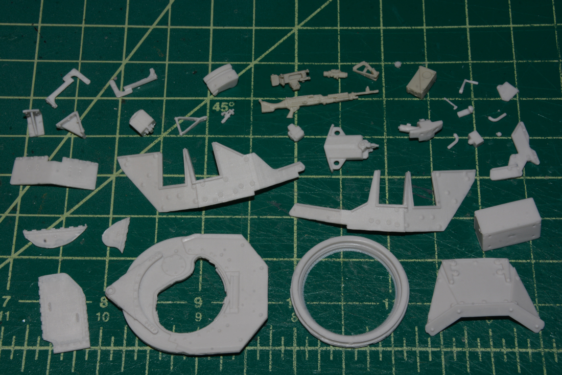

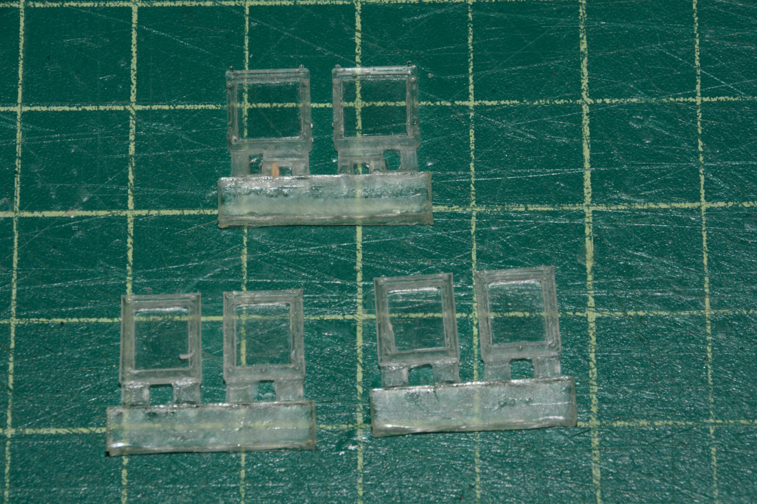

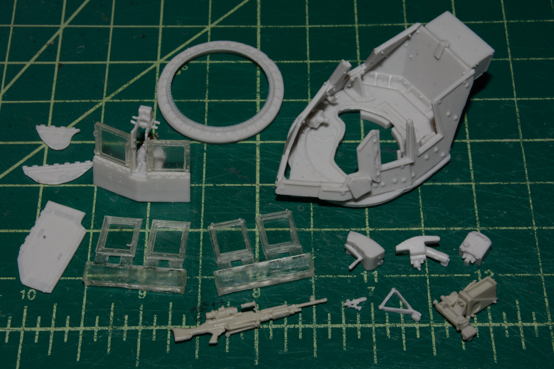

This is a different Legend MCTAGS set that I removed from the casting blocks this morning. Some parts not shown. The resin was soft and most of the parts were removed carefully but easily enough with a sharp #11 blade. I switched out the .50cal for a Legend M240.
Most of the ribs removed but still need cleaning up.
Still a ways to go to finish it but getting close. Legend has the clear parts molded with the window frames so you need to mask off the clear parts for painting.

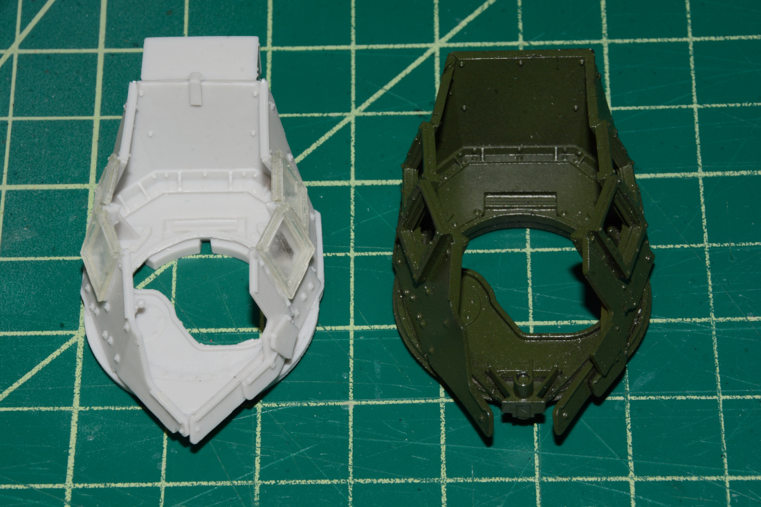

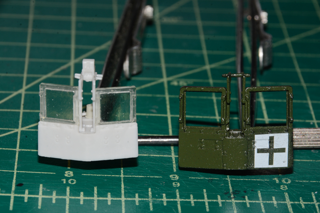

The Legend MCTAGS turret is slightly smaller than the Live Resin MCTAGS turret. I have no idea which is the correct size. Overall, the Live Resin looks better to me.
You can see the Legend shield on the left is smaller than the Live Resin shield on the right.
The width of the Legend turret is also slightly smaller than the Live Resin turret. You can see the difference on the back walls. Also, notice the front part of the turret how the Legend connects at the front where the Live Resin version is separated.
I don’t know if there are two different types of MCTAGS turrets but from these JLTV reference photos below, the front should connect so looks like Legend has it correct.

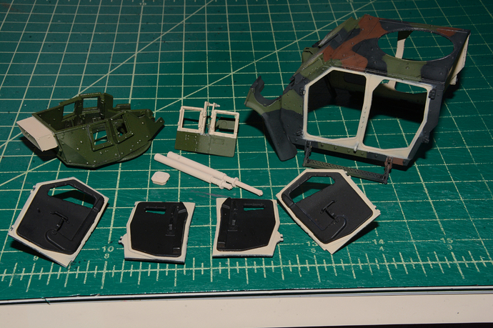

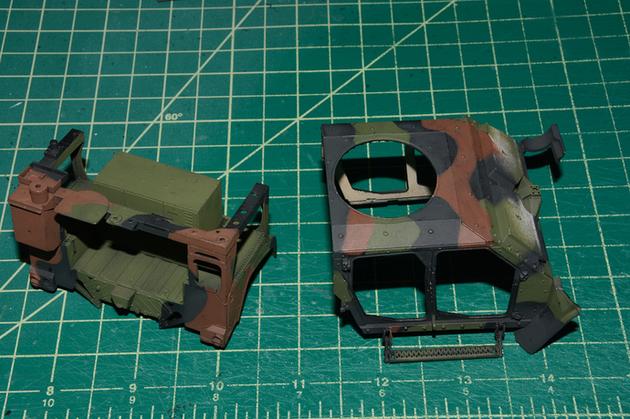

Got the NATO green and brown laid down today on the I Love Kit JLTV. Still a ways to go before closing it up though as I haven’t finished the interior yet.
Got some of the sand on the interior parts painted today for the ILK JLTV. I also painted the sand for the DUKE antennas, BFT and parts of the MCTAGS turret. The MCTAGS turret was alreay painted in Tamiya NATO green and was gloss coated so it looks darker. The shield was touched up so that is why it looks like two different shades of green.

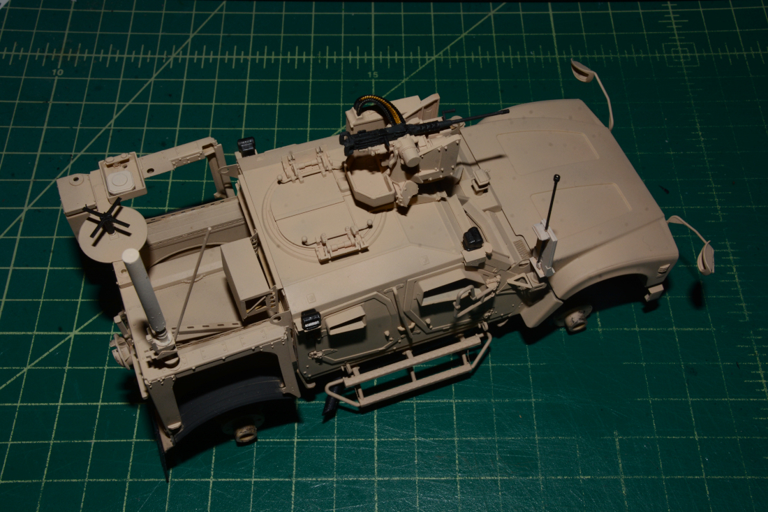

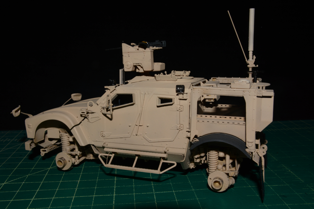

Had a little time last night so I added the DUKE antennas, BFT and the .50cal with ammo can and ammo feed belt on the CROWS for the Panda M-ATV. The hood is still loose but will hopefully glue it down one day.

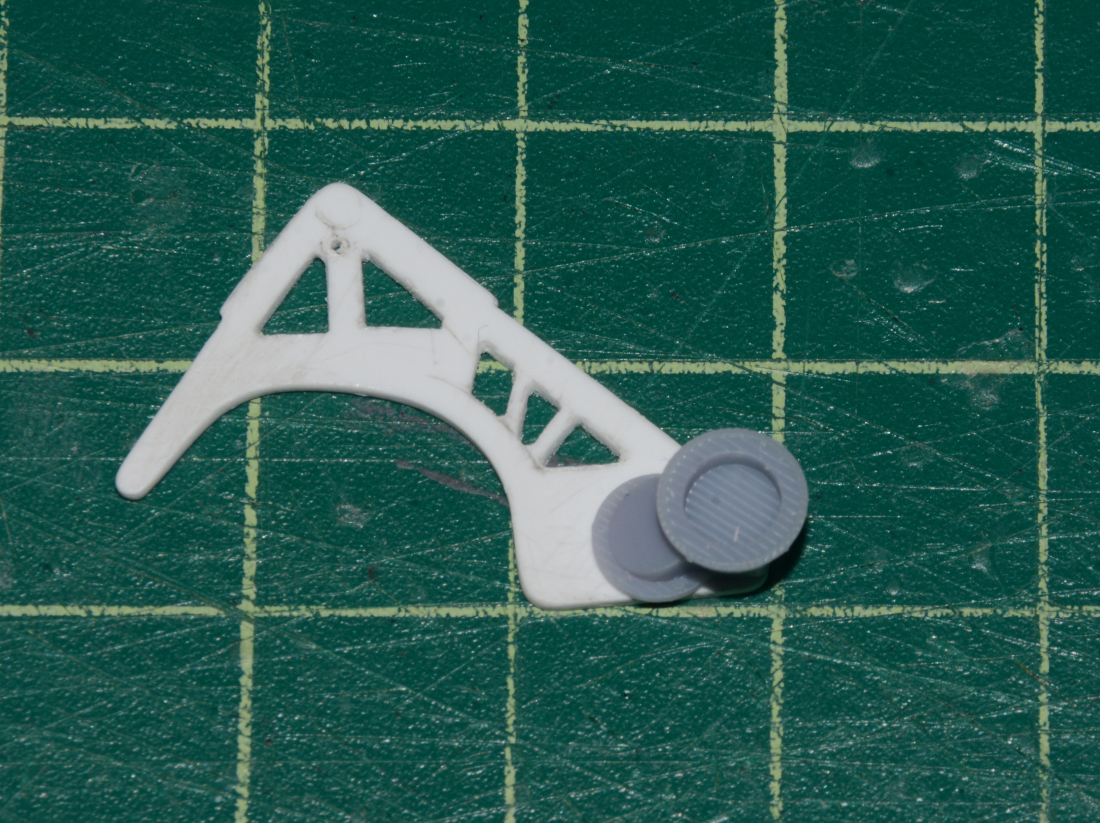

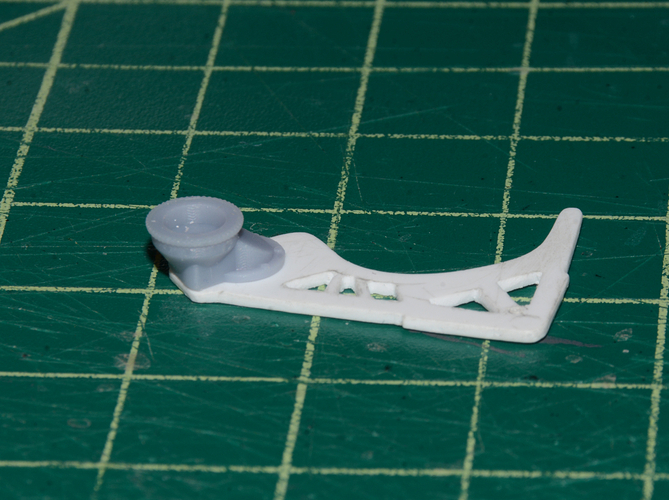

Got Galactica’s (Priamide) 3D printed LRAS3 mount in the mail the other day from 3Dp Train. It fits almost perfectly on my scratch built weapons plate.
The 3D printed LRAS3 mount circular plate at the bottom that bolts to the weapons plate is maybe 1/2 mm bigger than the area it fits on at the edge of the scratch built weapons plate. The size difference has nothing to do with Galactica or 3Dp Train, I scratch built the weapons plate by eye so I was off by roughly the 1/2 mm. You can see at the bottom right that the circular plate hangs slightly off the edge. I could just add a strip to widen it which I might do instead of scratching a whole new weapons plate.
Hopefully later I can test fit the Trumpeter LRAS3 to the 3D printed mount.
Glued Galactica’s 3D printed LRAS3 mount to the scratch built weapons plate. The Trumpeter LRAS3 fits perfectly on the 3D printed part. Next up is fitting the sides of the OGPK turret but the right side will need modifying to fit around the LRAS3 unit.

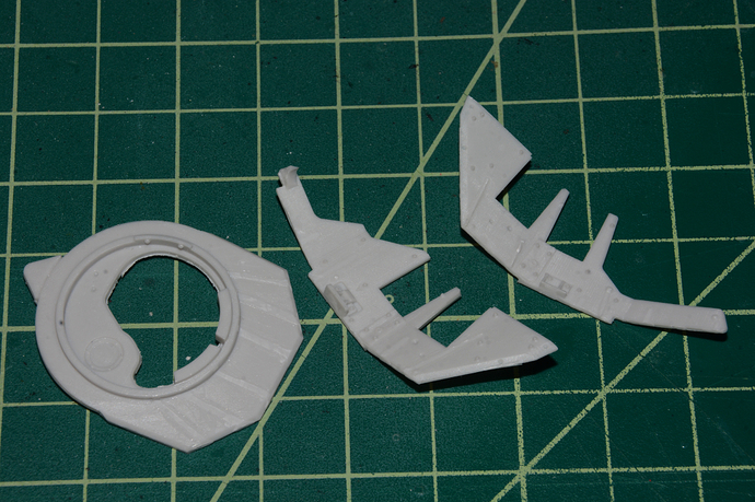

Just worked on the turret this morning to modify the right side to fit the LRAS3.
I used this photo as a reference.
I cut the right side of the turret and scratch built a new part to fit around the LRAS3 mount. The right side is only taped on for now as I still need to fill and sand it flush to match the RFM parts. Mine is not an exact match but close enough for me.

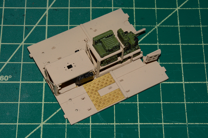

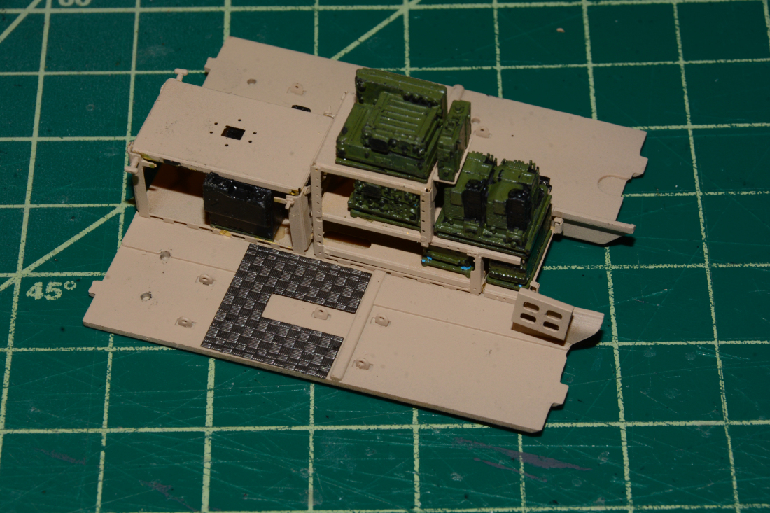

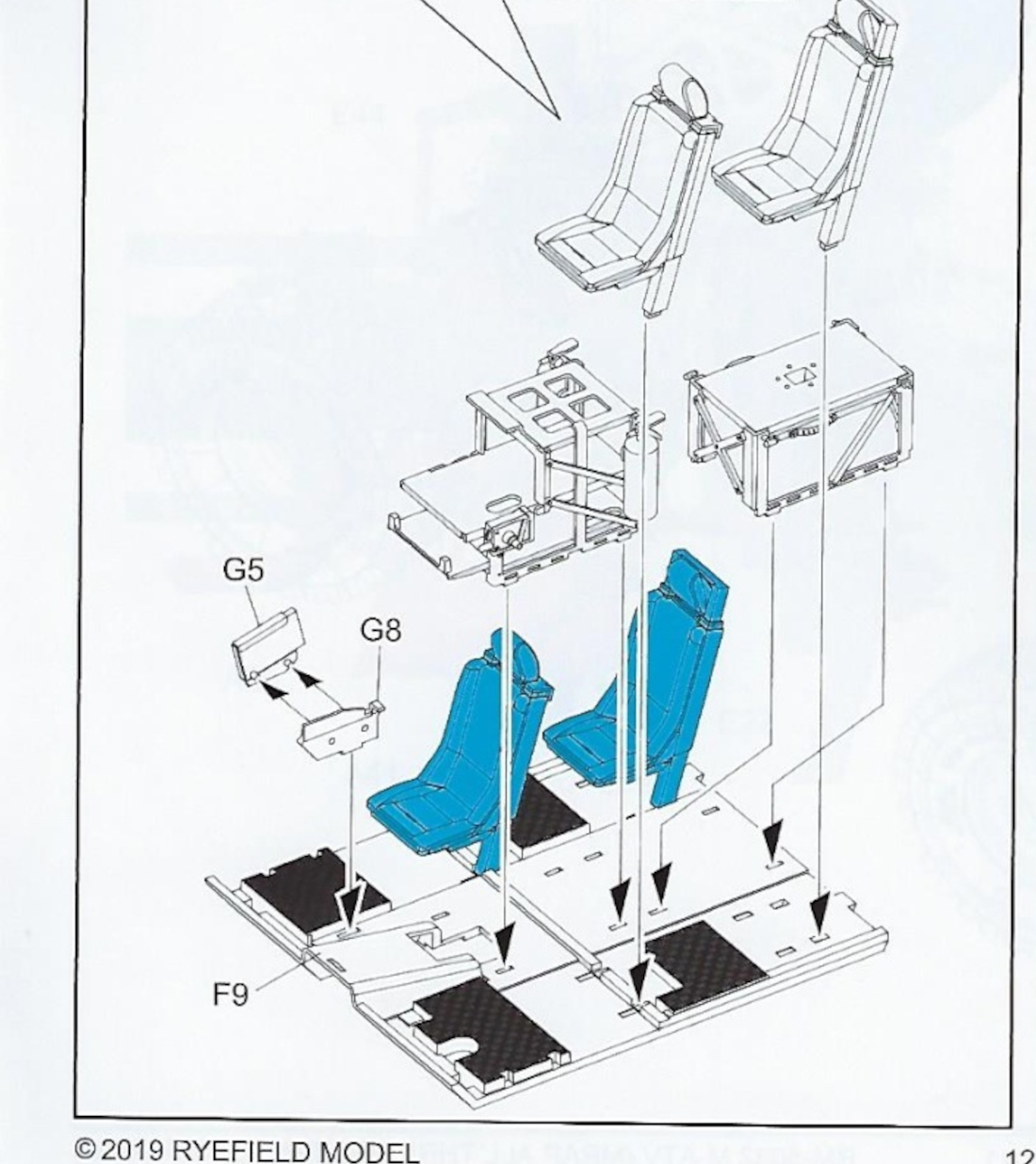

Worked on the Panda M-ATV interior yesterday. Still needs more work and then weathering. I used the Pro Art seats and radios. The minigun 3,000 round ammo can is from Legend. The rear anti skid plates were made from the Eduard PE modern floor plate set. The driver side front floor mat was scratch built from sheet plastic. The front passenger side floor mat is actually the Panda mud guard for the front fender. This is the one that will be in camo so lots of painting still needs to be done. The cold weather is setting in by my area already and not even winter yet so won’t get it done this year.
