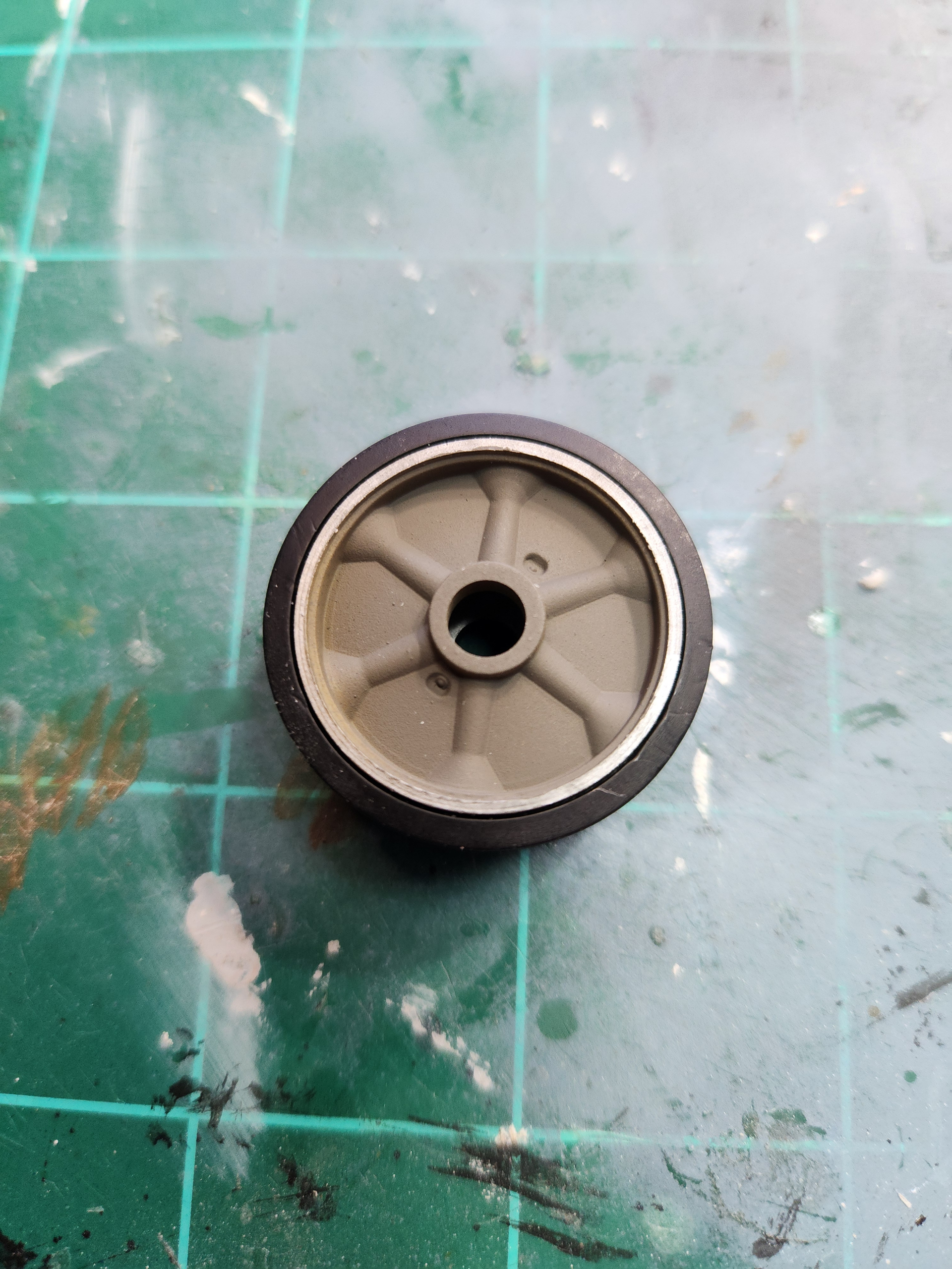

Doing the metal weathering around the road wheels from the track…..is this distinct enough……I am not sure how bright the metal would be?
It would be fairly bright, because the track guide teeth rub against it continually as the vehicle is in motion. Once you know this, you’ll spot it in photos of Shermans and similar vehicles all the time.
