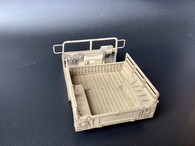

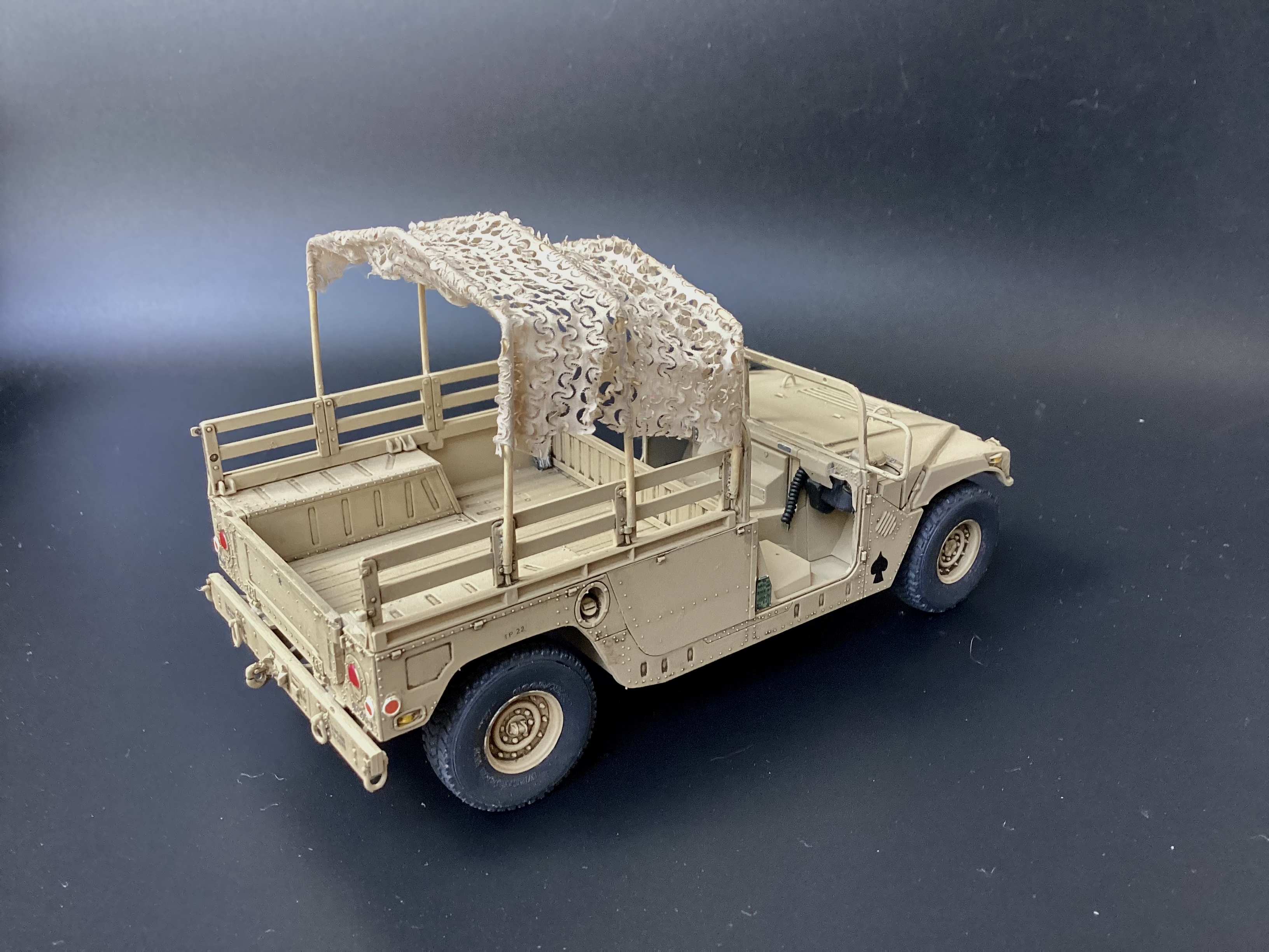

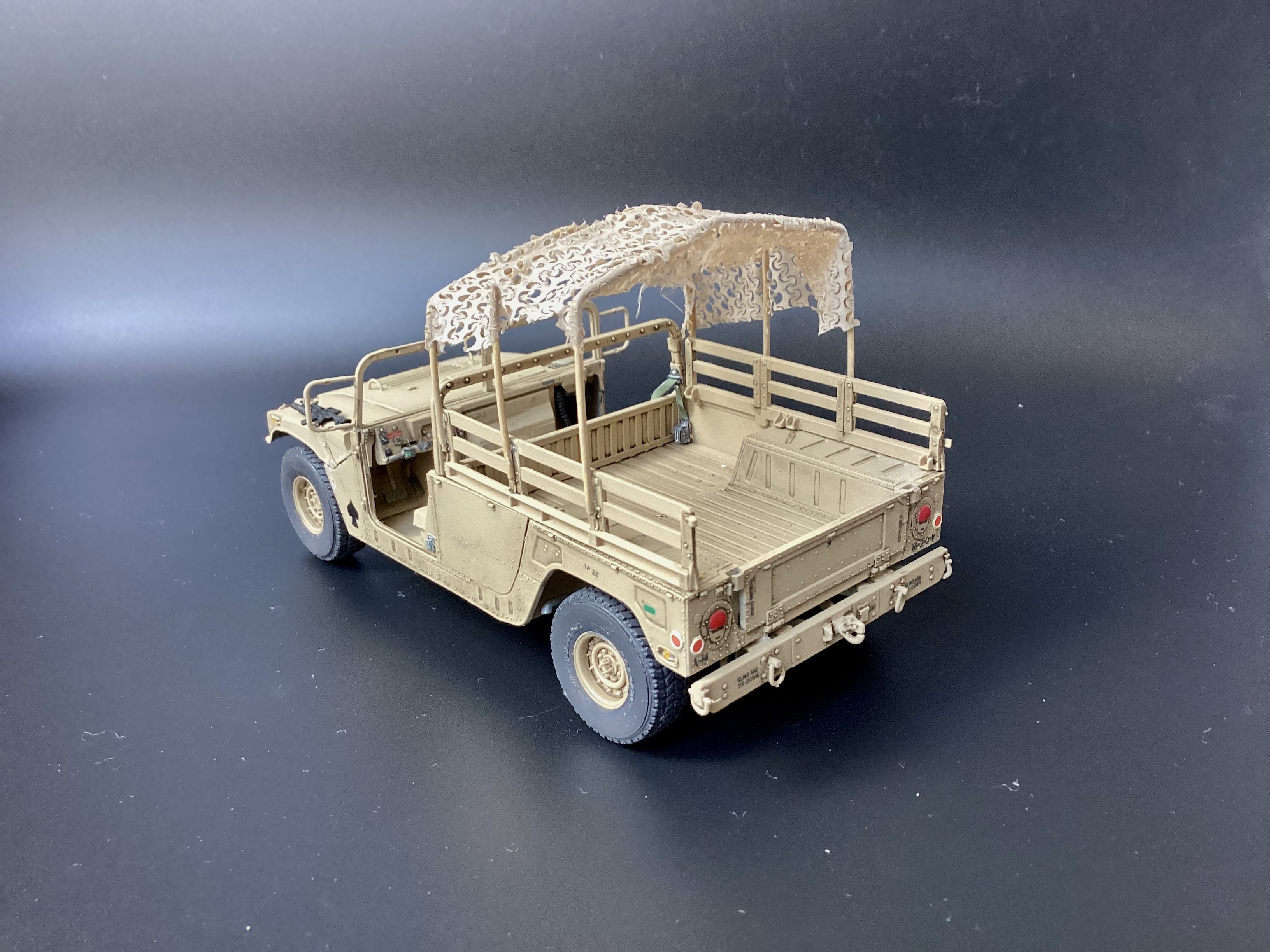

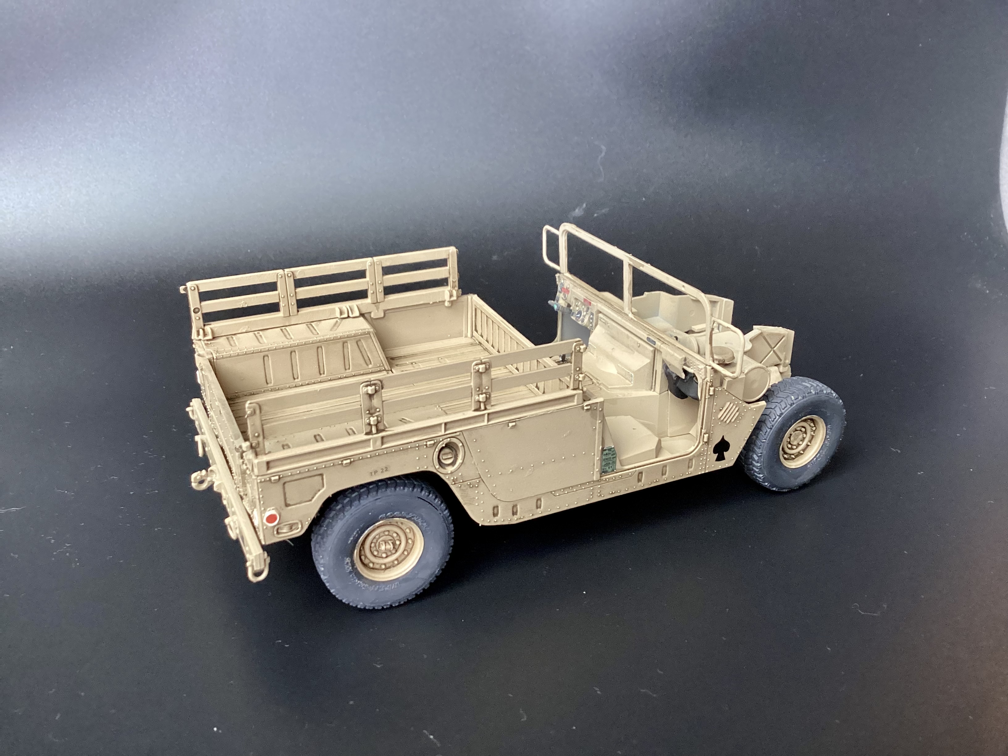

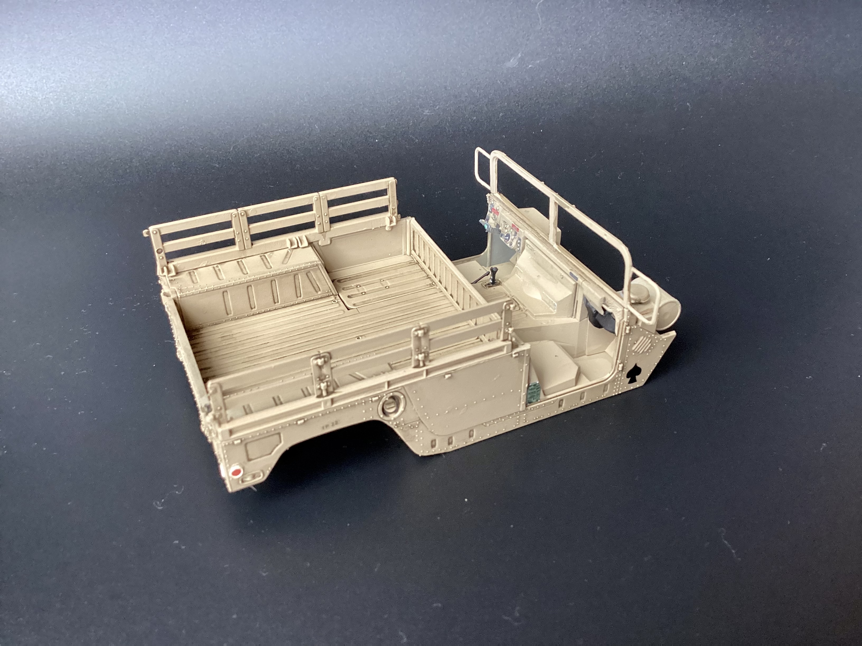

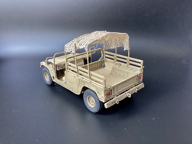

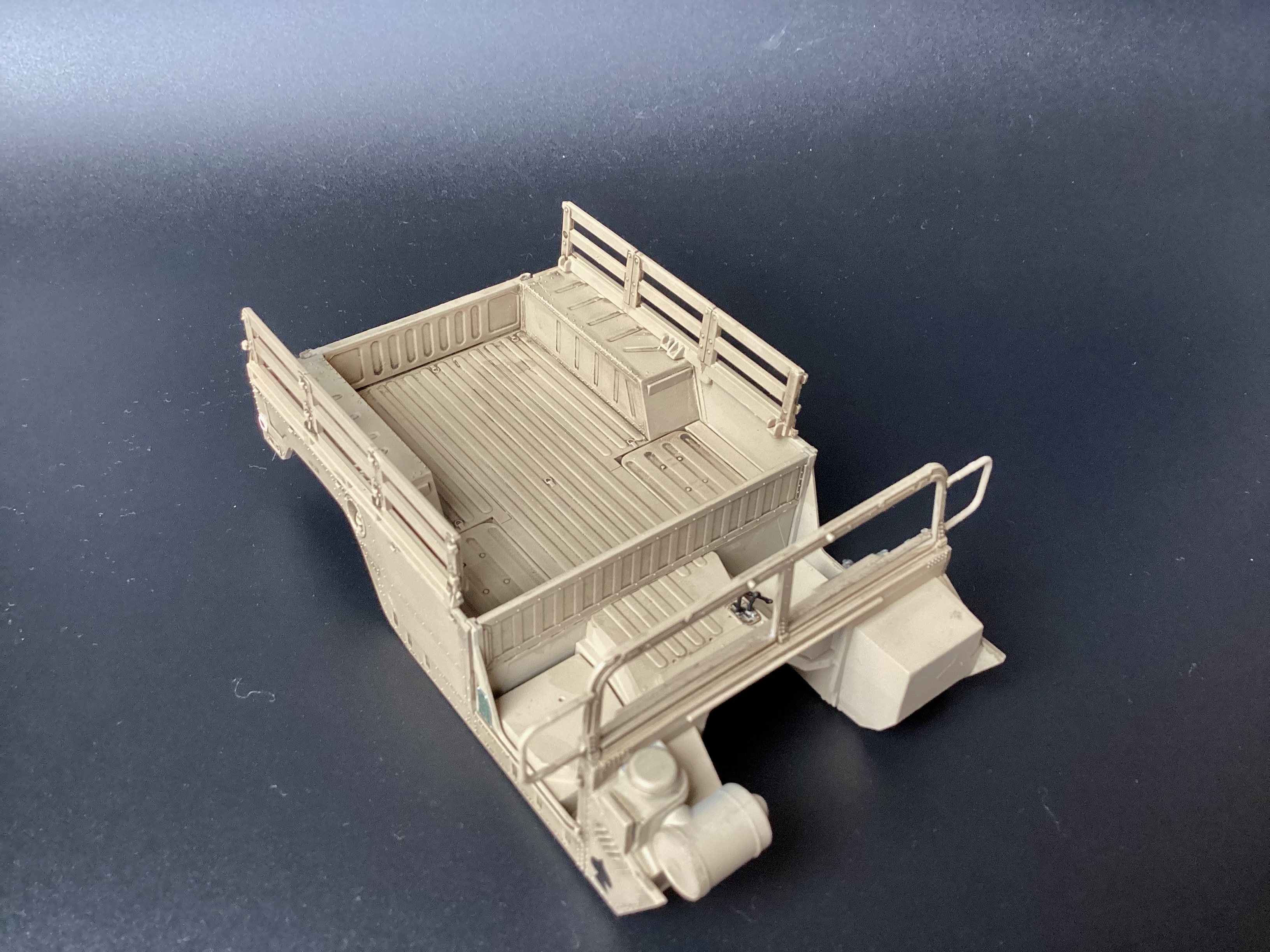

It doesn’t take much philosophy to build this Humvee. I’m thinking about the cargo part. Visible mold joints on the frame are not a problem because they will disappear into the chassis components

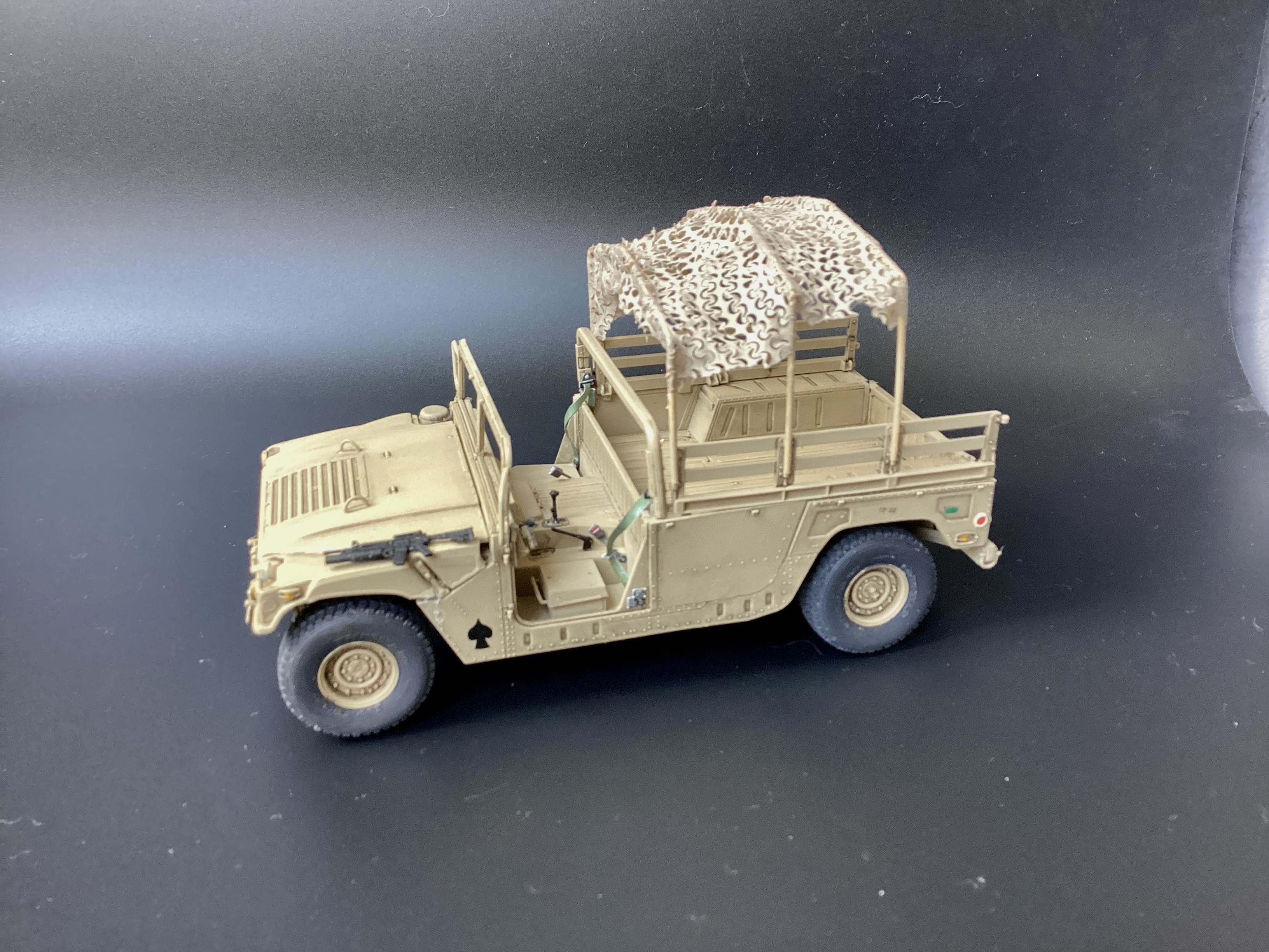

I really like this version. The interior details are awesome and way above any previous one. Also, it is perfect for what I plan to build with it; a Ft Irwin/NTC OC HMMWV. All I have to add are the top and some radios, along with gear.
The interior is already “rich” - the entire BFT+ SINCGARS set.

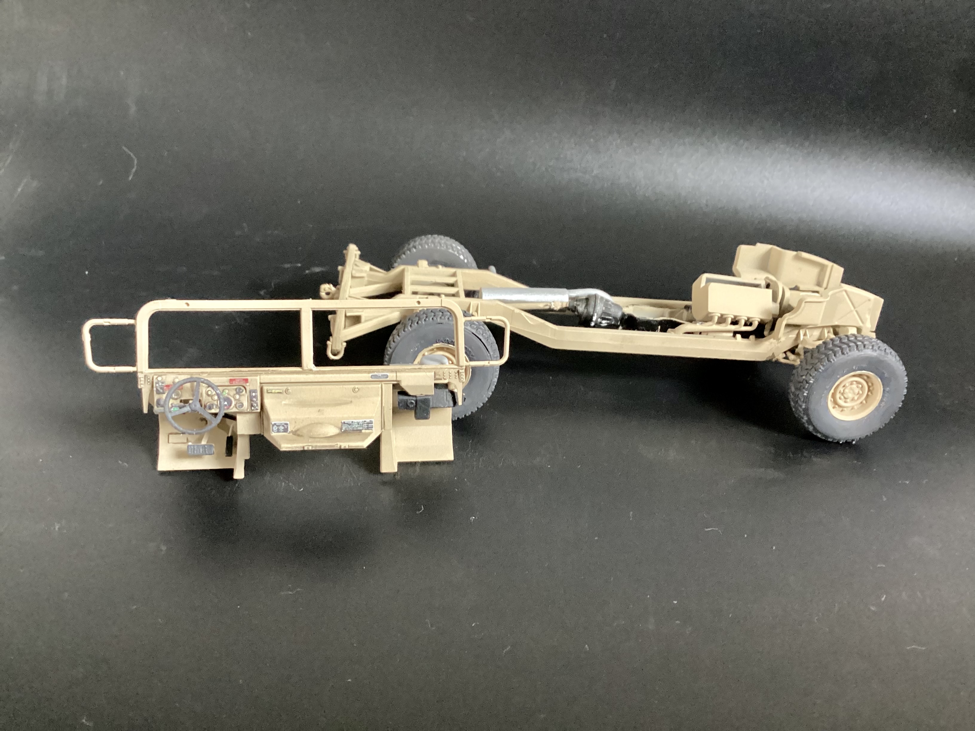

Is the frame mold lines correct for 1:1 or a manufacturing defect not cleaned up?
Your build is looking good.
I didn’t remove it because it won’t be visible. The 1:1 original does not have this seam
Not all seams are created equally so thanks for the information. :+1:

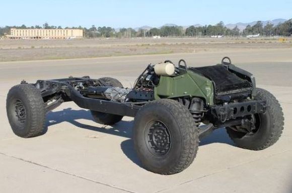

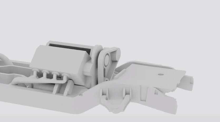

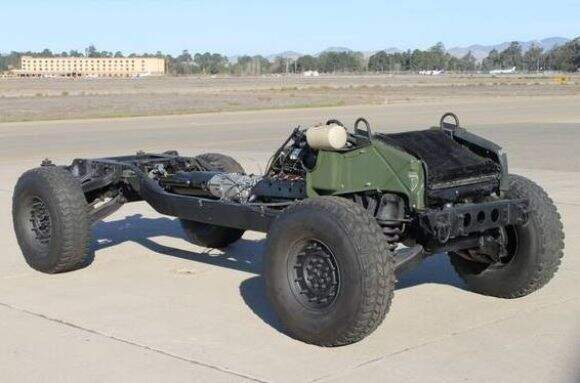

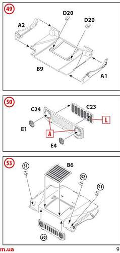

One thing to note that ICM got wrong. The radiator should be angled, like in the below pic. ICM has it flat on the frame.
Maybe a new 1/35 avenger kit might come out soon!
I contacted ICM and offered assistance but no response. :frowning_face:

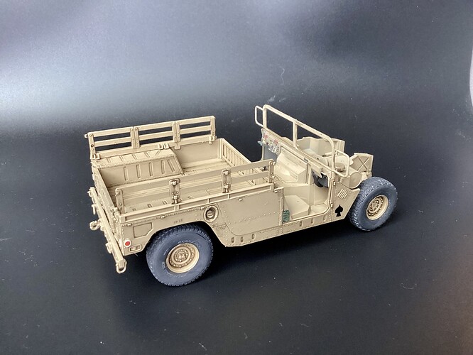

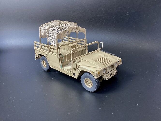

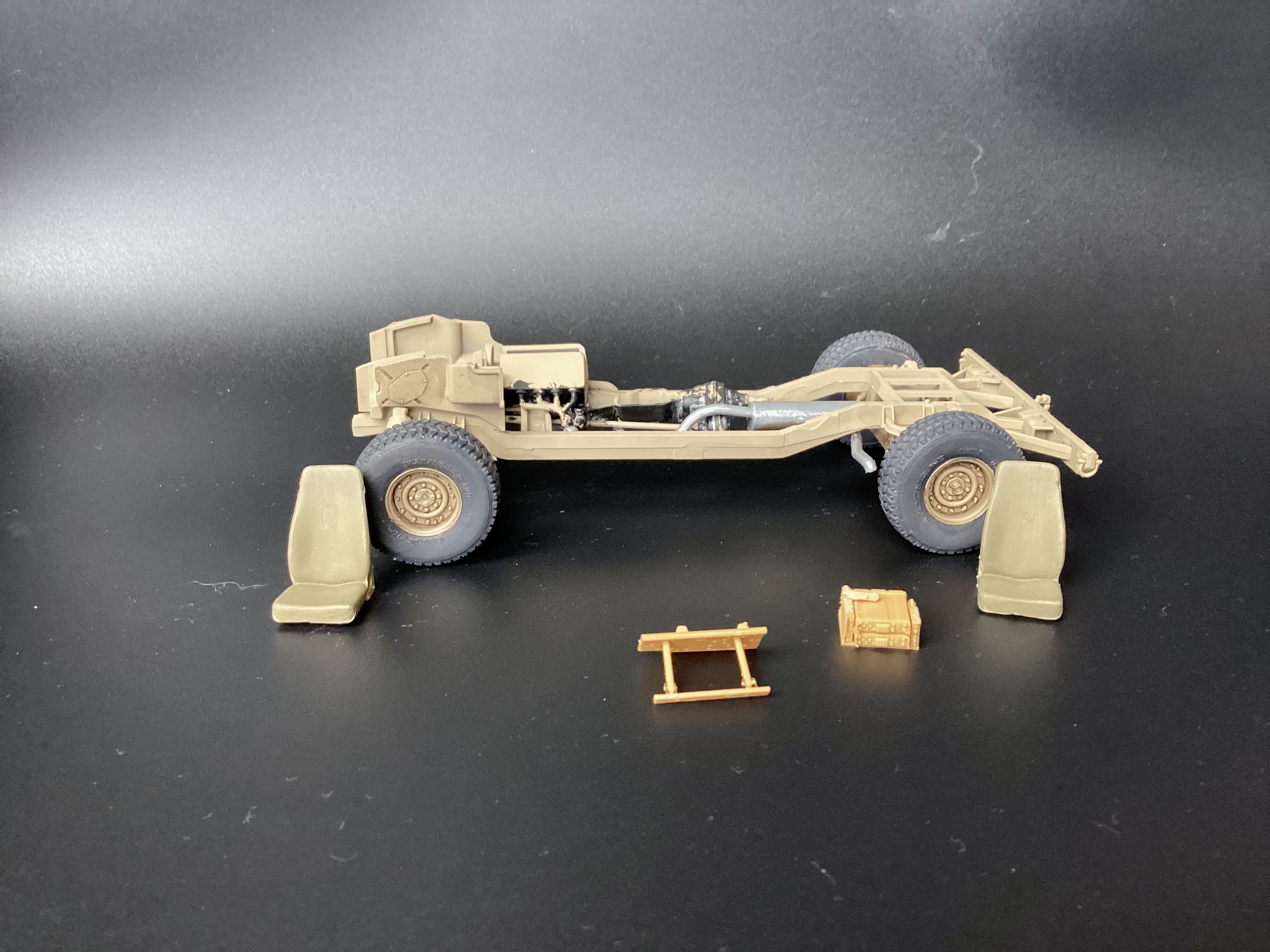

I will finish slowly. Today it looked like this.
Noice! :+1::+1:

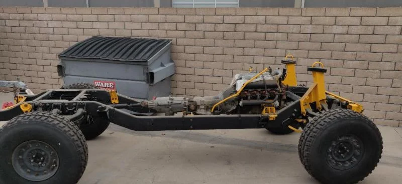

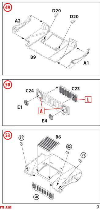

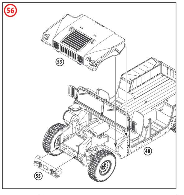

Is there some kind of box (coolong fan shroud) inside/under the radiator?
Could that plate lying flat on the frame be the bottom of such a “box”?
The frame extensions left and right of the radiator are present, the bottom of the box and
the rear wall holding the fan is there but there is NO radiator at all.
Step 56 puts the hood and fron bumper on the “chassis”
The radiator is not mounted to the underside of the hood either:
Radiator seems to be AWOL …
Unfortunately, there is no radiator.
