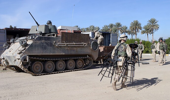

Technically, not an M113 - but rather an M1064A3 120mm Mortar Carrier, but yes, some M113s were deployed to Iraq still wearing NATOflage.
This one is an M113A3.
Thanks for the images. I am looking for ones specifically in the NATO camo scheme with the commander’s cupola shields.
A few more…

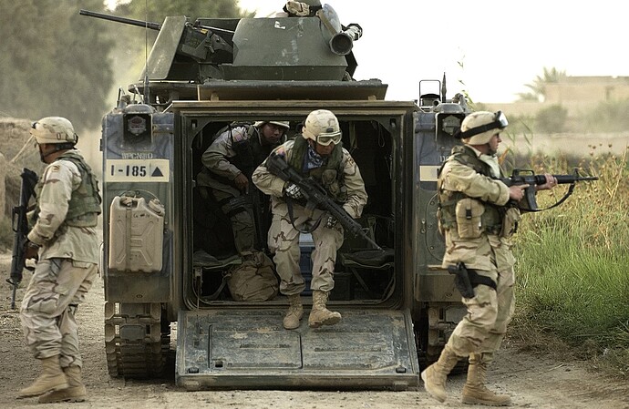

That is the front IFF panel. It is like the corrugated ones that go on the sides that shows up as a reverse colored rectangle (dark or light, depending on the setting) in thermal optics to ID a friendly vehicle.
As to the Tamiya M113A3, it is closer to an M113A2 that has A3 external fuel tanks added. Check out Vodnik’s article on updating it to an M113A3.

I have the Tamiya M113A2 Desert Version kit already. I wanted to do one from OIF specifically in the NATO camo scheme with the cupola shields. The ones in OIF were the A3 versions but I already have the Tamiya kit which includes the smoke dischargers, cupola shields and rear external fuel tanks so it would be close enough to an A3 to me.
Seeing the Tamiya kit is actually an A2, I was thinking maybe doing one from Just Cause instead. I also have the Academy M163 and M981. Both of those Academy kits include the Dragon ATGM so was thinking of adding it to the Tamiya kit for one used in Just Cause.

Yes, to make it a pretty accurate M113A2, leave the external fuel tanks off and use the flat rear fenders on both sides.
