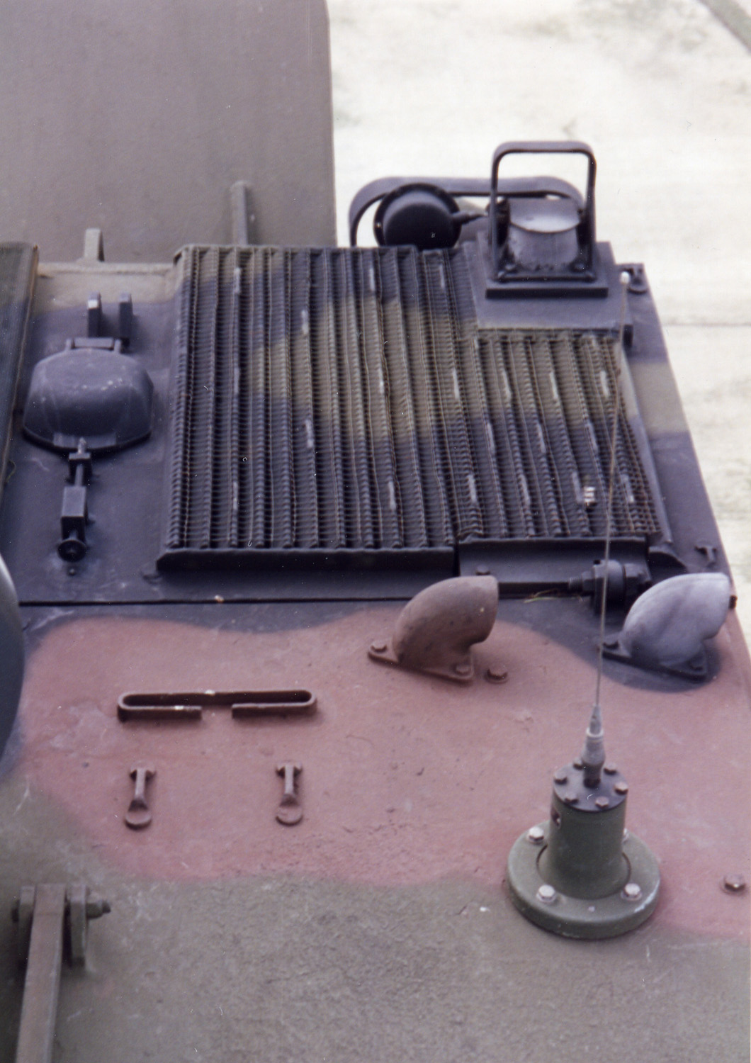

The image below shows what I think is a short-range FM aerial? I can only remember seeing them on USAF EOD vehicles (operating on/near airbases). Were they ever used on army wagons?

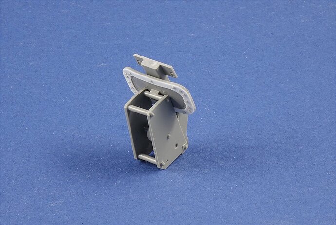

The rear hatch winch has been improved:

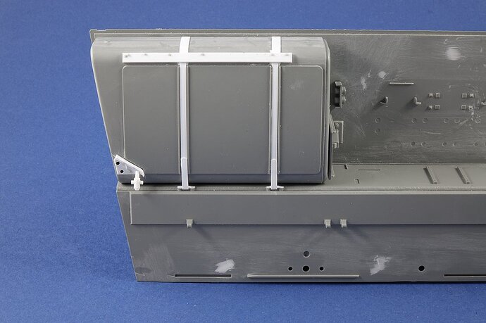

I’ve strapped the fuel tank into the hull:

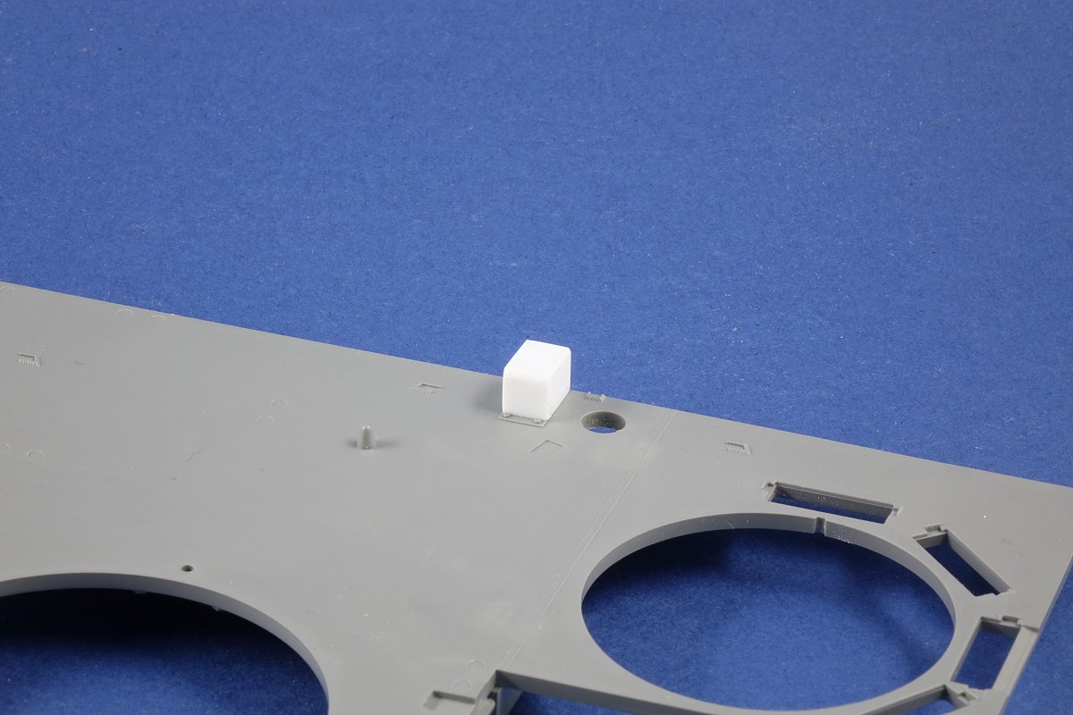

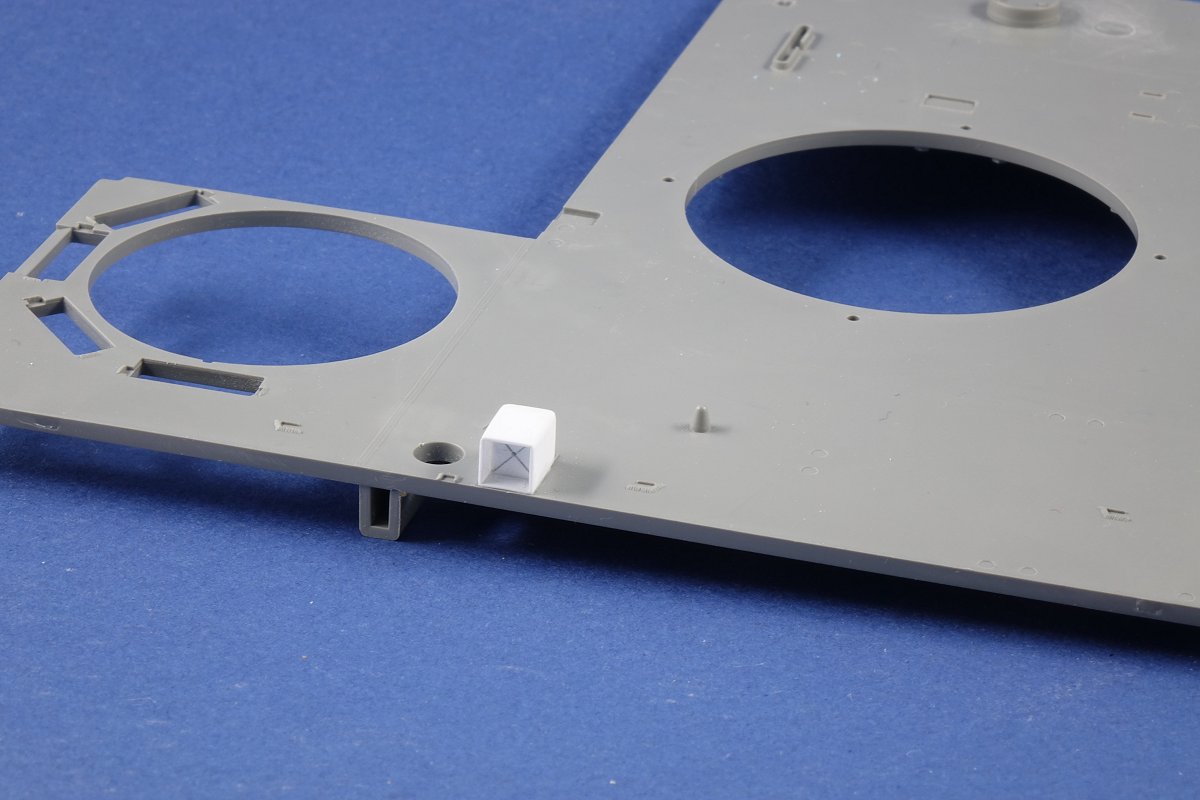

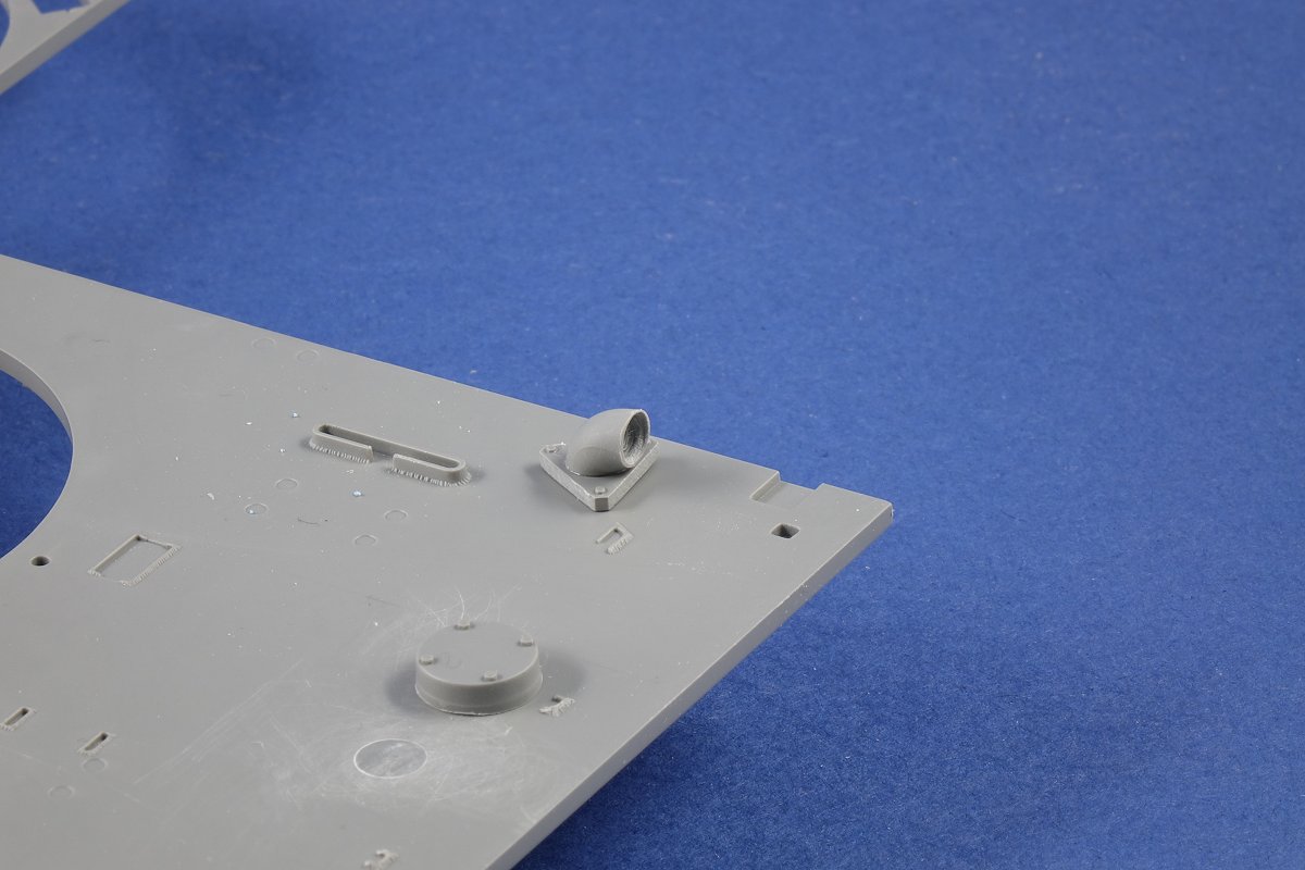

It may not look much, but I’m really pleased with the extra vent for the heater unit. The kit provides one, plus a spare blanking plate. I used the latter and then created a new vent by heating and bending some of the kit sprue, before chopping it down to size and hollowing the part out.

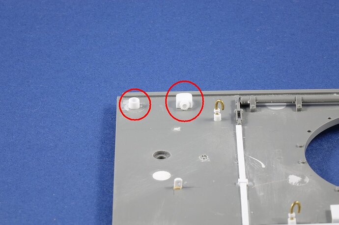

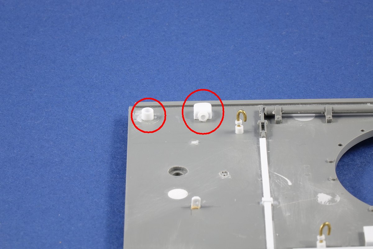

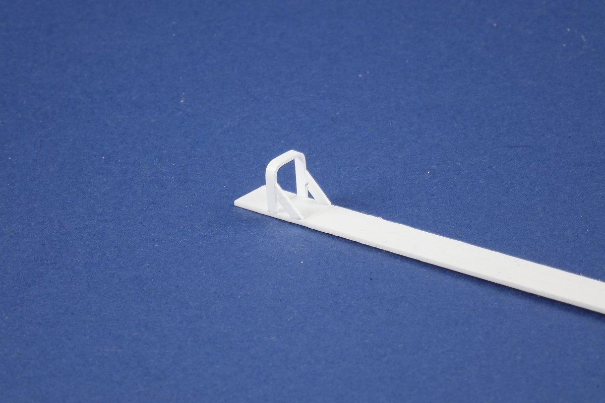

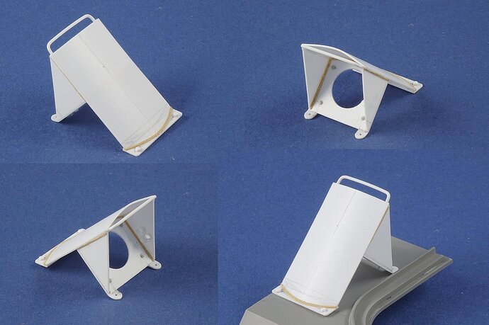

The major task of the week was to build the last part of the CBR detector. This is the external mount that fits onto the front of the M113

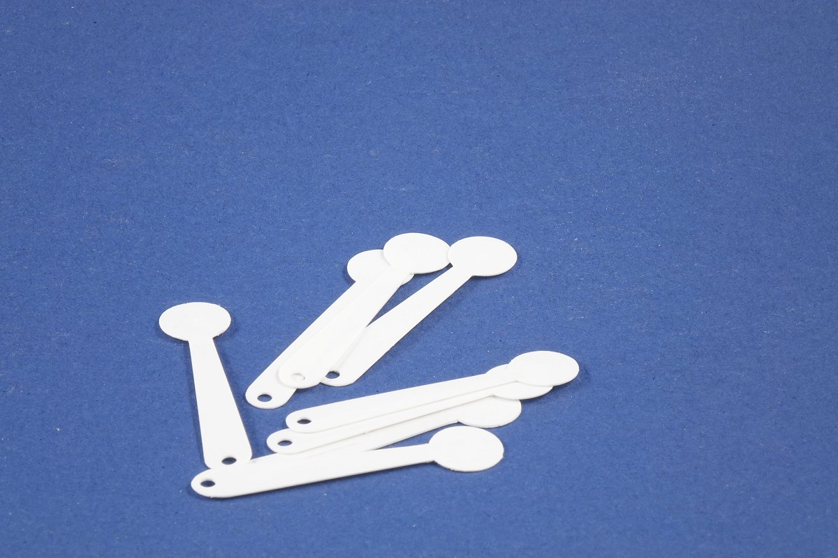

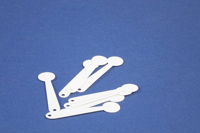

And finally, a bit more stowage for the cause. I ran out of the necessary plastic rod for the poles, so I’m awaiting the arrival of a general Evergreen re-stock to Chez Tapsell. However, the spreaders are done.

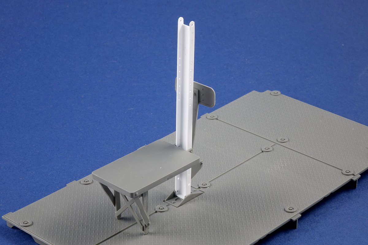

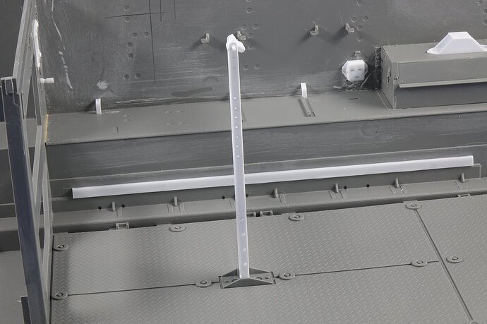

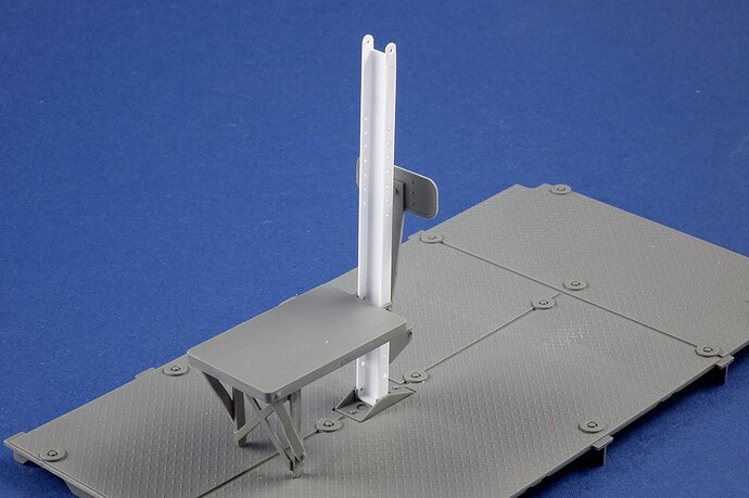

Internally, I replaced the seat post in the troop compartment. The kit piece is too chunky and I wanted a thinner appearance to it/ The commander’s platform is left unaltered because the overly thick lips face downwards and are not visible. Curiously, the commander’s seat back is the only one in the kit that doesn’t attempt to portray thecushion material wrapped round the back. Both the driver’s seat and the jump seat have this feature moulded on.

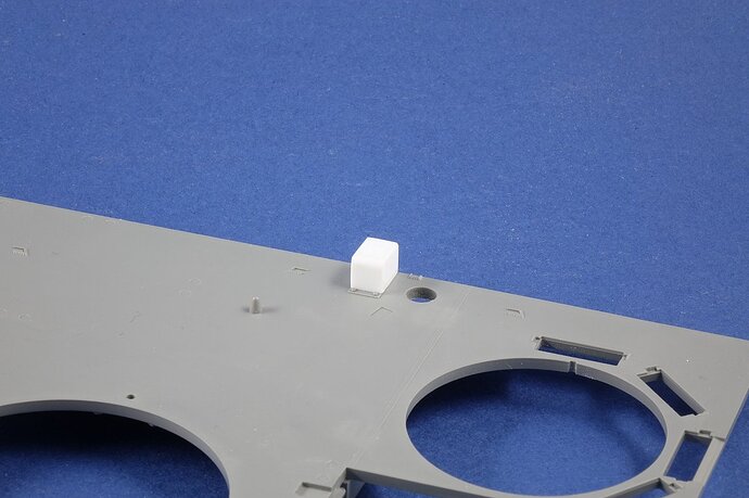

The external fire extinguisher handle in the kit isn’t the most common type, so that has been replaced with the more common variant. I have a suspicion that the kit part represents a really early production unit(?).

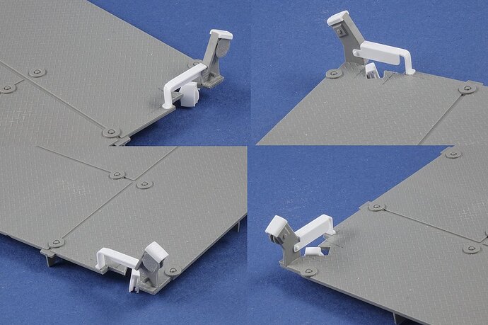

I made a start on the M113A2 flapper exhaust port but it needs some more work yet.

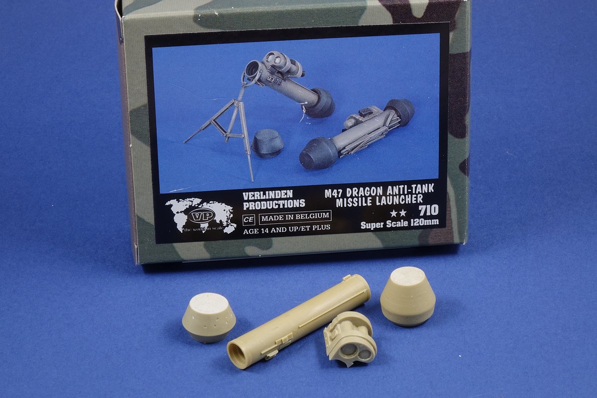

Finally, this little beastie arrived last week. It seems to scale out pretty close to 1/16 (with Verlinden sets, it’s not always the case).

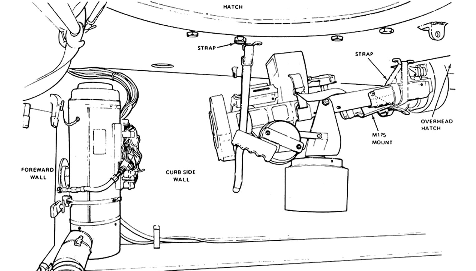

You may also recall I was asking questions about how the Dragon missiles were stowed in the dedicated scout versions of the M113 with the M175 launcher on the commander’s station. I haven’t resolved that to my satisfaction yet, but i now know the official way of stowing the M175 inside the vehicle (This is from the TM - clearly written by Heath Robinson…)

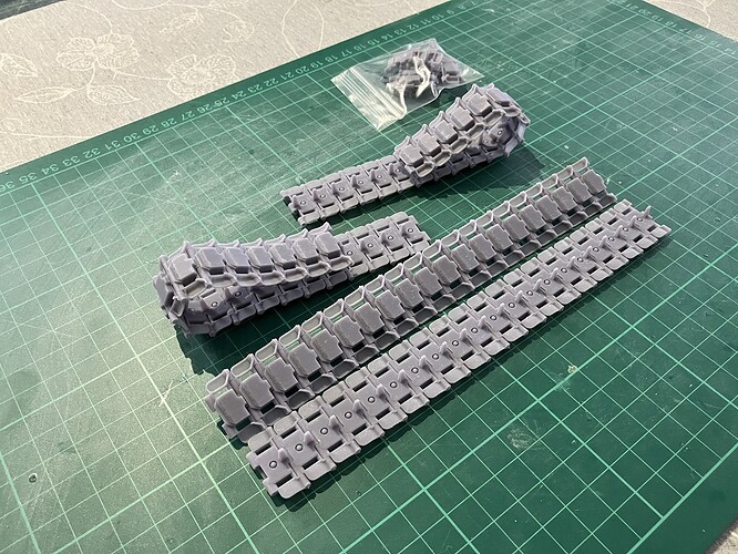

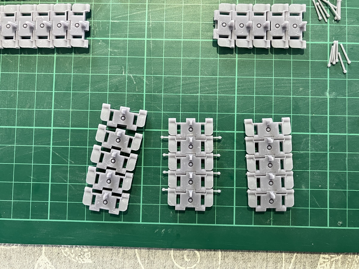

I did get some time to assemble sections of Jacques’ 3-d printed T130E1 tracks which are awesome. Thanks also to Sean for sharing some great info on the M175 missile mount.

John, glad the tracks were worth it!
