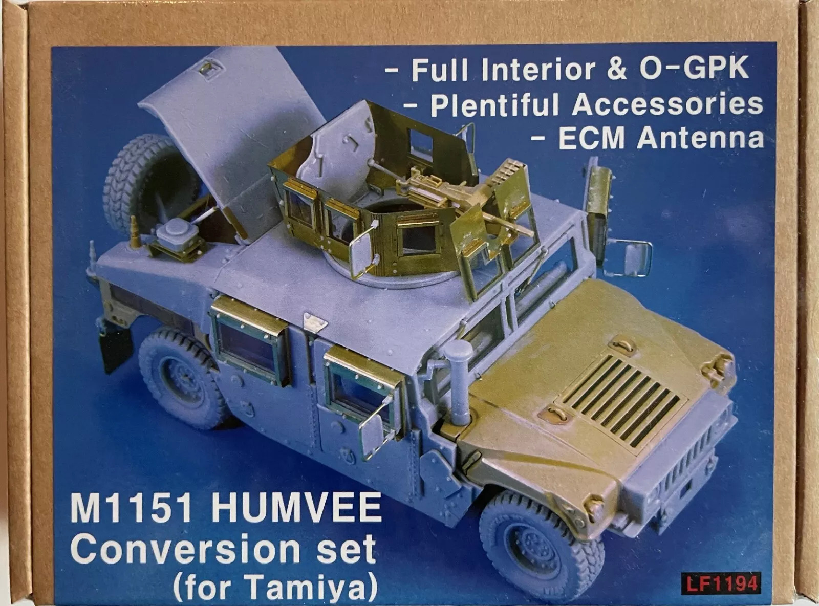

I have some questions about Legend conversion set LF1194.
Anyone used the set? If yes, how is it?
Do you think Bronco M1114s can be used with it?

I have built it.
Nice conversion with sharp details.
The rear cargo hatch doesn’t fit in closed position.
I used Tamiya one instead with armor plates added in styrene.
The worst part is the windshield which is very warped. I used it after reshape it.

I don’t know if the Legend kit can fit a Bronco Models M1114.
I used the Legend set to convert a Tamiya M1025.
See here my model and comments on the Legend set: M1151 - Scale models, 3D designed conversion sets and parts
I’m not sure it could fit a Bronco M1114.
Your built was a motivation to make mine ! ![]()
Your nightmare was bolts, mine was this horrible windshield.
I spent a lot of time to give it a better shape. And all those enormous casting blocks difficult to remove.
