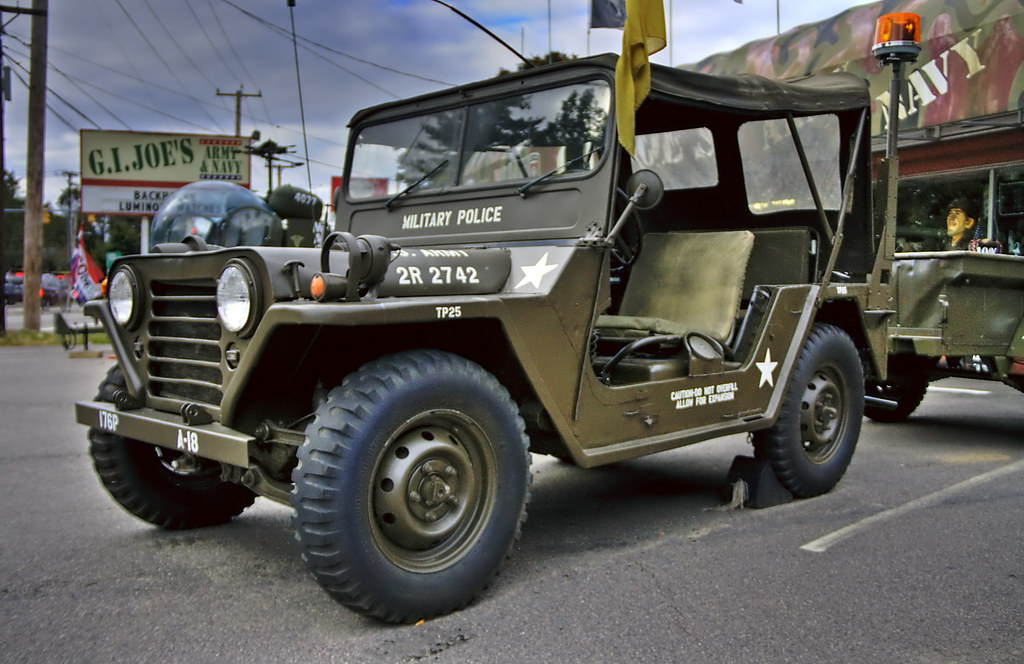

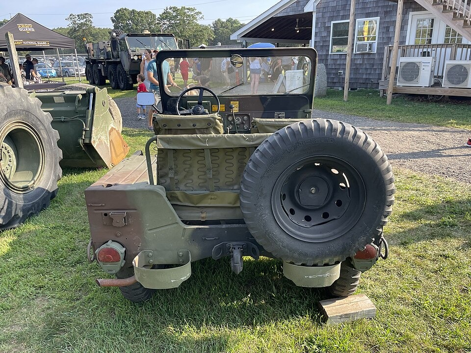

Split front windshield, small turn signal lights on top of front fenders, rear lights are older WW-II style blackout lights, flatter steering wheel, straight rear wheel opening. It also had a trailing arm independent suspension with drum brakes all around. The wiper motors were independent for each side with one being turned 180 degrees from the other. The soft top for it had two differently sized rear window openings as well.

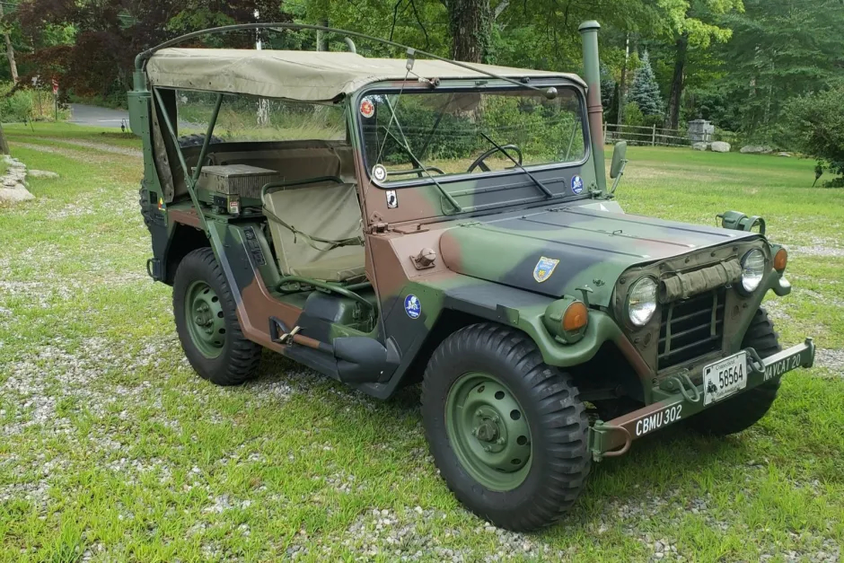

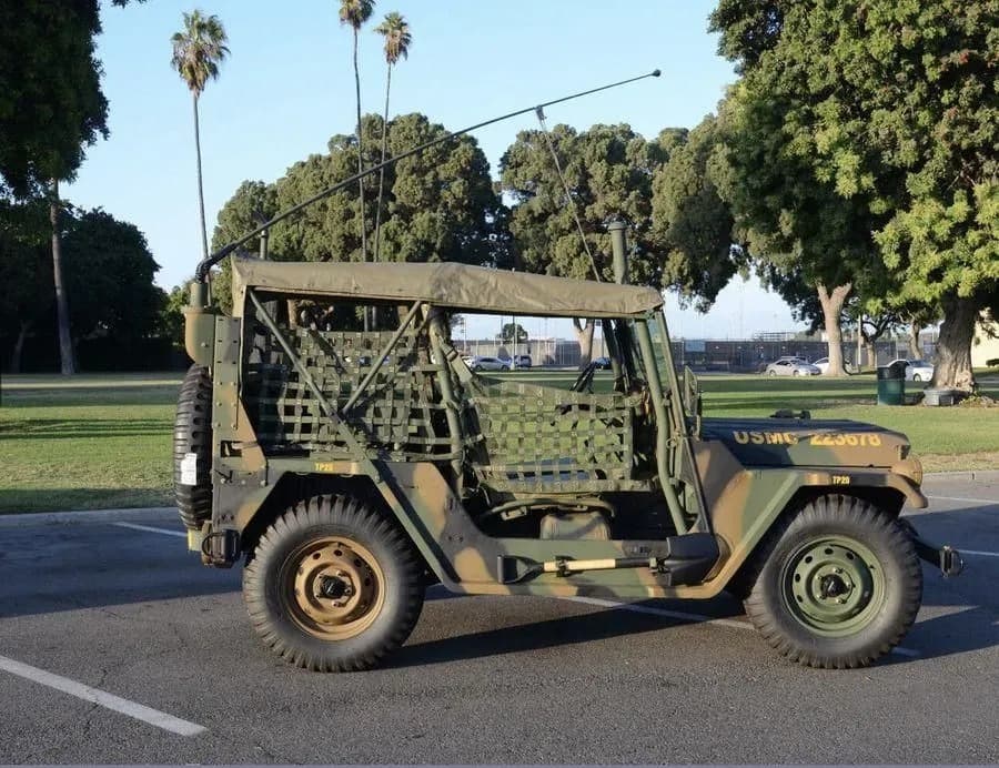

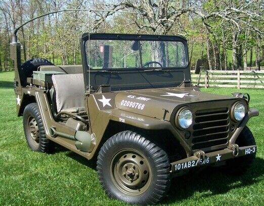

One-piece front windshield, large NATO turn signal lights integrated into front fenders, rear NATO taillights, dished steering wheel, squared-off rear wheel opening. The biggest update was on the rear suspension. The A1 trailing arm suspension tended to tuck under the vehicle and caused it to roll if cornered too fast. The A2 suspension corrected this by using an A-Arm suspension which moved the hinge point to the front so the wheel would travel straight up and down in the wheel well from front to back, as opposed to tucking in toward the centerline of the vehicle. A NATO slave cable adapter was added to the right-side front cowling on jeeps fitted with gas heaters (not all), and a single windshield wiper motor was used in front of the driver. The soft top for it had one large rear window opening.

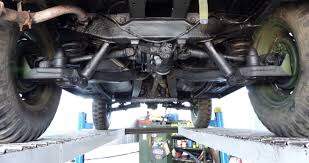

You can tell the difference in the rear suspensions between an M151A1 and an M151A2. From underneath, they look very different.
(#2 is an M151A1 model, while #1 is an M151A2 model.)
From the rear as well. You can see the different shape of the support arms (straight on A1, curved on A2) and the different position of the shocks (farther outboard on the A1).
A1 suspension
A2 suspension

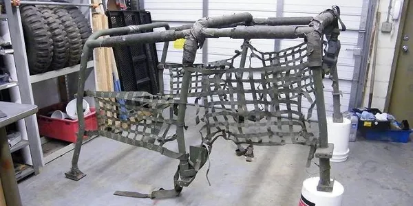

Don’t forget the ROPS, Rollover Protection System
One of these days I’ll build it :smiling_face_with_sunglasses::+1:
Yes, ROPS was used on very late M151A2s as a safety feature. Most A2s did not have them installed during their service life. I have plans to do one with ROPS as well…eventually.

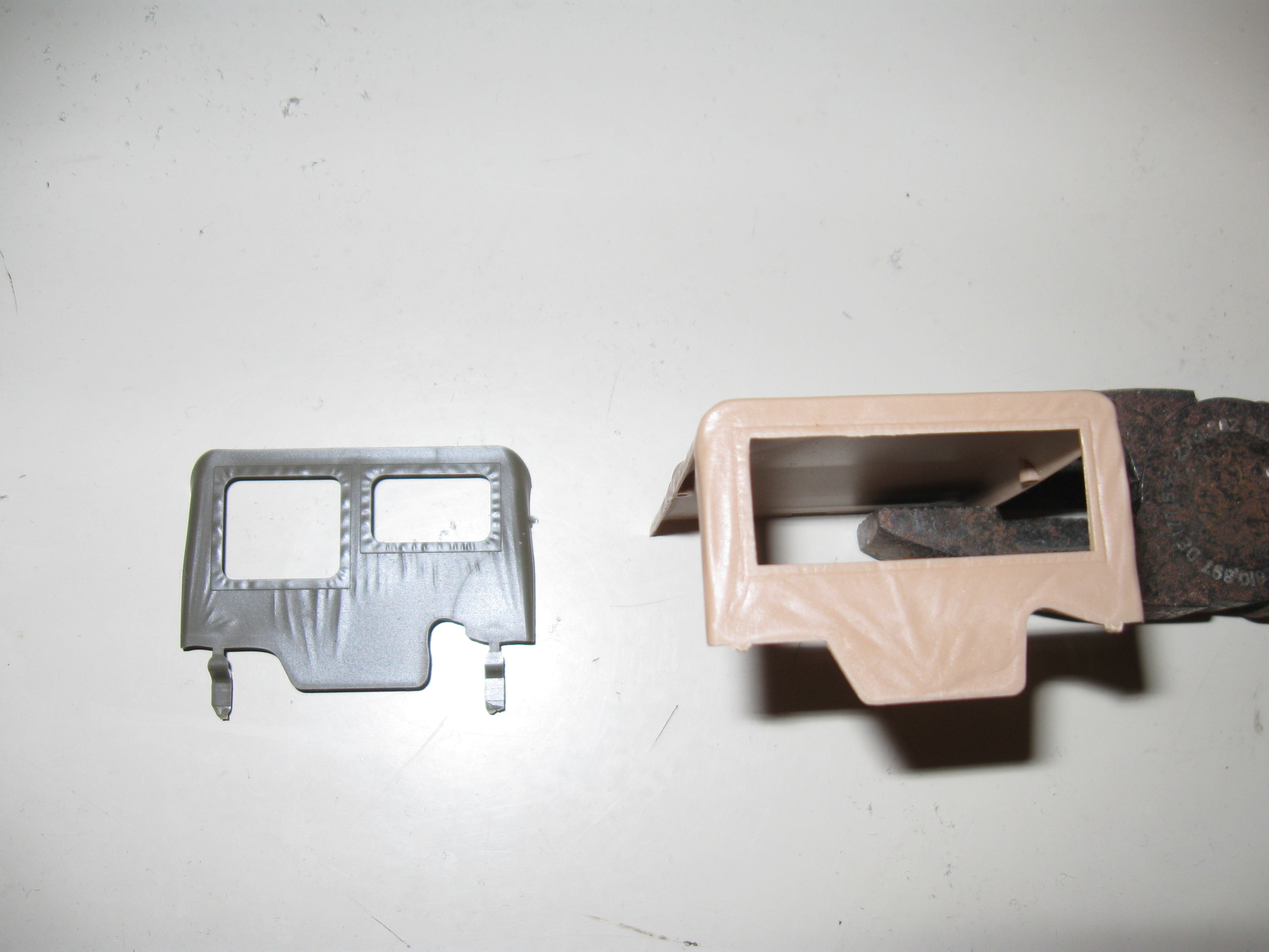

Another difference, if you are using the soft top is that the A1 has 2 smaller rear windows, while the 2 has 1 large one. Wayne
Yes, accurately depicted in the Tamiya M151A1 and M151A2 kits. Academy’s M151A1 does not have a top and is inaccurate in that it still has an A2 rear suspension. All noted in my feature article linked above.

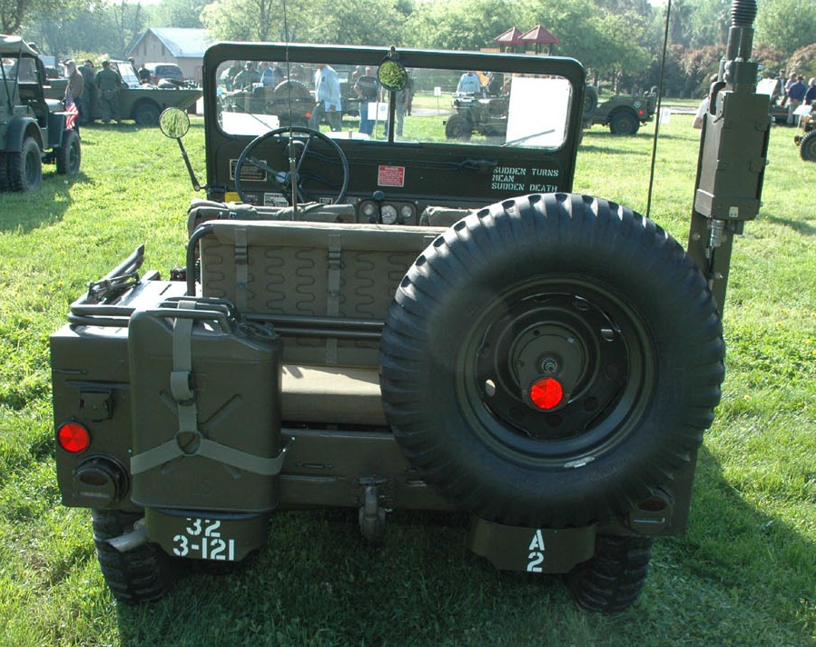

Here’s a pic of a jeep in our unit, I believe its the S-3’s jeep.
