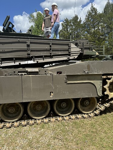

Real thing:
My CAD based on the photo:
Their excrement - see the highlighted:
The drive wheel center cap needs a lot more “fins” around:
Their excrement:
You’ll find Academy Sep 2’s and Rye Field’s version center caps much more accurate with the details. Sure, I’m bordering “rivet counter”.

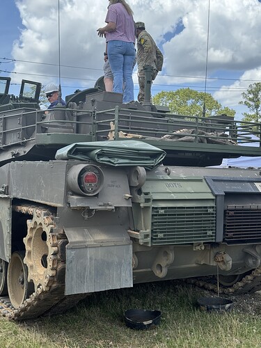

Awesome. I’m building the Panda M1 and now I can build the M1a2 SEPv3. Then I just got to fill in all the variants in between!!!
Nice! Now I see I did my upper left, rear deck incorrect on my scratch build.
Just received my RFM kit
Tracks will need some sanding and I will need some elbow grease
Specific part for the engine deck
