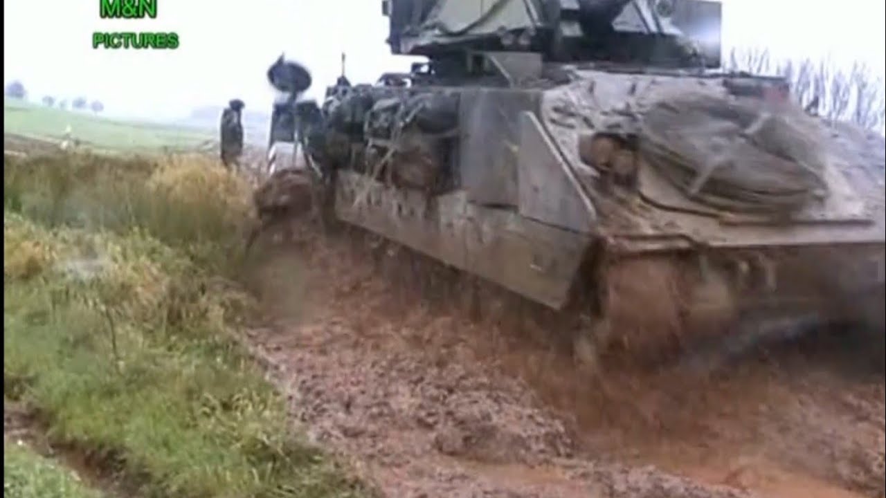

Impressive terraincrossing in heavy mud!
Also very useable as a reference when weathering.
Tearing up the German countryside.
