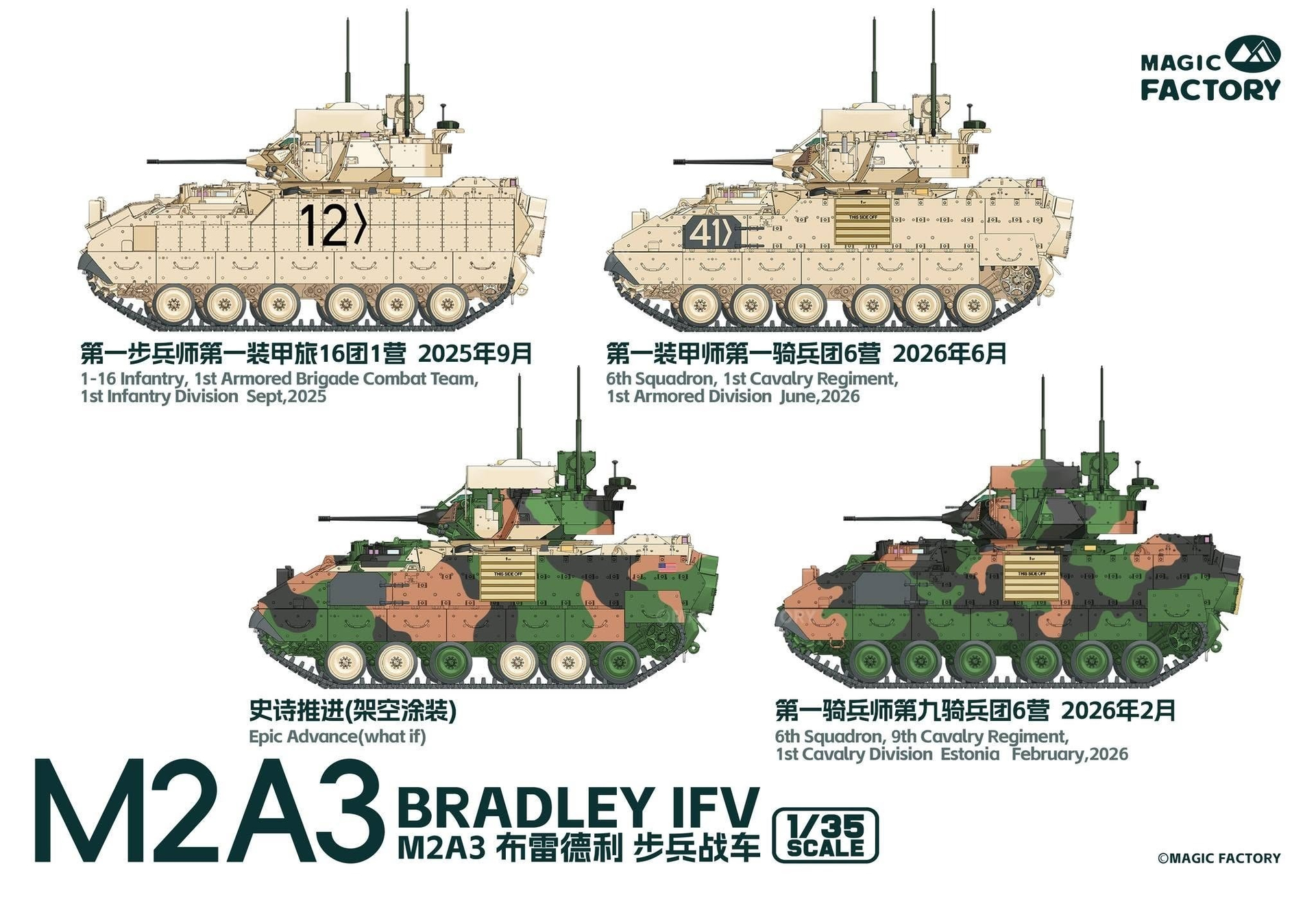

Magic Factory has released another new Bradley as of July '26, this time an M2A3.
The release states:
"This upgraded version includes accurate T161 double-pin tracks, MAPS (Modular Active Protection Systems) components, and broadband communication antennas…Modelers can choose from four distinct marking options: three realistic US Army painting schemes from the 2020+ era, and one “what-if” scheme.
Not sure how this is much of an upgrade or different version than their original M2A3/M2A4/Bradley M-SHORAD kit (kit # 2004)? That one could also be built as an M2A3.
I guess it has the extra sprue from their M7A3 kit for the MAPS (Modular Active Protection Systems) components and broadband communication antennas, and new decals. Everything else looks the same as their earlier parts. We’ll see what the “accurate T-161 double-pin tracks” means. The earlier kits come with T-161 tracks, but they had solid center guides, while they should be open. We’ll see if they correted them.
