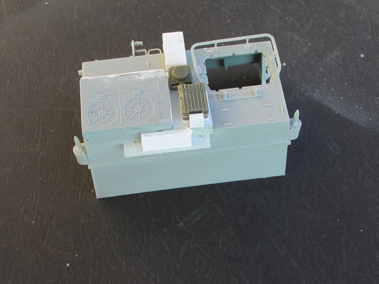

I use the A/C unit, too. but I cut it in half and reduced the width slightly.my track is have the Harris loop antenna with it´s electronic unit (transformer?). I also build the DVE housing, but more of them later.
Still WIP, the “electronics” suite on the cab roof.
Looking nice. Good job on the scratch work.

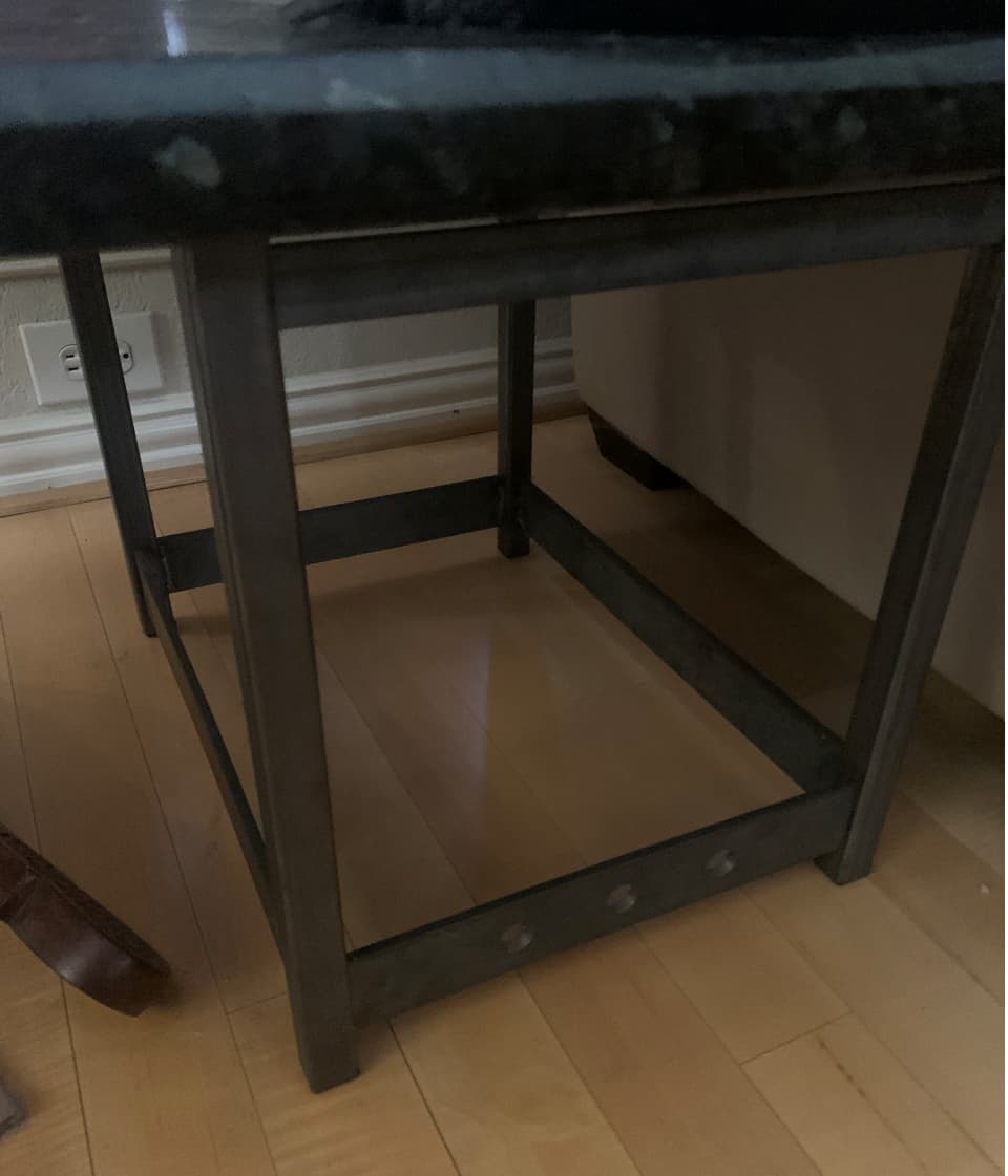

Stahlmöbel Gestelle. Bohren und schweissen.
Interessant. Mein eigener Entwurf:
