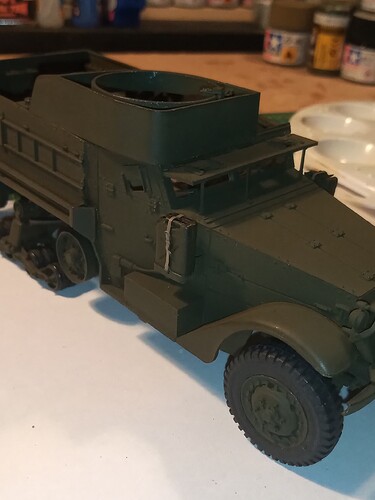

Got back into this and started on some internal work.
Bearing in mind that only 5 were built, I won’t be going crazy with an over worn finish… Dusting and some simple wear and tear and that will probably be it. I take the paint finish was the same method on say Shermans ? I know people have said it was a hard wearing finish so there would be little chipping and paint wear ?
Anyway, some external and inside bits
Fitted the 2 external Jerry cans and the MG pulpit is now fitted
Seat covers, front seats all added and painted. Did a very feint dry brush of oily steel on the gangway tread plate to show a bit of wear on that and the foot/stowage rail.
Thread plate looks good like that. The fuel can in the holder with strap looks great!
Thanks @KoSprueone :+1:
