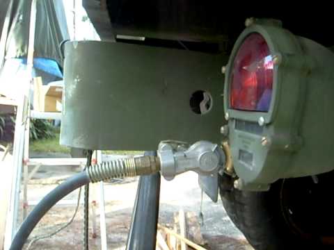

Unfortunately, AFV Club haven’t included gladhands with their M35A2 and M49A2C kits, so I bought some from Perfect Scale Modellbau (# 35083). And now I don’t know where exactly to install them and where the corresponding air lines should exit the chassis rails. Somewhere next to the tail lights, for sure - but where, and do the gladhands bend towards the frame, like the ones AFV included in their M54 kit, or do the lines bend? I haven’t been able to find a decent illustration, not in TM 9-2320-361-10 nor at primeportal or elsewhere, so HELP, please!
Thank you, Robin, I had seen these, but they don’t answer my questions, like do the things go through the tail light mounting braces, or under them?

They are basically in the same place as on the M54 and attach to the frame in the same manner. They are only on the rear though. You can barely see it in the below pic w/the cord for the rear flap attached to/laying on it; poking out behind the taillight.
Better pic.
I woould say the pipe/hose leading to the gladhand from somewhere under the truck goes through the rear light bracket
@HeavyArty the pictures I found didn’t provide the whole answer though …
Grainy still image from this video:
So AFV overlooked not only the gladhands, but a number of holes in frame rails and tail light brackets, too!

The M35 only has rear gladhands. It is most likely due to the vehicle size/weight. The M35 is not really heavy enough to need to use its brakes when being recovered/towed. The above M900 series (5 ton) and the Mack NO (7 ton) are too heavy to tow w/out using their brakes.
As you can see from the M35 TM, only rear gladhands are noted, # 4 Trailer Brake Connectors.
