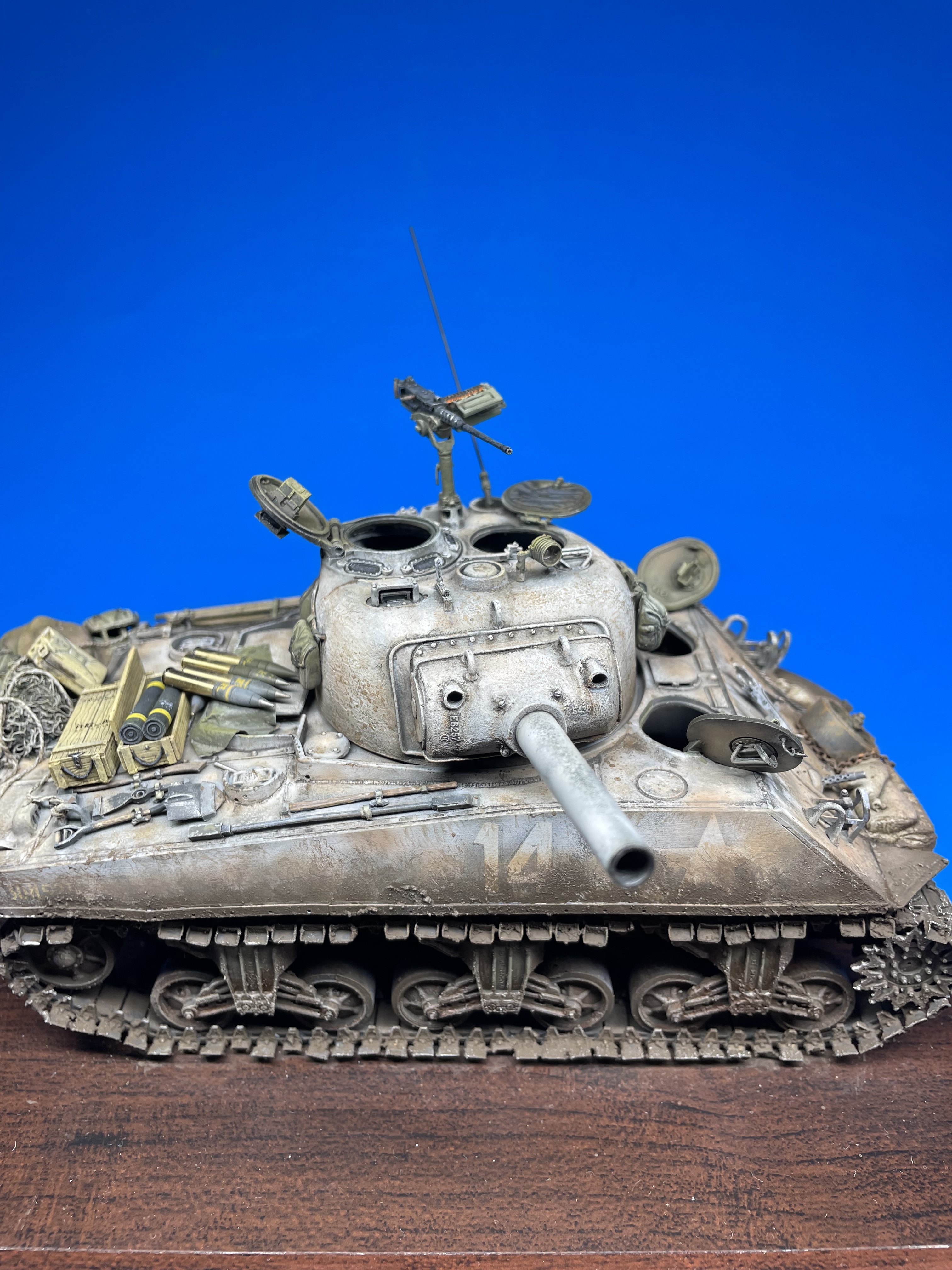

M4 105mm Sherman Kitbash
Yeah it looks cool with the bigger barrel of the 105

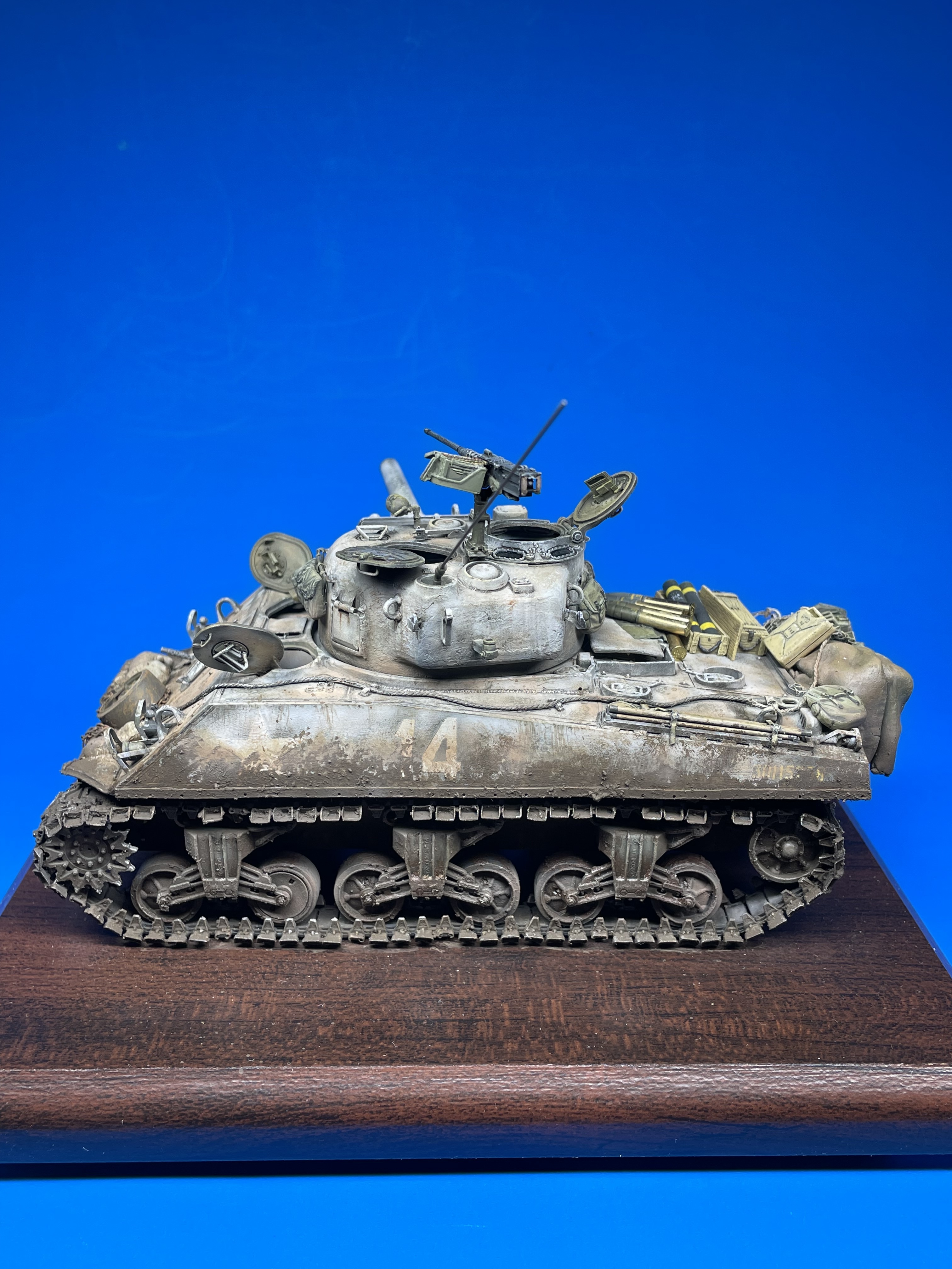

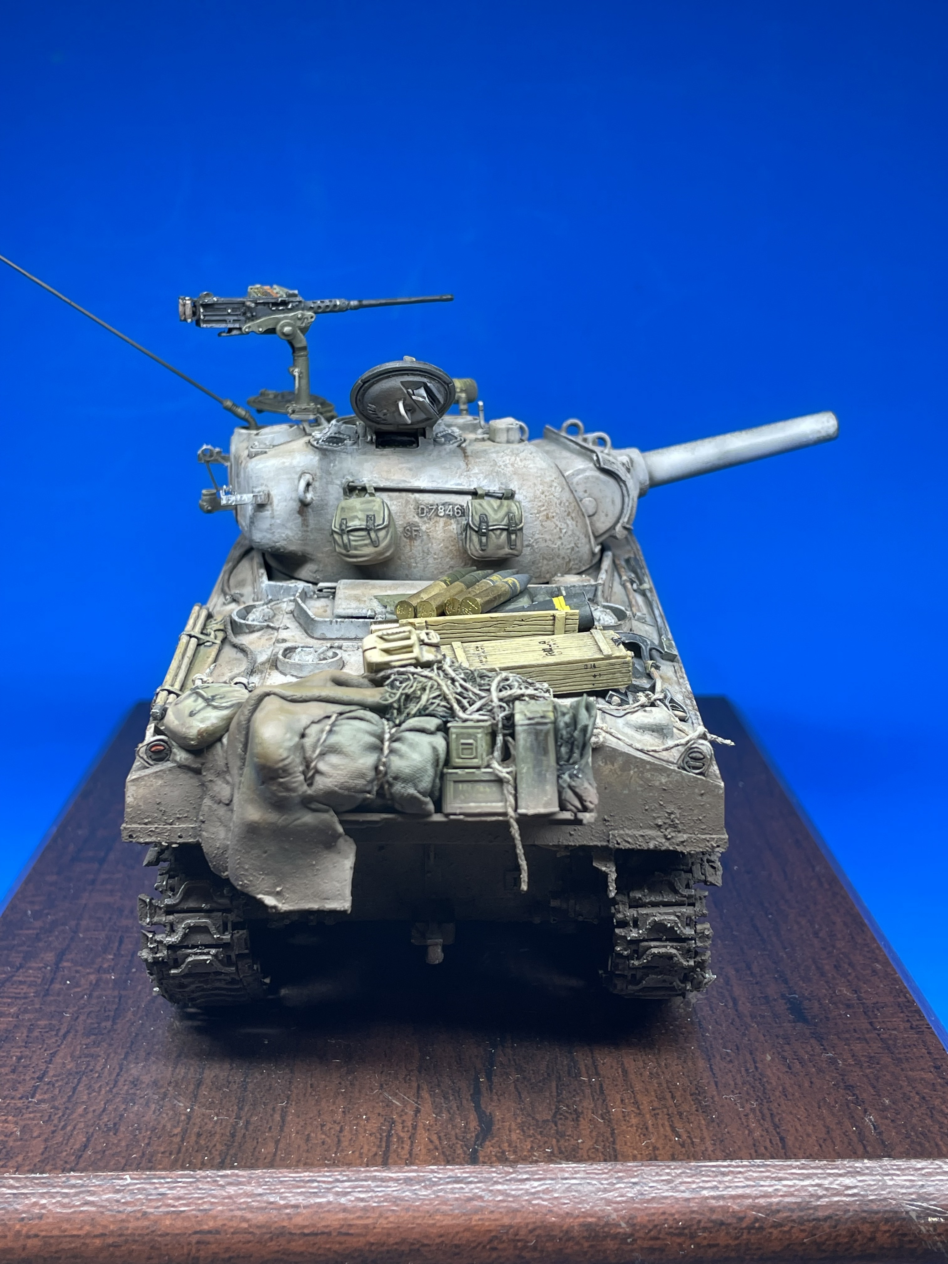

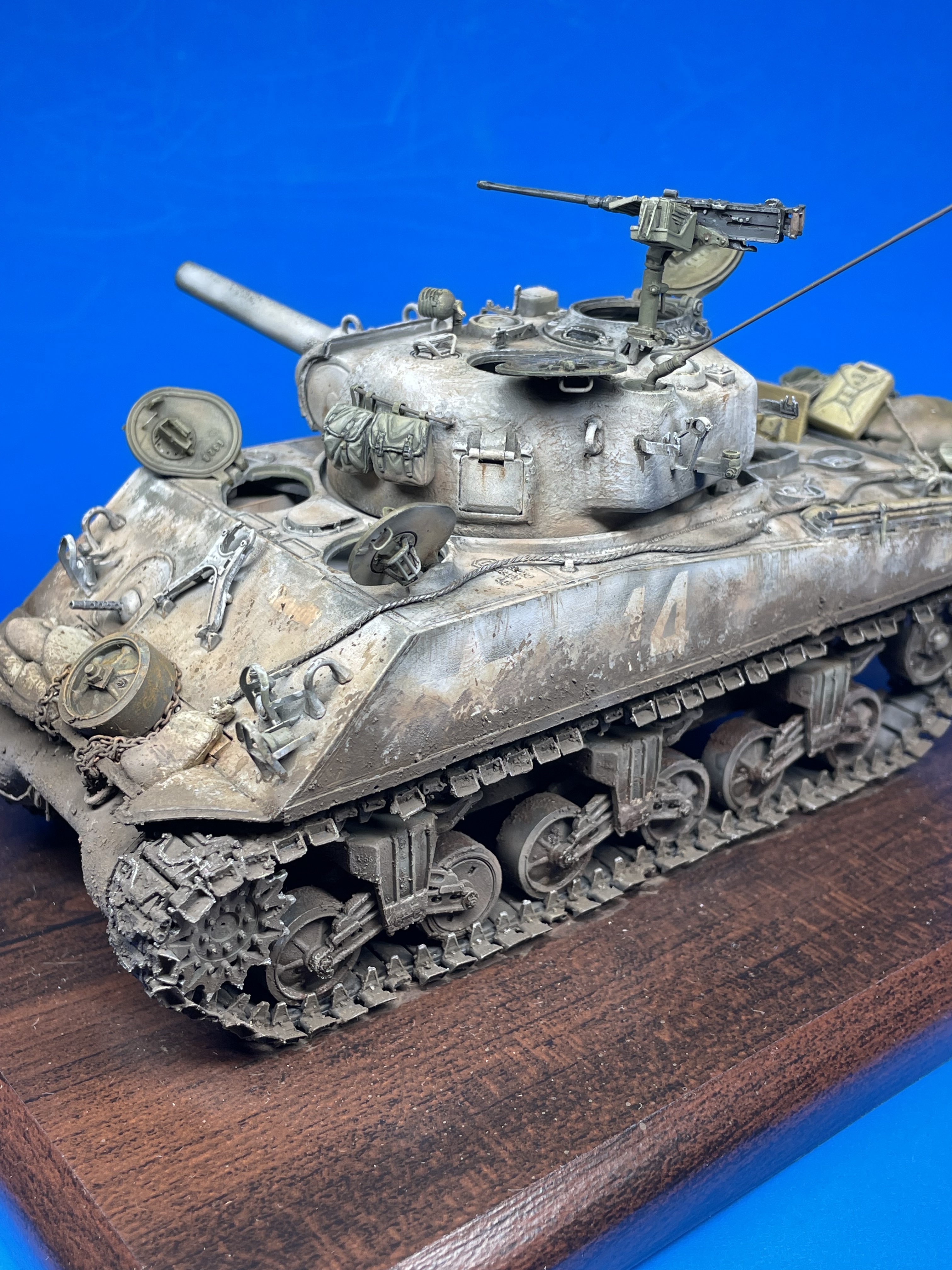

Ok finally bring this saga to an end: I’m calling this one done ( I might add a figure later). Comments welcome .
Balls to the wall Richard! This is an outstanding build! Really solid build, fantastic paint, perfect weathering, and wonderful stowage. That .50 is a little masterpiece that just caps it all off. Kudos on an awesome build. Love the details.
Thanks for the kind comments Matt!
That is some seriously good work, Great Job!
Thank you Jack . I’m glad it’s finally finished, now I can move on to other projects .
Great looking build, congrats.
Thanks Ryan appreciate it
Excellent work!

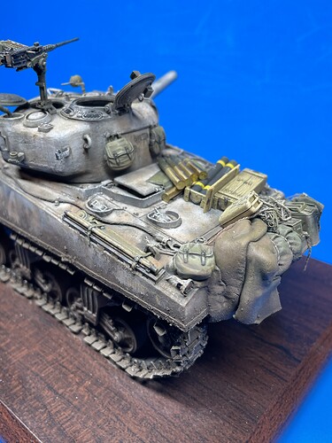

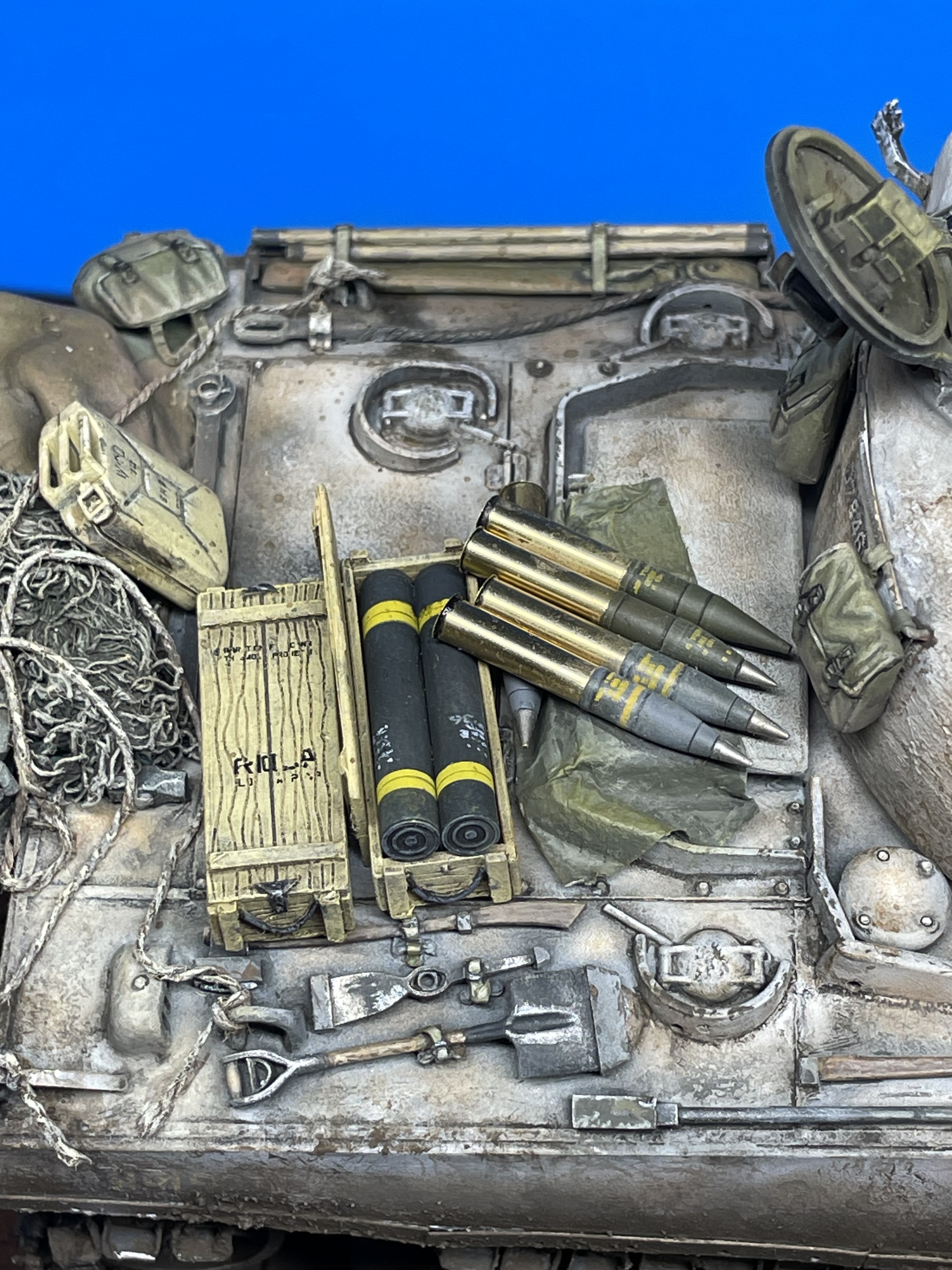

I really like the ammo on the deck. I’d opine that for loading into the turret, the turret would normally be over the left side of the hull, allowing crew to pass ammo down the loaders hatch. And as always, YMMV.
What a great build!
Thanks for the kind words Ted!
I wanted to turn the turret just to add some interest instead of it being straight ahead. I do plan on putting the tank in a diorama at some point. I could always turn it the other way, but I wasn’t planning on having the crew loading ammo; my plan is to have this old verlinden figure who is holding a panzer Faust with a small crowd around him looking on in awe including the tank crew. I have to play with the composition a bit. I’m also adding an M8 (10?) ammo trailer to the scene, but again I’d have to see if it works with the base I’ll be using.

The normal way with Shermans was through the pistol port. Why lift whole boxes of ammo up onto the rear deck if you can unpack them on the ground, and going through the pistol port means one fewer crewmen having to be involved in loading the ammo than through the loader’s hatch.
The question you always have to ask, though, is: Were they also this strict in 1945? Chances are very good that they weren’t.
I agree, I’m sure there was more than one way of doing things and you make a great point about making it easier to load rounds into a tank. Troops will always find the easiest way to do something ( at least we did but that was in peacetime ) not necessarily safest, nor according to regulations; which I think if they weren’t outright ignored they were “modified “ lets say lol.

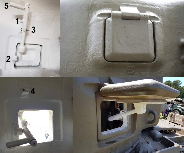

Size matters! But first, some history.

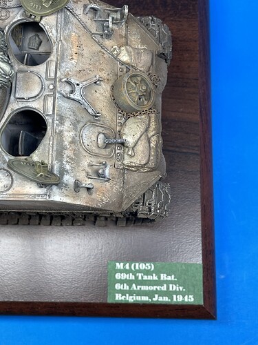

The first M4(105) was produced well after the original D50878 turret pistol port was deleted. Tanks in manufacture and depot had their ports welded closed. This started in June 1943. The pistol port was restored starting late 1943, with the updated D50878 turret. The best I can get is a November date, but some turrets w/o ports were in-stream before the latter turret entered the pipelines.
The M4(105) was first built in February 1944, and all 1641 were finished by March 1945. All the M4(105) were built by Chrysler. So whether an M4(105) had a port was a question of timing. As it was, the last VVSS M4(105) was produced in September 1944.
The TC’s vision cupola was introduced to the M4(105) line in May 1944. So Richard’s M4(105) was produced in those 3 to 4 months.

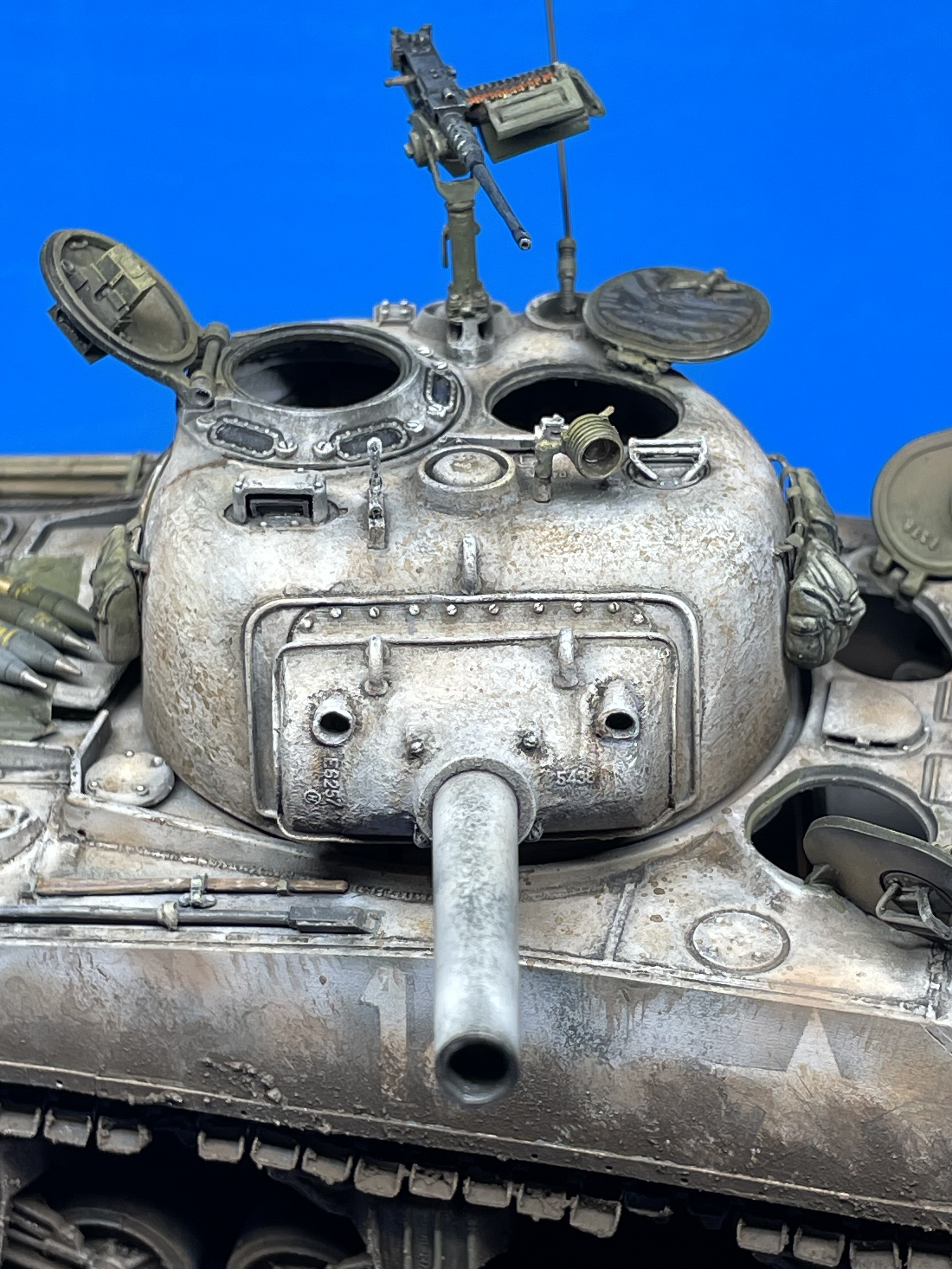

But the real problem is the port itself. The lever that open/closed/locked the port obstructed the 105 round passing through. The port opening was ~7” wide iirc. I think I saw you have drawings, so please set me straight!
With the port latched open, a 105mm didn’t fit well through the port. It was 5” longer than 75mm, and ~2” bigger (at the rim give or take) in diameter. The latch blocked the port rather effectively, and hence the 105 gets up porn the back deck, and down the hatch (no pun intended).
I also note Richard’s M4(105) doesn’t have the bulge at the right front, and also has the high lifting lugs. Chrysler reportedly ONLY made two of these, so the kit-bashing is making things complicated.
My head hurts. You’re right, crews liked the port. It was restored. But some interesting circumstances made it unlikely the 105 round would be loaded through the port.
PS- Jako, I think you have drawings. I’d appreciate help. Then, I’m going to the Armor & Cavalry Collection on Friday, and I’ll find out!
Was there strict compliance? “Always” is one of those words I avoid, because obviously it wasn’t if Richard has a reference photo!

Hey Ted is the bulge you are referring to on the right front of the turret? I definitely missed that.
