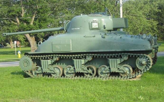

He said its a Grizzly with one of the 17 pounder the British shipped over to the US. Does anyone have anymore information on this tank? Also I want some obscure Canadian armor in my collection so this is as good as any I guess. So how hard would it be to build? Get like a base Sherman set then a Grizzly conversion and Canadian tracks, a firefly turret and only use the barrel and rear bustle rack? Anyways as always love to know what y’all think!
That sure looks like a firefly to me. If it is a grizzly with a 17 pounder it sure is cool. Another possibility for an obscure Canadian piece of armor is the AFV club Churchill MKIII from Dieppe. I need to build mine soon, but the division that supplied these tanks was stationed about 20 minutes from my house, and one of the tanks bore the call sign of my home town. I can’t wait to build it
Ooo that looks like fun! Yes it is a Grizzly, note the 17 tooth drive sprocket and the CDP track (Canadian Dry Pin) as opposed to the American 13 tooth drive sprocket and tracks. I also thought it was just a Firefly when I first saw it and about 98% of people will think the same… Ooh well the joys of modeling!

I will waiting for your Churchill log! Im not sure but I think there may only have been two Grizzlys with the 17 pounder,( I think it was only used for testing and training) so defiantly obscure!
I was watching a video on Grizzly’s and they say these tanks underwent full Firefly conversions, does that mean they have different turrets or were they just added to the existing turrets?
If the conversion to these was the same as standard fireflys then they used the same turrets but modified them. The 17 pounder was too long for a standard Sherman turret. To cope with this two things were done. First the gun was rotated 90 degrees. This way loaders could lift the shell onto the breach instead of sliding it in (they didn’t have the length to slide it). Second a whole was cut in the back of the turret and the radio box attached. The recoil from the gun would have hit the radio were it was previously. The last thing they did was cut a hole for a loaders hatch. The new breech was so long it blocked the loaders exit and so he needed his own hatch.

This looks like a Frankenpanzer. The British never used M4A1’s (or Grizzlies) for Fireflies, though they did use the M4 Composite hull. I suspect this is a turret-hull mismatch by the museum.
@geraldowens, yes the British didnt use the M4a1 but the Canadians did. The pictures of the tank above isnt a regular Firefly its a Grizzly with a 17 pounder used by the Canadians as a training tank.
Doing some research I found this written on the old forums which gives me some great info.
There were 188 Grizzlies built and they all stayed in Canada. If you want to buid one, you can do as Jim says and use any intermediate to late small-hatch M4A1 Sherman configuration with a few changes to stowage. Given that there were only 188 of them made they did have both welded on and cast-in applique on the hulls and I think the ones at Borden have the cast-in reinforcement on the turret cheek.
The addition of the Firefly turret to the Grizzly would have made it, more or less officially, a Grizzly Ic Firefly although I’ve never heard that anyone has found a document with it named any way in particular.
There was only the one made as a trials vehicle, but it was a full conversion, with the ass’t driver’s position cleaned out and ammo boxes put in, just like a real Firefly. You can see from the photo that instead of a plate over the MG position, the Borden Firefly has a plug welded into the MG hole.

Yes you can tell that this is a Grizzly with a Firefly turret and not a Firefly IIc because there were never any Firefly IIc’s produced. Just Firefly Ic composites that are misidentified as Firefly IIc’s. Plus you have all of this source info to back you up, so have at it Ezra! I’m going to gather the parts to build one (someday) too! This is a very interesting tank!
Id love to see you build this someday! Yes it is very interesting and obscure, the downside is almost everyone who sees this tank will automatically assume its a regular Firefly!
