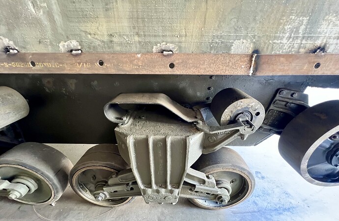

The US Army Armor & Cavalry Collection (The Collection) has begun restoration/preservation of the aforementioned vehicle. Initial gleanings from my conversations there are that it should be ready for a celebration of the creation of the US Army Armored Force on 10 July 1940. Also mentioned was a plan to use this vehicle to reflect upon and honor the fighting done after the D-Day breakout during the Battle of the Falaise Pocket.
I grabbed these initial pics, and I imagine there will be questions. Patience, grasshoppers. My next visit is 25-28 April, and I’ll see how the restoration team is doing and what they might share.
Meanwhile: some teasers
NOTE- I do not have (YET) the SN or RN of this particular vehicle. However, several features make it one of the earliest (76)w VVSS built. For reference, I used the Sherman Minutiae website (merci Pierre et vos amis!) to compare and contrast what I saw in my very brief visit.
A few more pics:

The best you may be able to do is find the build number stamped on one or both sides of the rear hull in this area:
The small yellow box is where this tank’s number was, the red boxes are where it’s been seen on others. Sometimes the number is inverted which makes it harder to pick out.
