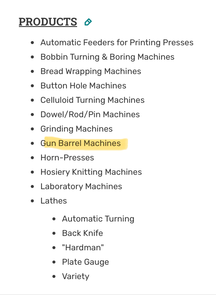

Interesting discovery-
While doing more background work for the (subject), I ran across this about Cowdrey-
Curiouser and curiouser!
“Gun barrel machines” are likely for making small arms barrels. Cowdrey did not produce cannon making equipment for sale as products. In fact, they didn’t actually make cannons themselves. Their Massachusetts facility was leased by American Type Founders and operated as their Cowdrey Machine Division.
