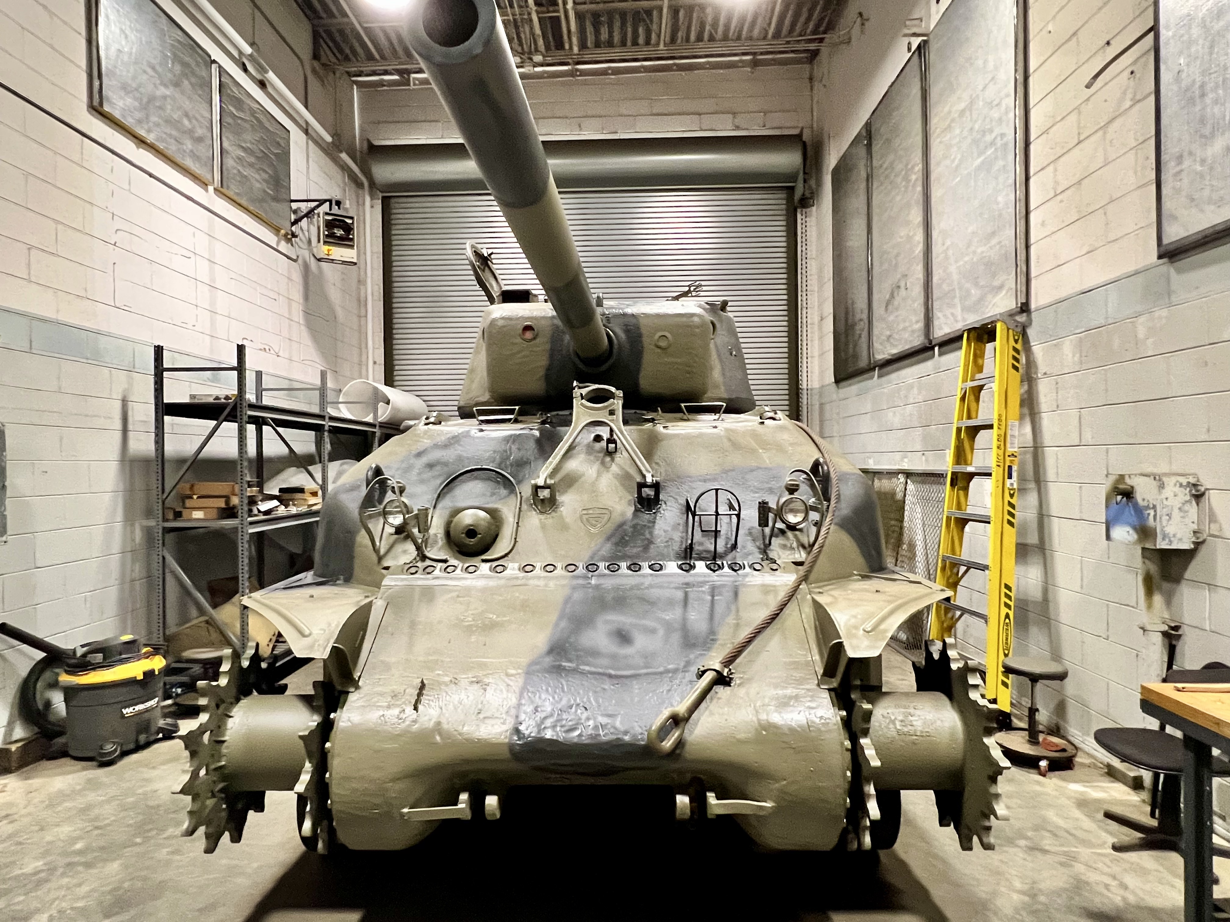

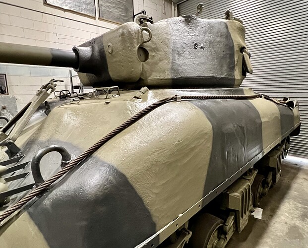

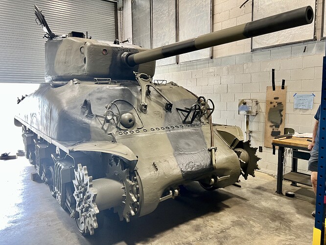

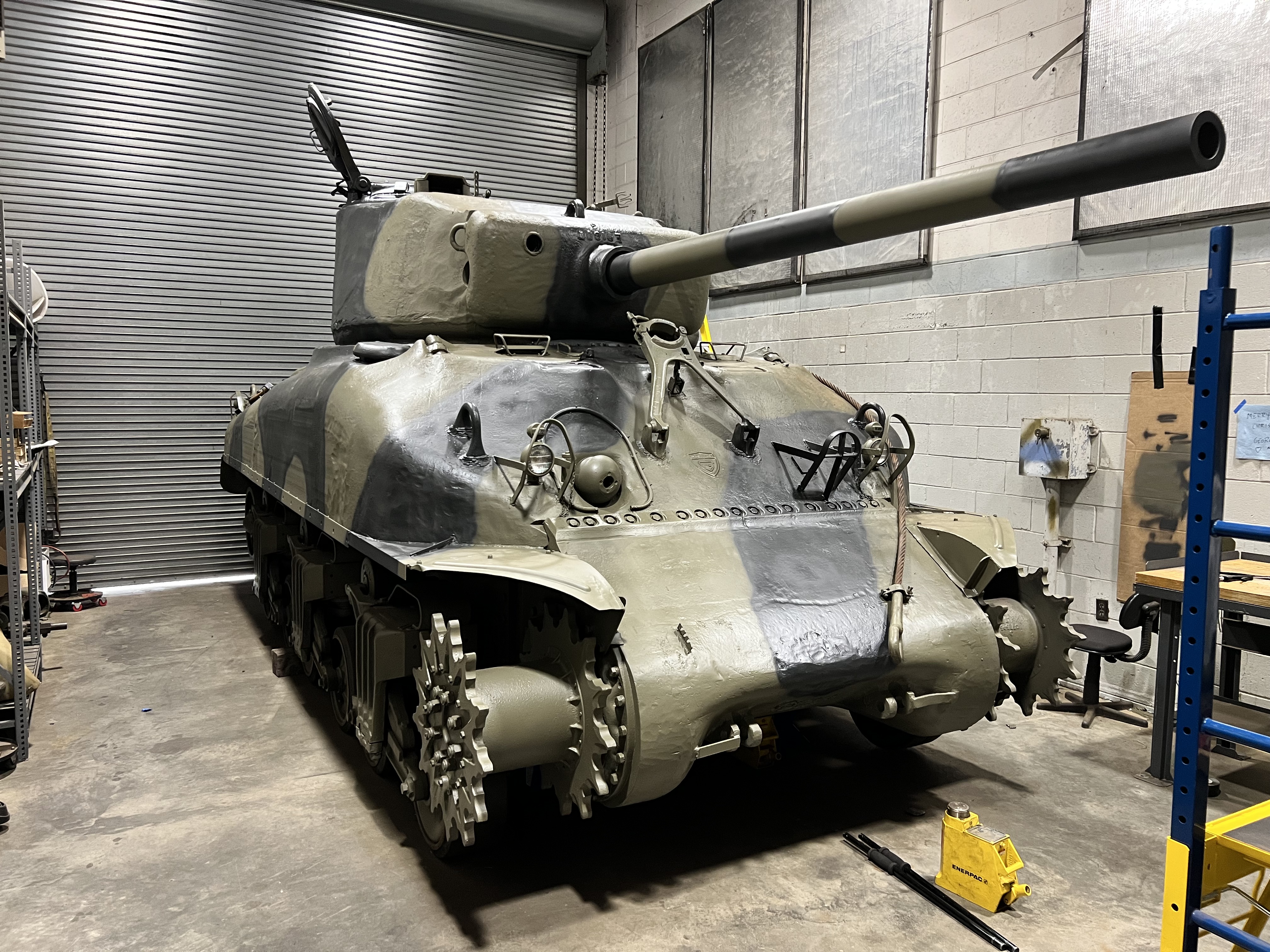

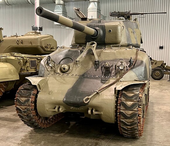

We are nearly finished. The volunteers (all LTs using their spare time to fix old tanks!) made great progress. You can see it:

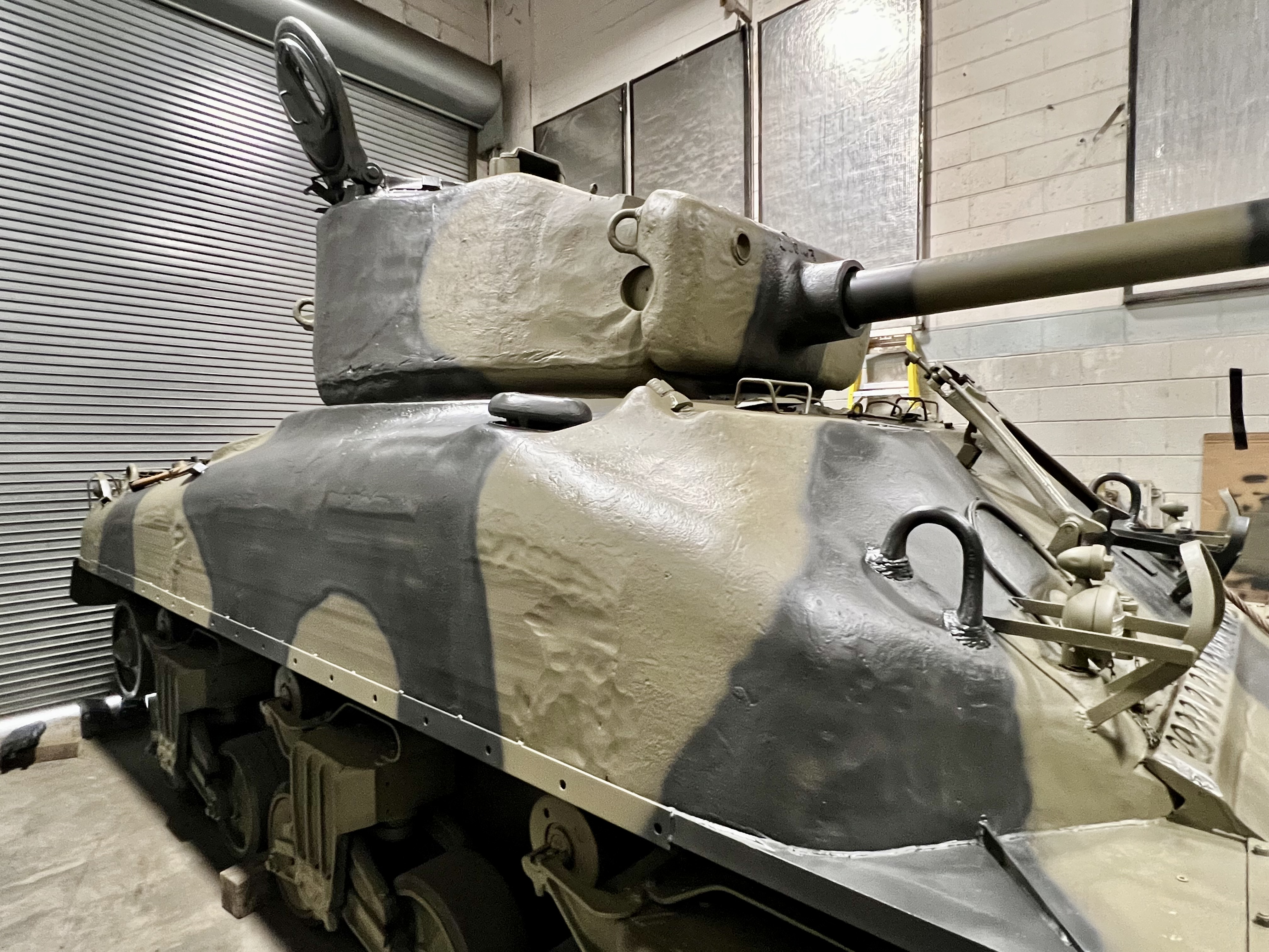

Pics taken at different times door open and door closed. Two-tone camouflage is really well done, by a gifted 97-pound LT who starts ABOLC next week. We’re still sorting things: I’working on getting the split hatch latches to work, and on finding/fabricating a vision cupola periscope cover. Might go steal one from the back lot. We have “as-found” track and aa roll or three of essentially unused track marking will be last, after the colors cure I wager.

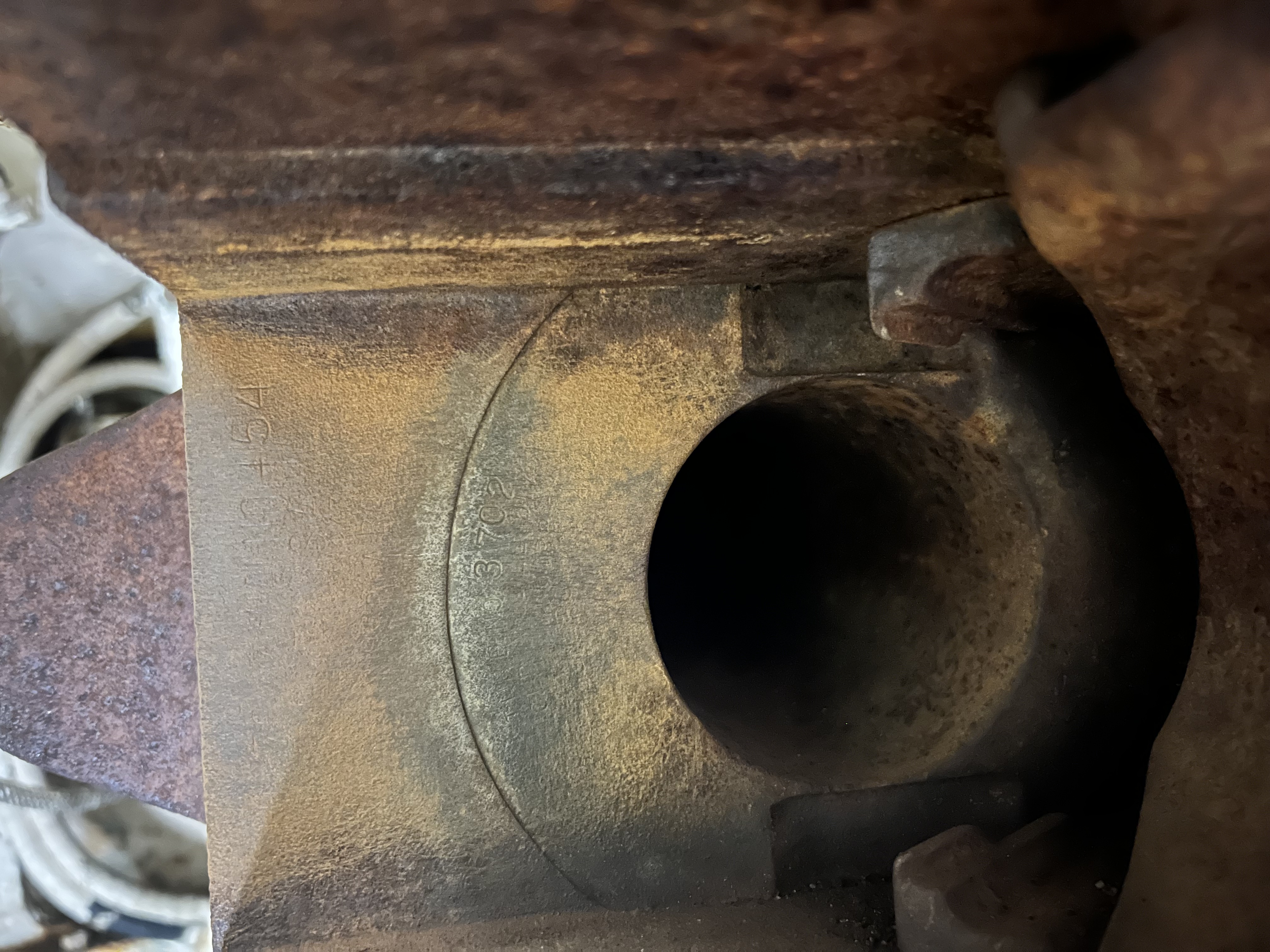

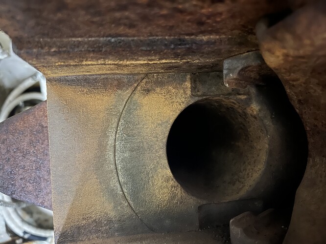

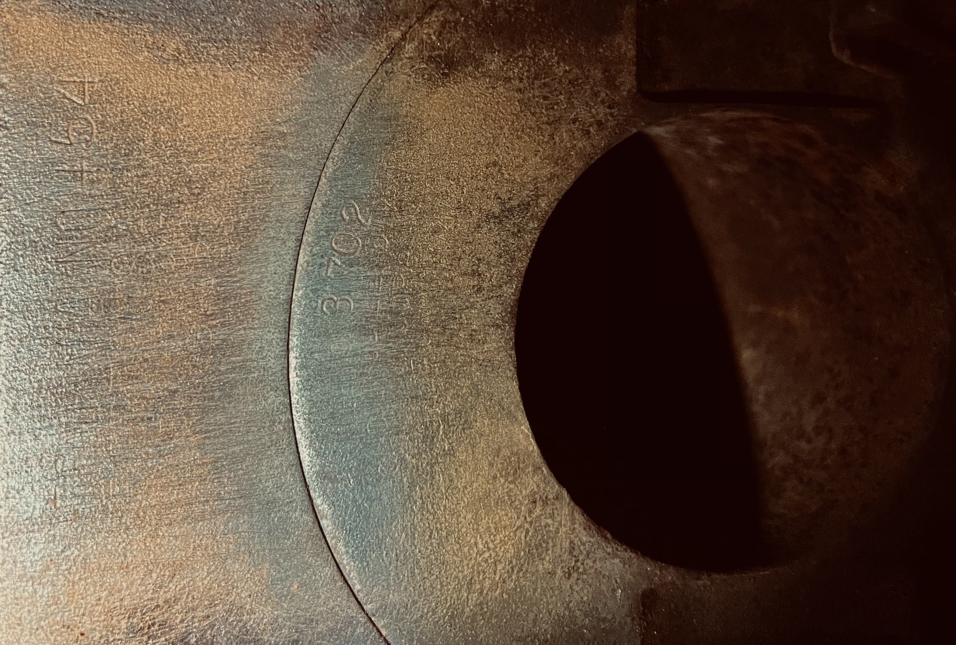

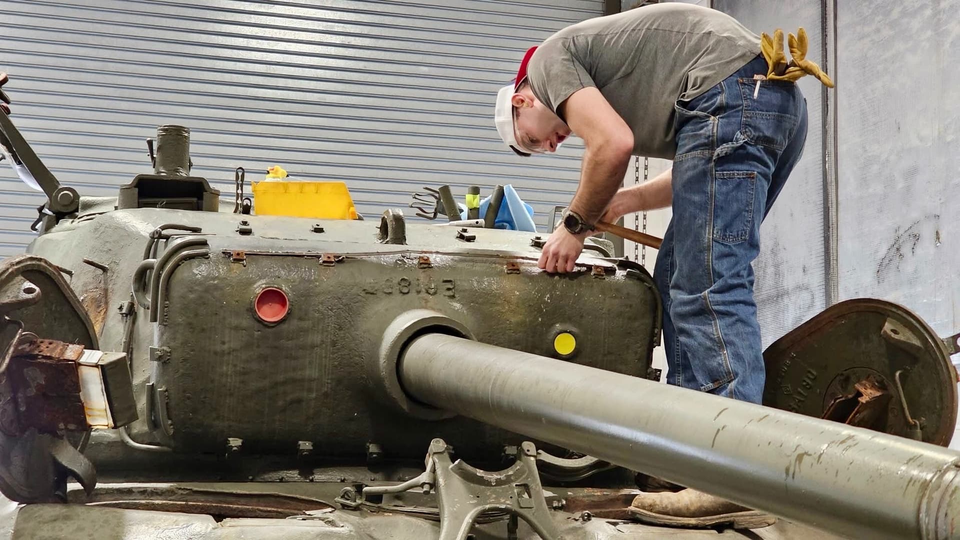

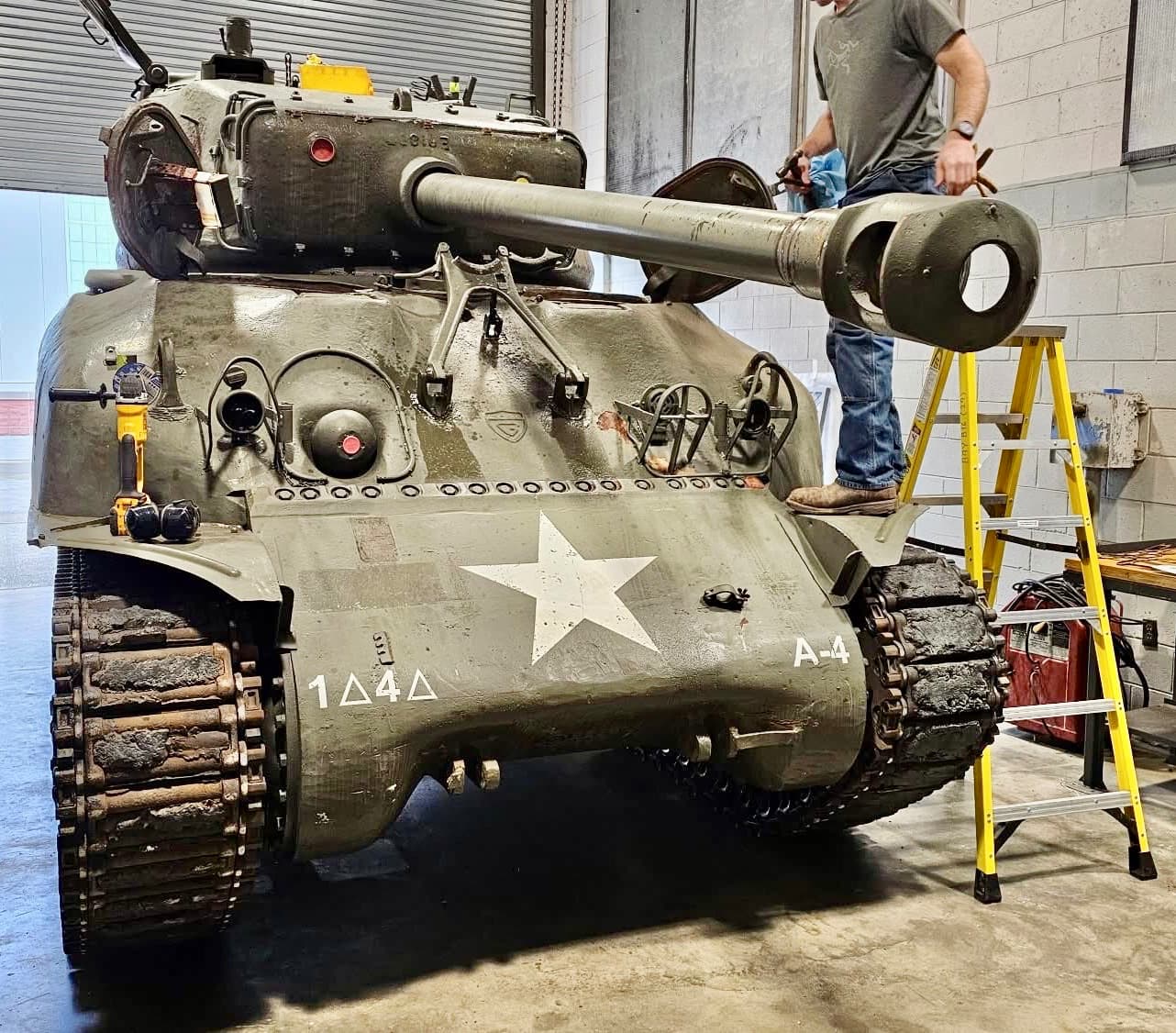

The barrel is indeed 156” (13’) exactly muzzle to breech ring. JJ (our machinist) got the length, taper, and everything perfectly.
Breech Ring
Looks like tube number 3702.
It sure looks nice, but none of my display shelves are strong enough to hold it! :rofl:
Seriously, those guys did a great job.
Looks excellent Ted! Great work there!
We have quite a crew! All are Armor/Cav officers, backed up by some VERY experienced NCOs and WOs!

Just a sample of our young leaders.
I’m not sure when the “reveal” is planned yet. We’ll keep you posted.

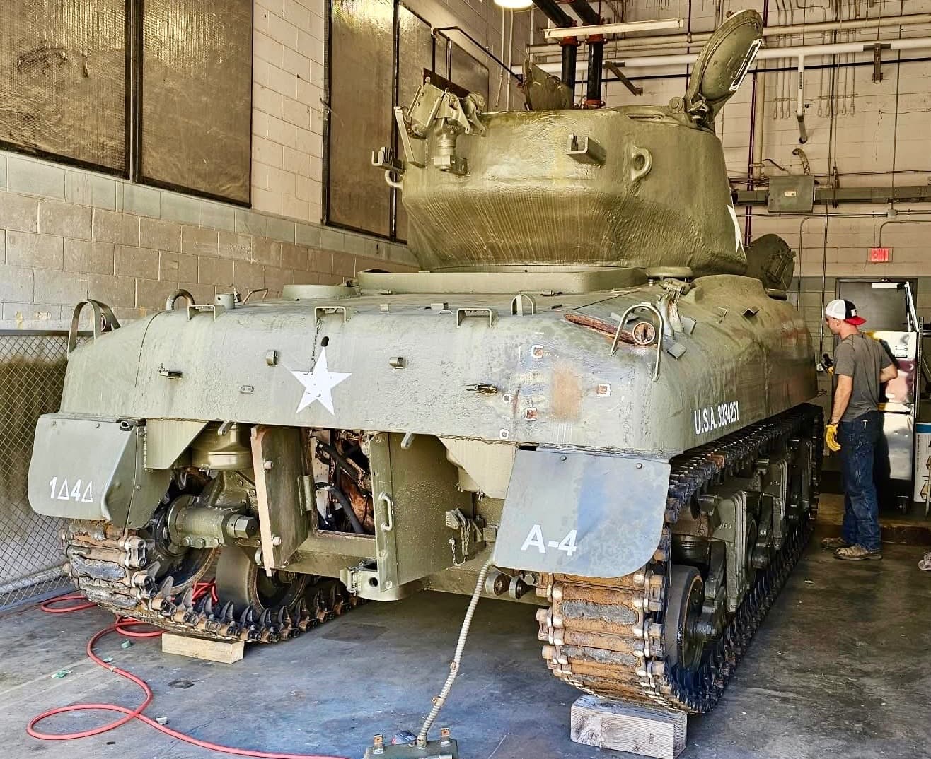

Continuing detail work on the turret fittings. Still on-track.
Work has proceeded despite my absence, or perhaps because of it. Well, I need to find out more about this. Odd, as it is different.
Where did this come from?
I don’t have all the facts, so I’ll wait until I visit this week or early next.

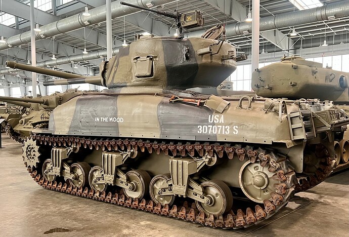

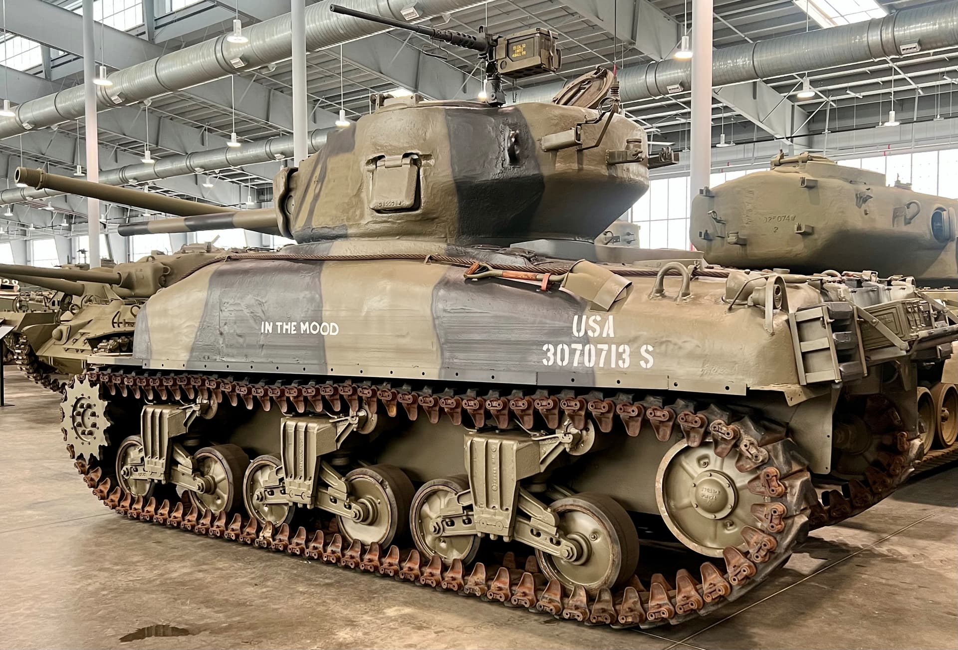

Cue Glen Miller
Behold: In The Mood

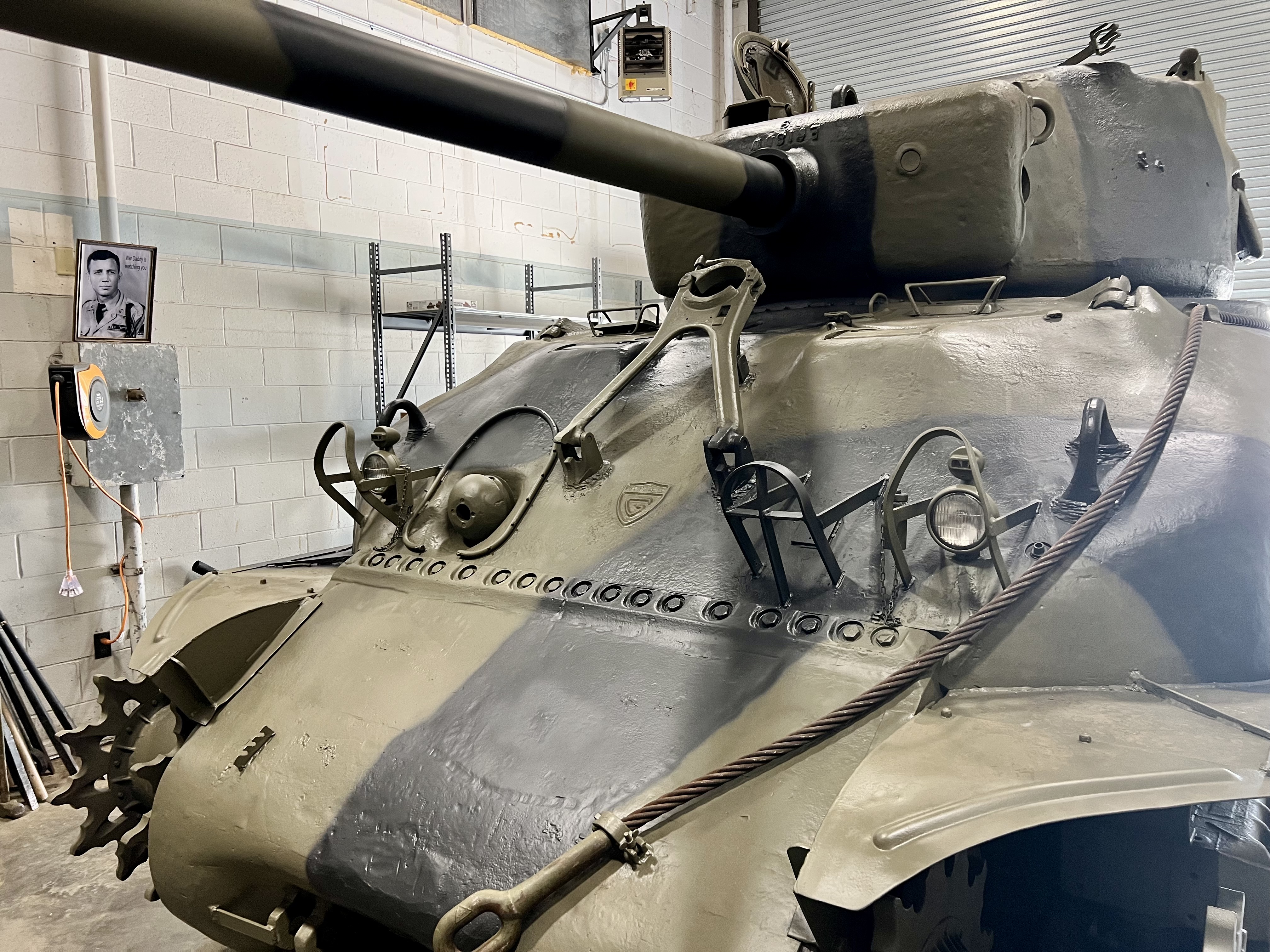

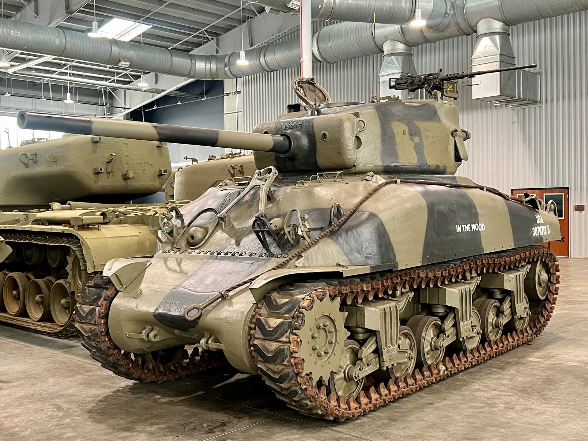

We’re looking for Bow MG bits, and some periscope covers, et al. This is intended to closely replicate SSG Lafayette G Pool’s third M4, this an M4A1, and the 4th of that variant [M4A1(76)w] produced.
I’ll be down Thursday and see if I can get intel.
Awesome!
But I believe that OD is not the correct shade….LOL LOL LOL!!!
LOLZ! WHICH ODG Shade 8 were you thinking!
In my 30 years on US armored fighting vehicles, I saw perhaps hundreds of faded and production variations.It’s a chore. Oddly, the German tanks are often easier to color match, because everything under everything is painted Gelb or Brun.
And remember, this pic is under tube lights, and processed digitally.
That thing looks outstanding, great work by you and your crew!
PS- this is NOT In The Mood, btw. Someone asked me in a PM.
