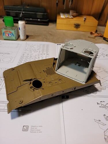

M578 (Italeri, Perfect Scale Modellbau)
Hi all…
Started a new project.
The M578 in a Vietnam setting.
I use the Italeri M110 and the perfekt scale modellbau M578 turret with interior.
Noticed early on that this kit will take its time.
Here is the current status.
The back of the hull
Started on the turret
Thanks for watching
Cheers :slight_smile:
