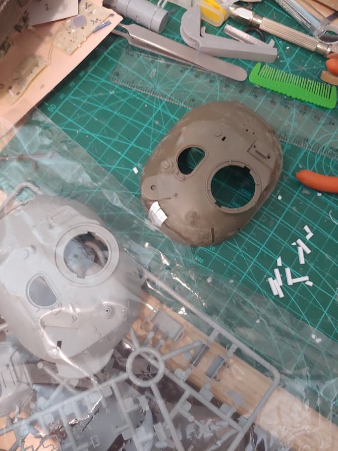

First, just for the challenge, decided to convert the Tamiya M48A3 turret to M60’s turret by adding more bulge. I’m adding some “bones” first using Evergreen rods then add and sculpt the shape using Magic Sculpt compound after.
Tedious so far but fun. :smiley:

Modifying any M48 tank turret to M60 turret is going to require some tedious work - which I started above. The main work is trying to get that rear of the turret to have the extended steep shape (I don’t know why the extended space b/c at first I thought it was to accommodate the 105mm gun of M60 but M48A5s (generally, A3s retrofitted with the 105mm gun) retained the same round turret shape.

Aside from the turret difference, the front return roller has to be moved when converting to the “slick”, in addition to deleting the #2 shock and mount…

Getting ready for some sanding and magic sculpt adding.
