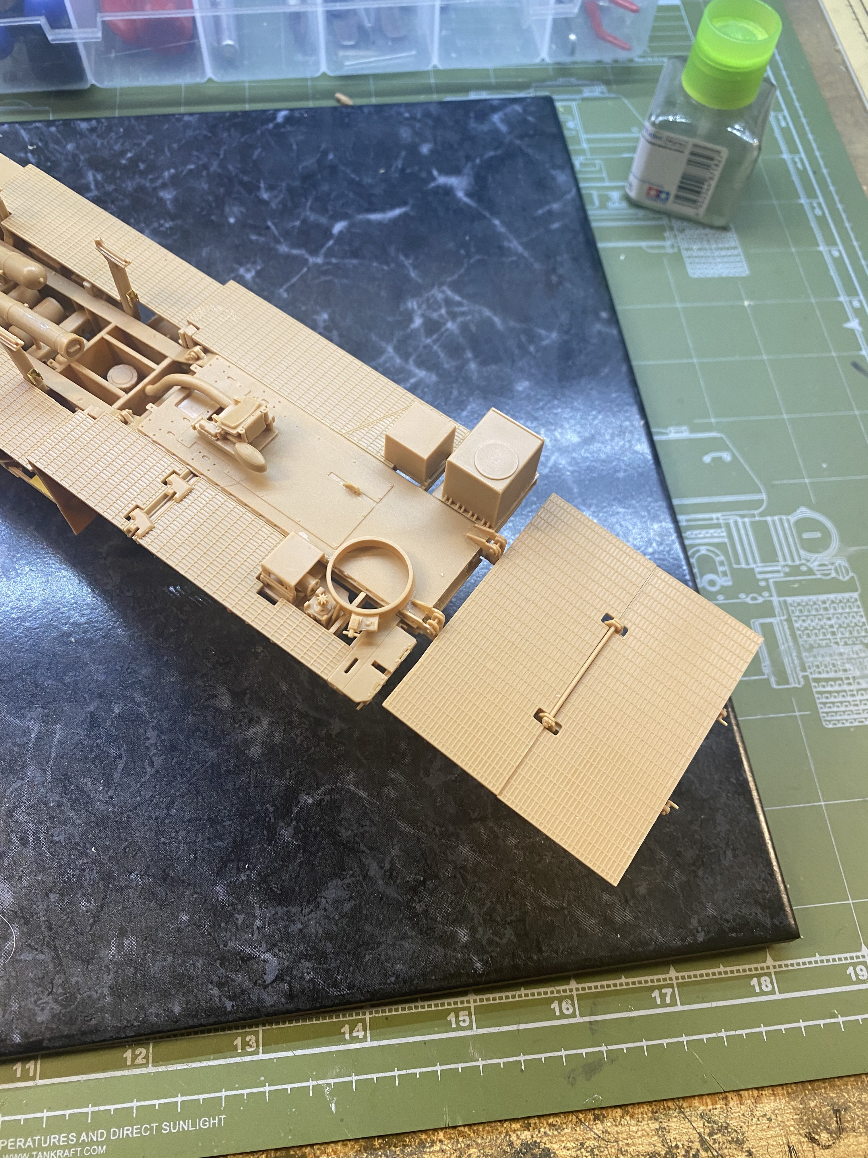

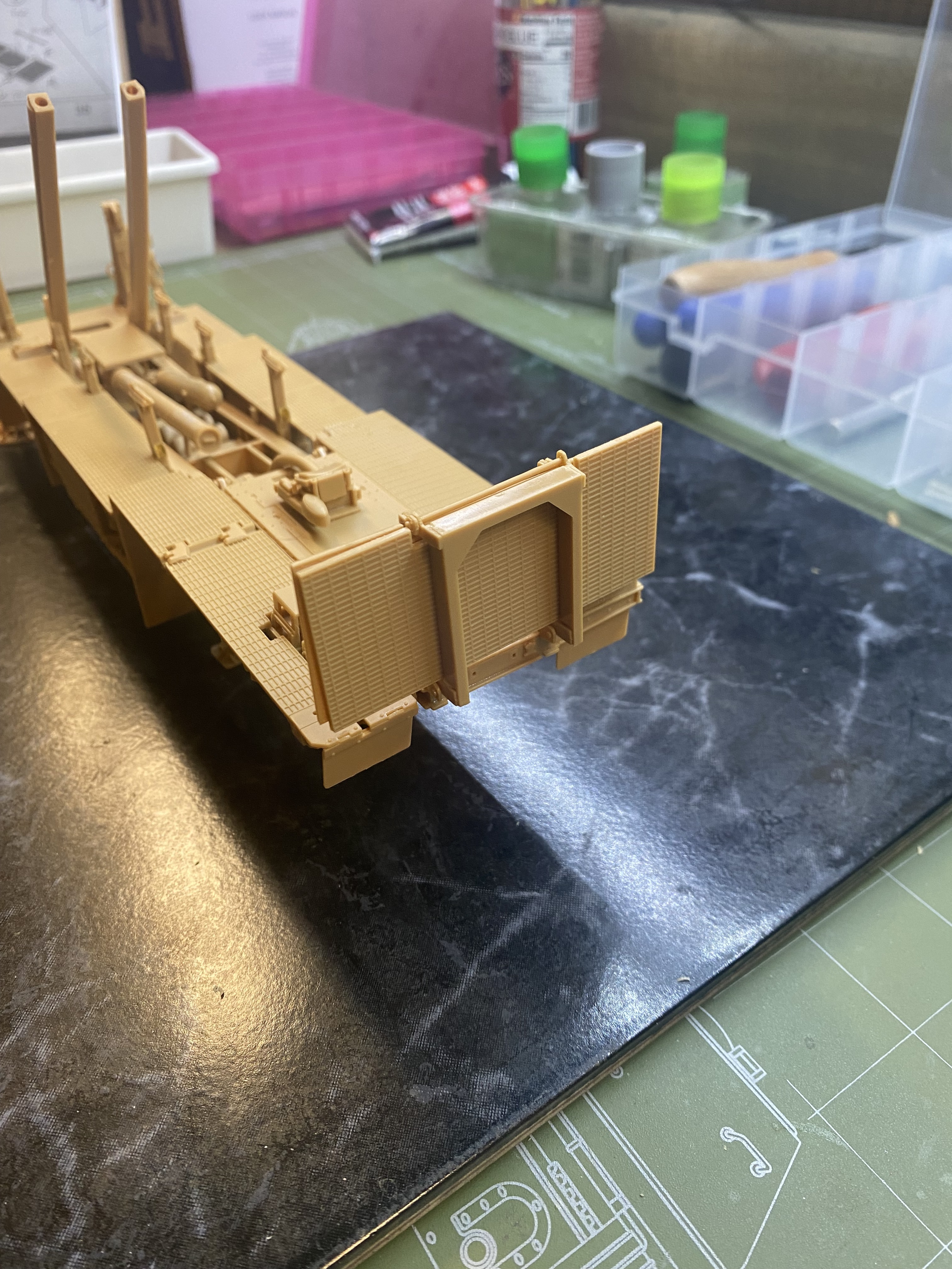

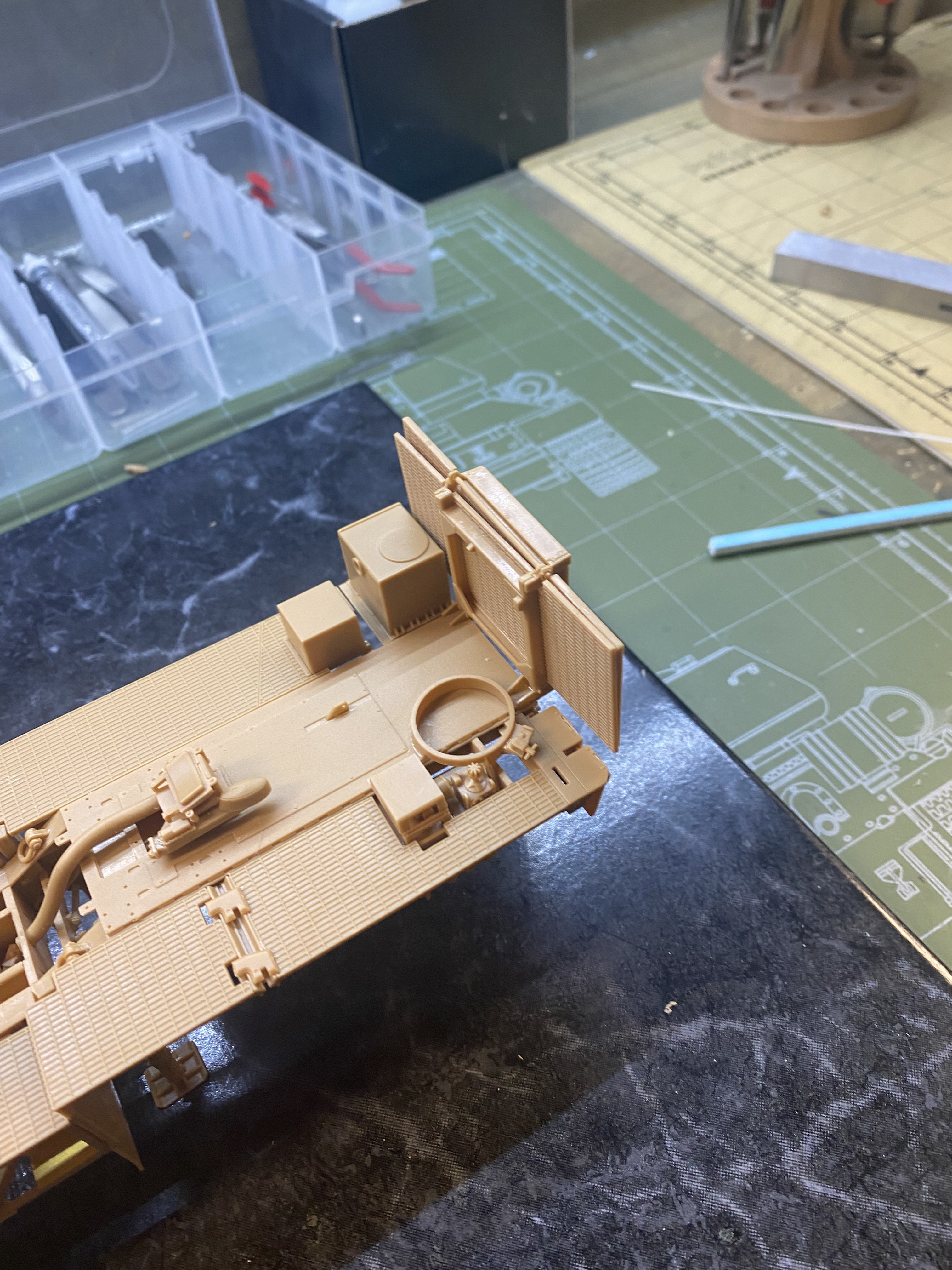

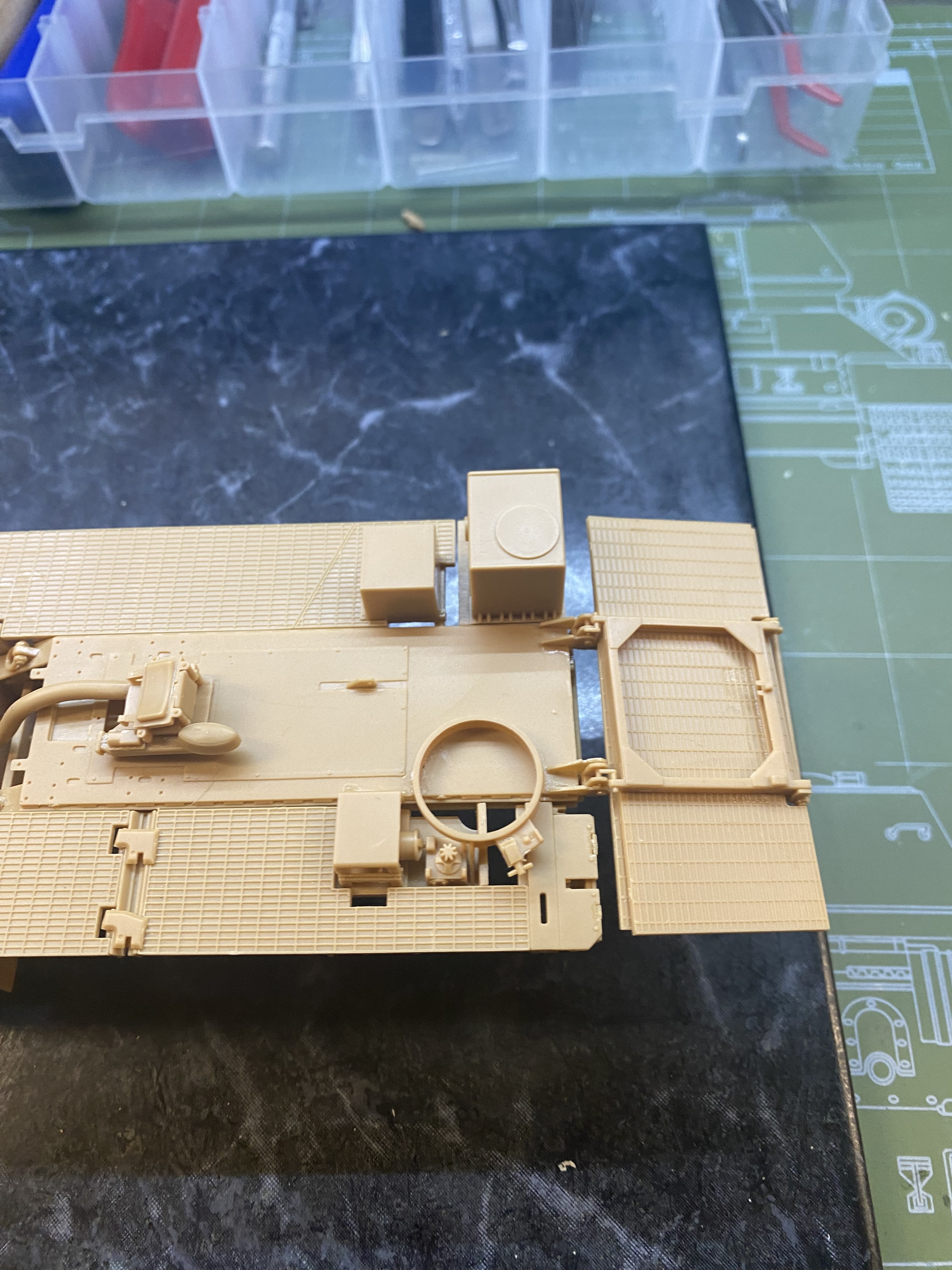

On to the platform frames

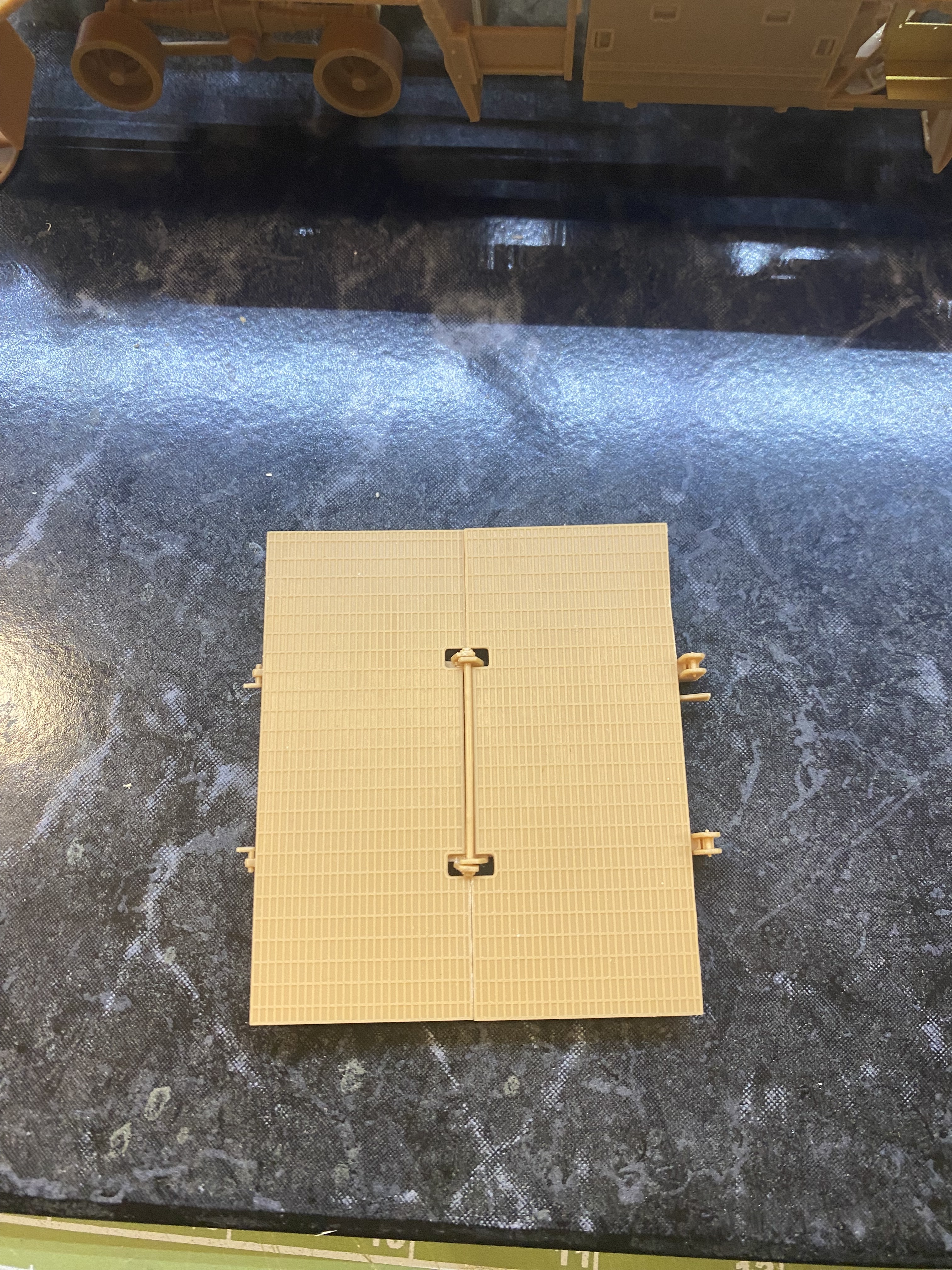

This part wasn’t bad, once I figured out the orientation of the hinge halves.
Work platform temporarily attached to the EL in the folded/up position
With one section folded down
Work platform folded down position
This is just hanging off the end of the EL with friction holding in place. I left off the part shown below because I wasn’t sure if it would interfere with the platform. I’m pretty sure now this will act as a stop and hold it he platform more horizontal to the EL.
All this is only temporary at this point and probably won’t be attached until after paint. This is getting really unwieldy to handle and there’s still a bunch of small parts I’ve left off (handles etc) because I’m sure they wouldn’t survive the build.

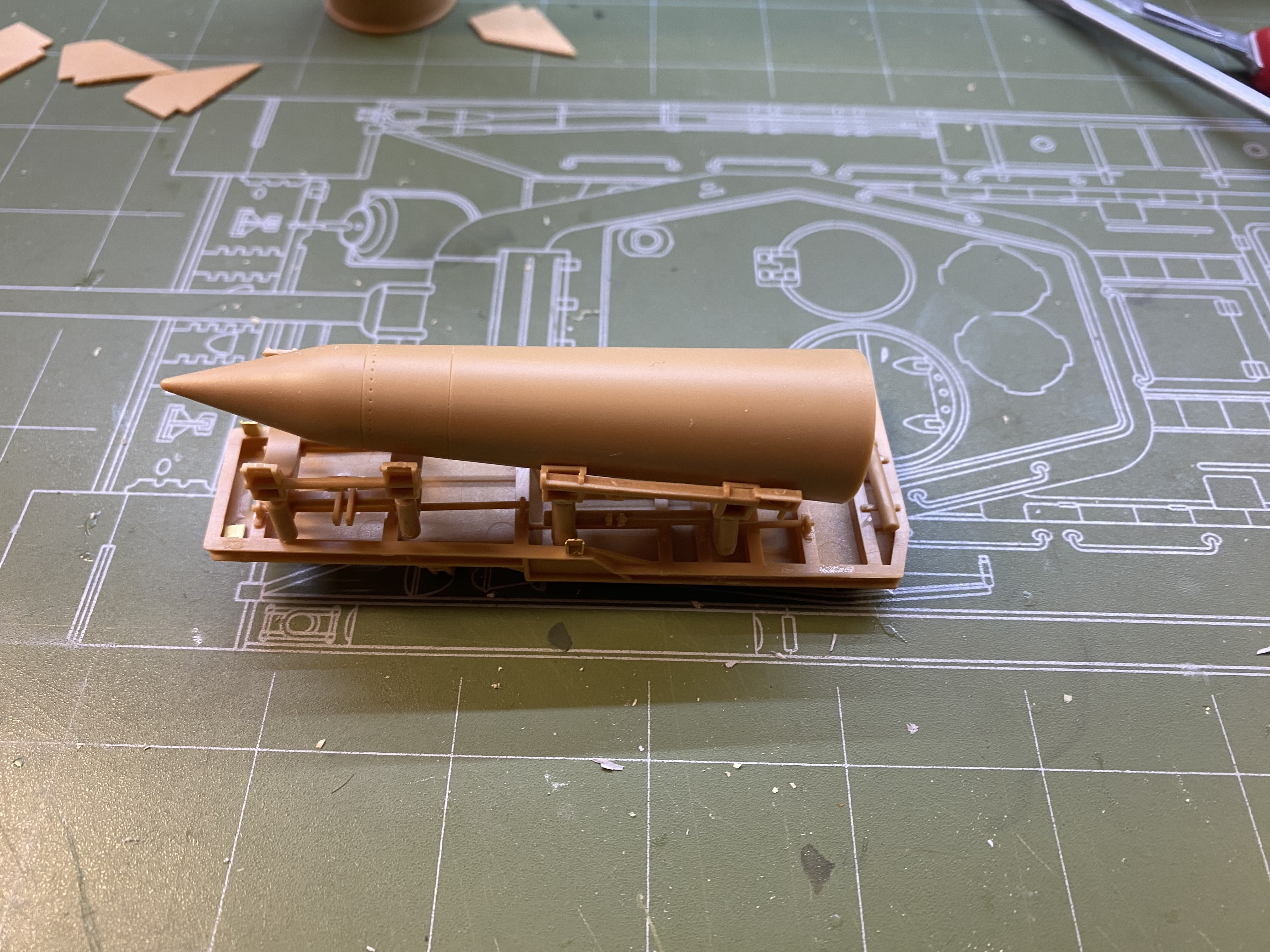

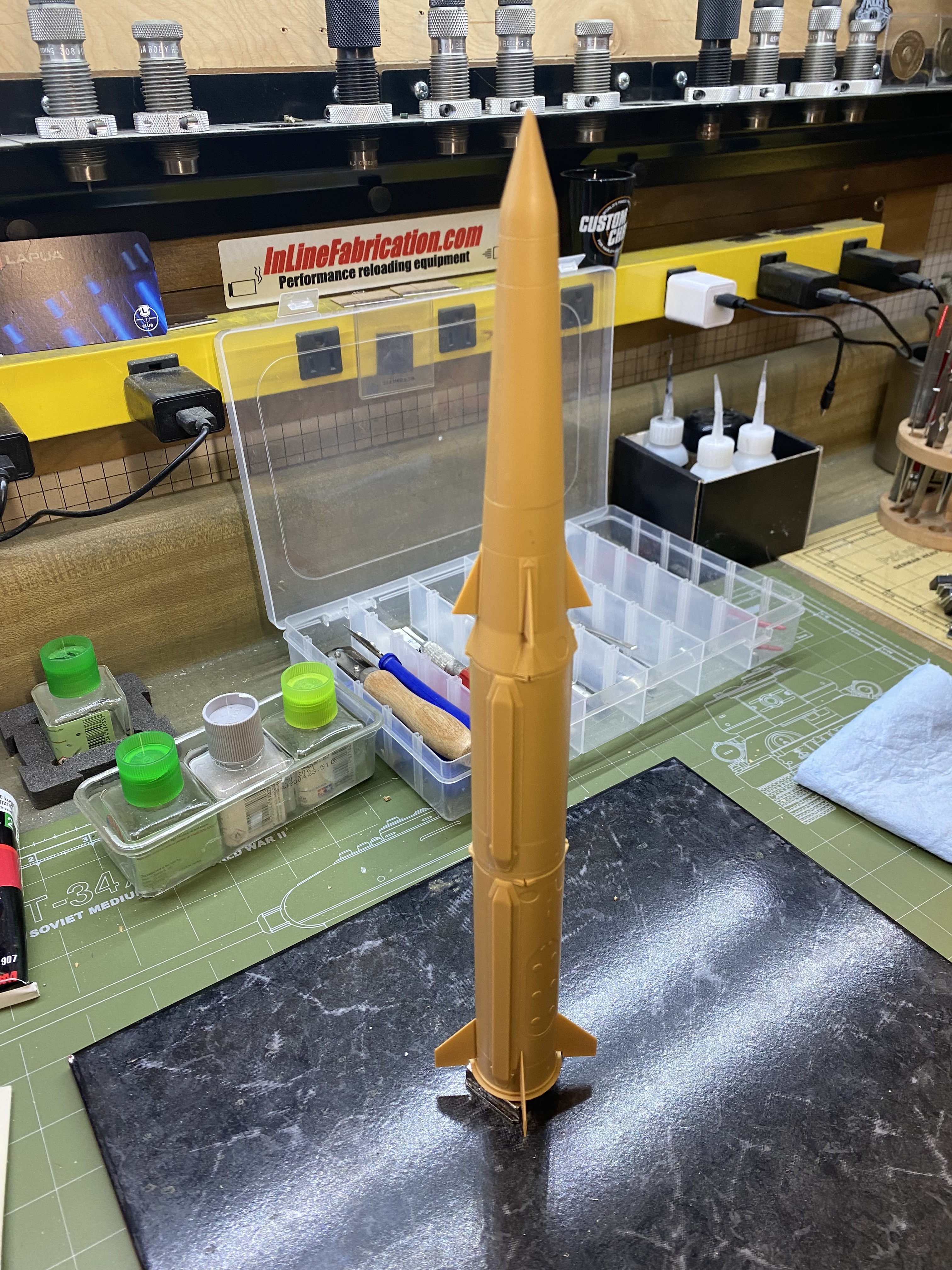

Next up, the missile, itself.
The only thing that’s slide molded is the G&CA, the guidance section.
I’m open to suggestions and instruction how to glue these halves together without screwing up the fine details.
This isn’t a main gun barrel that I can sand to death to get the seams out of……fuselage halves are why I haven’t built aircraft since the 80s….
Any help would be appreciated.

Al, just glue them together. Then fill the seams with Mr. Surfacer. Allow to dry for an hour, then remove excess with a cotton bud wet with Mr. Color Leveling Thinner. This will take down the high spots and remove excess without effecting surface detail at all. Repeat until seams are gone.
Thanks. Thats exactly the kind of advice what I was looking for. :+1:
No problem, man. That’s what we’re here for.

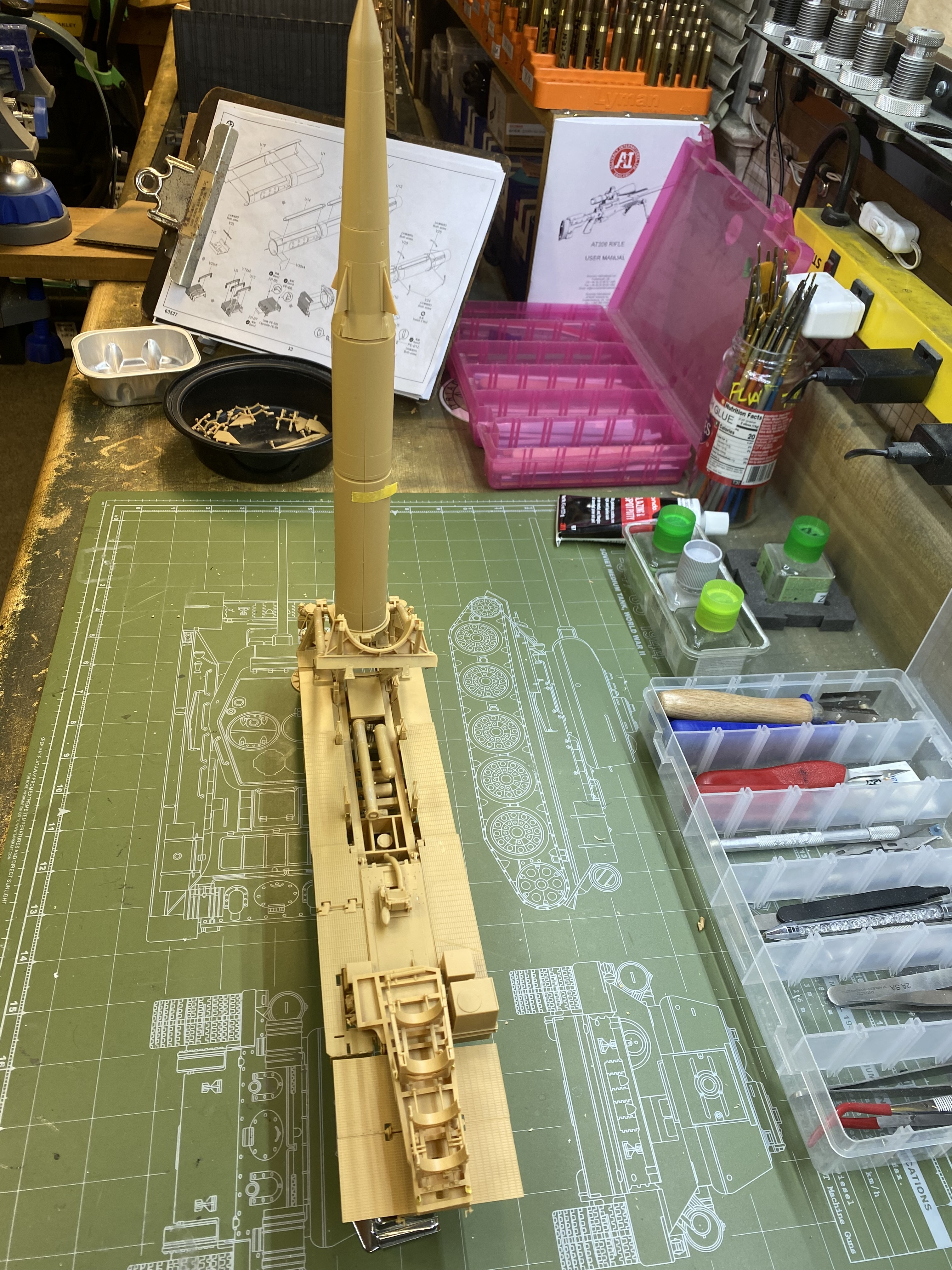

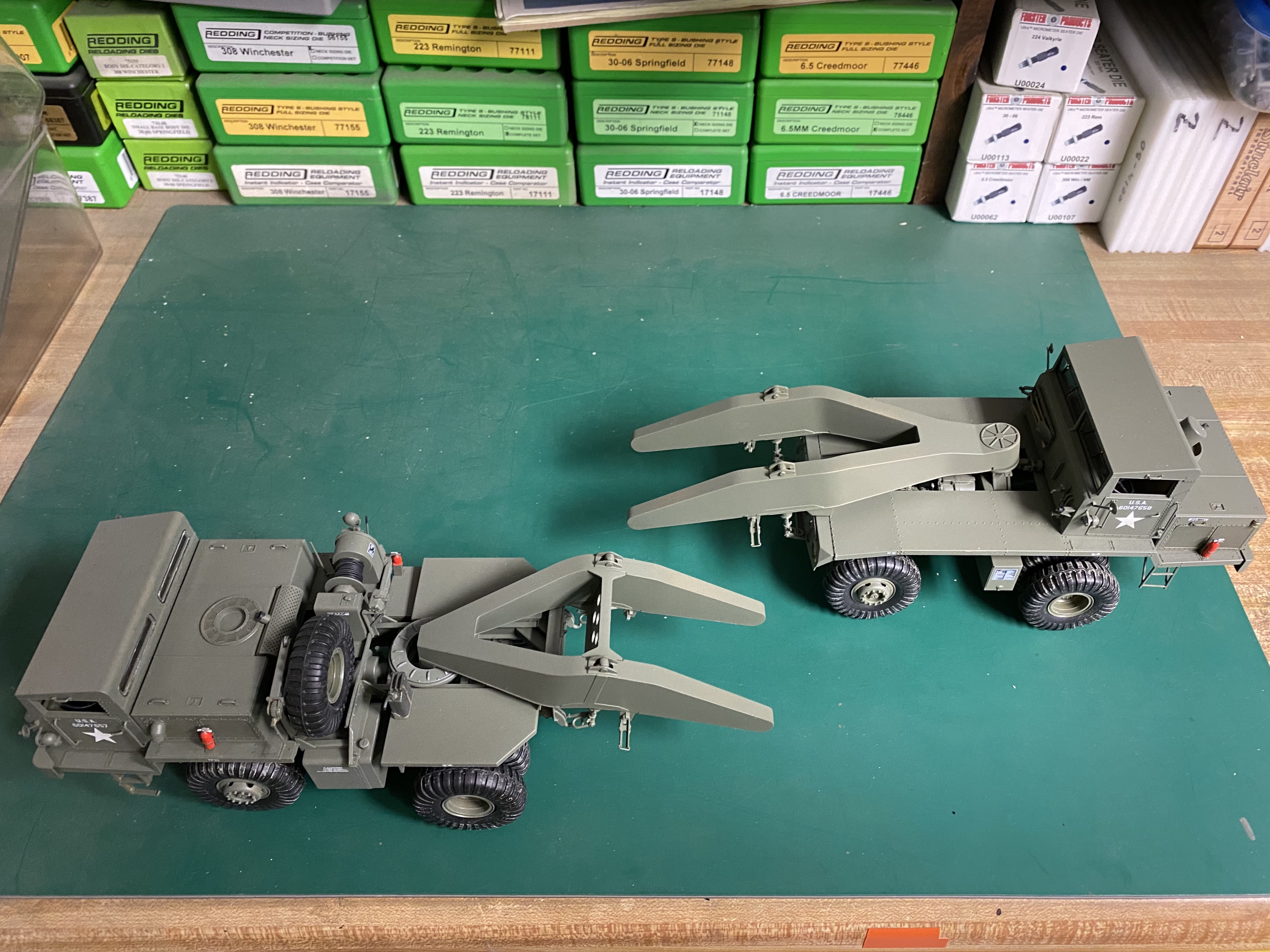

No glue yet, mock up.
This is gonna be a monster.
Impressive. The missile looks great.
Thanks. I haven’t worked up the courage to glue the missile together yet, although if pretty much snapped together. There’s a bit of tape holding the 1st/2nd stage together, but other than that, gravity and friction and some magnets are holding everything in place.
Thats an impressive mock up Al and very well detailed by the looks of it thus far. These I love Kits kits look pretty nice all in all … terrific work mate … and yeah, its going to be a whopper :+1:

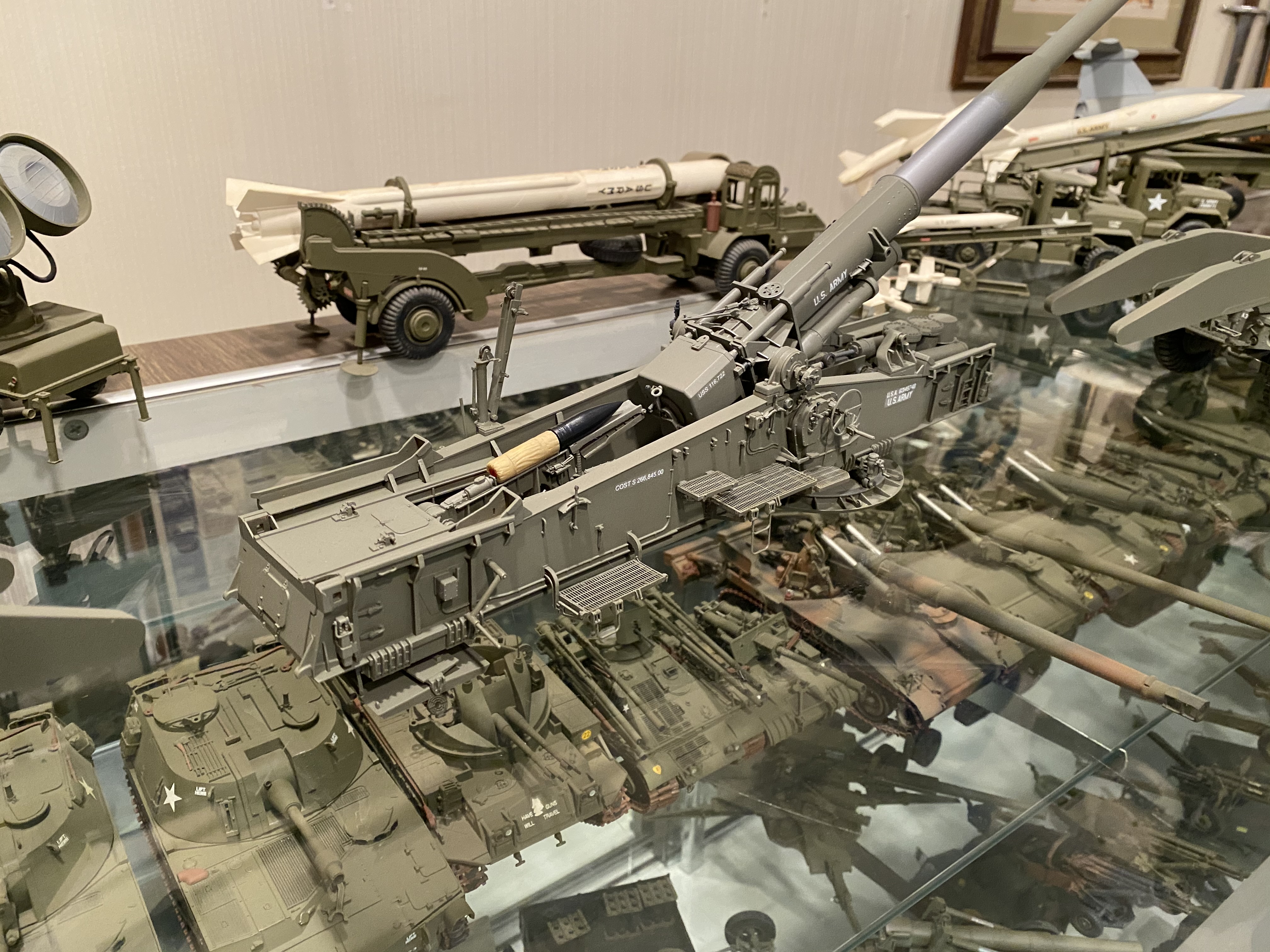

@Johnnych01 my only previous I :heart: Kit build M65 280mm howitzer back in 2020 (another “Grail” kit) and it was a pretty easy build, other than the size of it. It took a lot of work to get all the paint in all the nooks and crannies….
They’re really no different than Hobby Boss/Trumpeter kits. The instructions are identical. I know HB has haters, but I like ‘em.

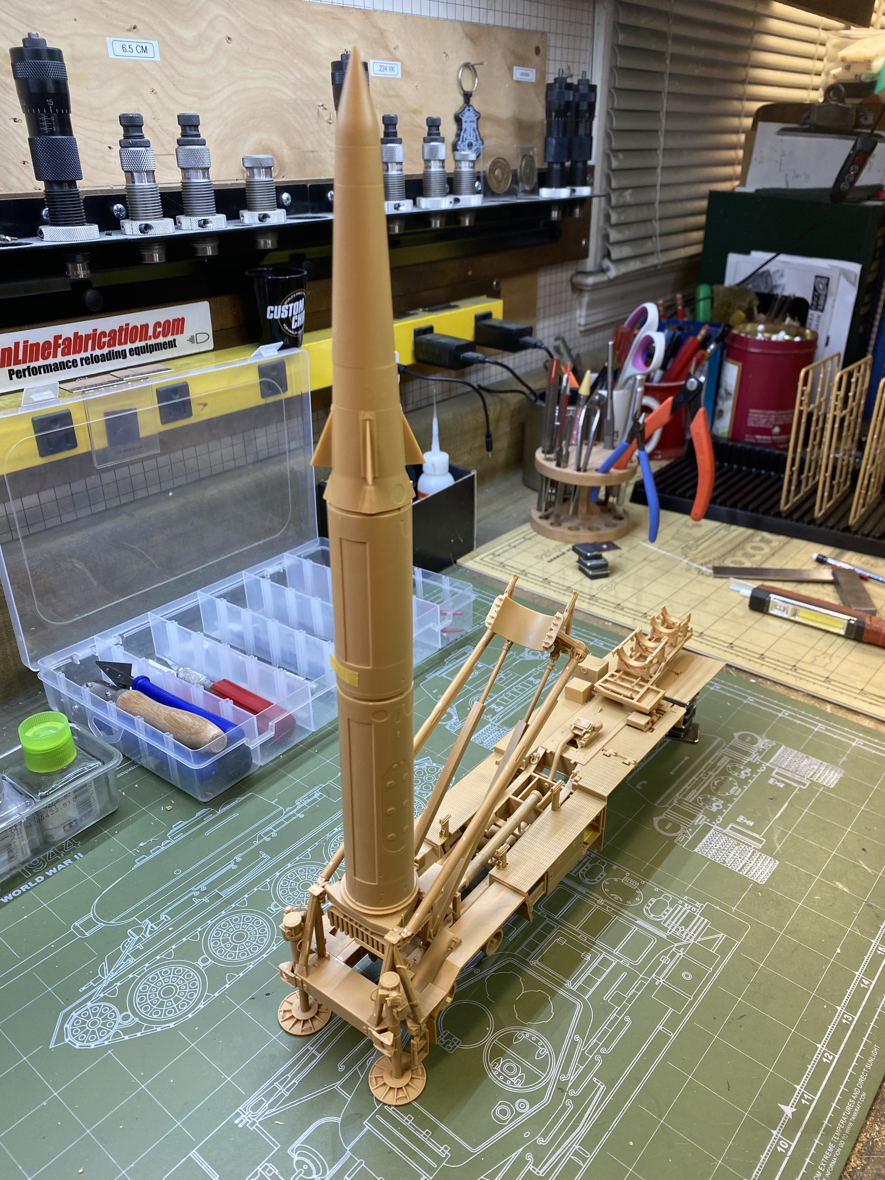

Got the missile together. Attached the guidance, war head and radar sections together, but I won’t attach them to the missile until after paint.

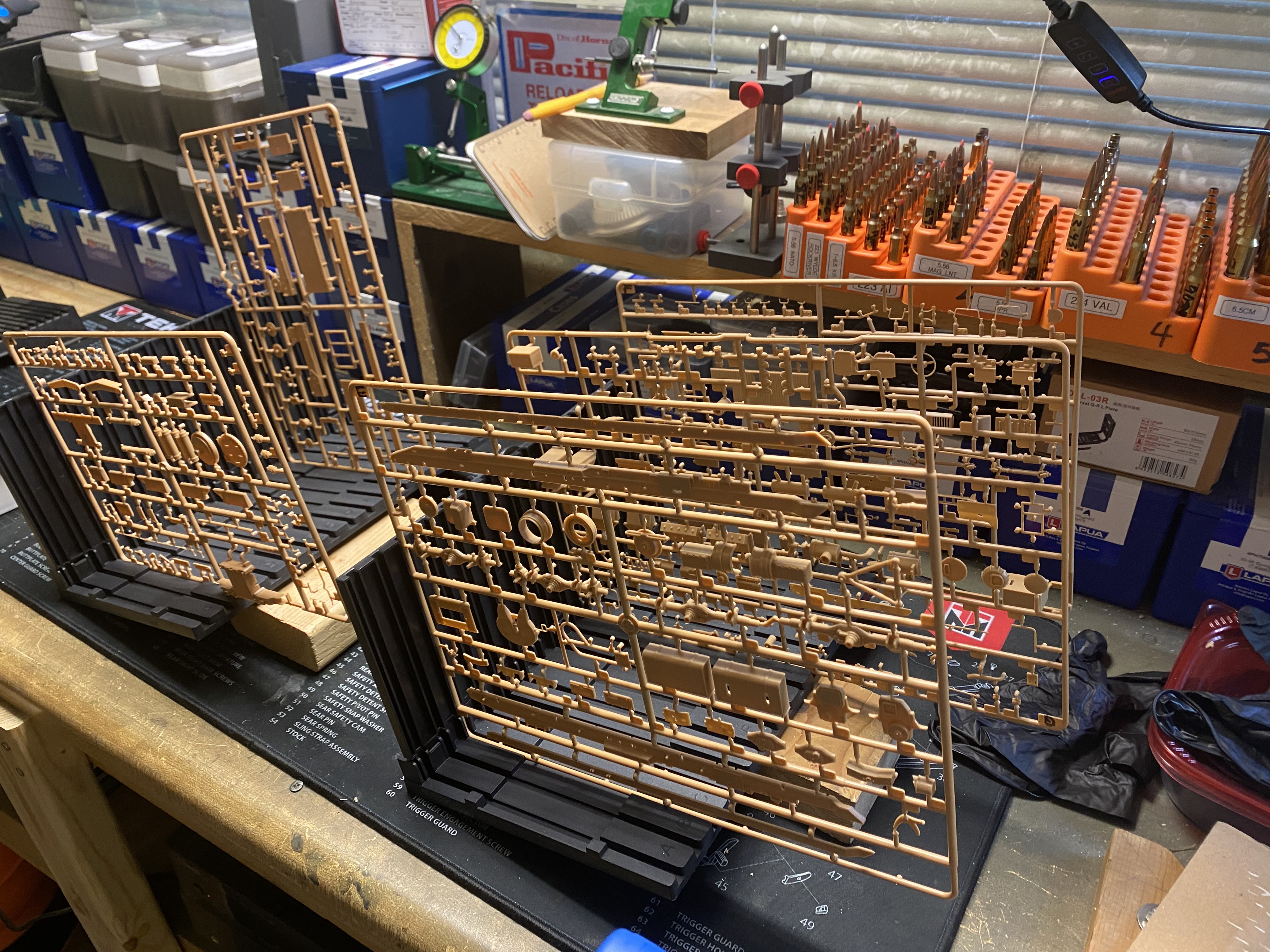

The missle and launcher had a higher sprue count…
