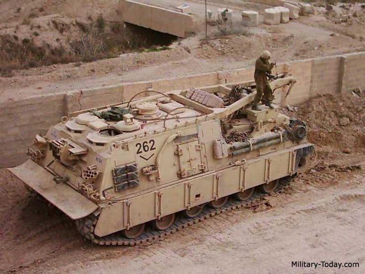

There are extended intakes, but they are not often used. The intakes are at the top rear of the cabin roof, so they are pretty high already. Here is one with the extended intakes.
I know you said rhetorical but here I am tossing in my two cents just for the sake of it. I have crewed many M88s in my military career and have been around and seen other units as well and I have seen several with the fording kit for the exhaust, but the above pic is the first time I have ever seen the Intakes. Most of the guys I knew put the exhaust stakes on for the sound that it gave the 88 not necessarily because they were doing a lot of deep-water fording.
