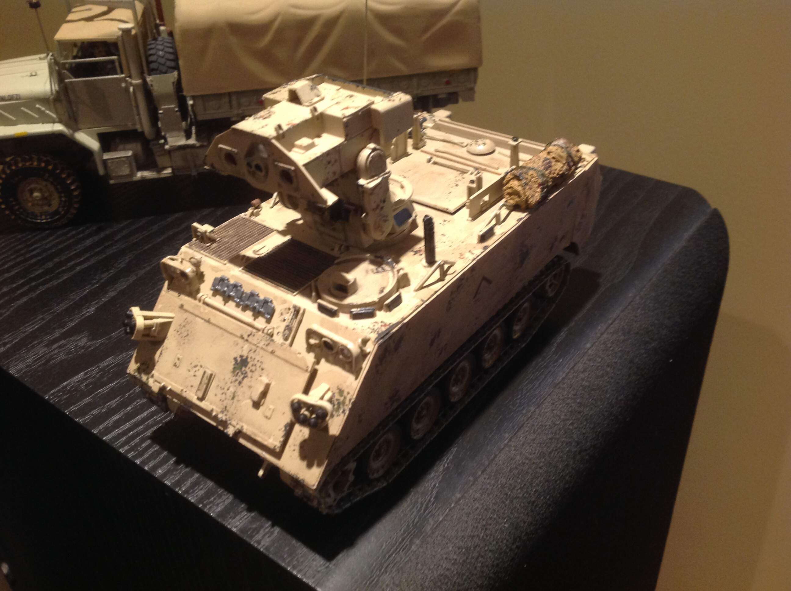

My latest, Italeri’s M901 with modifications suggested by Carlos. I tried some weathering using a sponge.
Looks good. Nice job on the weathering/chipping.
That turned out looking pretty damn good! Much better than what comes in the box.
Thanks Gino and Carlos. I appreciate your comments and Ive decided to go back to that Chapparal and apart from correcting the uniforms and missile colors, I’ll give it some chipping/weathering treatment.

M901s in U.S. service didn’t have external fuel tanks.
Hi Carlos
Just heard on here that M901’s didnt use the external fuel tanks.
Does that tie-in with your time on them?
Just want to check before I strip them off.

Gary is correct. I hadn’t noticed them when I looked earlier. The M901 ITOW did not have them. The later M981 FIST-V, which is almost identical to an M901 ITOW since it was built from them, had external fuel tanks. Other than the M981 FIST-V (which was still an M113A2 chassis), no US M113A2s had the external fuel tanks. The external fuel tanks are a feature of the M113A3 upgrade in US use.

What, you don’t believe me? A little research would have made you aware of that.
No offense Gary. You’re quite right, I should have done more research on this and bigger fool me for following the kit’s instructions.

Upon looking closer, I see another small issue. Italeri molded the blackout drive light upside down. The 1/2 moon-shaped hood should have the rounded part at the top, not the bottom. If you cut off the light and rotate it 180 degrees, you will be good.
It should look like this.
Hi Gino
Stupidly, I reversed the position of the shade/cover on that part in my kit.
It was already molded the right way up as per your picture. (Talk about blind faith)
Now time to reposition the shade/cover!
…along with removing those external fuel tanks on the same build and sorting out the missiles and crew uniforms on the Chaparral.
